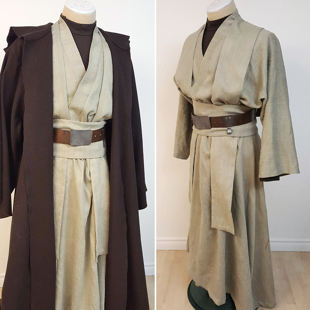

Hello Andy and welcome to the RPF,
Have you seen the complete patterns of all the parts to create Old Ben's costume available for a small amount by juliechantal.com ?
Picture courtesy Julie Chantal
There are also several options on etsy under Ben Kenobi Pattern including Julie Chantal, which of those are most accurate I can't tell . . . I can try and summon Psab keel to check this thread ;)

Hi, thanks for your reply. Yes, I had seen those files by Julie Chantal on Etsy, but didn’t have any independent opinion as to how good they were. Have you (or anyone else here) actually used them, please?
Hi AndyPreston ... I have not used them myself, yet from what I can tell those look quite elaborate and even more important is the kind of fabrics you'll use which will make for a convincing appearance of old Obi-Wan, not if the pattern used follows every stitching of the original costume ;)
To quote Uncle George : 'Don't make it real, make it believable'.
