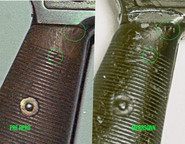

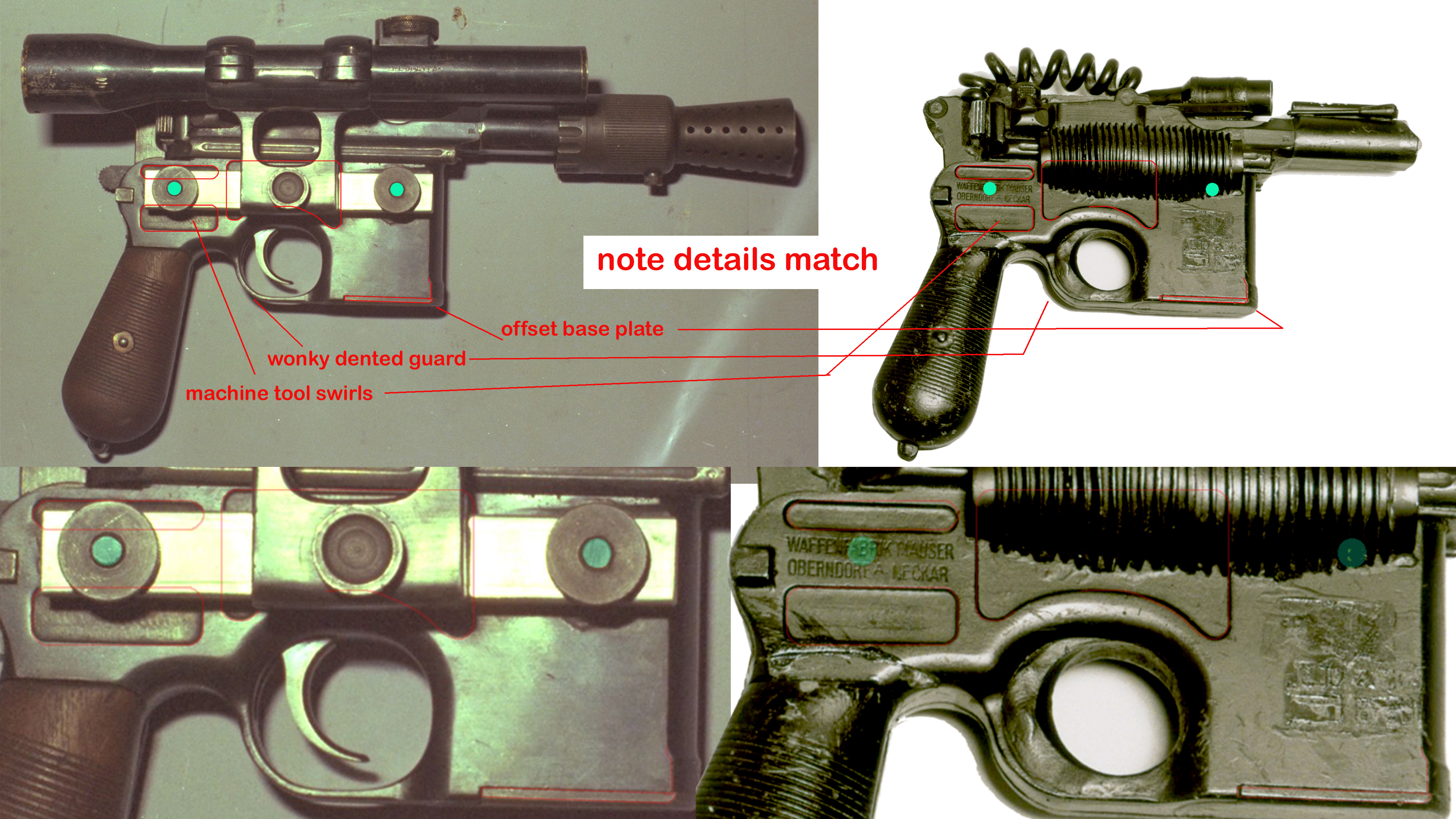

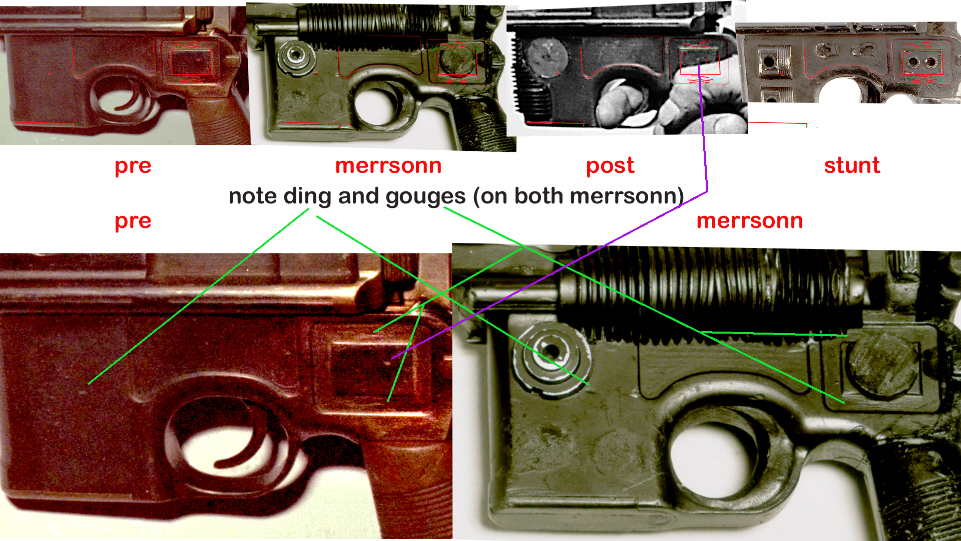

I agree with most above but:
IMO the MerrSonn castings are casts of the ANH HERO upper AND lower as is the ESB Stunt.
I had done the comparisons a while back and there are many details and witness marks that show the same Upper and Lower.
THE GRIP WITNESS MARK COMPARISON IS NEW.
I posted a full history I believe to be accurate based on the evidence a while back.
These are my assumptions:
Based on these images it seems the ANH Mauser was first given to Lucas with the LEFT side lug mounts and scope from possibly Sweeney or NR or other Lower. This is NOT the R&H LOWER.
Note there are NO Right side lug mounts. The art dept. made a mold of it which we see in the MerrSonn castings.
Logically, the MerrSonn casting was either molded from a Mauser with the 2813 upper and a lower with NO mounts at all OR it had LEFT side lug mounts when first shown to Lucas... which makes sense since it seems the rear lug on the castings were cut off. The front covered by the pulley.
I have always assumed that Lucas tested the blaster with the left side mount and scope and realized Han needed a right side holster so they gave it back to KCarl to change to a right side mount. We now know that KCarl easily brazed on and off and refinished these Mausers many times so no problem. Lucas likely explained the holster use to KCarl and he changed the scope and mount to the ST to be a little more compact.
KCarl gave it back to Lucas which is the PreProduction HERO image. The art Dept. made another mold of the HERO with RIGHT side lug mounts which eventually became the ESB Stunt blaster castings.
So, the MerrSonn castings are of the 2813 HERO entirely but with the original LEFT side mount lugs. IMO.
For me, there are just too many "actual" witness marks that match exactly the HERO preproduction image.
These images also prove the HERO lower can not be the H&R. Possibly be the NR Lower or Sweeney if it was different or another Lower entirely since KCarl added Lugs as needed.
Wow Pat, I wish you shared this earlier! Now I think the Merr Sonn actually does share the same lower as the Hero..
I wonder why they molded it twice? With the Merr Sonns, the FH was much further outward, vs. the ESB/ROTJ stunt being almost right-on to the Hero FH position)
Thank you for sharing this buddy, I hadn't even noticed those identifying marks!!
..though I wonder now how they removed the spacers so cleanly?
Also on the Merr Sonns, if that 'possible' antenna post wasn't in the way of the slight radius cut in the Hero's frame right where the top of the Mystery Disk is, that would absolutely prove it for sure.
Though, we can't factually claim it's a pushrod stem there, it might be just part of that possible Bic Pen tube-like thing in the center of the Merr's barrel greeblie. :p
Great stuff, man. I think I know now what my favorite feeling is, a 'New Realization'..it feels good..
