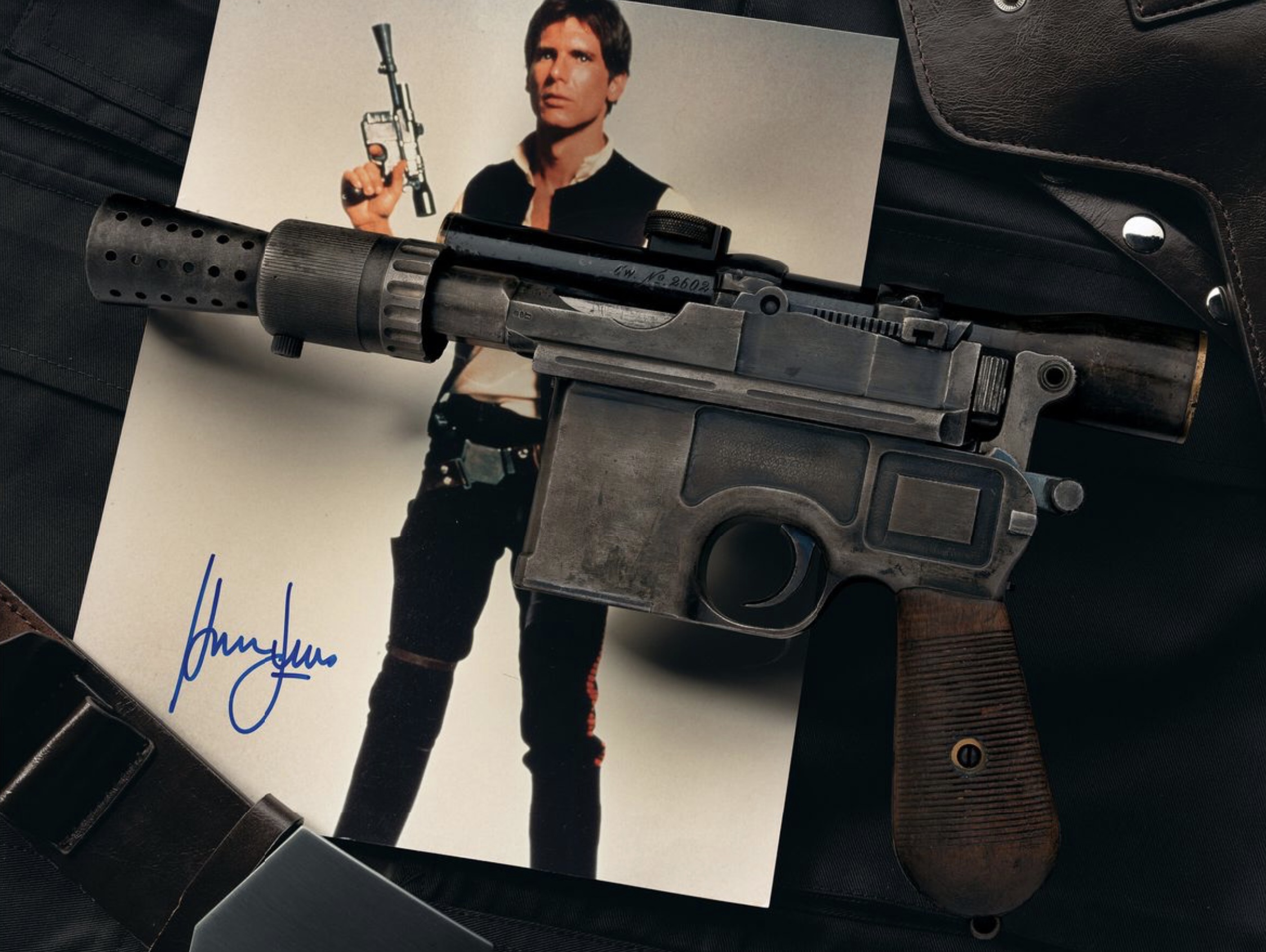

Han Solo ANH Blaster From RIA, Prev on Pawn Stars
wow, thank you...

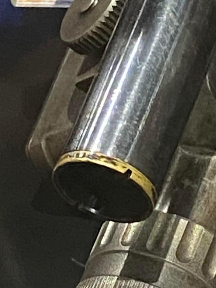

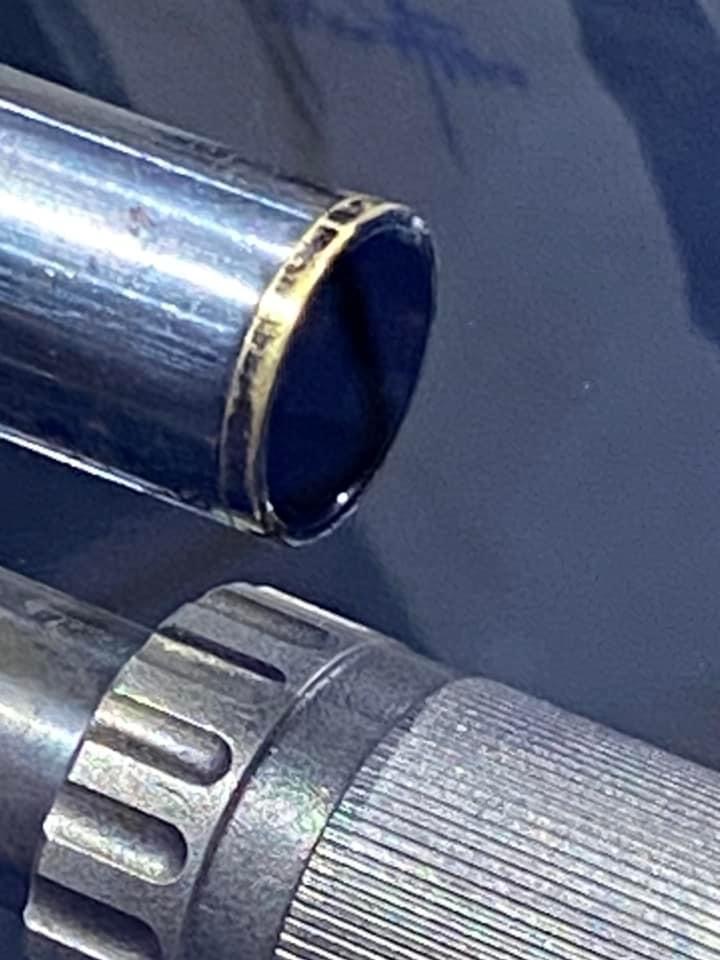

Look at the different colors of the metal, the rings have a dark sheen, fading to red... and so does part of the cradle. The flat part of the mount is completely gray, looks like different metal. I can even see the remnants of the center circular swoop on the bottom, they may have ground off a lot of material

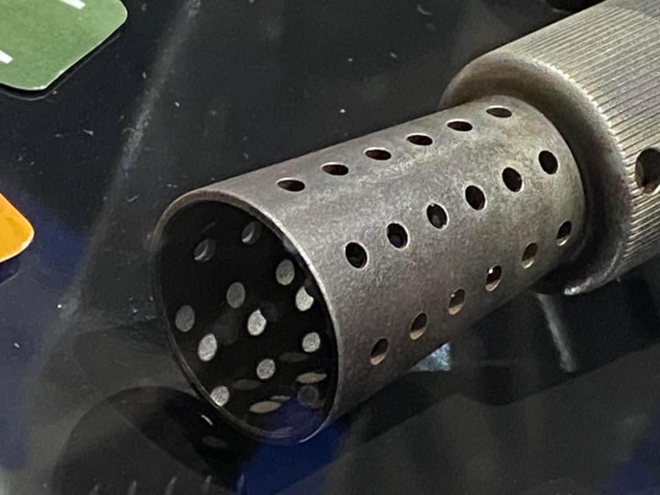

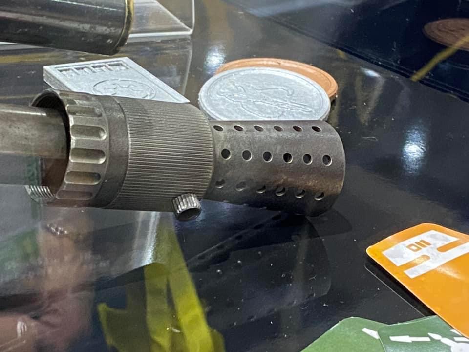

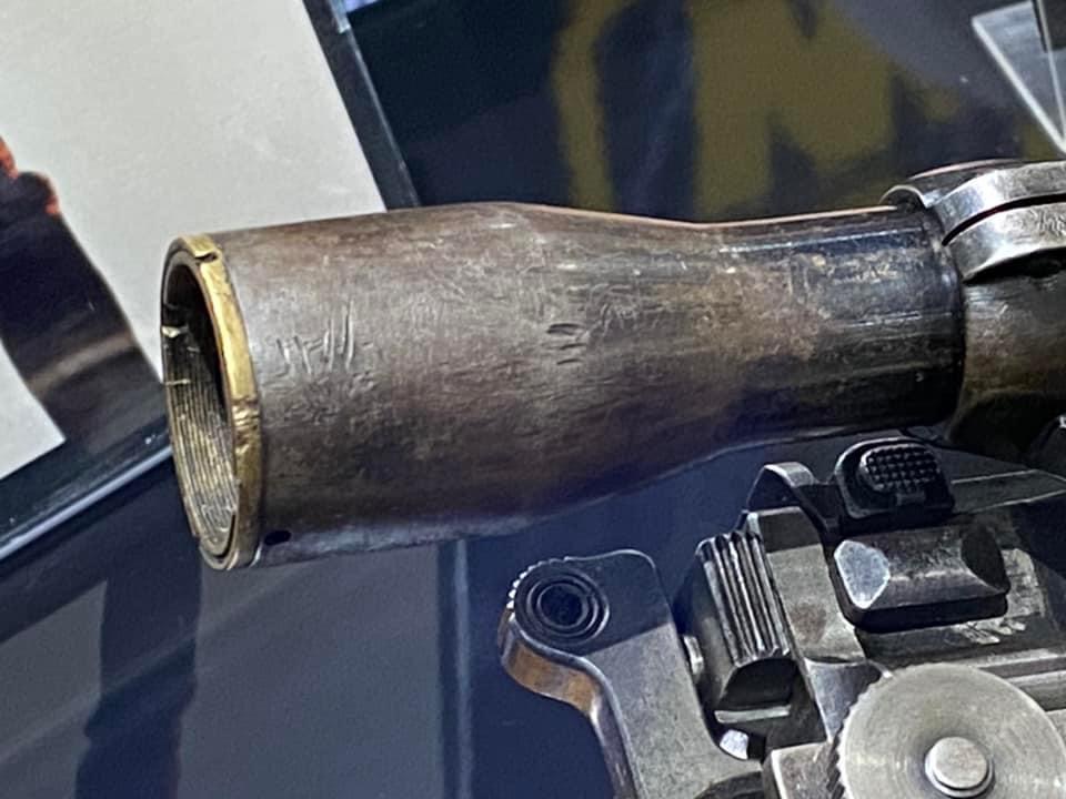

The way Tony described the barrel to me was that it was a shroud fitted to the outside of the shortened Mauser barrel. It was able to be un-soldered and removed. I understood him to mean that is the state it was in when Carl began reconstruction.

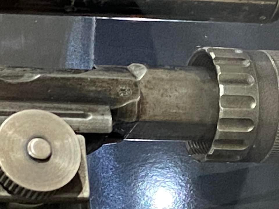

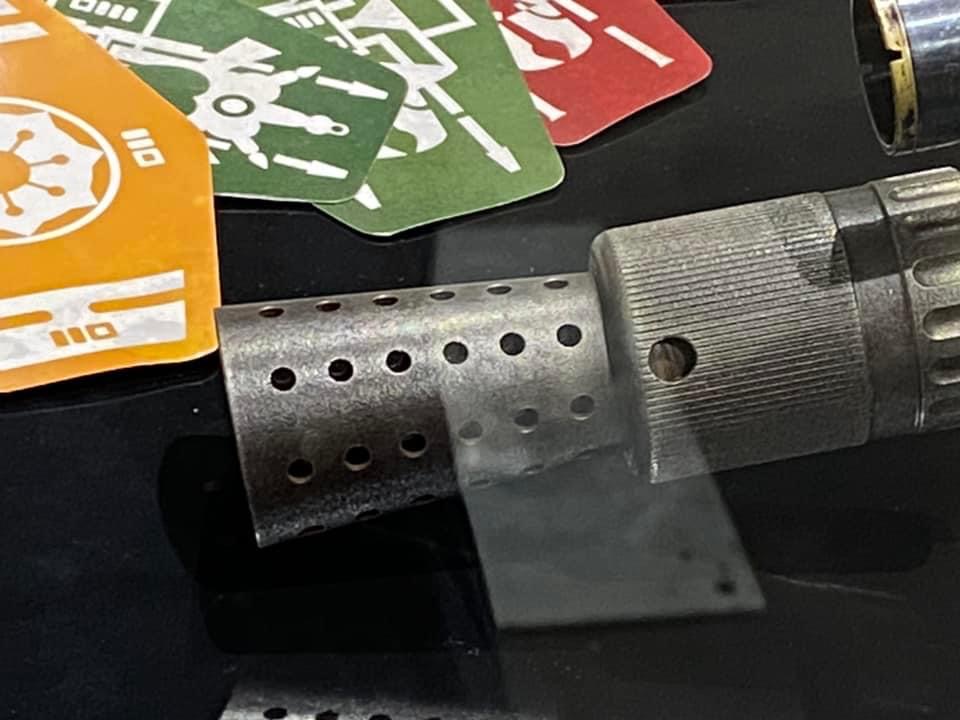

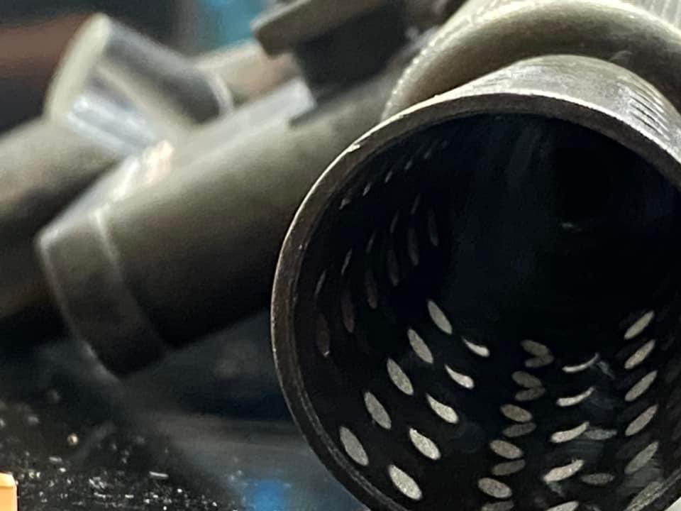

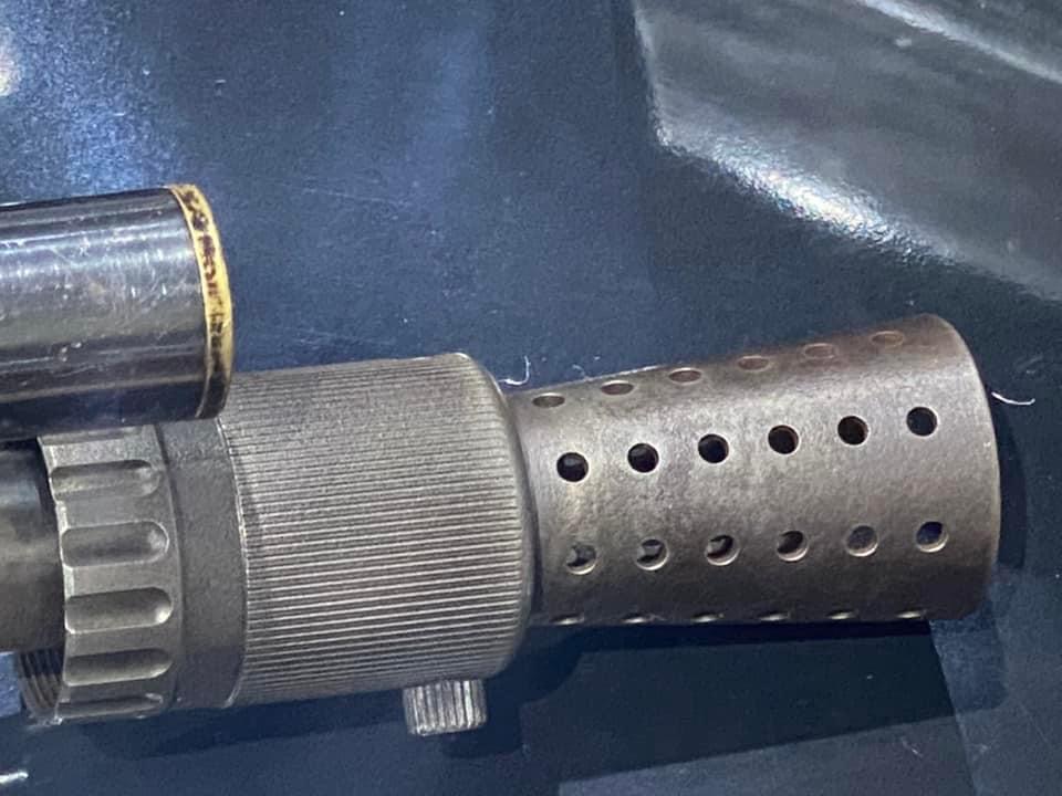

The Barrel info is interesting but confusing.
The rifle barreled (bullbarrel) c96s were already built for Naked Runner and Sweeney prior to SW so I assume when Karl said they already had guns with the barrel cut he meant these. These were not unsoldered after NR and Sweeney but I guess there would be the option. ?
Soldering to the outside would mean the c96 "barrel would need to be turned down to a tube or cone shape that he could match with the shroud accurately... without taking too much material from around the chamber area since these still needed to fire blanks etc.

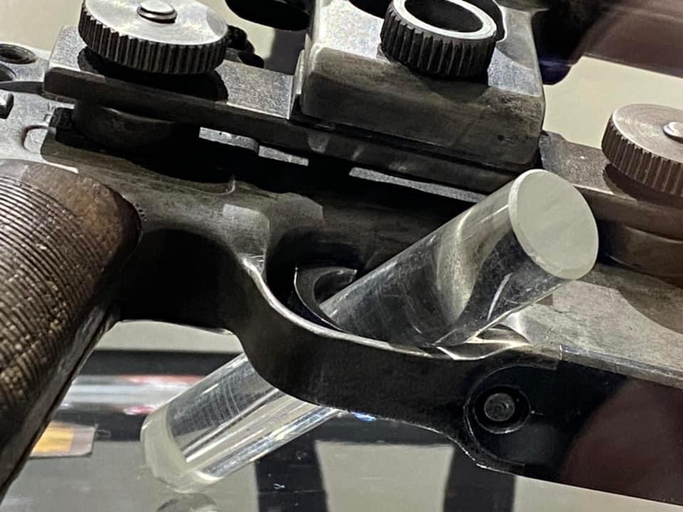

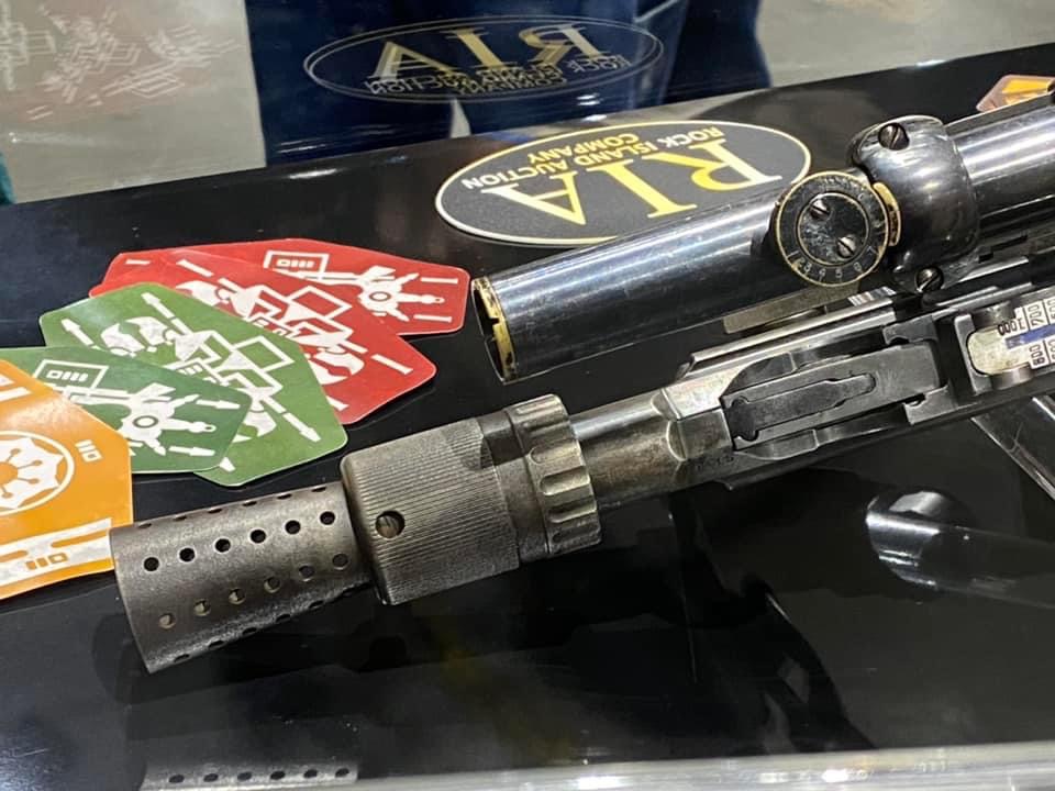

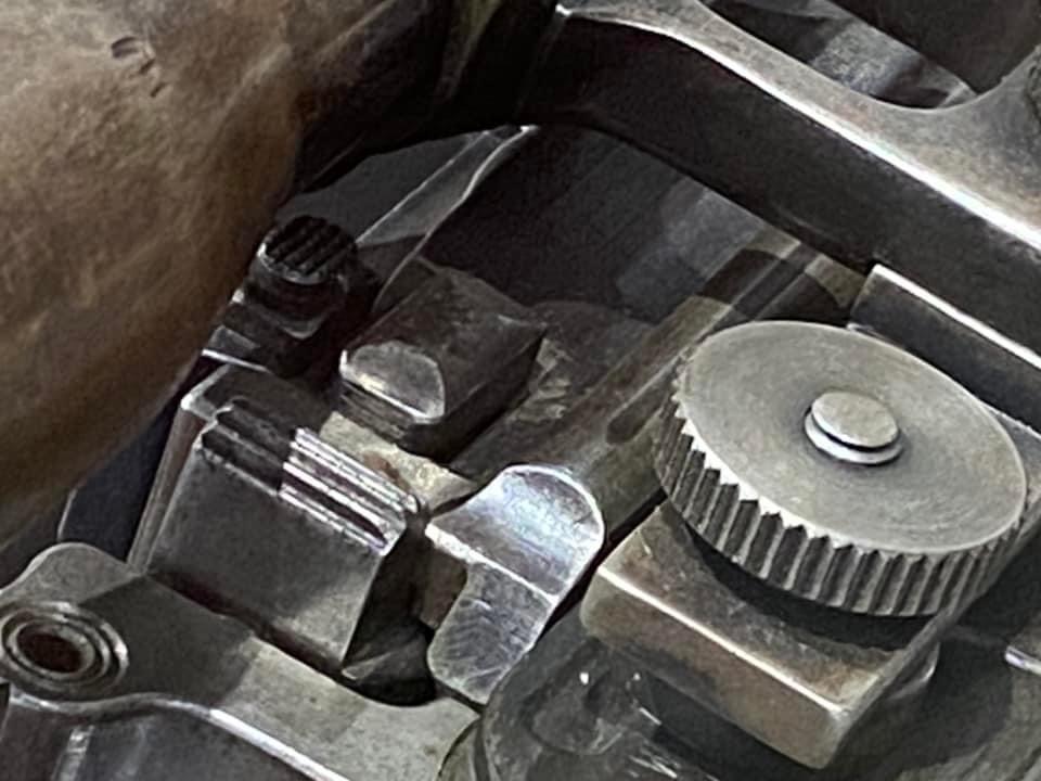

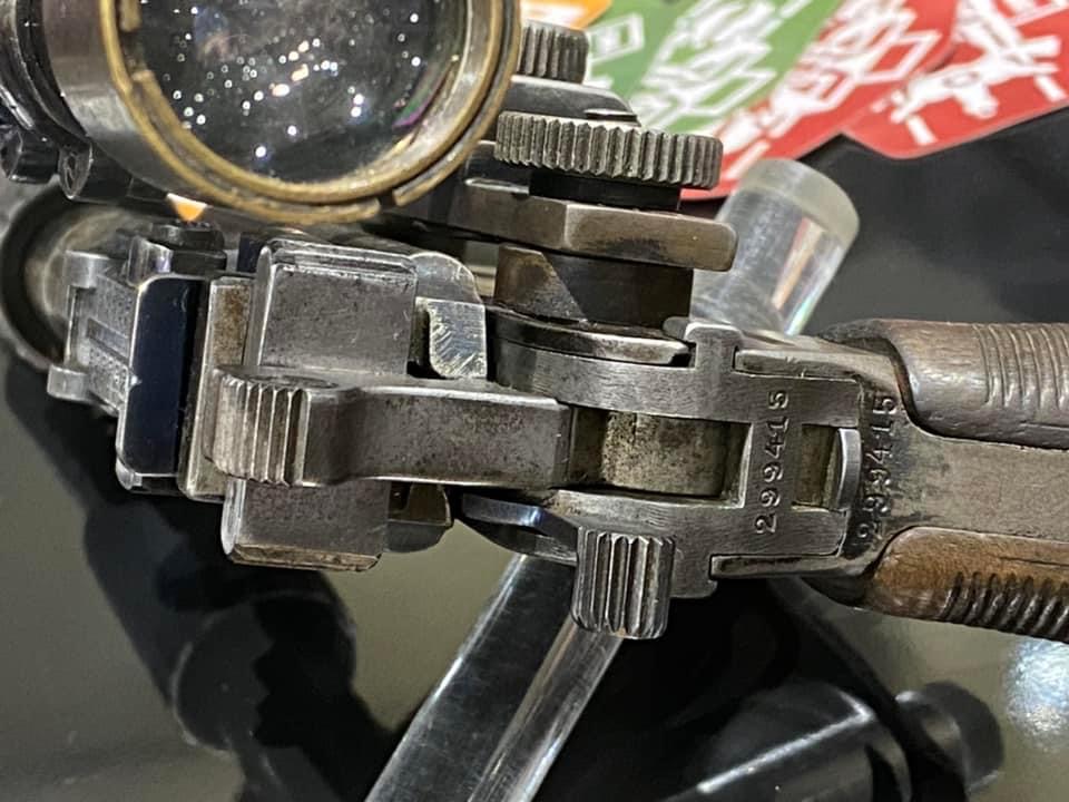

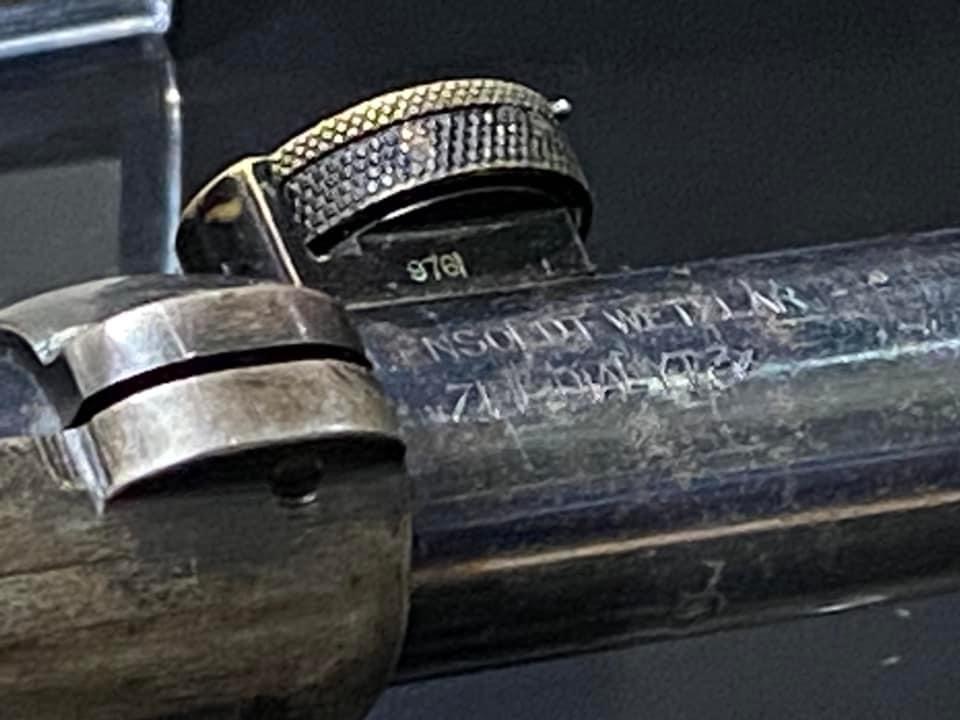

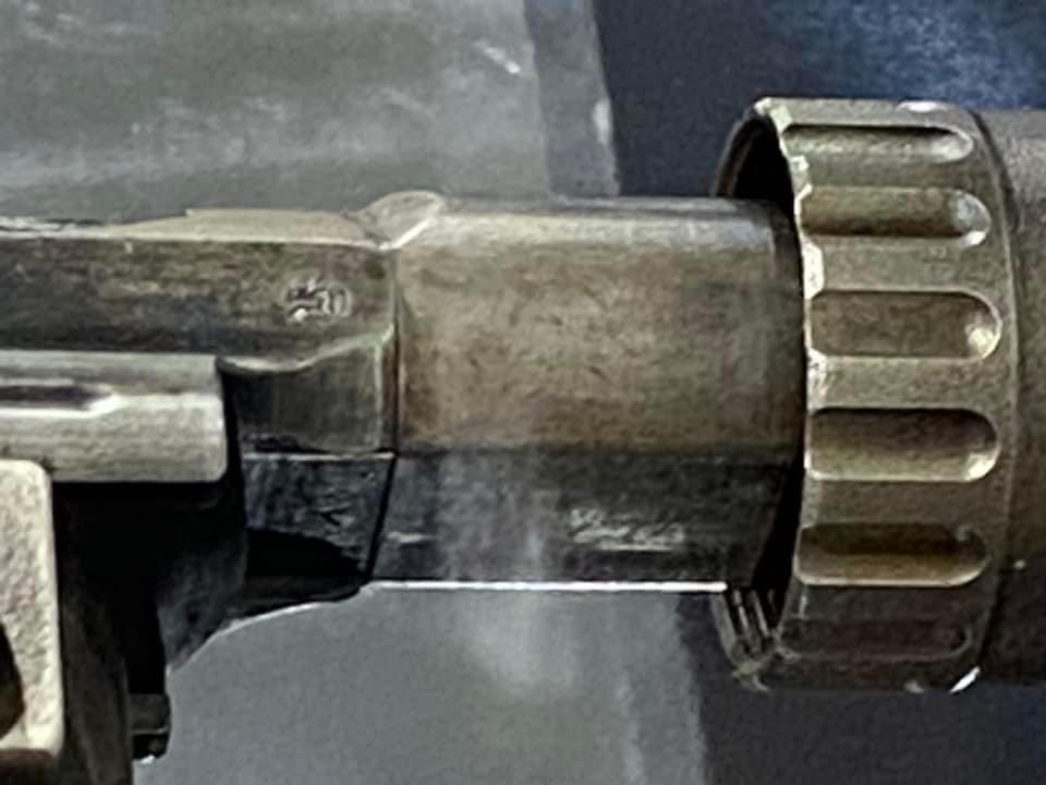

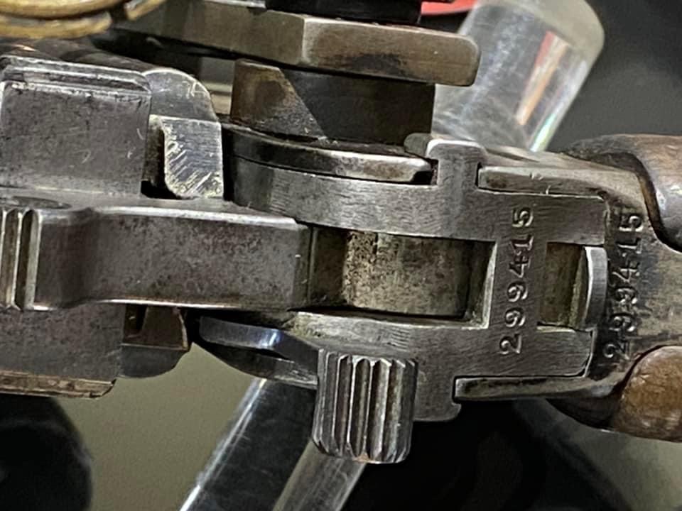

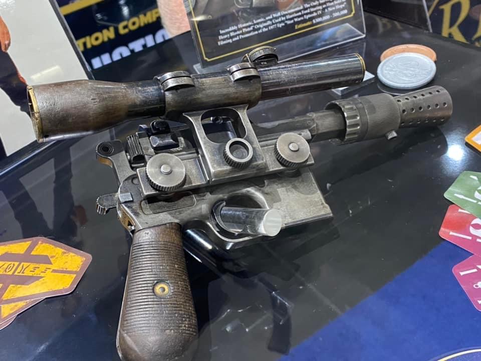

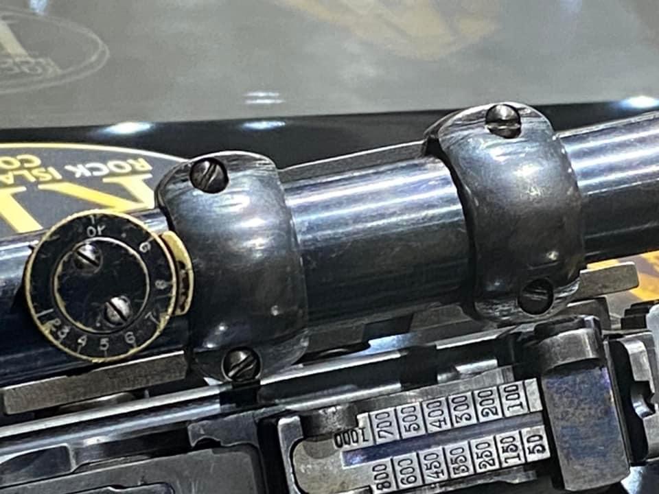

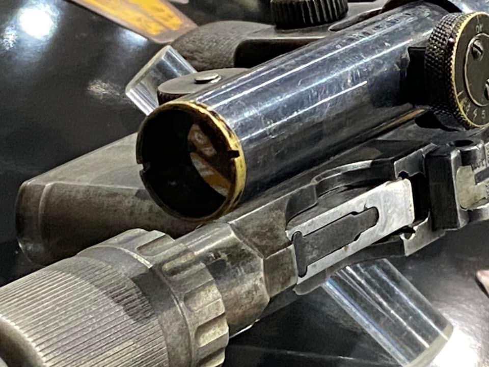

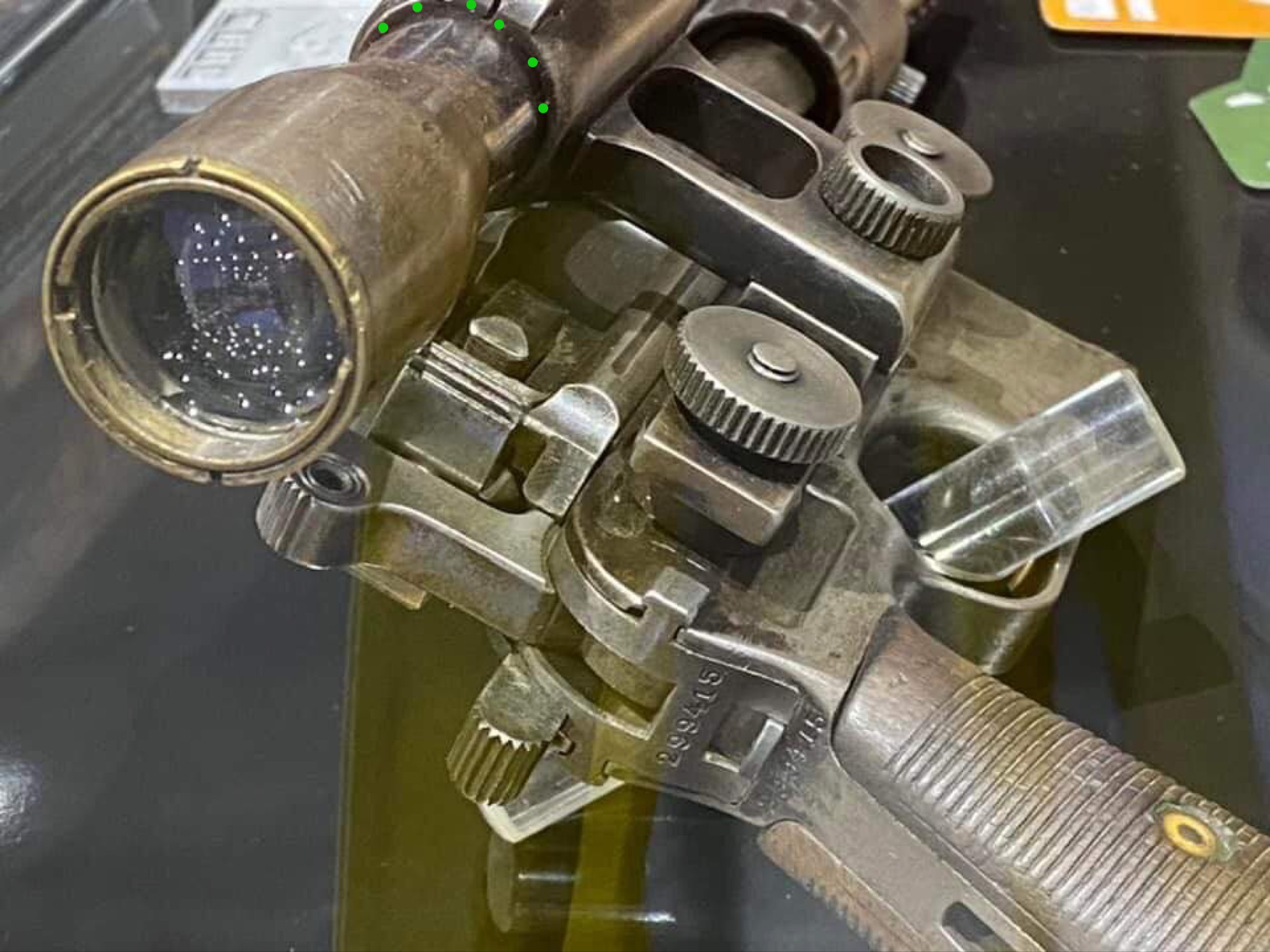

Thanks teecrooz, you found some great shots of it! There may still be some hope (a new hope, maybe? haha) that the cradle is original-ish and possibly just modified beyond recognition. The marks between the lugs seem a tad too close to the Hero's for them to bother copying, considering their lack of consideration recreating the rest of the prop accurately. There does seem to be a slight bit of the 'under-cut' from the original center square hole of the mount, as thd9791 noticed. But hard to tell confidentely.. It's difficult to go just by the claims of the profiteers selling this thing for the most part.
The crosshairs are likely not visible due to the relief that the scope has when the photo was taken, the whole reticle fades to black if viewing too close or too far away. Which isn't much, usually just within an inch or so tolerance can cause that with rifle scopes.
-Carson

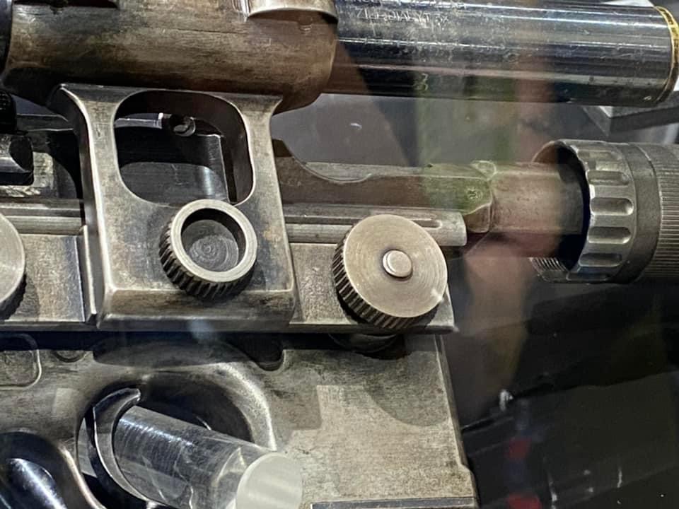

I agree that I'd like to have hope for the cradle part, not that that would make all THAT much difference, especially since it has been changed beyond recognition if it was original.

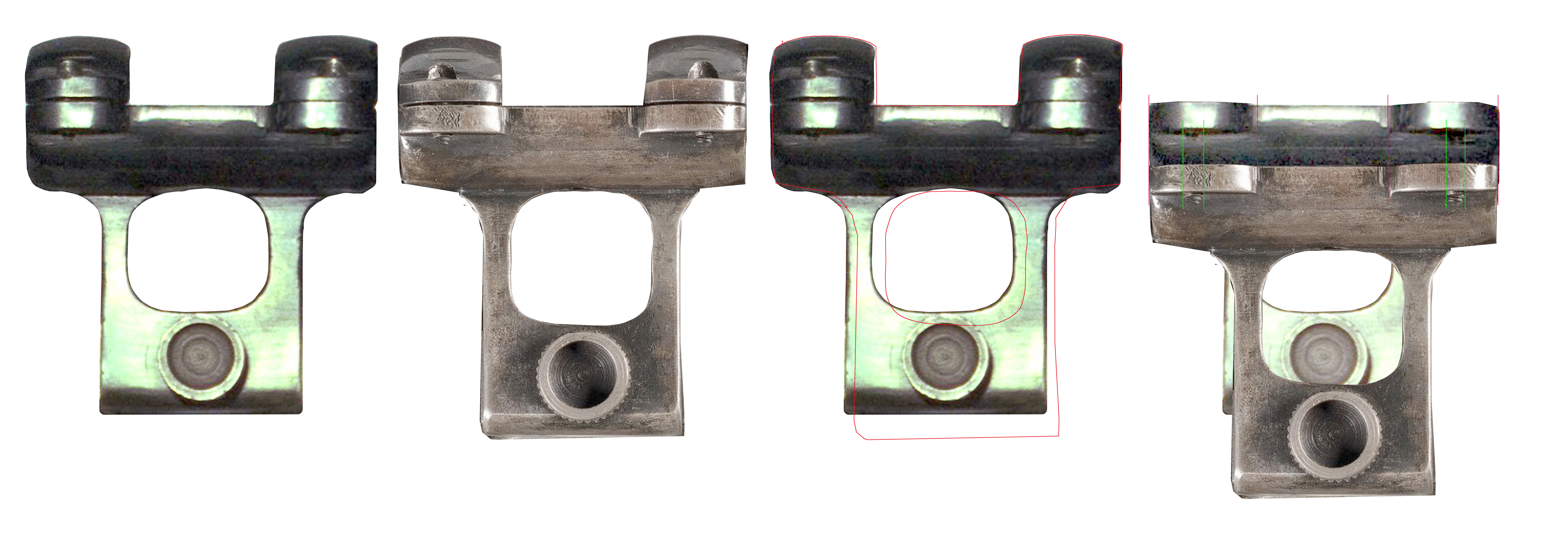

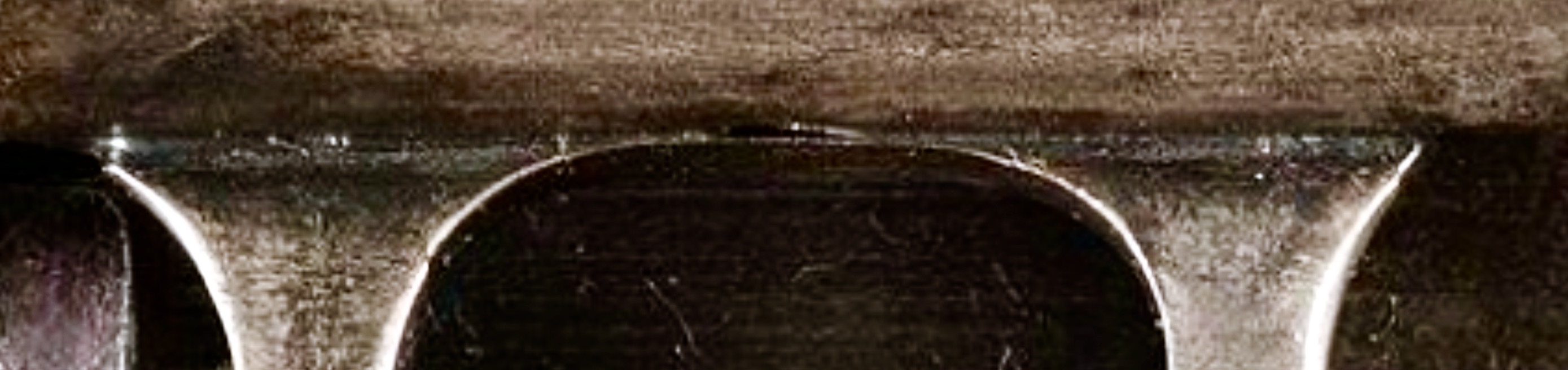

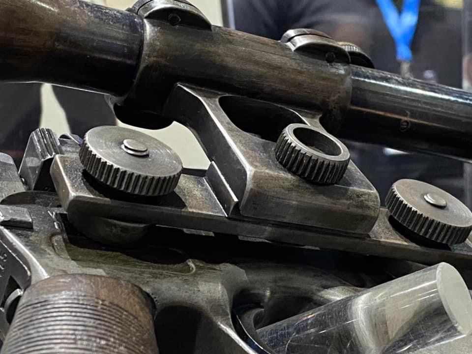

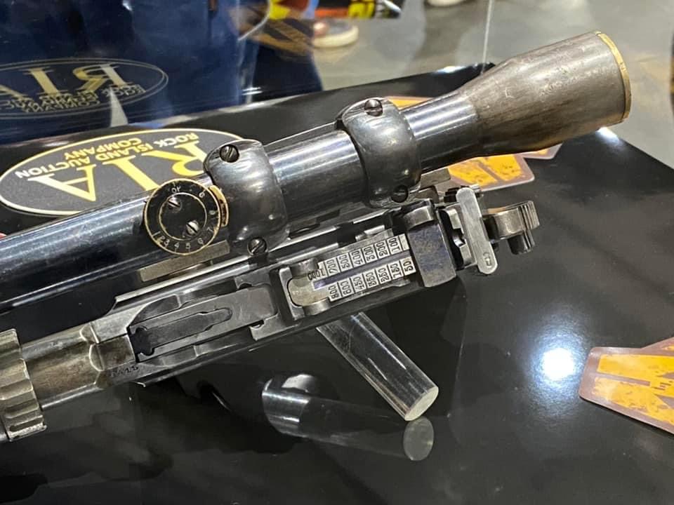

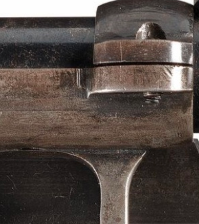

The two images of the mount are almost identical in angle (not exact) so the comparison is pretty close IMO.
I based the scale on the only consistent area. The upper rings. Size and spacing. They match and I believe they are original.
Forgetting the lower section from the thumbscrew down for a moment there are similarities if you squint.
The general shape is similar.
Tool-marks and "witness" marks could be similar due to the same type milling operations so it is hard to be 100% sure either way.

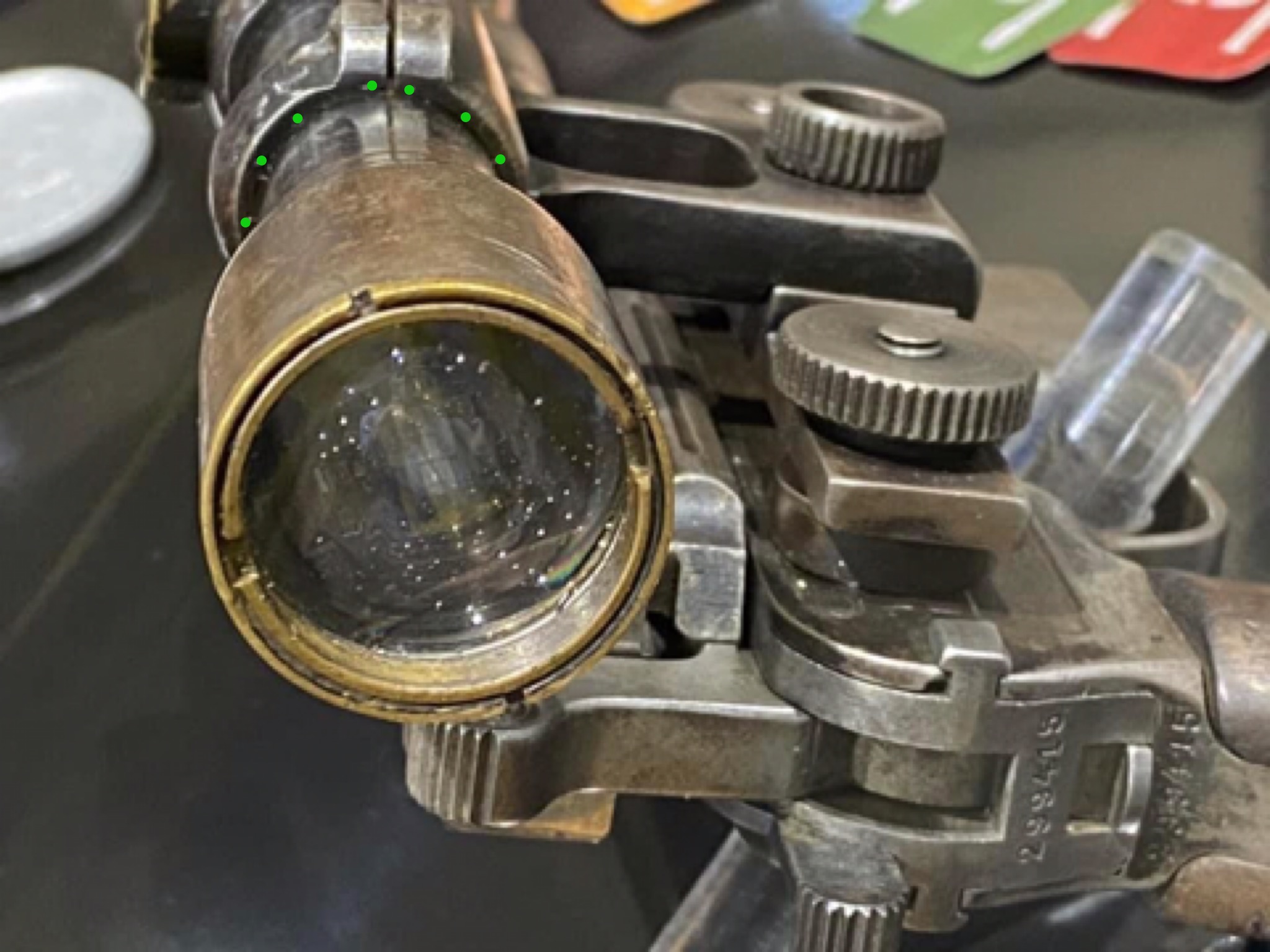

The PS mount cradle is actually shorter up and down on the ends and tapered rather than straight. This "could be" from filing off rusted material from the original OR simply remade a bit different.

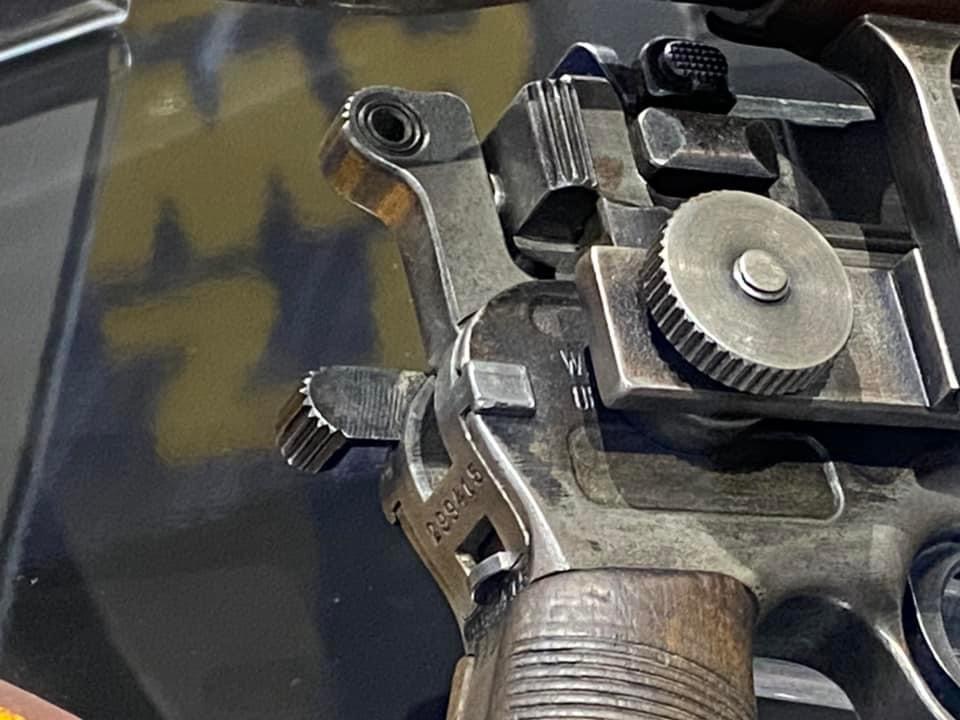

The lower ears:
The RIGHT ear is close to the hero in general shape. The tool gouge to the left is similar but not exact.
The LEFT ear seems wider than the HERO to my eye. Could be lighting but... (wish we had a sharper HERO image.)
There is a "wave" like pattern between the rings on the HERO. Could have been filed off due to rust.
The screw holes are an issue IMO. The PS threads are larger and more defined. Could have been re-tapped due to rust.
Overall the PS mount is taller. The center Square hole is longer.
The verticals on the PS are more abrupt and have a step where it connects to the cradle.
The section below the cradle does not line up with the upper as on the HERO. Could be the angle, but the rings line up perfectly so...
The entire surface is re-worked. It looks nice but if it was the HERO mount it has been altered by the restoration so much it may as well be new.
There should have been photos taken of the mount before and during the restoration which would have provided proof that the original HERO mount was under there.
For my money, IF Tony wanted a million for this prop he should have maintained as much of the original as possible and documented the restoration to confirm. And even tho the HERO mount was "complicated" Duplicating the original form is job one in a restoration. The fact that they decided to NOT duplicate the dovetail mount suggests to me that the rest of it is new as well. The rear shapes have issues as well but "could be" explained if it was reworked and reshaped.
The question is, exactly where could he or would he have cut off the old and added new? What could have been salvaged? Seems to me that if the dovetail was "mangled" the thinner verticals would have been rusted away as well. So at the bottom of the cradle? The "hollow" under the center is not there. There is a gouge, likely from a mill, but no hollow.
Did Karl cut off the cradle, smooth it all by hand and weld on a new lower section and verticals? Maybe. Very hard to tell but it would require a lot of secondary shaping.
If they didn't want to recreate the dovetail area because it was too complicated and too much work... then cutting off areas, cleaning them, making matching parts to weld to and rework to look like ne piece seems like MORE work than just machining a new part.
Karl could confirm all these question.

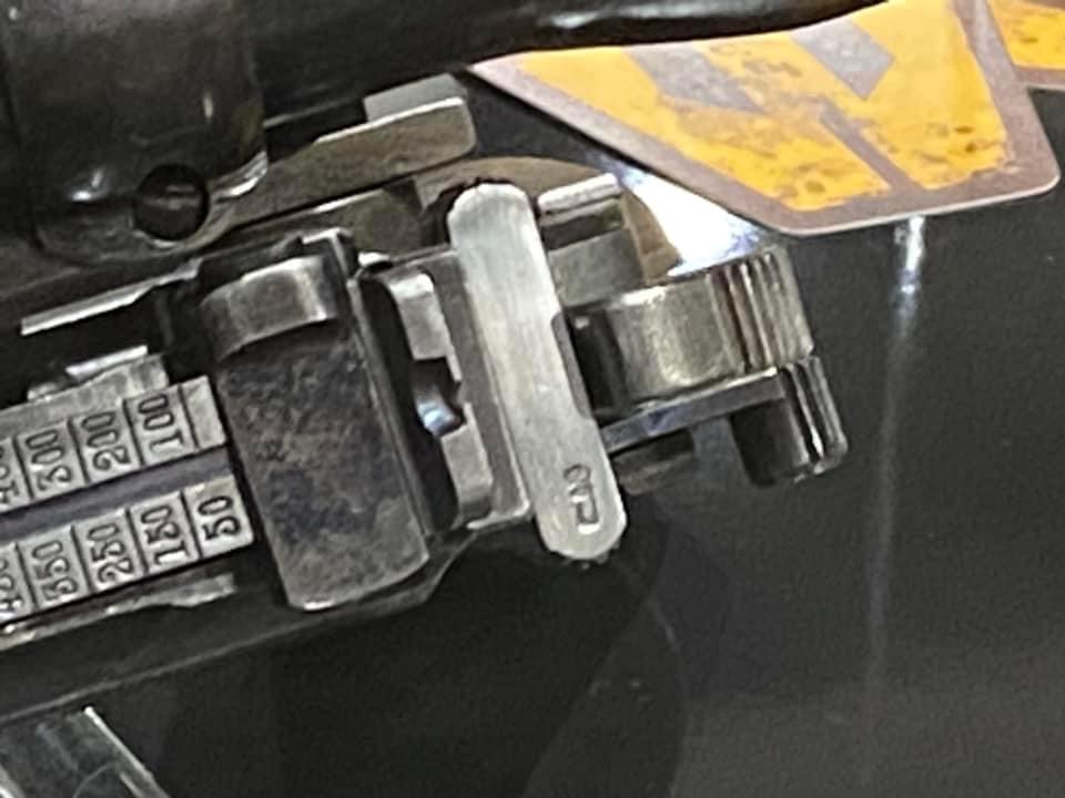

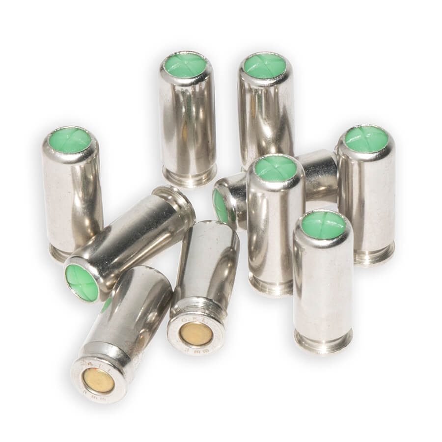

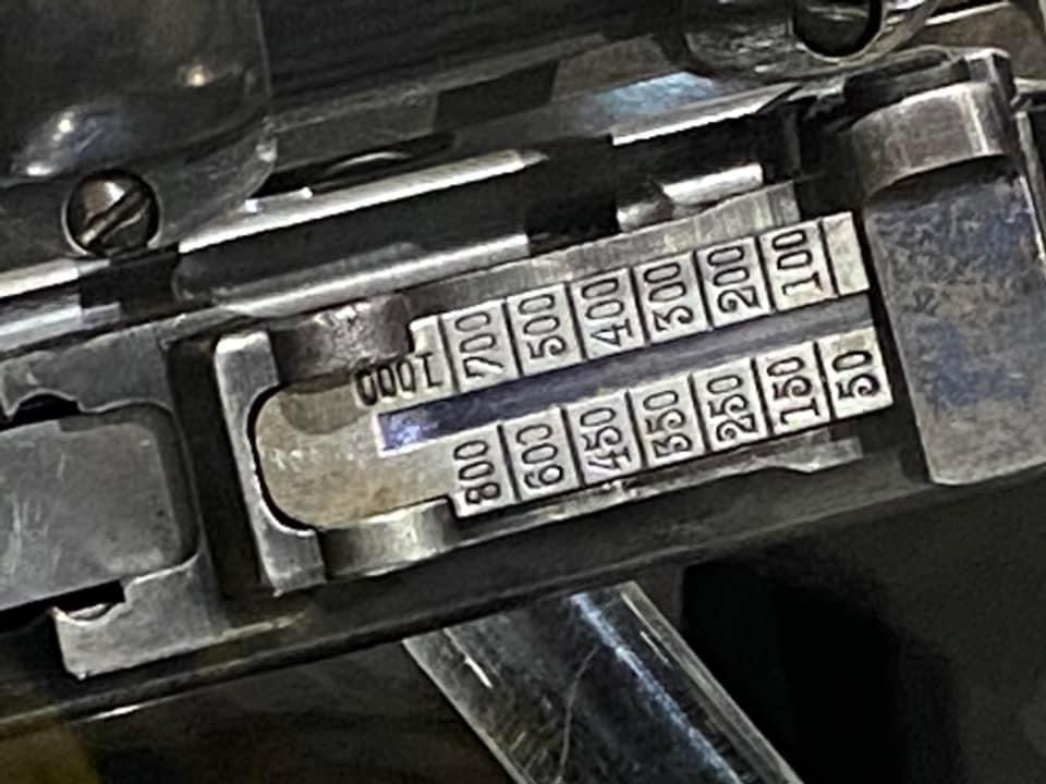

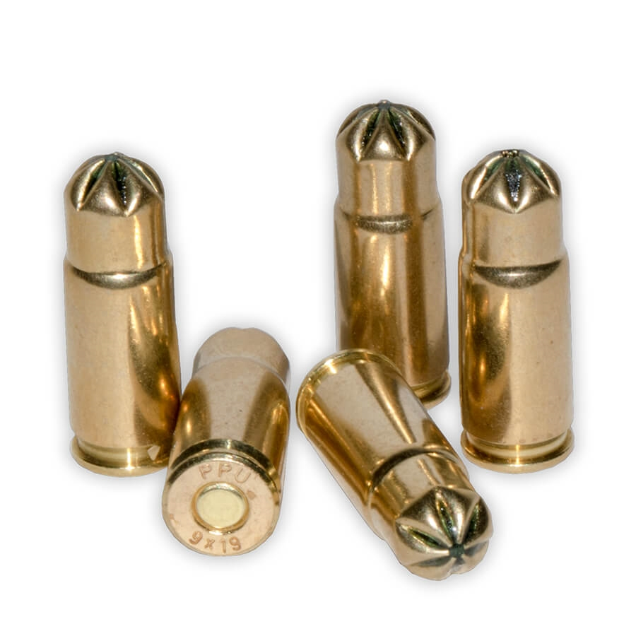

Another question I'd like clarification on is "caliber"
Tony in his letter said the PS was 9mm black fire.
Both the HERO and PS have 1000 meter sights which usually go with 7.63 while 500 meter sights go for 9mm. Sights could have been changed but why.
My guess is that the chambers are cut back and shortened for 9mm blanks? May not even need to be shortned for blanks IDK. I wish Karl could tell us. Like .45 acp the case may be held by the extractor. I have never found a case to seat on the edge of the case.
Straight walled semi-auto handgun cartridges (.45ACP, 9mm, etc.) headspace on the mouth (front) of the casing. At least in live-fire guns. I don't expect it would change for blank firing guns, except those that use a specific, blank-only chambering. The barrel restriction is typically to create enough backpressure (with no projectile) to cycle the action.
This is generally true... They are "supposed to" seat on the case mouth. Ideally. At least that is the design.
They are straight walled but tapered cases. The 9mm more so than the .45

Movie blanks don't have sharp edged case mouths to seat on. And probably have a lot of slop built in to function dirty. In reloading for straight wall auto, reloading books suggest no crimp or slightly tapered crimp to maintain the case mouth but the blanks have a huge crimp and rolled shoulders so...
I think all things play a part but the tapered wall and extractor likely play a bigger role than the case mouth. You will find heated debate on the subject no doubt. ; )
Also why a .380 will fire in a 9mm. Wont function or cycle 100% great but will go bang...

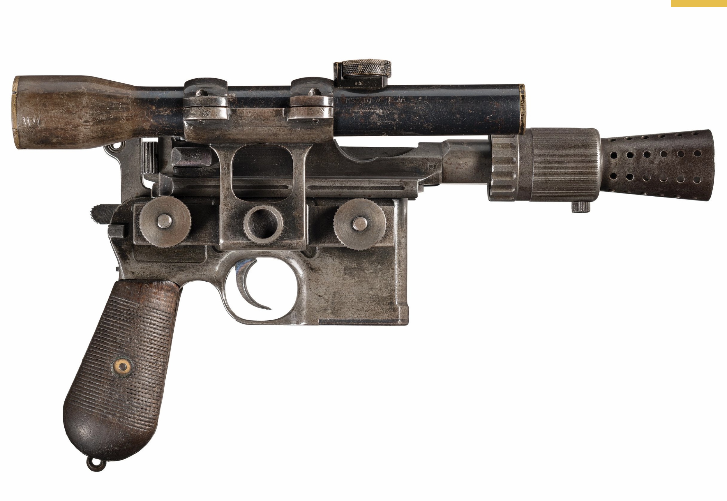

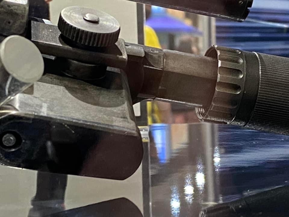

Going off of what Kpax said, I took a second look at the mount. My current belief is that they ground off a LOT of material.... cut the vertical portion out of flat metal stock, and welded/brazed it into place. I see a very obvious joint here of two pieces... maybe the remnants of the center curve.
Could be.
But look at the rear angle image. The way the uprights have to curve and blend into the cradle round shape.
Those rounded shapes would need to match up to braze.
Even if the verticals were cut straight. Not an easy match.
The surface is so rough. So many spots that look like an area that could have been joined.
Either way. It has been altered so much it just isn’t original anymore.

It's relatively common for people to "re-sleeve" a C96 to 9mm chambering without swapping the sight leaf (because the sight ramp profile of the upper is different anyway, and would be too difficult to change.)
