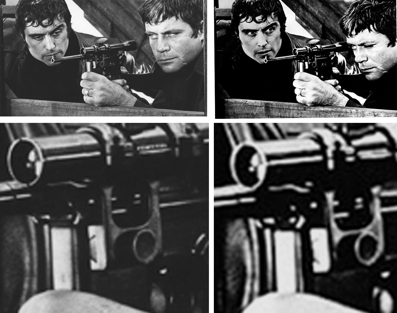

Oh that's brilliant! I see it, and the spot in the middle coming from the thumb nut i hadn't even thought of. very well done
My point earlier was - have you lined up the same info on the color pre-production photo? the part poking out in that photo looks larger than the post photos you beautifully lined up for me!

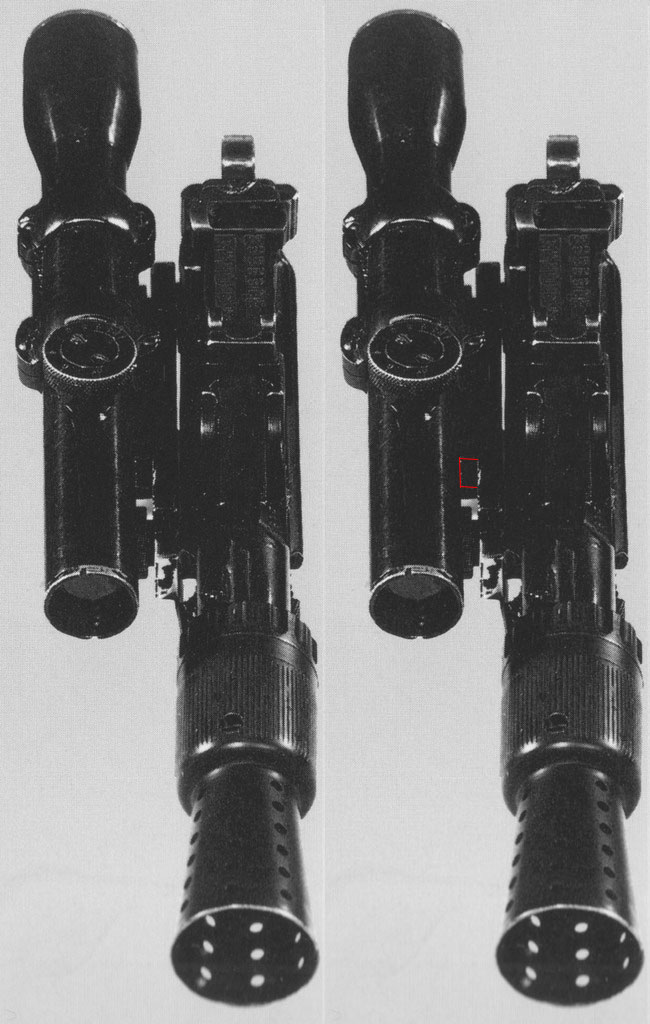

Have a look...

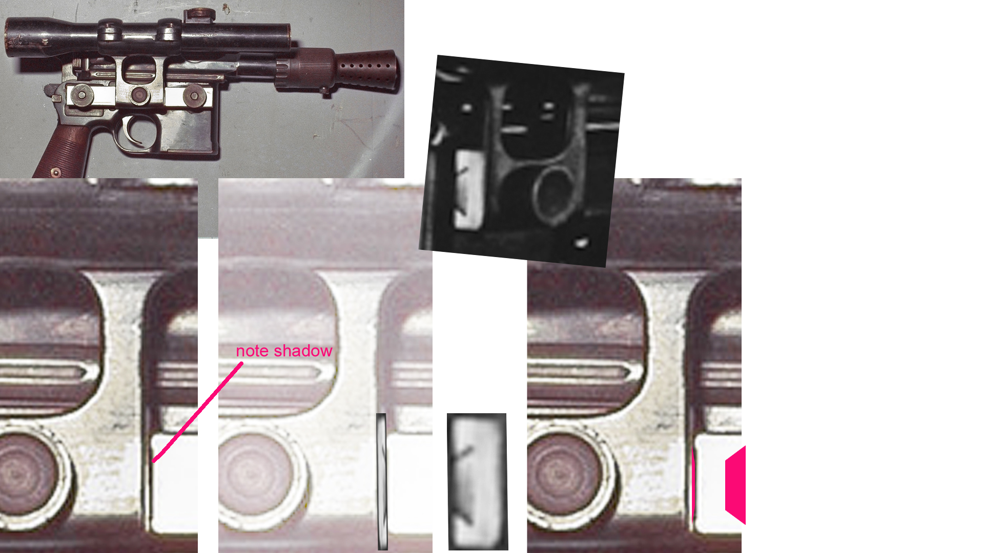

I scaled the mount image from Sitting Target and then skewed the dovetail shape to the approximate angle shown in the pre production image.
You can see the slight shadow of the dovetail shape and size on the crossbar once the position is located by the overlay.

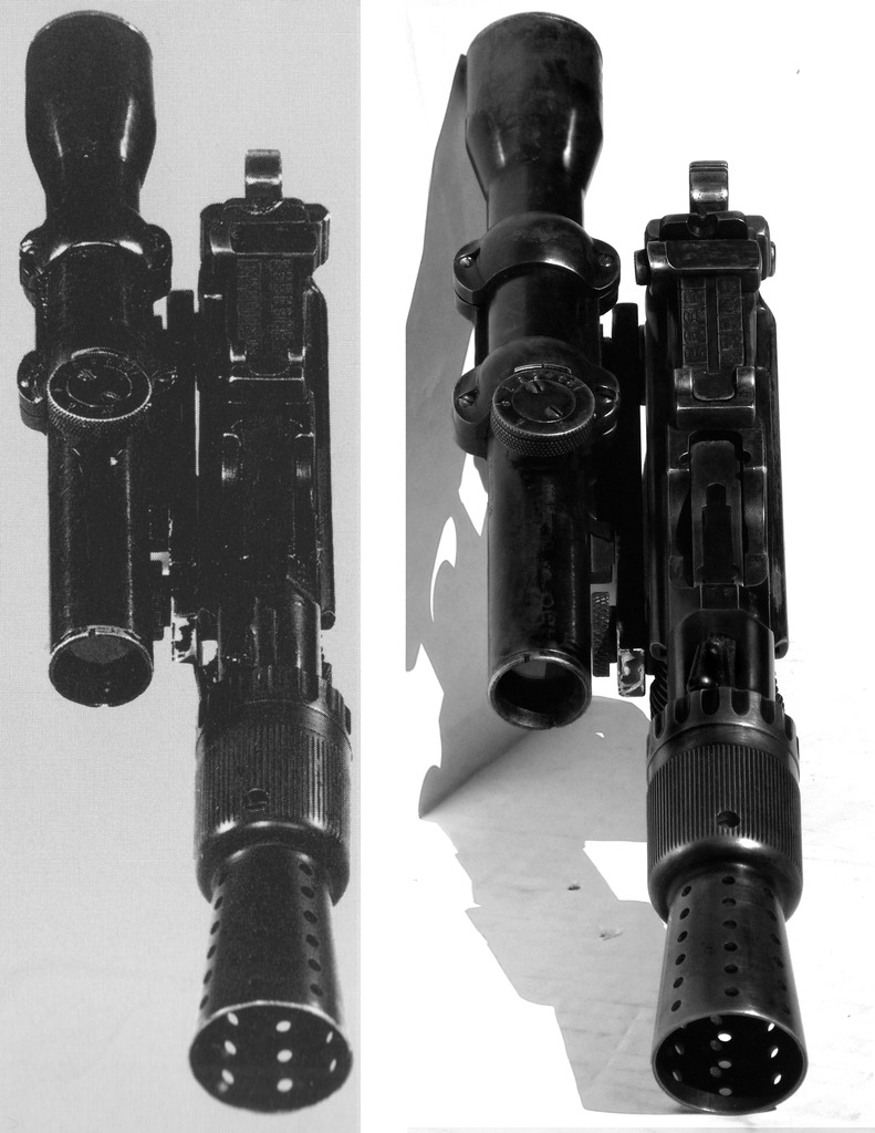

Call me crazy, but that clear dovetail shape looks smaller than the metal poking out from behind the mount in the photos above. I mean, the "pre-production" shot looks closer to this fake and the B&W I can see the smaller dovetail block.
I agree. Is that the best photo there is to prove that there is a dovetail on the HS Hero blaster? Because I don't think those extremely faint lines make that shape at all. This is what I see:
It may look like that but IMO it is only the lighting. I believe better hi res images exist but they are not available on the web.
There would be zero reason to mill off the dovetail and make a square when doing so would weaken the attachment. Firing even blanks puts enormous stress and torque on the heavy scope and mount. Milling a dovetail insert shape is just as easy.
We can not ignore the Sitting Target detail showing the dovetail clearly.
The scrapes and gouges on the aluminum crossbar (as per my previous posts) would not -could not exist if the mount had a squared pocket as you suggest since the mount could simply be removed perpendicular to the crossbar with NO horizontal sliding needed. Hence no gouging.
The mount MUST be slid off the dovetail which causes the gouges...if not careful. Empirical proof IMHO.

This image shows evidence where the dovetail scraped off the paint on the crossbar, sometime during or after the production of SW. Also, the obvious differences in all of the other parts, including the Mauser, make it that much more unlikely for that to be the original mount. Despite the other obvious differences in that particular mount. (No undercut on the cradle at the topside of the 'square' center cutout for a basic example)
Also, Pat (kpax) has already screen-matched both the scope and mount to Sitting Target many years ago in the blaster thread..unfortunately photobucket kinda ruined a lot of our photo proofs and such, but it was already covered that the mount that was previously used in Sitting Target was indeed the one used in Star Wars, which most likely would have had the dovetail present, no evidence whatsoever suggesting otherwise.
So, simply not the original mount in any way you can figure it, period. Nothing matches nearly close enough to think it's the same mount.

In fact, the fake is so good that they replicated scratches, dents, machining marks, and even the misaligned threaded holes beneath the rings. That's why I'm giving the mount a second chance - we really don't know what the other back-ups looked like, if they did make any
I just saw that the scope dial and front lens retainer are in the same position from ST to SW (using Todd's trace from a couple posts up)
I agree with Deadbolt. There was a bunch of proof marks showing the ST and ANH mount was the same ONE mount.
That image Carson posted highlights the tilted FH. I'd love to know "exactly" how Karl mounted it and what the deal was with the muzzle restrictor.

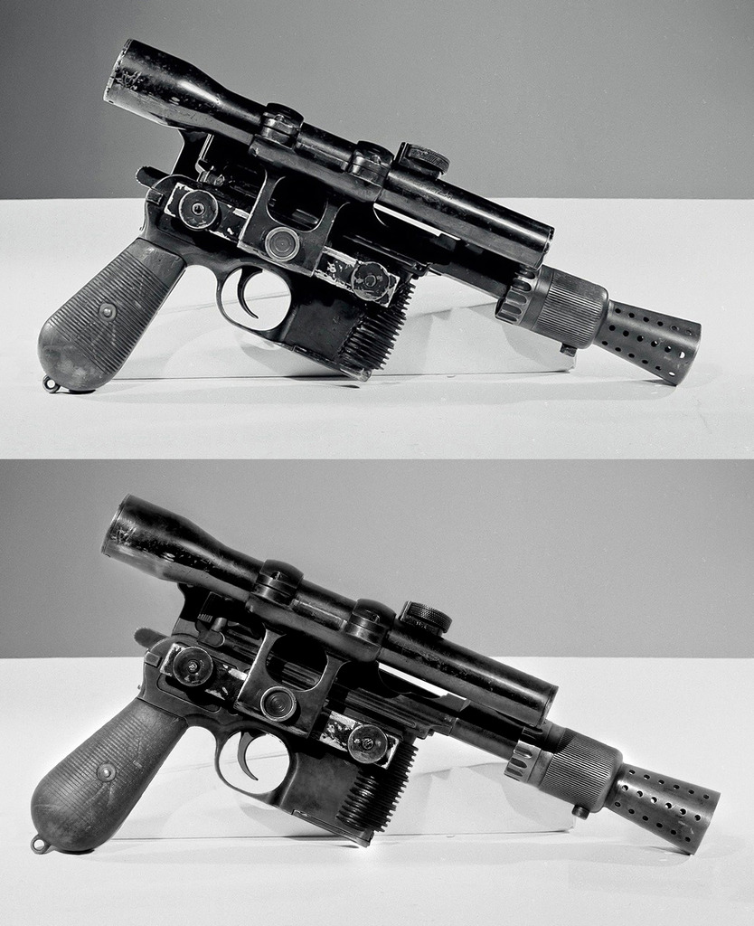

Which one is the real HERO blaster.?
And I wasn't even "trying" very hard to fool anyone...

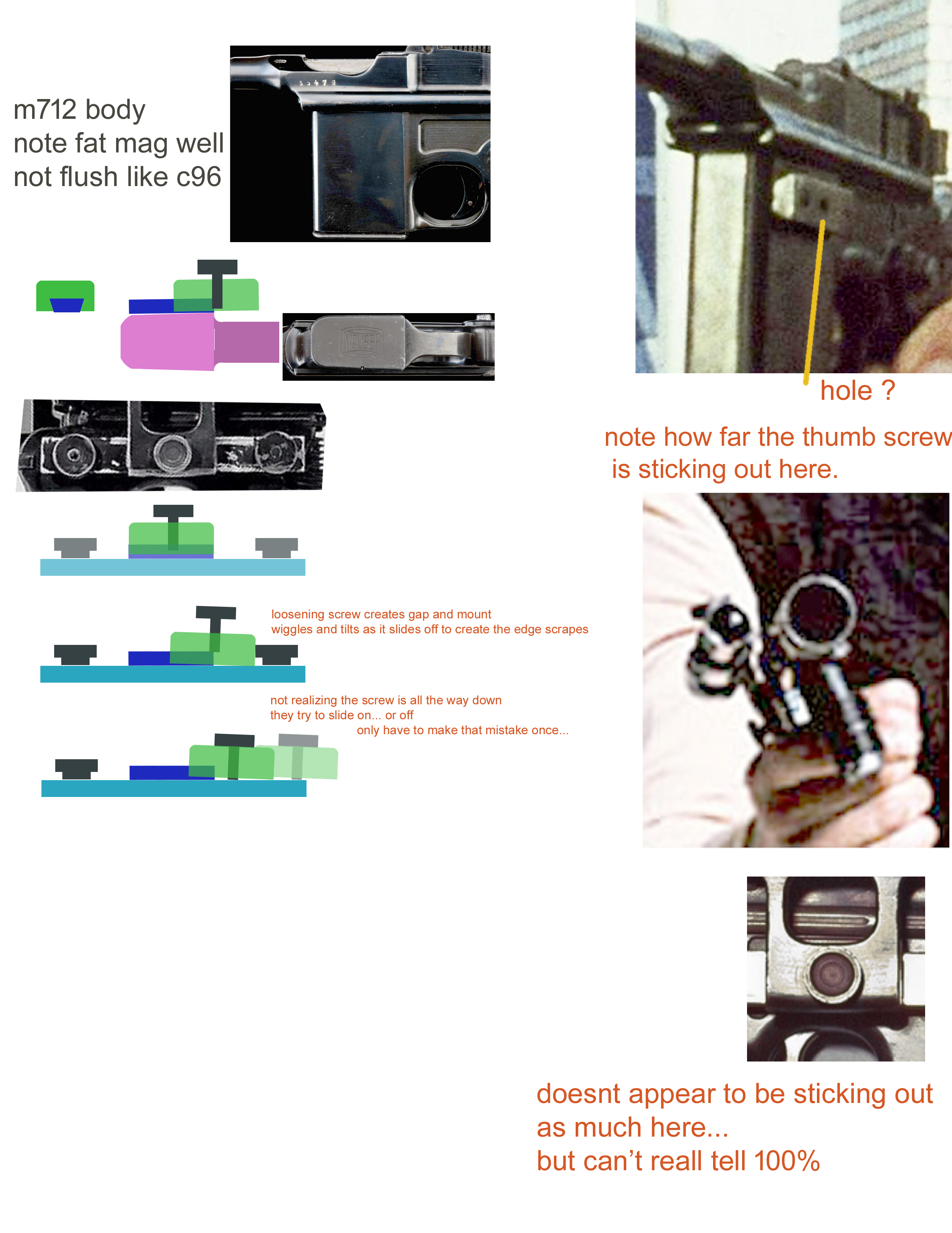

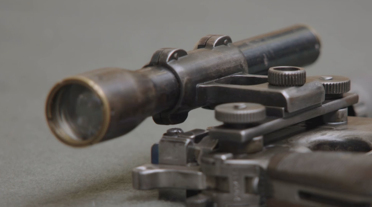

Here is a visual that may help.
First. The ST Mauser, you now agree HAS the same dovetail. Good. ; )
The mount does not scratch the ST Mauser for several reasons.
1) The Sitting Target Mauser is a model M712, which differs from the c96 in many ways including the "raised box" magazine well. See pic
This m712 mag box is the same width as the dovetail and mount suggesting it was made for this gun and this film...otherwise the size is a fantastic coincidence. I could be wrong but I believe this is the first appearance of this mount in film.
Since the mag box is raised off the body and the dovetail extends to the edges the mount can be guided onto the dovetail without contacting the body as it slide over the dovetail... The dovetail acts as a guide.
2) The Mauser body is steel and does not scratch as easily as soft aluminum.
The actual thumbscrew length is unknown. It was never shown being fully removed. Reed turns it twice to tighten then there is a film/cut and he turns it again.
The thumb screw tightens the mount to the dovetail by pulling it up slightly against the angles taking out the slack. When loosened, there is a bit of slop and wobble clearance to allow the mount to slip off but this also allows the mount to tilt and make contact with the soft painted aluminum crossbar as you wiggle it off the dovetail. If there was sufficient slop between the two parts it would allow the mount to drop against the crossbar quite a bit causing the scrapes.
All you really only have to do is try and take the mount off the dovetail without removing the outer thumb nuts. The contact points and scrapes for the outer edge damage/scrapes are very obvious. The scrapes stop at the thumb nut on the right end. I figure they then realized they had to remove the nut and slid it the rest of the way off.
Since we do not know exactly how the original was made or how long the thumbscrew actually was,- it is impossible to know this part 100%. With a little imagination and visualization the center marks can be explained by accidentally screwing the thumbscrew too far in while off the gun, playing with it or screwing it in too far in the wrong location and fumbling with it to get the mount off. With all the damage done to this prop in other areas I don't find this explanation unreasonable.
The dovetail part in ST can be seen to have two end attachments. The center "hole" looks deeper than a typical detant. see image. I am assuming it was a deeper hole for this conversation. When milling parts like this, at that time, they would likely have drilled and tapped 3 thru holes. No blind taps.
I also believe the thumbscrew may have been longer and went deeper into the dovetail for better hold. The Dovetail on the SW blaster crossbar was likely custom made and not the dovetail from ST. The ST dovetail may have been brazed on pins or bolts. I think this likely and would have been too much trouble to remove.
I figure they made a custom dovetail and crossbar and possibly used a different thumbscrew.
Why do I think the thumbscrew was longer than assumed for a "set screw" ? There are several images that seem to show the thumbscrew at different lengths. Sticking out more or less at different times. The thumbscrew only needs to go into the dovetail a little bit to be long enough for this theory to work. See image.
The center crossbar markings would be hard to explain rationally if the screw was not long enough to contact the bar. When putting the mount back on, all that needs to be done... by accident, is to have tightened/lowered the thumbscrew enough to contact the crossbar. These would be odd marks to put in purposely and difficult to do as a weathering effect which typically wears on edges... but I suppose the center marks could have been caused by misalignment of the mount or other mishandling. But the subject of this conversation is really if there was a dovetail on the SW blaster or was it like the newly found fake!?
Even if you want to doubt the cause of the center marks there is no doubt that the other markings were made by the mount sliding over the dovetail. I believe this is a rational and reasonable explanation for the markings. Again, Try it yourself. If the tolerances are the same you will get the same scrapes. I did!
We are all just trying to figure out details and throwing theories around for fun. This is what I settled on until more info comes out.
