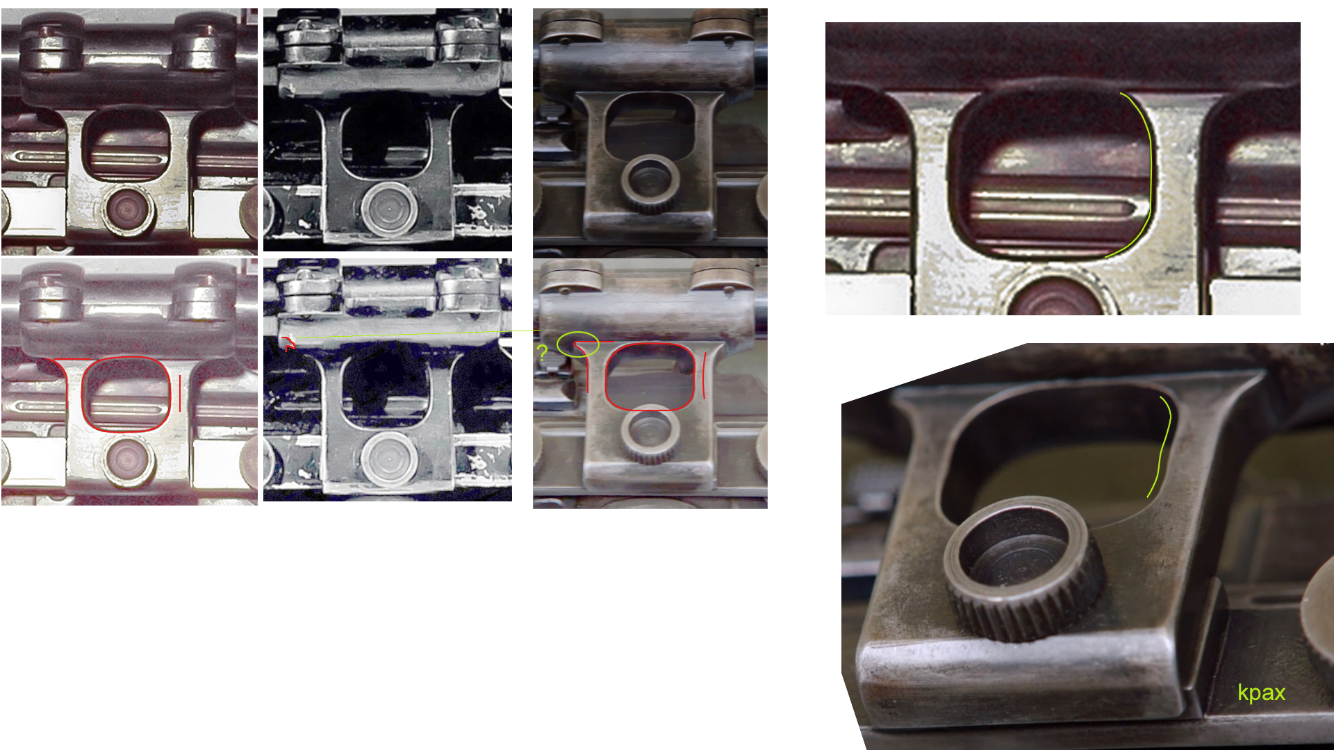

The scope: I agree with Scott. It's the scope, no question. It's has a lot more handling and the scrapes aren't bright and shiny anymore, but I'm convinced.
The bracket: Check this out:
I see 7 matches there, despite how dull and dark the metal is now and how little finish it has left on it. I think most authenticators would call that a match.
  1. The dovetail doesn't match the one in "Sitting Target". True.
    • Is there any proof that the exact same bracket was used in both films?
    • Is there any proof that the dovetail wasn't modified for use in SW?
    • Is there any proof that the blaster in SW had a dovetail other than it's similarity to the bracket seen in ST?
    • If this bracket was war surplus (like the rest of the prop) isn't it plausible that Bapty might have had many similar brackets, perhaps with HW scopes mounted in them?
I have a lot more questions about this prop, but they will have to wait for later. For now, let me just say I'm about 80% convinced this is the scope bracket in the reference photos (who knows what actually ended up on film?) As far as the mounting hardware... IDK. Not so convinced.
  • The dovetail doesn't match the one in "Sitting Target". True.
    • Is there any proof that the blaster in SW had a dovetail other than it's similarity to the bracket seen in ST? There is a SW promo image that shows the dovetail is the same. New computer so I can't post right now. Also, as Scott can attest, a non-dovetail connection will not stay on very well... even with blanks.
    • If this bracket was war surplus (like the rest of the prop) isn't it plausible that Bapty might have had many similar brackets, perhaps with HW scopes mounted in them? No other similar mount has ever been found as far as I know. I even contacted Mauser at one point as well as antique arms experts. They have never seen a mount like this either. If it was actually war surplus I imagine there would be a bunch out there. Never say never but not yet anyway.

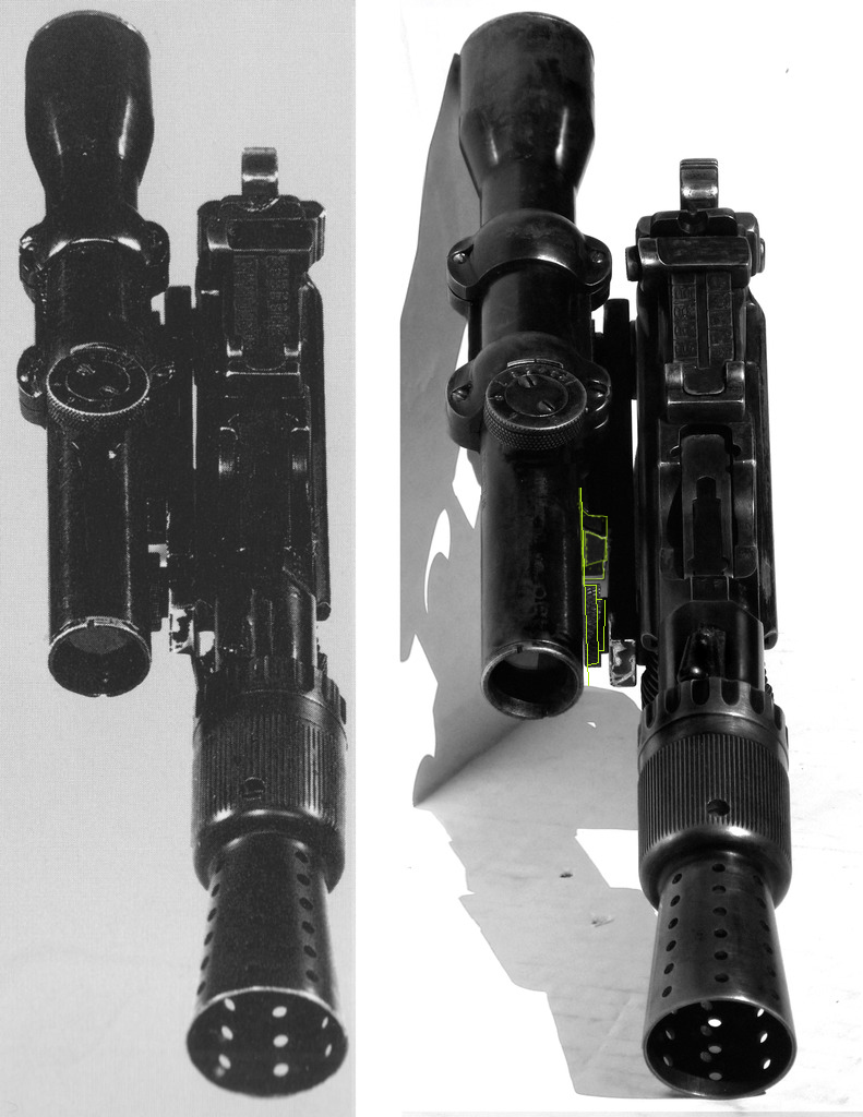

  • I do not think the mount is the original. The indicators you point out are not a match to my eye tho not inspecting it in person I could be wrong... but don't think so. It is missing some clear markings that the pre and post production images share.
  • 1) the hollow cut under the cradle that brushes the under scope barrel.
  • 2) The semi-circular gouge to the left of the thumb knob, likely due to pliers being used to loosen or tighten the knob at some point. Likely to originally get it off the Sitting target gun is my guess.
  • 3) The thumb knob turnings in the center share a distinct shape and pattern that the pawn stars lacks IMO.
  • Close but no cigar.
Two points: First, the two original images don't reveal all of the same markings, so it does not surprise me that some marks do not show in the video, especially after all these years. Second, one mark shows clearly in ALL THREE PHOTOS - the horizontal mark running the full length of the cradle tube, right under the tabs. It's the same mark. Also, the grinding marks between the tabs are the same in all three photos.
That's the hardest to explain. Is what I see in that one original profile photo really a cut, or a reflection? I've gone back and forth over the years, and I've made them both ways because sometimes I see it one way and sometimes the other way. So, I'm really on the fence about that one. If someone's got a really clear picture of the underside of the bracket, I'd love to see it.
I don't trust photos that much. I could tell you stories about customers on my site that ask me to make their item like "the one in the second photo, not like the third" and they won't believe me when I tell them the pictures are of the same exact item. They'll argue with me. Really. Sometimes pictures are very deceiving.
That one doesn't bother me. It's quite possible that it has faded to the point it doesn't show in the photos. A close up inspection might reveal it in the right light.
I don't think that's the same thumb screw. The knurl is very pronounced on the Pawn Stars gun, and should be easily seen if it were in the original photos. Also, it is much deeper and thicker than the original. Perhaps if they did use the mount and scope for ROTJ, they paired it with different hardware? At any rate, it didn't get put back together with the same screw.

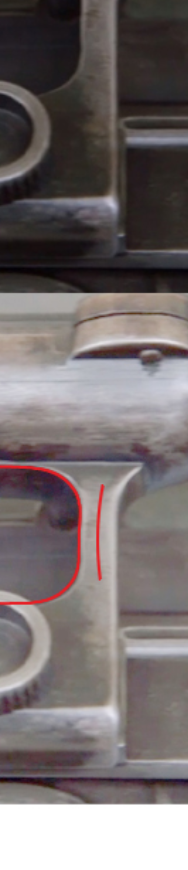

I do not believe Bapty had two mounts. I think they simply made a new one OR more likely bought a repro mount. I believe the mount is made more like the first reproductions from MR.
I did check with several very big antique arms collectors and historical experts and they had never seen a mount like this. If they did have 2 mounts they sure keep it secrete all these years. I know several people contacted Bapty over the many years and asked about the blaster.
To my eye and experience, the horizontal marks and indicative of any machine marks and as you point out, the photo angles and exposure can trick the eye. I try to find more pronounced marking to compare like the hollow area, knob gouge and missing dent on the left tube area.
In addition, note the shape of the squarecle opening. The real mount has even parallel straights but the Pawn mount has a hump pushing in on the right side. To be sure I show 2 angles to be certain it was not a shadow.
The vertical supports are also different. Note the top area where they transition to the scope tube barrel. The real mount blens smoothly with very little "step" but the Pawn version has a distinct STEP.
The Mauser is not original. The mount is not original. The prop lacks the grill or even the glue remnants and the mystery disk area is not even there.

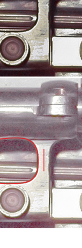

I'm very curious too. Scott, like you said, the tooling marks are quite similar but not all the way there. My ideas:
1.) A stripped, sanded, cleaned mount that lost details. I even see 2 dings - on the upper edge of the left scope ring top and scope cradle bottom ring that line up.
2.) Scott's idea that there were multiples made by bapty, machined the same way, leading to the similar bull barrel and mount. (Hell, maybe the continuity photo is of one of the "seconds" and not the hero itself)
3.) What if the dovetail was milled off for some reason. The pre-production photo shows the same amount of metal poking out behind the right side of the mount (where the dovetail would be).
For the Pre-production photo: is that the profile of a dovetail poking out?
