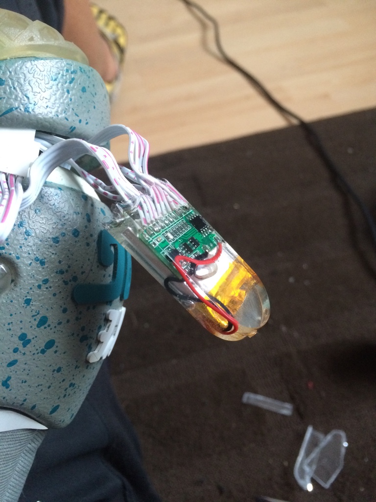

Well, the batteries are not gonna get replaced as far as I can see.
The battery and circuit board are incased in a plastic block
Those are 2nd gen HC. I got a pair of those that have been sitting upstairs in the box. The ones I could never get the toe unglued. I should check them.
That's a bummer about the battery encasing. You could consider upgrading all the electronics to EL lights or something since you're already opening the shoe. There is also the possibility of replacing the electronics with glow-in-the-dark parts.
Just depends on how far you want to get into it.
Which is why those of us that did electrical upgrades replaced everything. You can't use the factory wiring here.
