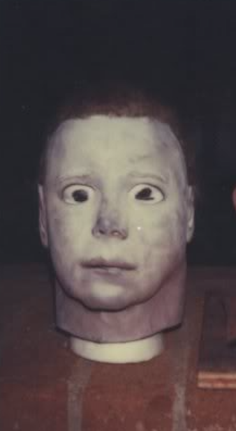

The original mask, for those that don’t know, was made by taking a 1975 Captain Kirk mask by Don Post Studios, removing the sideburns and eyebrows, cutting the eyes larger, spraying it “fish belly” white, and misting the hair with Streak-n-Tips. The hero mask was used in Halloween, and then the same mask was used again in Halloween 2. The masks paint had tarnished quite severely, the black had come out of the hair, leaving it more of a dirty brown.

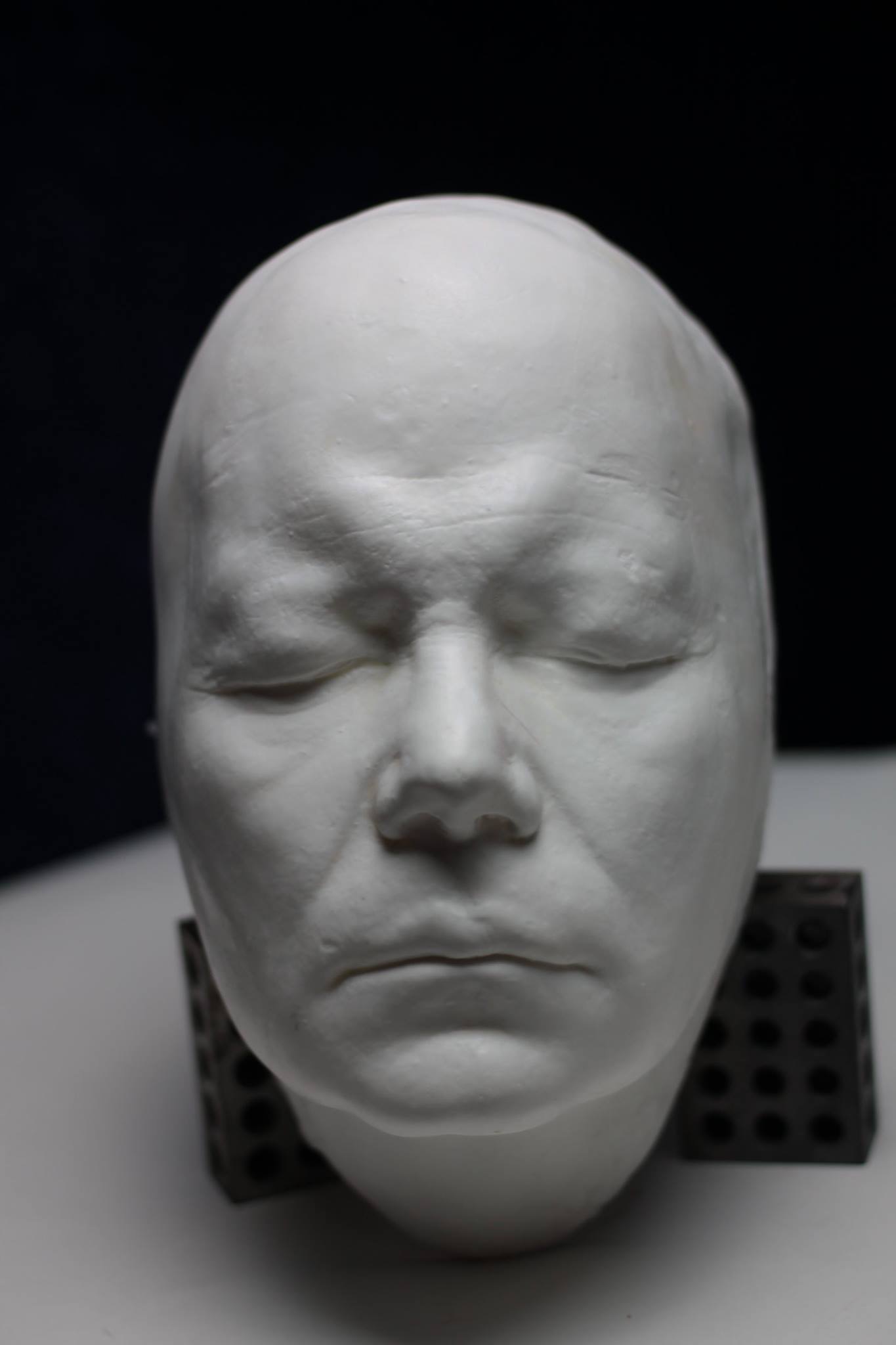

To start my sculpture, I did exactly what Don Post Studios did to make their Captain Kirk. I used a lifecast of William Shatner! Bill Malone is the artist who made the original Kirk mask. Taking the very lifecast this one is cast from and opening the eyes, adding ears and the rest of the head. He also made some strange choices regarding the likeness. Heavily altering the cheeks, and resculpting the lips mainly.

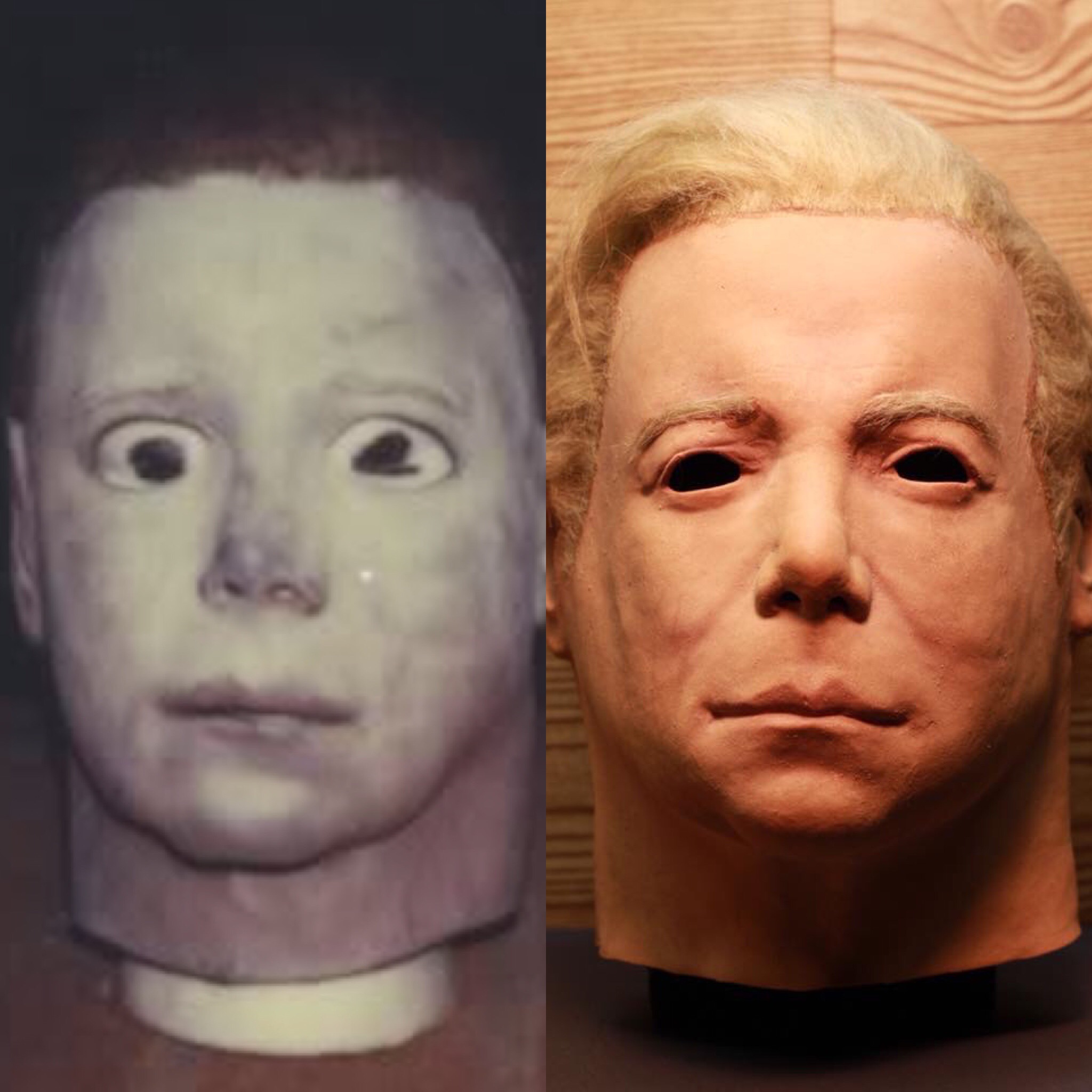

So you think, great, job done! Clay press it, open the eyes, make a Kirk, and call it done..... well, not quite in this case. I didn’t want to replicate a mint 75 Kirk. That has already been done to perfection. I wanted to approach this as more of a portrait sculpture of the hero Myers mask. Adding each and every little surface imperfection and flaw in the pull I could see in reference.
800E3F22-B8F2-4C9B-9233-ED9A39444489.png ABBDAD1D-BFE0-4740-BE1F-002BF1EA6950.jpeg

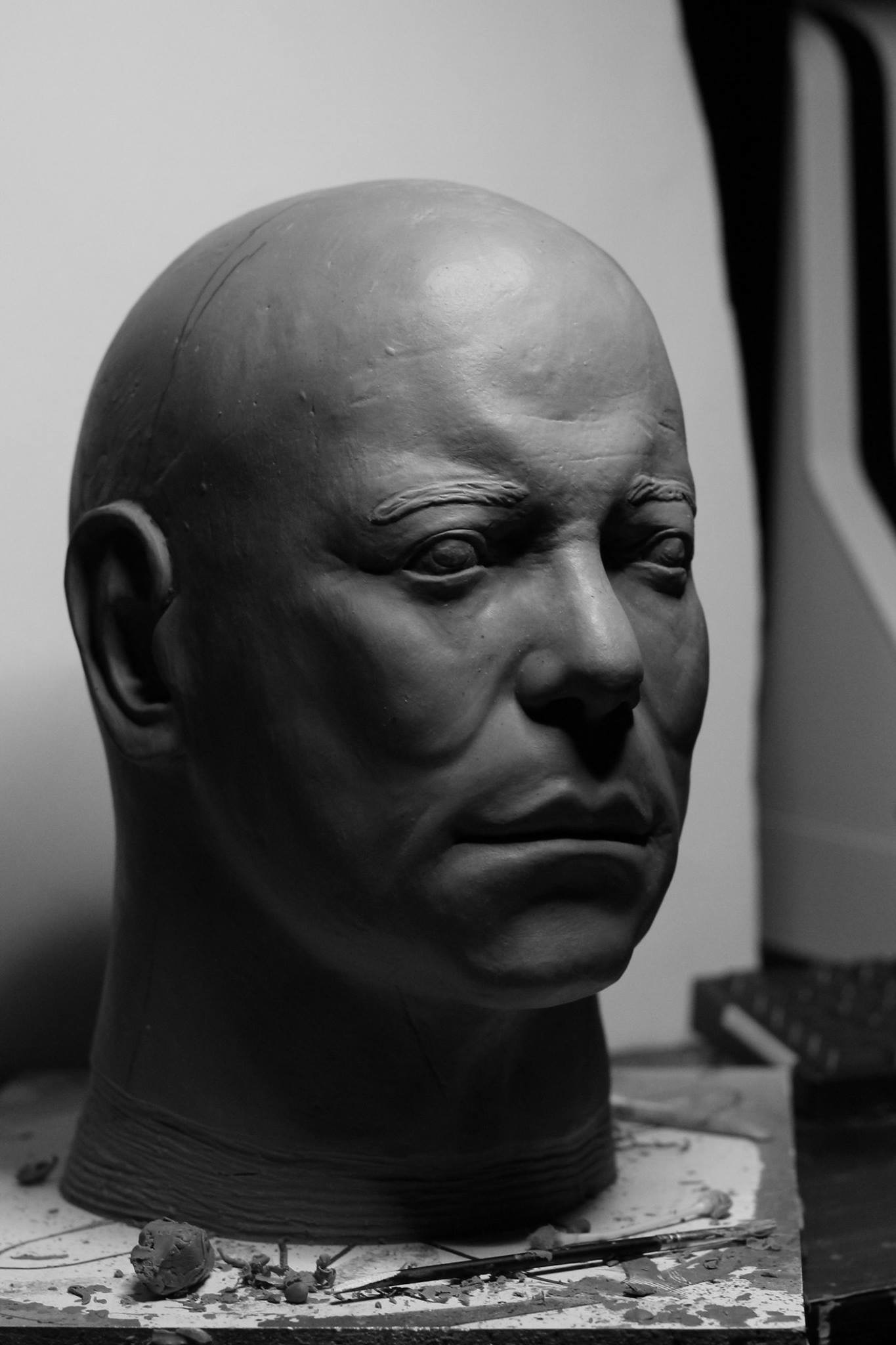

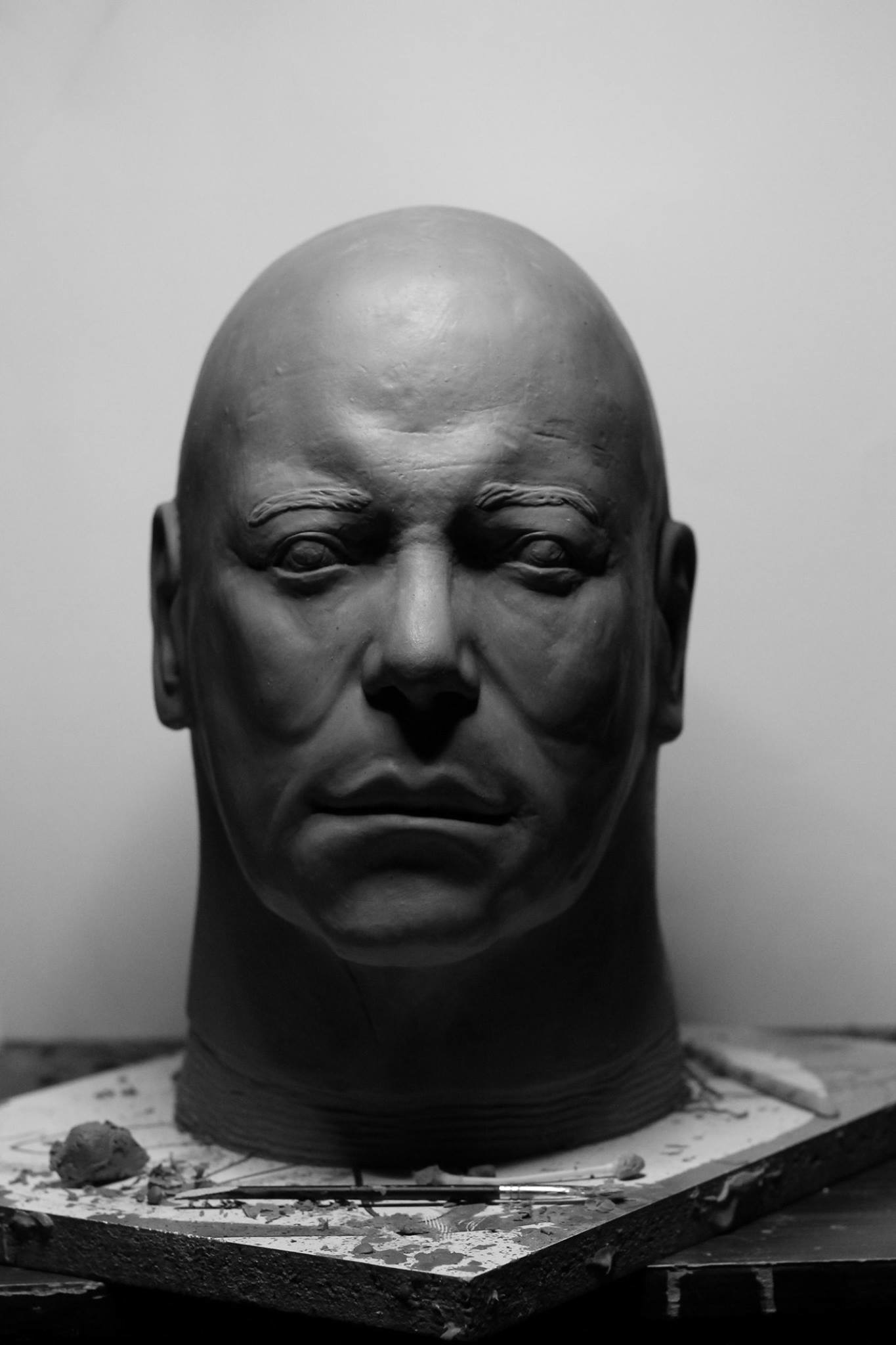

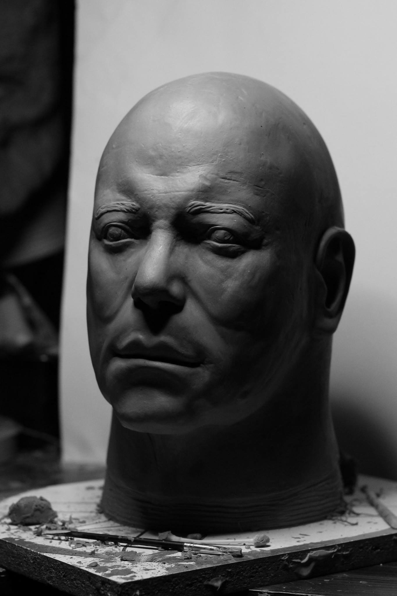

When I look at the reference, I also see a mask that is heavily distorted from use. The nose and chin in particular are sagging under their weight. This is an effect that mint Kirk replicas never capture, as today’s latex just doesn’t stretch and stay there like 70’s “claytex.” If we compare it to a mint Kirk replica I think what I’m saying becomes super clear. I set out to replicate THAT mask. To me? THE mask. I had my goal set, all that was left was to claypress the Shatner lifecast and start sculpting! Countless hours over the next seven days and I ended up with a sculpture I was happy with. I worked on it all the way up until it was under stone so I don’t have “finished” sculpture pics but here are some in progress ones!
790FED37-E32F-43EA-8254-3FAD703B7F35.jpeg7F0EC222-9B6A-44B0-A524-BAD1E68526C2.jpeg15E98191-901C-4D4A-8FE0-3485FA4F066C.jpeg

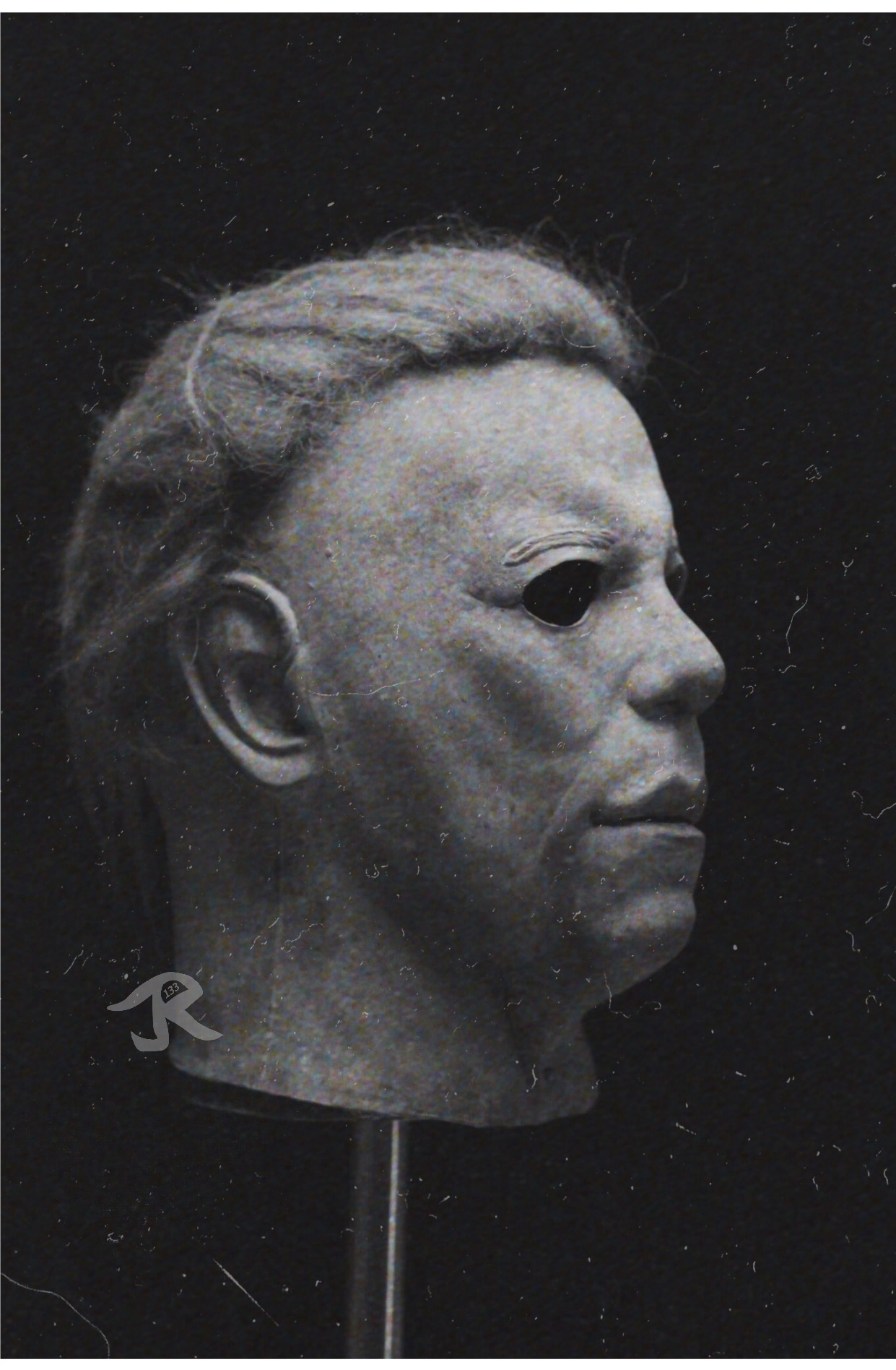

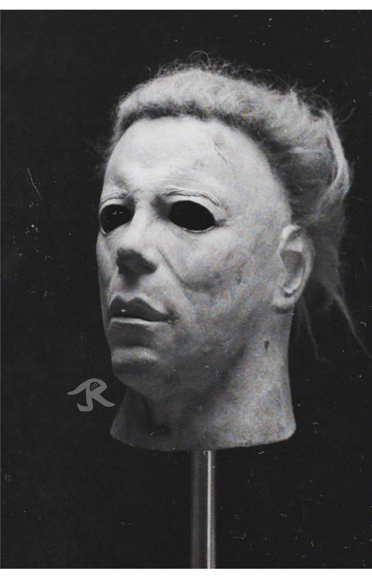

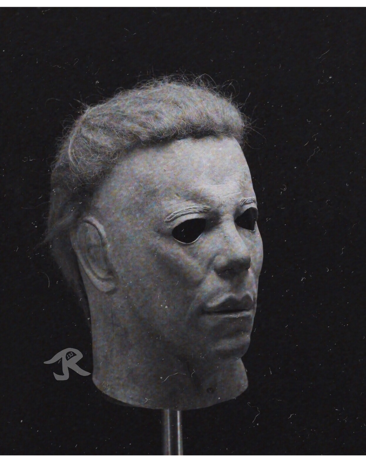

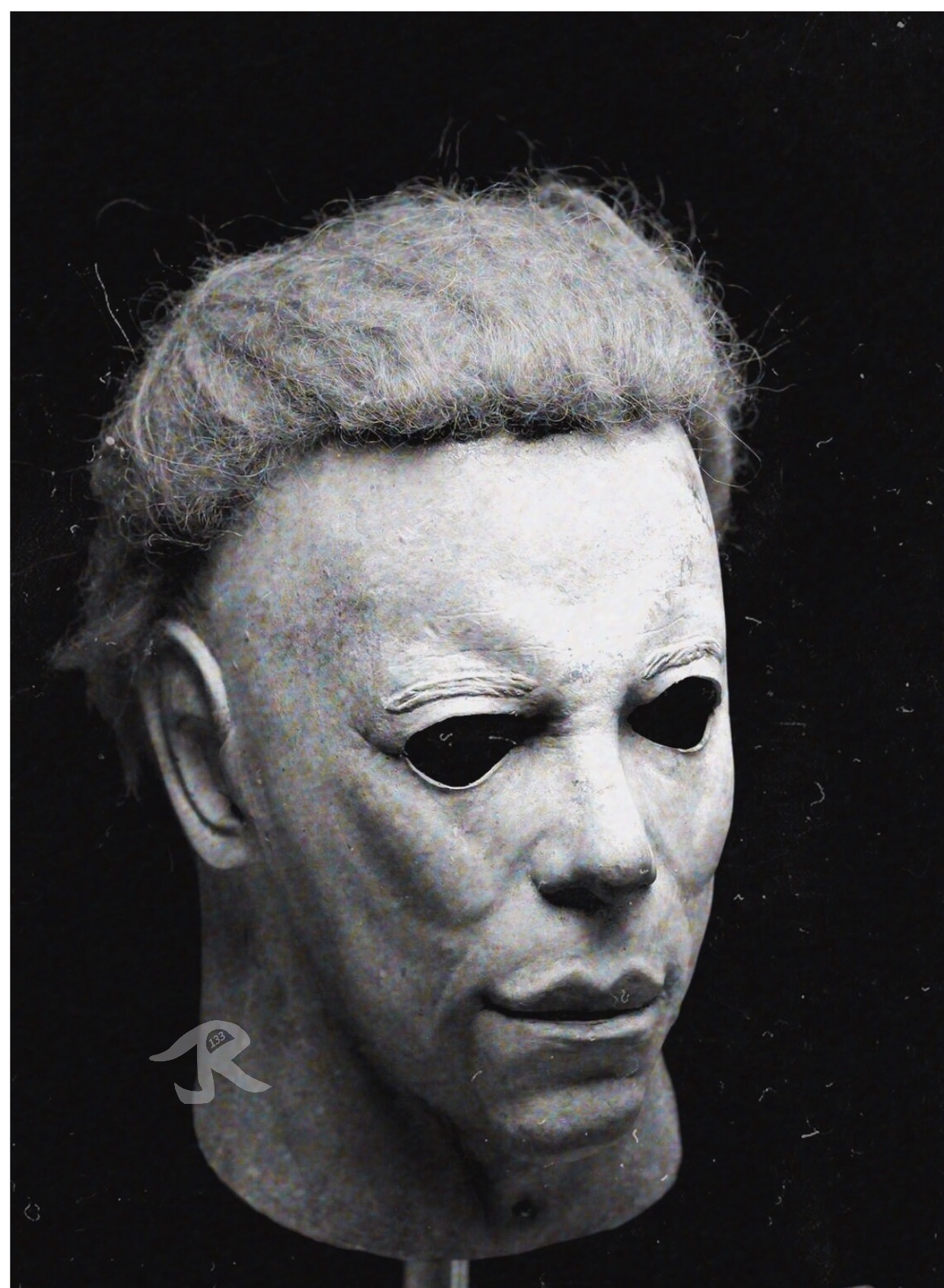

Here is the first copy in a few different lighting settings, and stuffed to match the famous “Warlock Stretch.” There is some stuff I want to change on the next copy, I messed the eyecuts up a little, want to weather it a little differently, etc. It’s impossible to catch lightning in a bottle, but I did my best! This is exactly how I see the Hero in Halloween II, and a side from some small changes I’d like to make to the sculpt at some point, I’m very, very happy!
View attachment 837843View attachment 837851View attachment 837850View attachment 837849View attachment 837848View attachment 837847View attachment 837846View attachment 837845View attachment 837844
