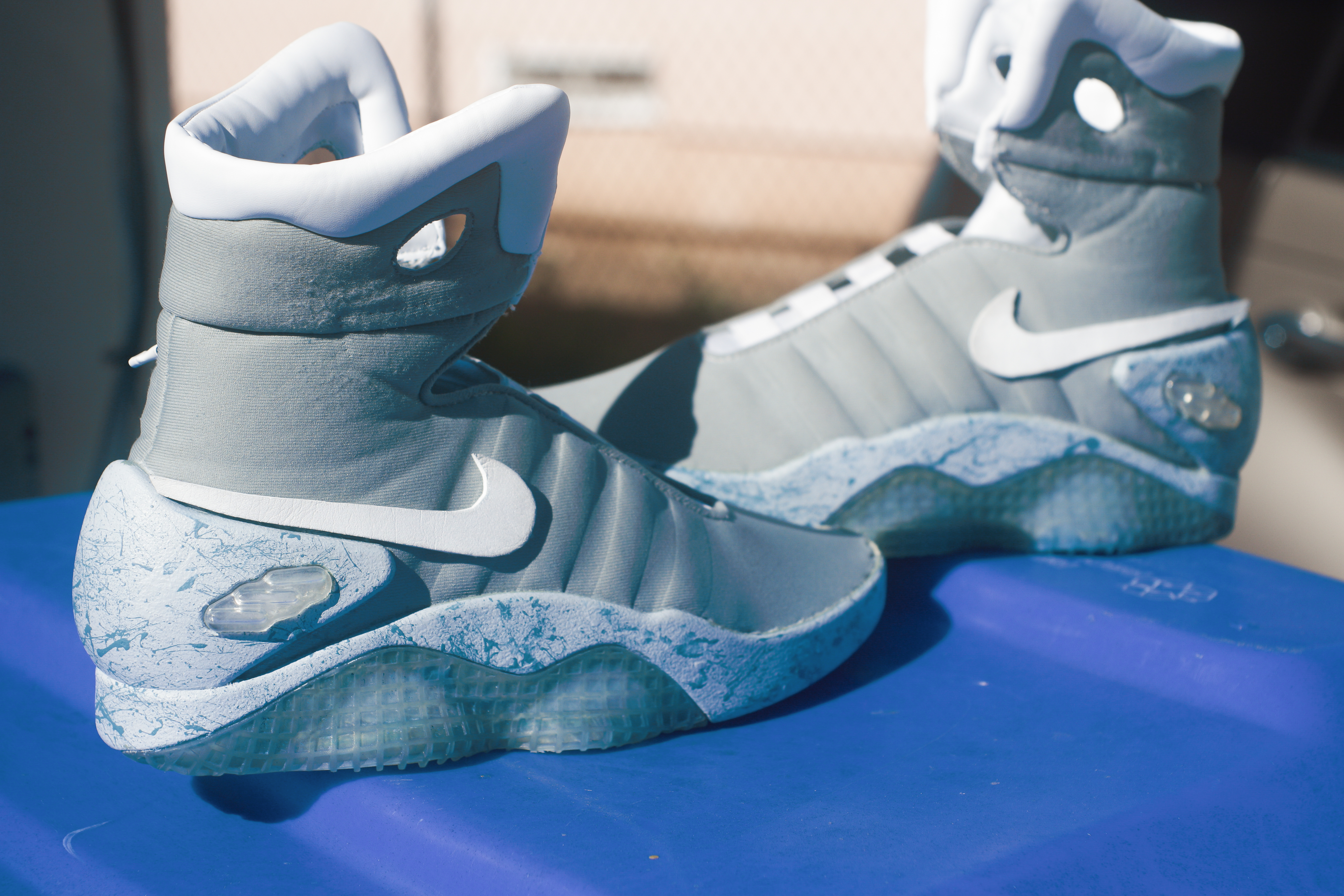

Painted the soles the right grey color and did some new splatter I really like how they turned out now I just need my
glow stuff to arrive so I can start working on some test for the sole lights and the strap

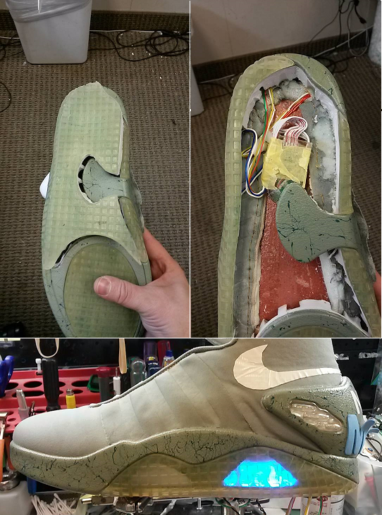

Personally, I'm fine with how the toes look, but those bulging laceways got to go, IMO. I haven't seen the vid yet on how to do that, so I ended up actually peeling the fabric back and scraping all the extra foam out. Now I just need a way to glue it back on the upper that won't bleed through or discolor it.
Do you have any in progress shots from that process? I'd love to get a look inside the sides of these shoes.
-Nick
-Nick

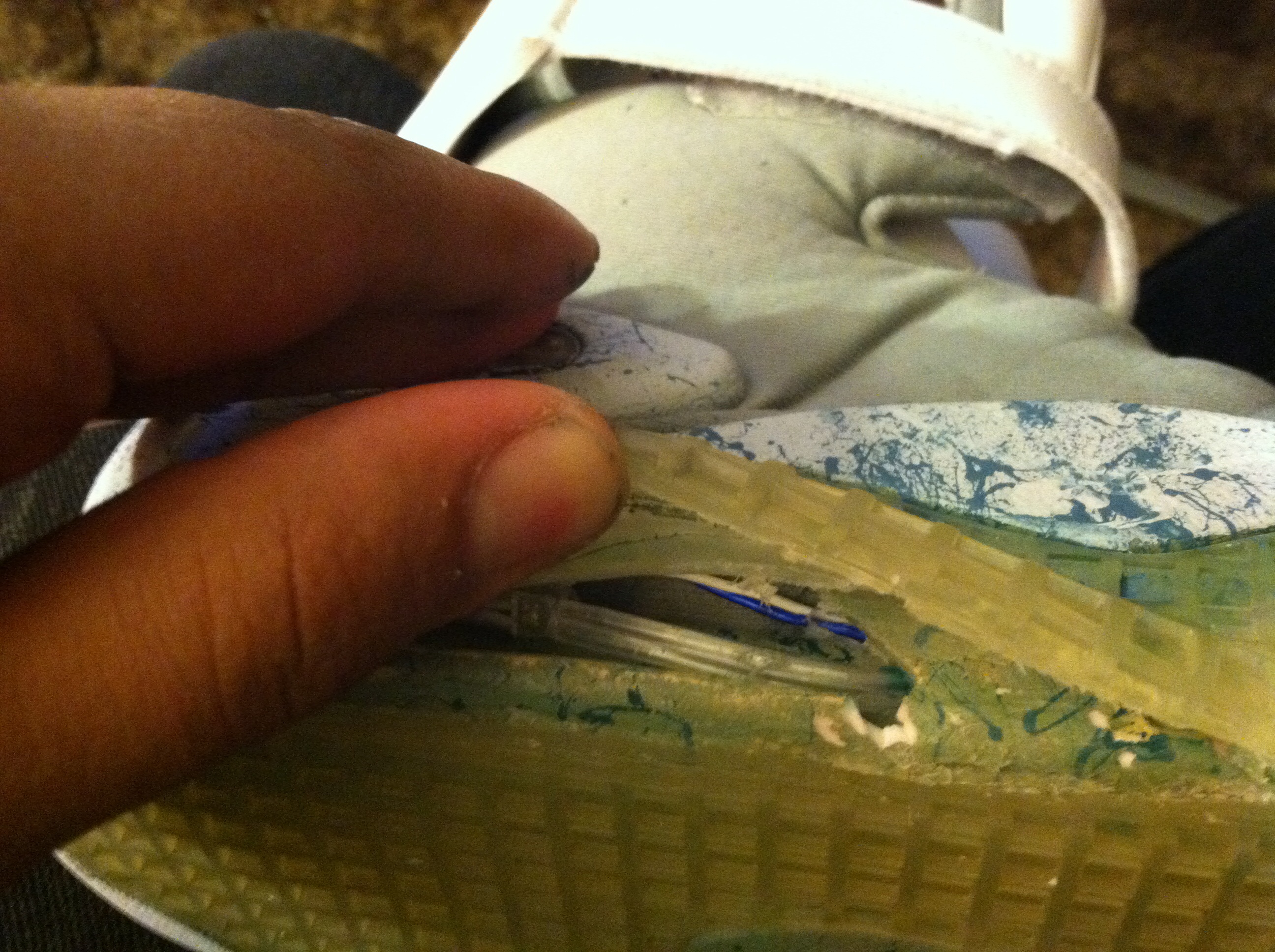

Here's a shot of my shoe when I peeled the side up one with the led off one with it on and the third pic is the electronics you can easily get to them by peeling up the insole the little re light also let's you know when they're charging these have the same electronics as the Chinese v2s

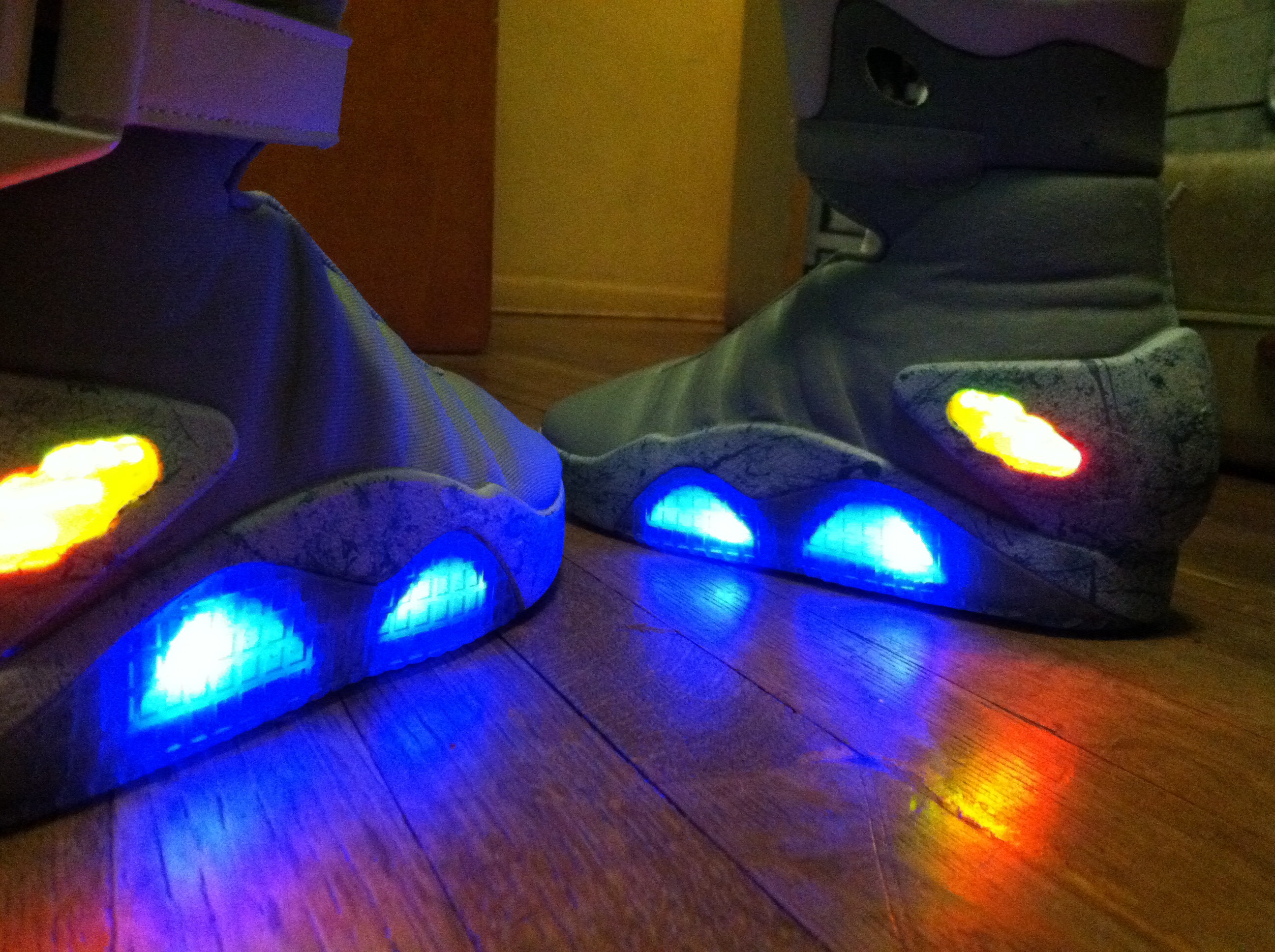

I put some diffusion in my sole so my LEDs look a lot better and have an actual shape instead of just the led wore showing through
Yes, I've looked into that, but didn't have anything that would properly disperse the light evenly throughout like I wanted.

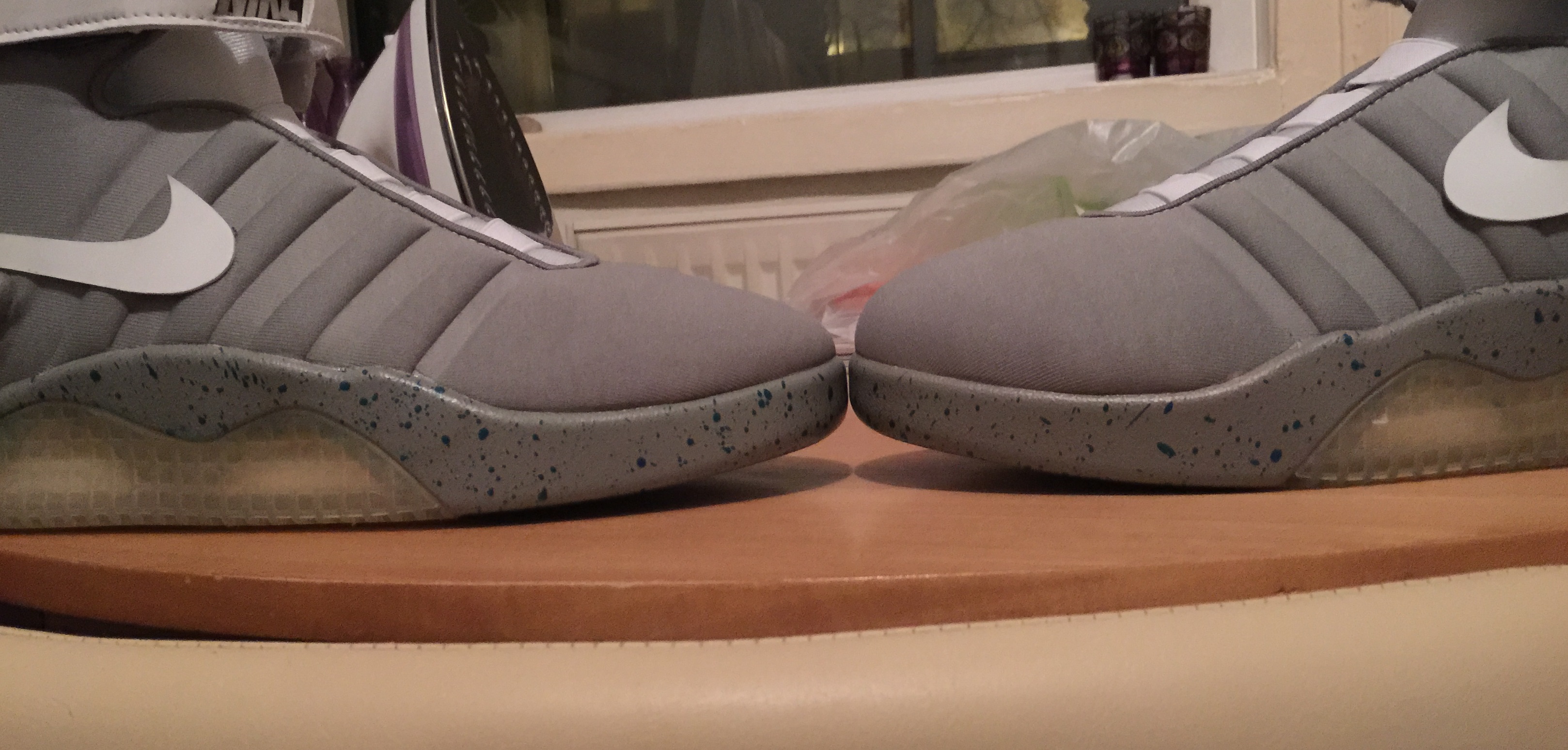

Ok so, i have already done the Markpoon Mods and just did the toe slim, left shoe didn't go as far as the right but still made a huge difference.... I urge you all to do this steaming method! works great!

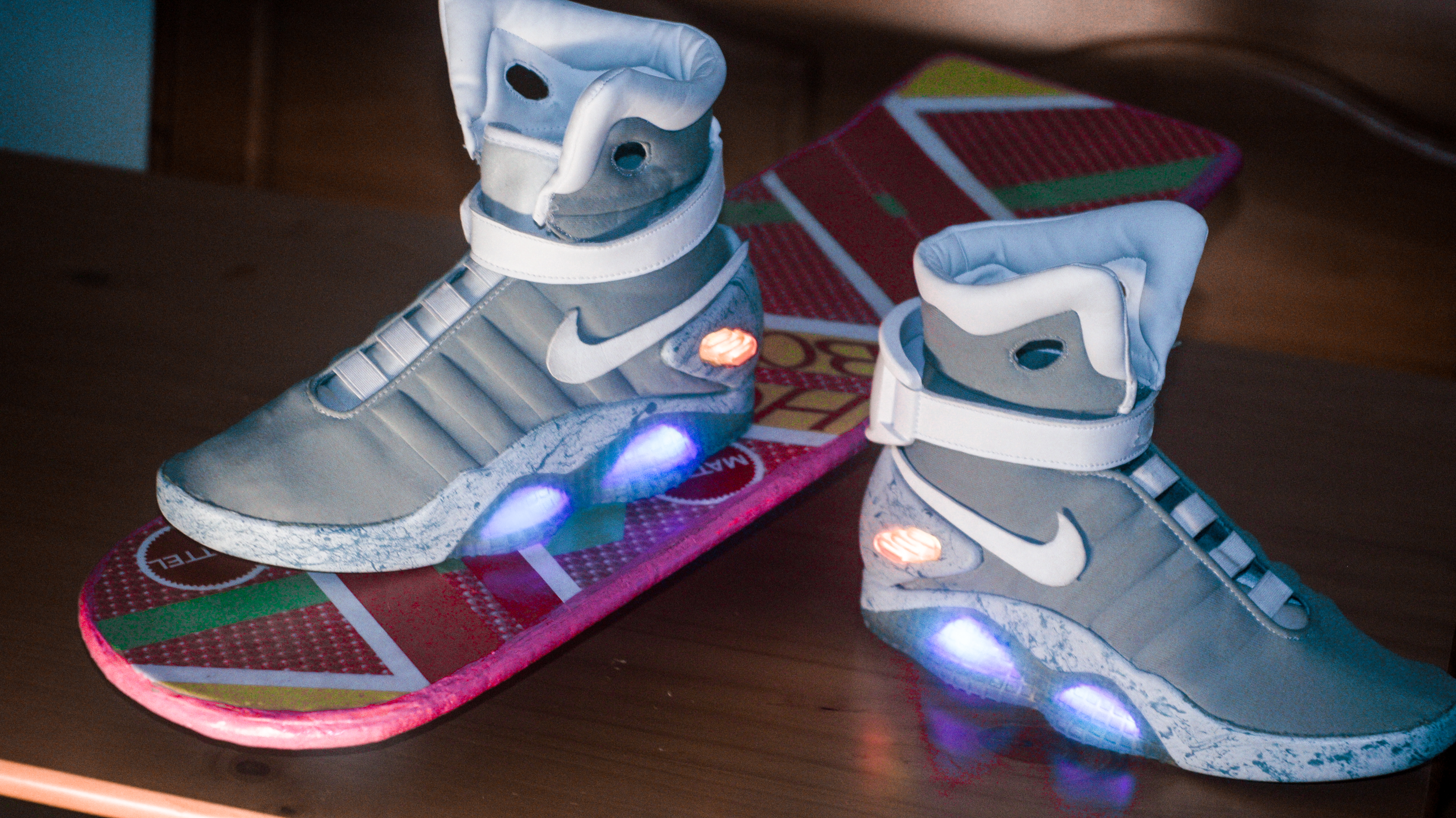

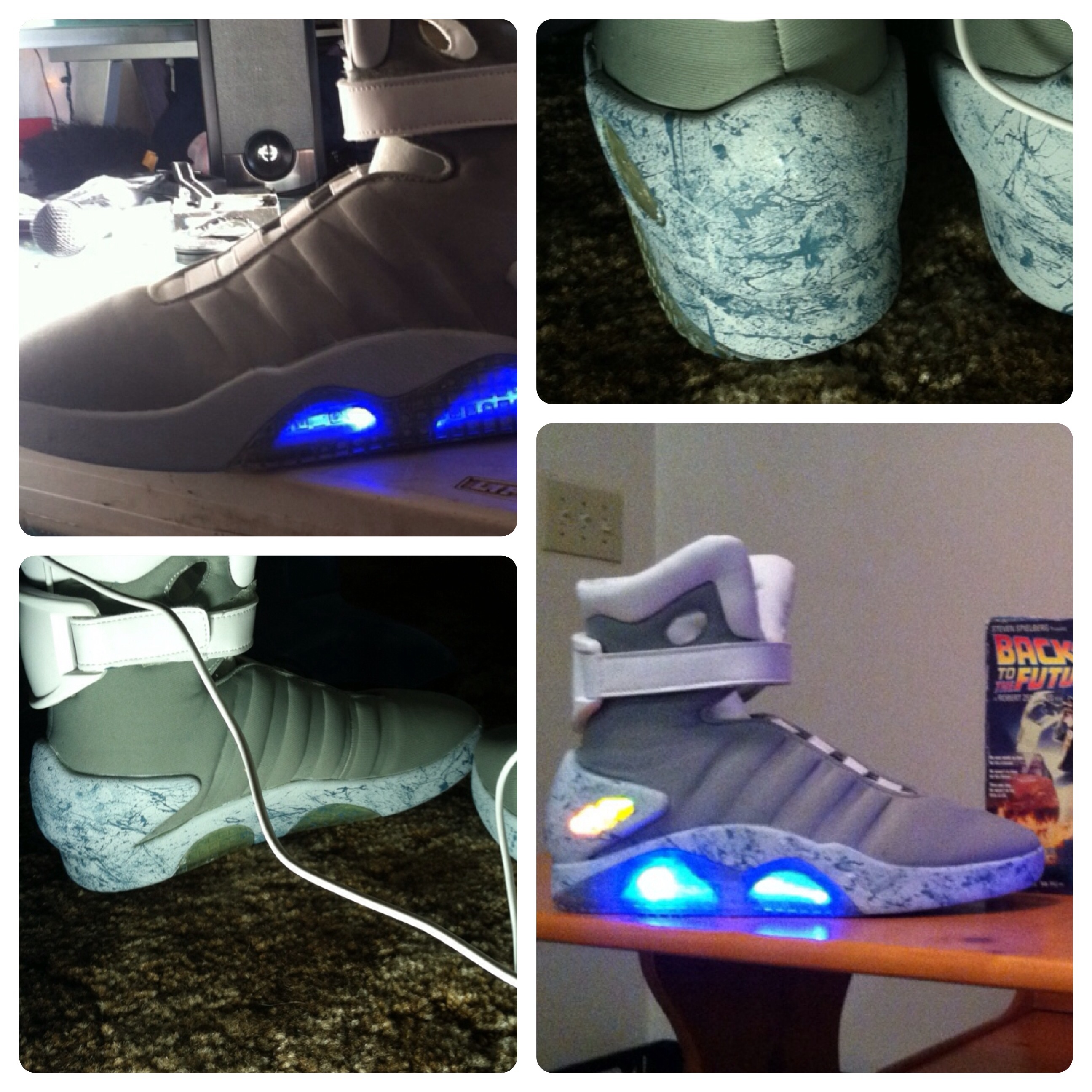

shoes so far just wanted to update on this thread so far i have done the cut and glue sock movie type slim toe, i rit dyed my soles blue to get rid of yellowing,i also added diffusion in my soles over the leds to make them look more like el, i modded my led bubbles to stick out farther and added diffusion to get the foggy look the rd mags have, i did the outrigger mod on my soles, i flattened the laces, i painted my midsoles the correct color grey and did a new splatter, and i have my el stuff coming in the mail for my new straps im making im also making a new tongue i also have the markpoon decals coming in the mail and i made a hoverboard
