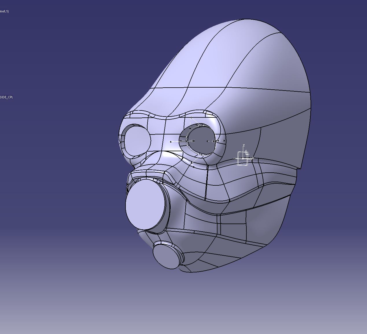

I did the main 3d model work in my goto CAD software/3D modelling which is Catia slash Zbrush. The Metrocop helmet is a somewhat more simple shape to model than both of the previous builds and as such that part of the build went pretty smooth. I always try to introduce something that I've not tackled before into every ew build and the new thing for this build though was that I wanted a bit of texture on the collar piece. I added some twill/textile texture onto the Catia-modelled collar in Zbrush with the intent to resin print that part in my M3 MAX.

Final version of the 3D-model

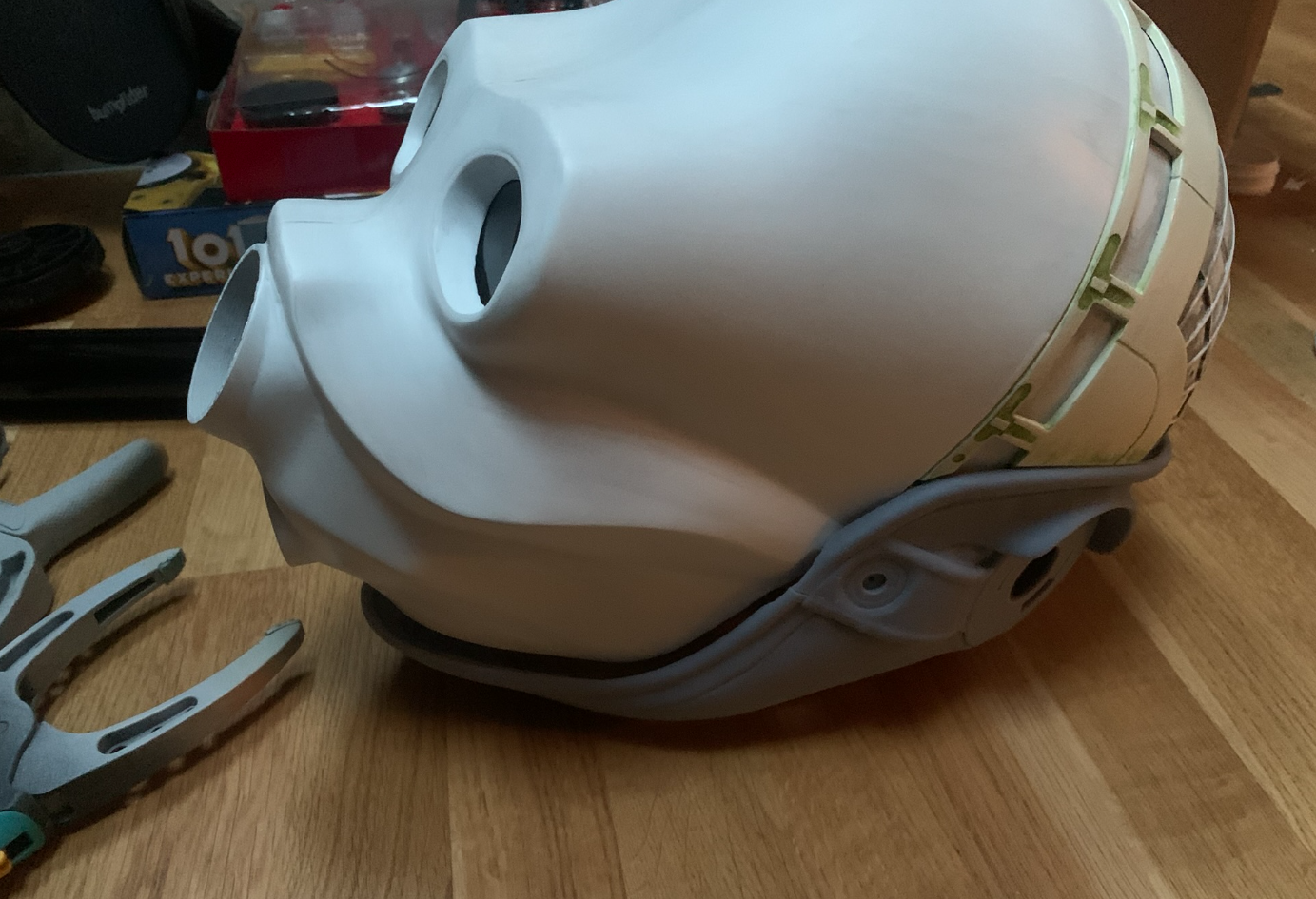

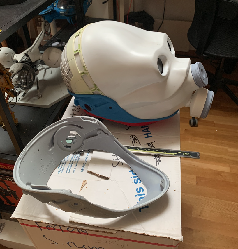

I had to reprint the collar due to it being printed in resin and i miscalculated the shrink-compensation. I compared my first 100% resinprint to a FDM-print of the collar and found that it was 2.5% smaller in length and therefore did not fit the facemask and so first try I just upscaled the collar 2.5%. This though did not work, I hoped it would shrink into place but alas, it did not even after spending 15h @ 55 °C in my enclosed Voron 2,4. I realized that the sides had folded out when I originally measured the 100% print which gave me an incorrect reading. So, I reprinted and this time I upscaled it 1.5% in length and 1% in width since I noticed a major gap and the at the sides on the 2.5%. This seemed to do the trick and it fits with just the amount of gap I want from a fresh print towards the rest of the helmet. I should now be able to paint it after letting it dry up for some hours in the Voron ;)
The gap with the 2.5% after drying. Fits like an oversized glove
The reference FDM-print and the too small 100% resin collar

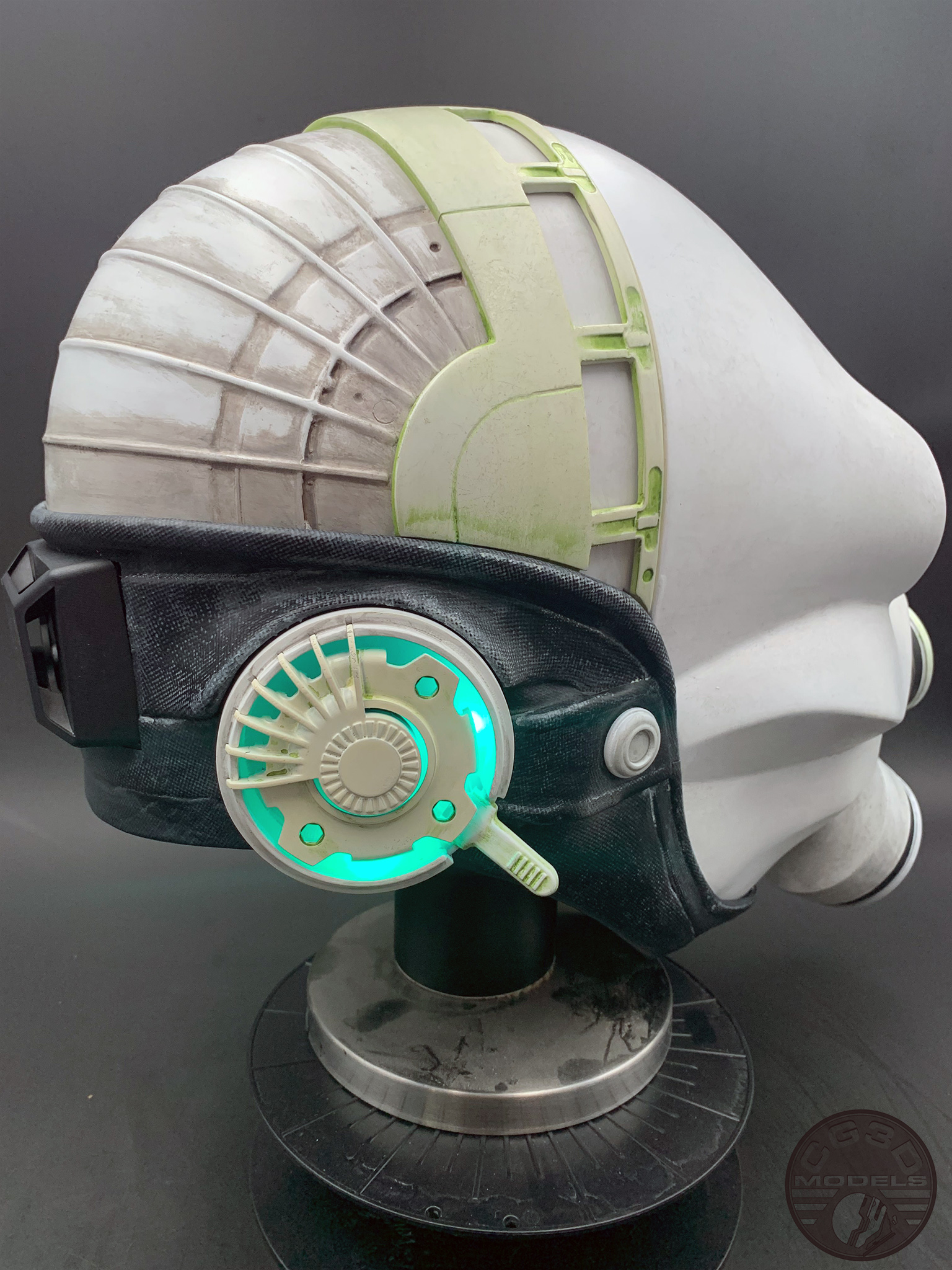

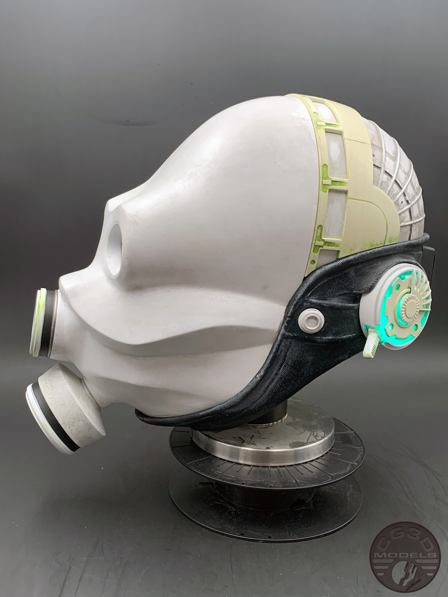

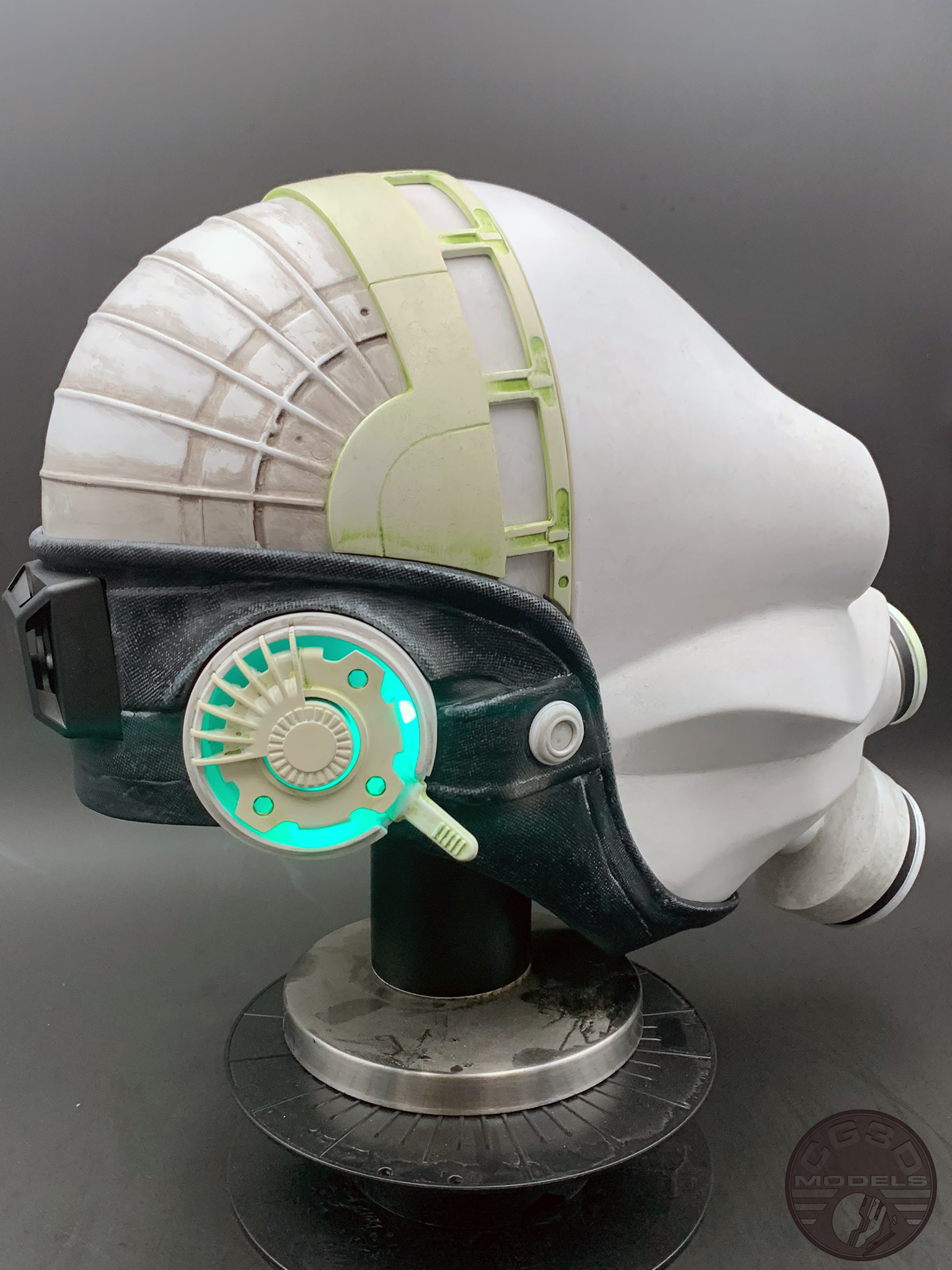

I managed to finalize the build yesterday. I don't feel 100% pleased with it for whatever reason. I kinda feel that something is lacking but can't put my finger on it specifically... but I'm not going to do any more work on it as it stands, It's on hold for now and maybe I'll see what I'm missing now later.
That said, here are some pictures of the finished build, and also, I put the files up on my Etsy if anyone is interested.
The only things that really stand out to me would be that maybe the seam down the middle of the face needs to be more prominent and that some weathering on the white to make it "world-used" could really make it pop. Such a large area of white looks unnatural without either small details (which don't exist on the subject matter) or some weather grime.
Yeah, that might do the trick. Thank you, I'll try that
