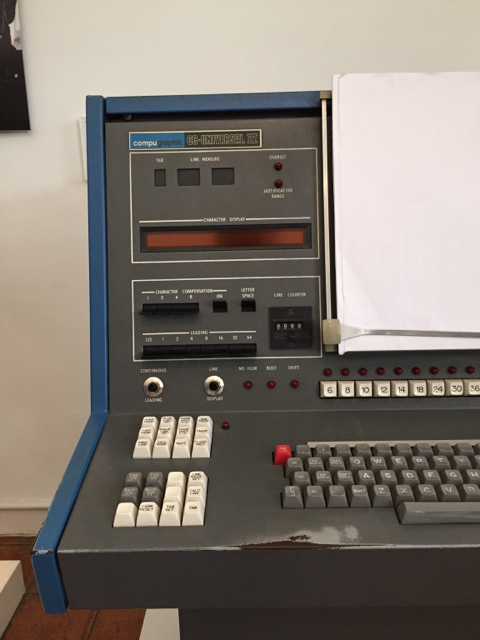

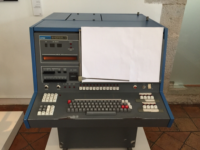

I saw this machine early this spring in Spain. It looks very Hal to me
ImageUploadedByTapatalk1441545722.494558.jpgImageUploadedByTapatalk1441545759.561571.jpg
