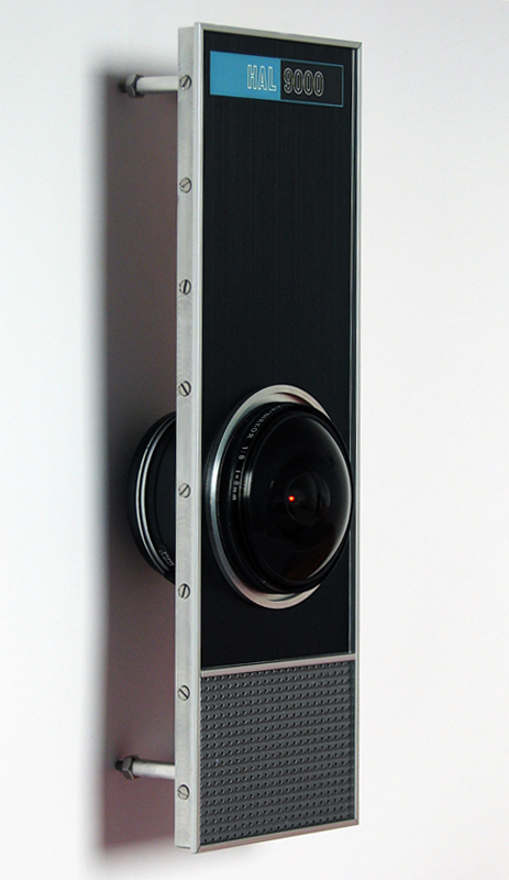

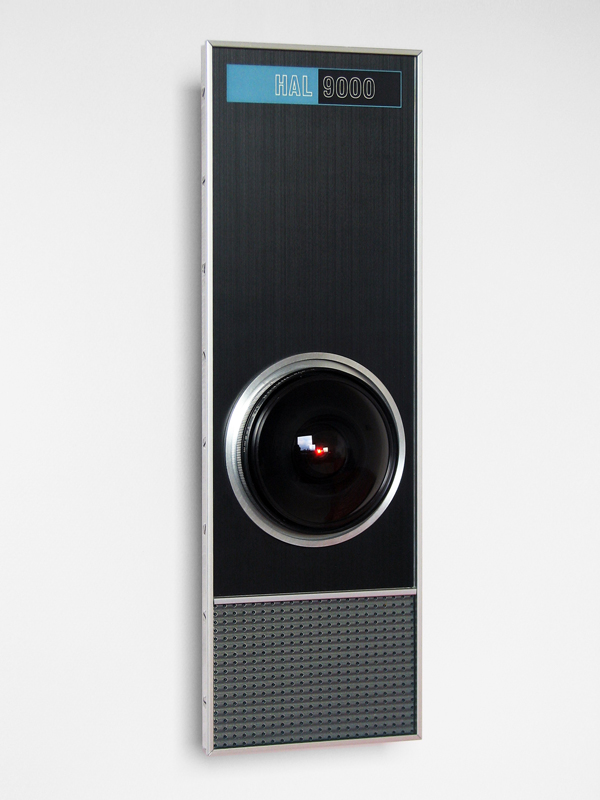

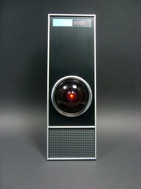

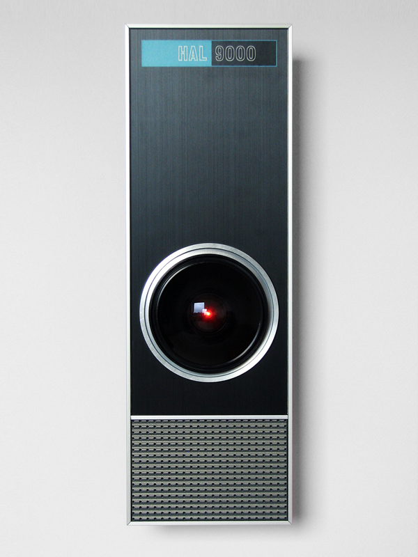

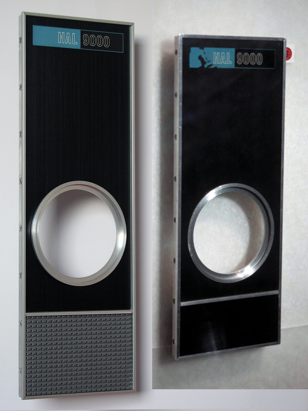

HAL 9000 1:1 replica by AP-333
Just after finishing my first HAL Panel, I decided to bring it to the next level and started to build these two:
TWO identical 1:1 HAL 9000 full aluminum panels!

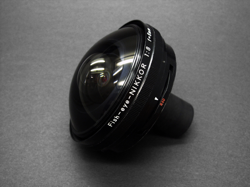

Both with original f=8mm NIKKOR lens ;)
No.1
No.2
It toke me some time to build these with the acuracy and very close tolerances, but I think they are as acurrate as they can possibly be to the screen used HAL.

It started with a little luck on an eBay Nikkor lens auction.
I just couldn't resist after already having hold an original lens in my hands,
I really had to get me one of my own.
(you know exactly what I'm talking about :lol)
More Details:
During the long shipping time from US to Germany, I started to do more research on the prototype panel,
because it's clearly the basis for the screen used HAL.
1) Panel Depth
The panels depth dimension is mentioned in the description, on the Christies Prototype auction site [LINK]
"plate -- 4½" x 11¾" x ½"
2) Details
Thanks to Mikes (Sith Sheriff Brody) reference pictures [Post #43], that
show the panel from the side gave me following information:
- black brushed anodized aluminum panel face
- Trims do have a rabbet cut outs of the edges
- 8x holes with counter bores with equal spacing on sides
- Slot headed countersunk screws
- Correct ring shape and dimensions
- Cross bar (trim) is at the same height as the other trims
more details from Denis Gilliam's [LINK] 1:1 prototype rebuild.
(he took dimensions from the original prototype)
- 4x counter bores with equal spacing on top and bottom trims
- 4x threated screw holes on the back
(for the supposed attachment system, which he tried to reproduce)
- 4x threated pins for the wall mount system (NOT CONFIRMED)<- I took
his idea over, because its good way to get the panel mounted on the wall,
without breaking a hole in it for the long Nikkor lens.

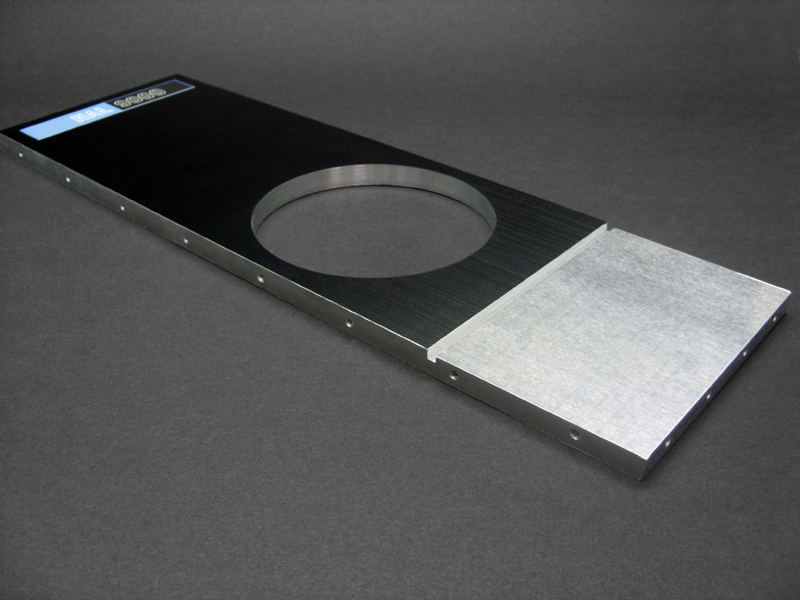

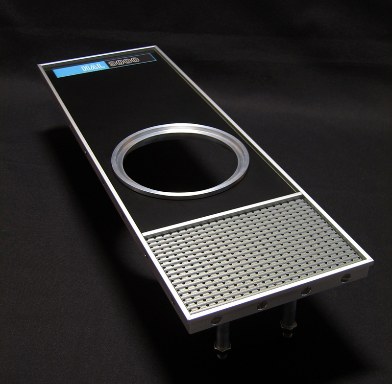

3) The Parts
- NIKKOR fish-eye 1:8 f=8mm Nippon Kogaku Japan
- 1:1 100% aluminum panel with 24 threated screw holes around it, cross
bar groove (milled)
and four threated screw holes on the back for the attachemend system
- brushed, black anodised panel face
- 1:1 aluminum ring (lathed)
- 5x aluminum trims with correct screw hole spacing and trim profile

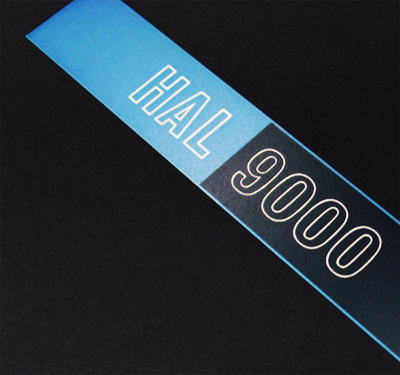

- High quality thin Vynil sticker (original label with correct dimensions)

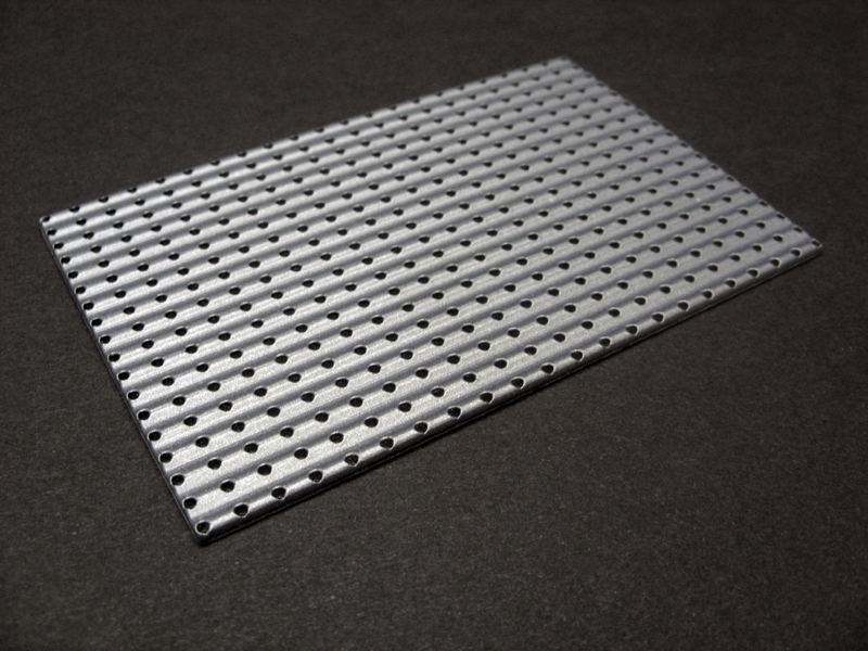

- 3D printed grid with correct hole spacing and custom mixed antharzit
metalic paint
- Custom lens cap with Nikon F Lock system and integrated white LED,
battery compartment, alternativ DC-IN socket and on/off switch
(This cap secures the lens on the panel and centers the led in the middle)

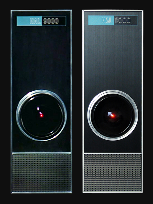

Comparison:
AP-333~
Truly a work of art. One of the finest and most detailed prop replicas I've seen on the RPF!

The decal is a digitally restored copy of the original prototype panel from the Christie's auction.
I've printed them in a local print shop. If you need one, you can download the graphics from my first post in Chapter 8 The HAL | 9000 label and print them yourself or just PM me...I have still a couple left~

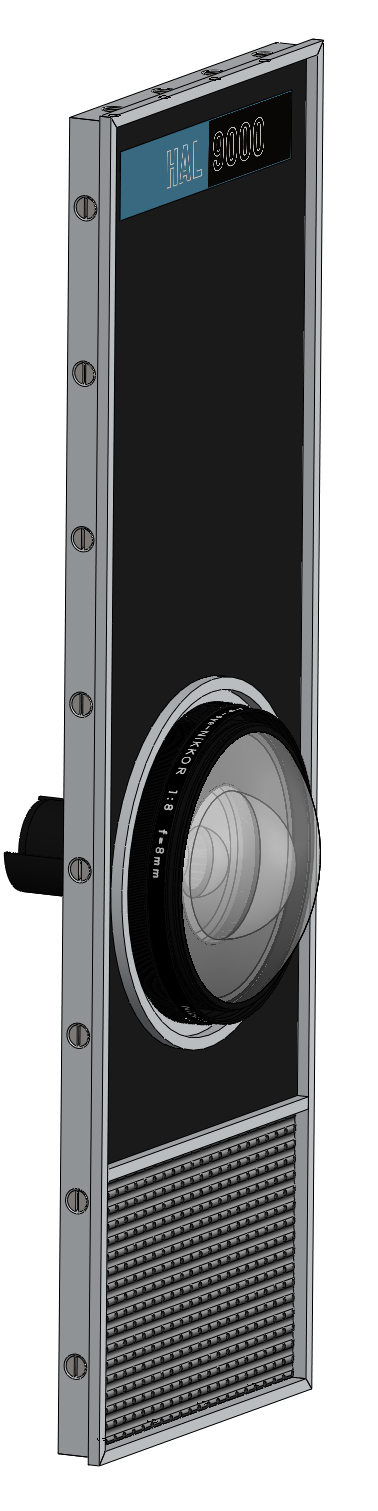

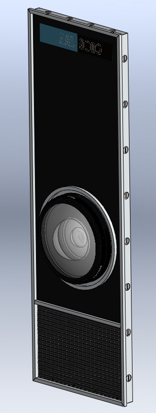

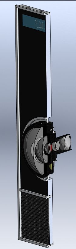

!!Please Note!!
I just found a mistake in my drawing!
The overall size of the HAL panel is 13.5" x 4.5" x 0.5" (height x width x depth) and not 13.75" as mistakenly shown in the drawing.
Apart from that all other dimension are correct as they are.
Sorry for that! I'll post an updated version soon.
For the Nikkor lens dimension please refer to the 3D.pdf
All the best for your build!
Show us a little of your work in progress :love
AP~
