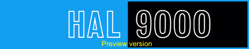

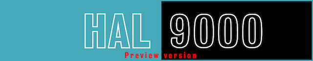

I have taken the image of the nameplate from earlier in this thread and recreated it as a high fidelity vector graphic suitable for printing.
The font was "Grotesque Becker" which has been converted to outline format for the file. (So no font required.)
The blue is set as #45A9B9 (R69, G169, B185) which was sampled from the original image.
Because this board doesn't allow for SVG image uploads here is the code for the image file.
You'll need to copy/paste it into a blank text document and then rename the file so the extension is .svg instead of .txt
SVG:
<svg width="1449" height="282" viewBox="0 0 1449 282" xmlns="http://www.w3.org/2000/svg"><g fill="none" fill-rule="evenodd"><path fill="#45A9B9" d="M0 0h1449v282H0z"/><path fill="#000000" d="M747 5h697v272H747z"/><g stroke="#FFFFFF" stroke-width="5"><path d="M394.212 221V64.372h35.457v59.094h20.884V64.372h35.571V221h-35.571v-75.503h-20.884V221h-35.457zm137.81 0H501.73l30.293-156.628h35.342L599.953 221H562.89l-4.016-27.998h-22.95L532.023 221zm23.753-49.34l-8.606-58.75-8.261 58.75h16.867zM615.56 221V64.372h35.915v125.99h41.997V221H615.56zM795.637 175.943l23.266-.665c-.75 4.566-1.127 7.811-1.127 9.806 0 11.094 4.283 17.303 12.712 17.303 8.592 0 13.789-6.52 15.555-18.546.48-3.364.865-12.007 1.173-26.126l.1-4.586-3.908 2.401c-5.966 3.666-12.056 5.482-18.313 5.482-12.016 0-21.056-4.783-27.398-14.474-4.982-7.654-7.509-18.166-7.509-31.563 0-19.041 4.124-32.363 12.194-40.075 6.443-6.16 16.193-9.29 29.368-9.29 8.943 0 16.496 1.67 22.689 4.982 8.698 4.63 14.637 15.213 17.651 31.974 1.651 9.532 2.485 23.402 2.485 41.554 0 28.905-2.82 48.46-8.299 58.468-3.909 7.036-9.794 12.035-17.74 15.041-5.056 1.878-10.499 2.822-16.327 2.822-10.704 0-19.832-2.473-27.442-7.401-7.588-4.874-11.366-12.672-11.366-23.72 0-3.816.741-8.282 2.236-13.387zm35.77-93.417c-4.246 0-7.647 1.95-9.933 5.665-2.763 4.577-4.042 12.89-4.042 25.177 0 10.903.955 18.423 2.991 22.752 2.264 4.716 6.243 7.172 11.557 7.172 4.282 0 7.775-1.65 10.248-4.882 2.902-3.719 4.186-11.782 4.186-24.583 0-14.913-1.859-24.165-6.072-28.103-2.236-2.14-5.268-3.198-8.936-3.198zM945.12 65.839c7.822 0 14.485 1.062 19.993 3.163 9.61 3.508 16.017 12.464 19.217 27.225 2.402 11.185 3.615 28.28 3.615 51.22 0 18.534-.758 32.142-2.258 40.766-1.682 9.871-4.846 17.098-9.416 21.738-6.74 6.954-17.92 10.5-33.675 10.5-17.611 0-29.15-5.236-35.001-15.597-3.013-5.381-5.114-13.6-6.23-24.611-.679-6.859-1.02-16.73-1.02-29.582 0-26.886 1.516-46.178 4.51-57.781 2.322-8.996 5.99-15.408 10.947-19.316 6.463-5.114 16.217-7.725 29.318-7.725zm-1.033 17.031c-6.684 0-10.933 3.85-12.213 10.888-1.335 7.15-1.99 20.722-1.99 40.838 0 30.68.19 47.852.585 51.88 1.043 9.736 5.503 15.107 13.16 15.107 6.176 0 10.423-3.308 12.263-9.472 1.242-4.223 1.826-12.938 1.826-26.419 0-42.201-.573-66.061-1.768-72.194-1.373-6.867-5.485-10.628-11.863-10.628zm112.796-17.031c7.822 0 14.485 1.062 19.993 3.163 9.61 3.508 16.018 12.464 19.217 27.225 2.402 11.185 3.615 28.28 3.615 51.22 0 18.534-.758 32.142-2.258 40.766-1.682 9.871-4.845 17.098-9.416 21.738-6.74 6.954-17.92 10.5-33.675 10.5-17.611 0-29.15-5.236-35-15.597-3.014-5.381-5.115-13.6-6.231-24.611-.678-6.859-1.02-16.73-1.02-29.582 0-26.886 1.516-46.178 4.51-57.781 2.322-8.996 5.99-15.408 10.947-19.316 6.463-5.114 16.217-7.725 29.318-7.725zm-1.032 17.031c-6.685 0-10.934 3.85-12.214 10.888-1.335 7.15-1.99 20.722-1.99 40.838 0 30.68.19 47.852.585 51.88 1.043 9.736 5.504 15.107 13.16 15.107 6.176 0 10.423-3.308 12.263-9.472 1.242-4.223 1.826-12.938 1.826-26.419 0-42.201-.573-66.061-1.767-72.194-1.374-6.867-5.486-10.628-11.863-10.628zm112.795-17.031c7.822 0 14.485 1.062 19.993 3.163 9.61 3.508 16.018 12.464 19.217 27.225 2.402 11.185 3.615 28.28 3.615 51.22 0 18.534-.758 32.142-2.258 40.766-1.682 9.871-4.845 17.098-9.416 21.738-6.74 6.954-17.92 10.5-33.675 10.5-17.611 0-29.15-5.236-35-15.597-3.014-5.381-5.115-13.6-6.23-24.611-.68-6.859-1.02-16.73-1.02-29.582 0-26.886 1.515-46.178 4.51-57.781 2.321-8.996 5.99-15.408 10.946-19.316 6.463-5.114 16.218-7.725 29.318-7.725zm-1.032 17.031c-6.685 0-10.933 3.85-12.213 10.888-1.336 7.15-1.991 20.722-1.991 40.838 0 30.68.19 47.852.585 51.88 1.043 9.736 5.504 15.107 13.16 15.107 6.176 0 10.423-3.308 12.263-9.472 1.243-4.223 1.826-12.938 1.826-26.419 0-42.201-.573-66.061-1.767-72.194-1.373-6.867-5.486-10.628-11.863-10.628z"/></g></g></svg>

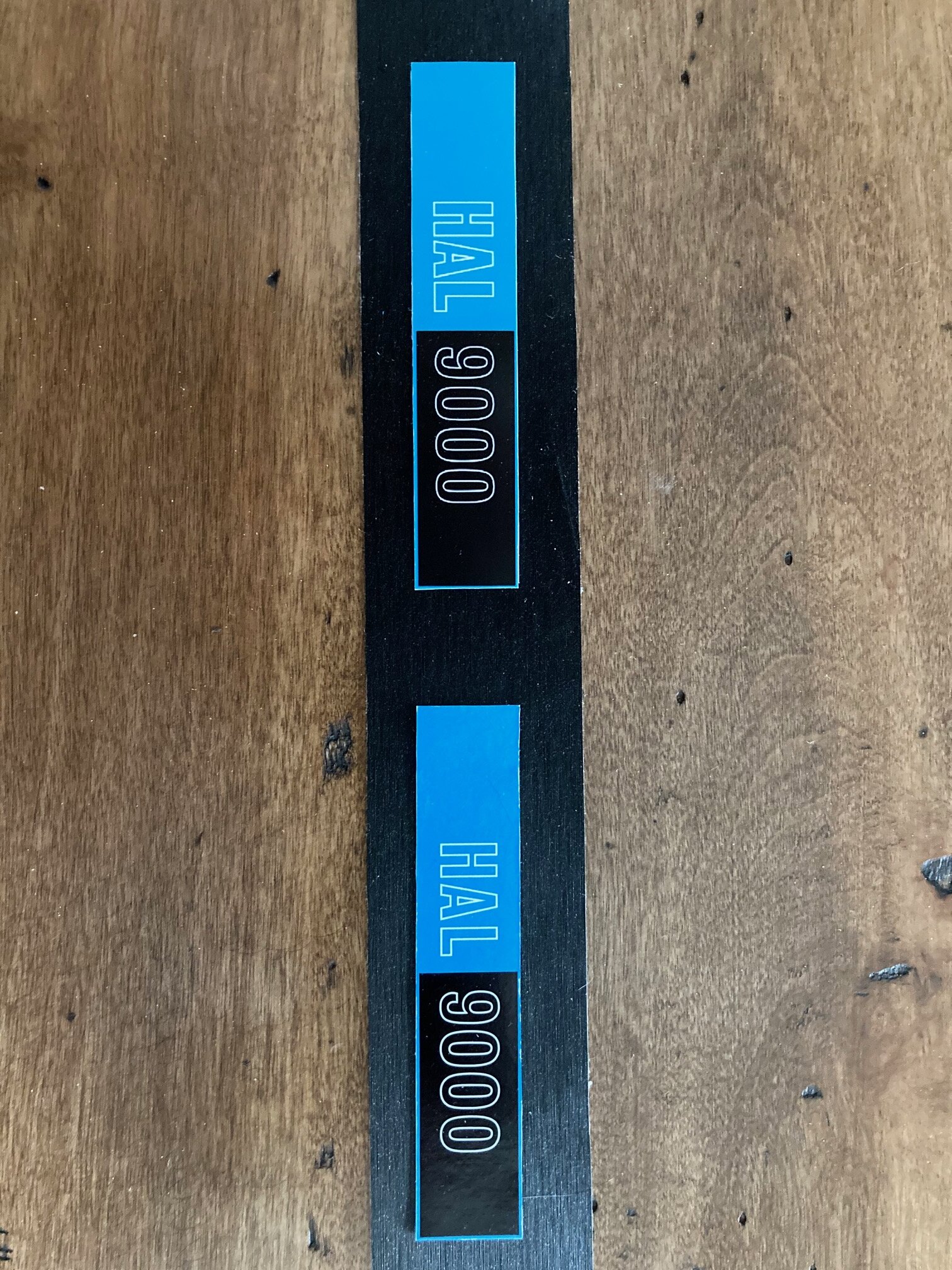

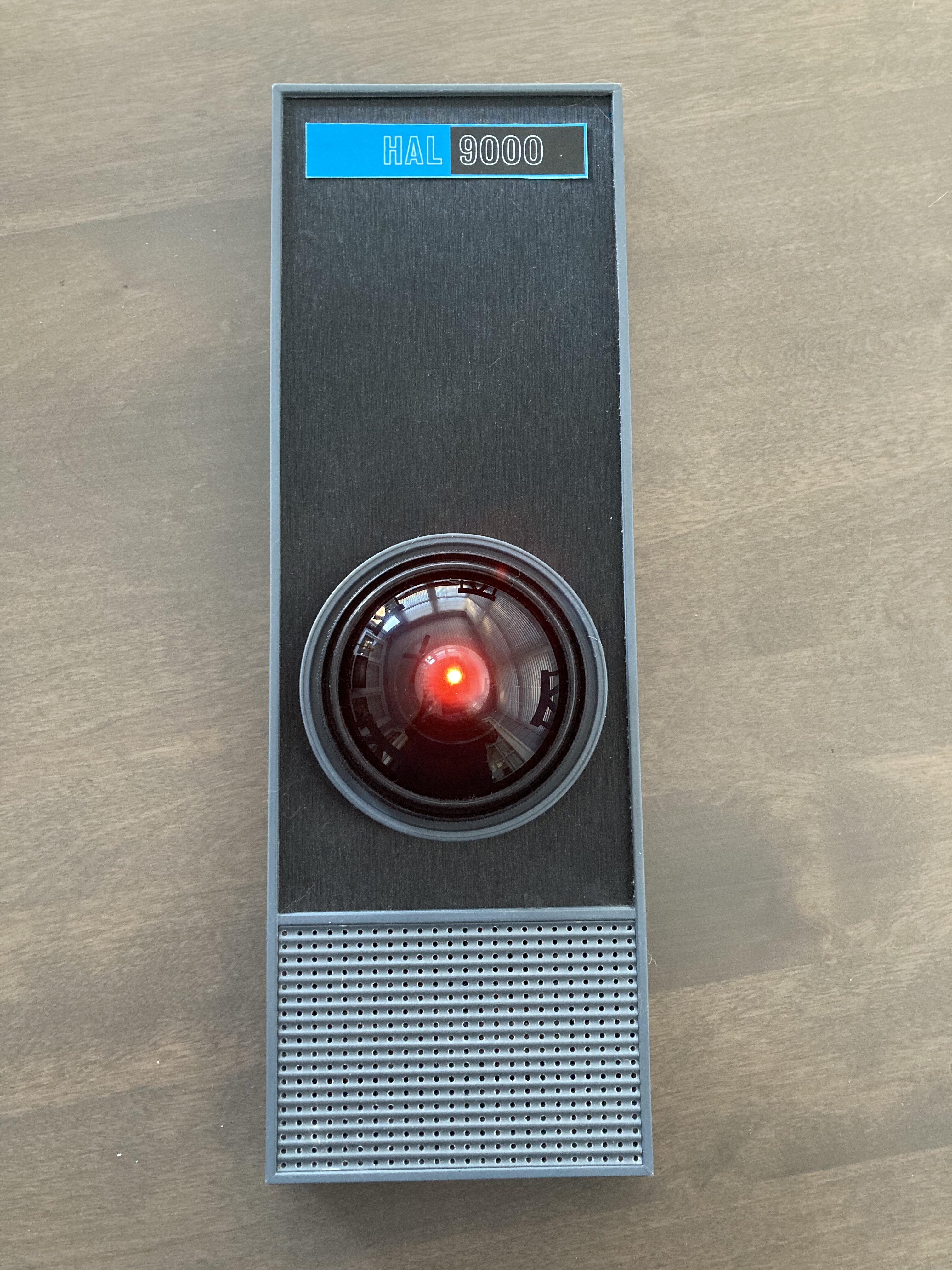

Thanks for this. I thickened the outline around the black just a bit using MSPaint and resized and printed (a bit of a "iterative" process) such that it was ~92 mm wide. I do prefer the more turquoise color compared the the decal from the Moebius kit (though the color difference is more obvious in person than my camera picks up - your version is on the left, err..top ;)).
Yes, photo paper. But open to suggestion.

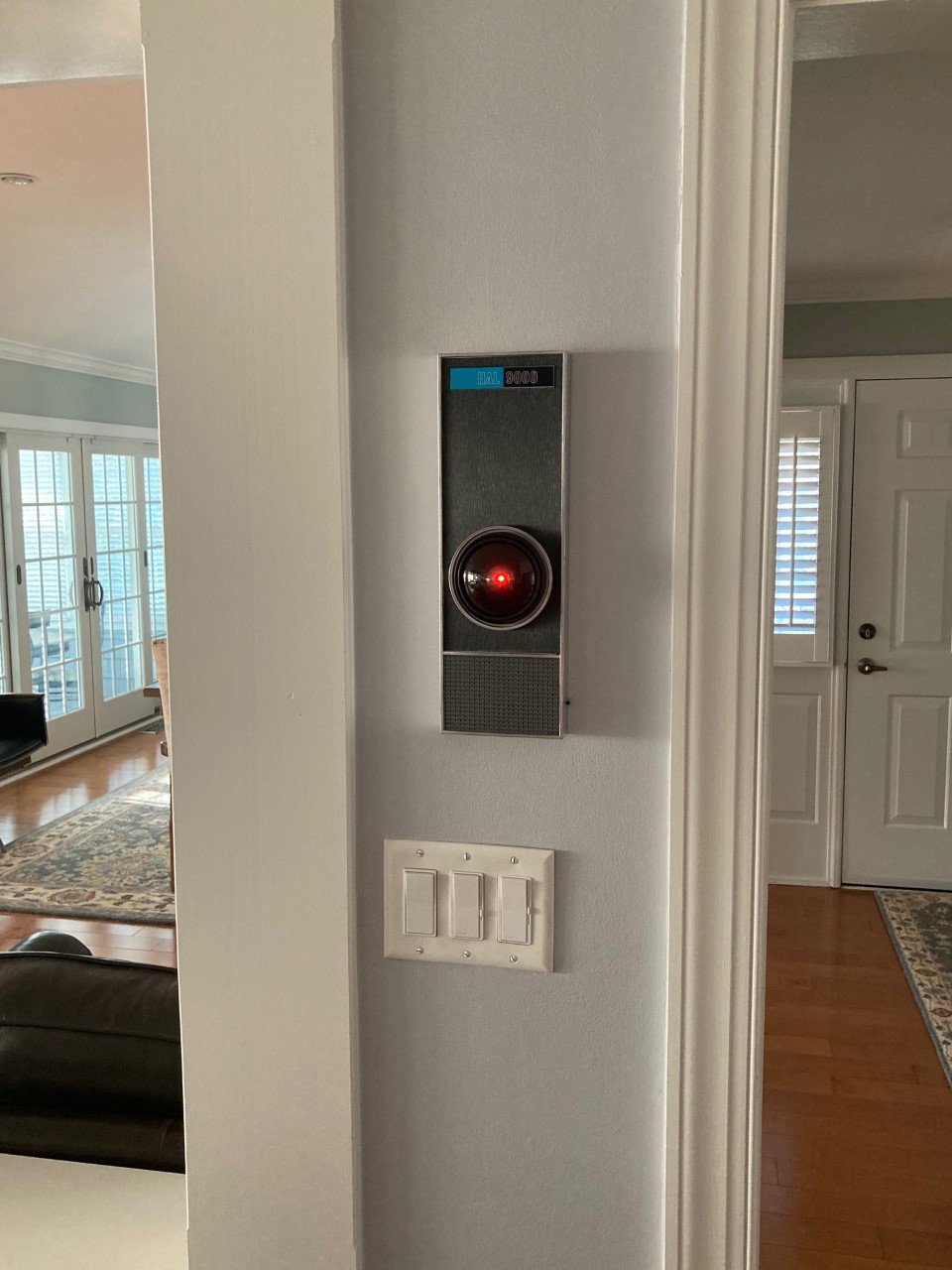

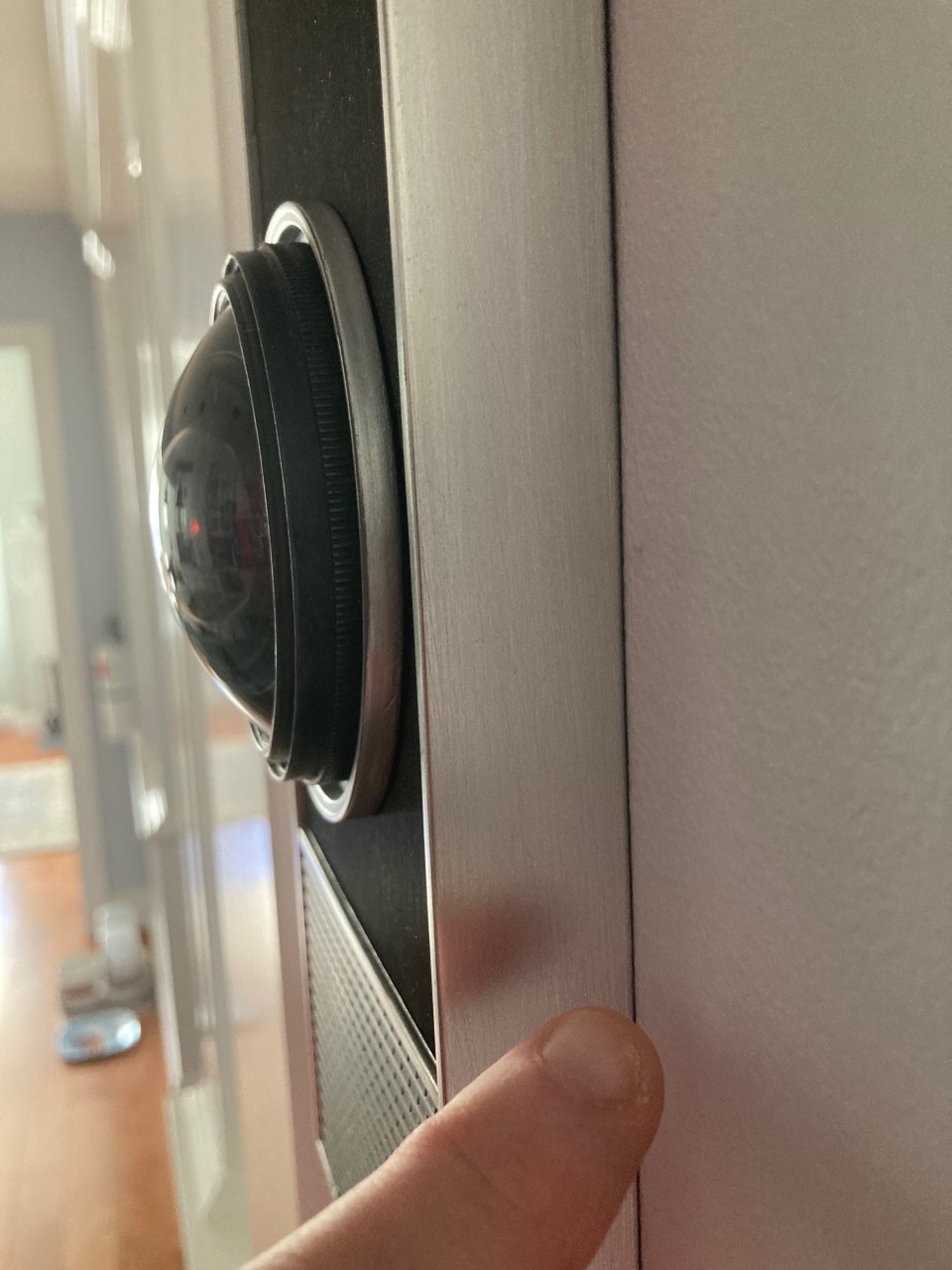

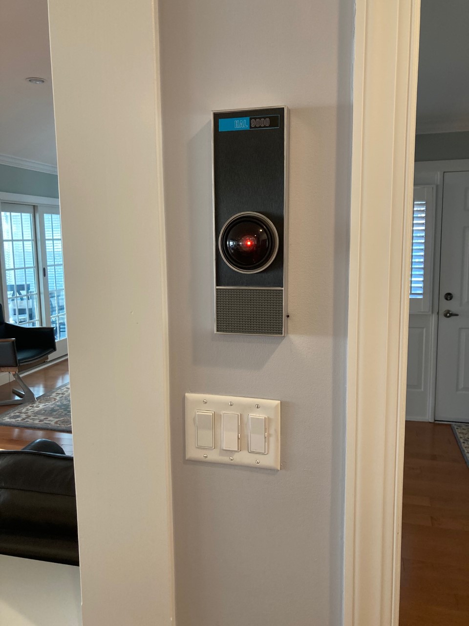

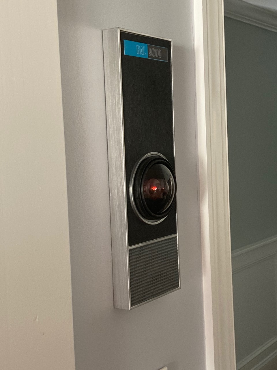

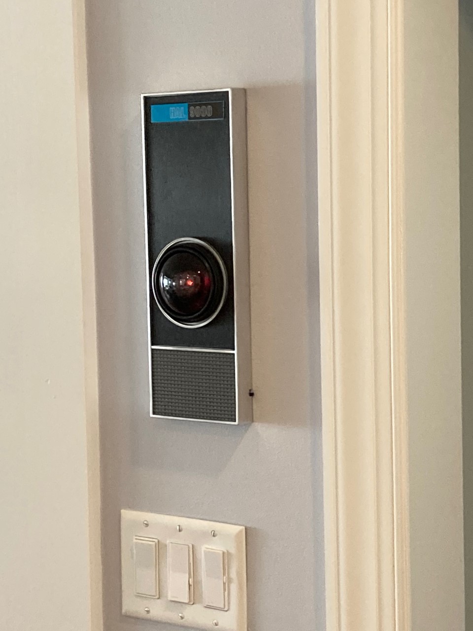

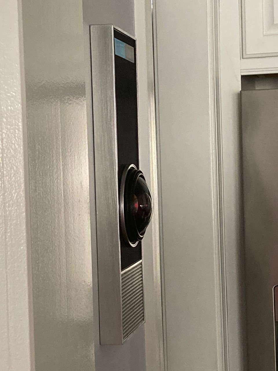

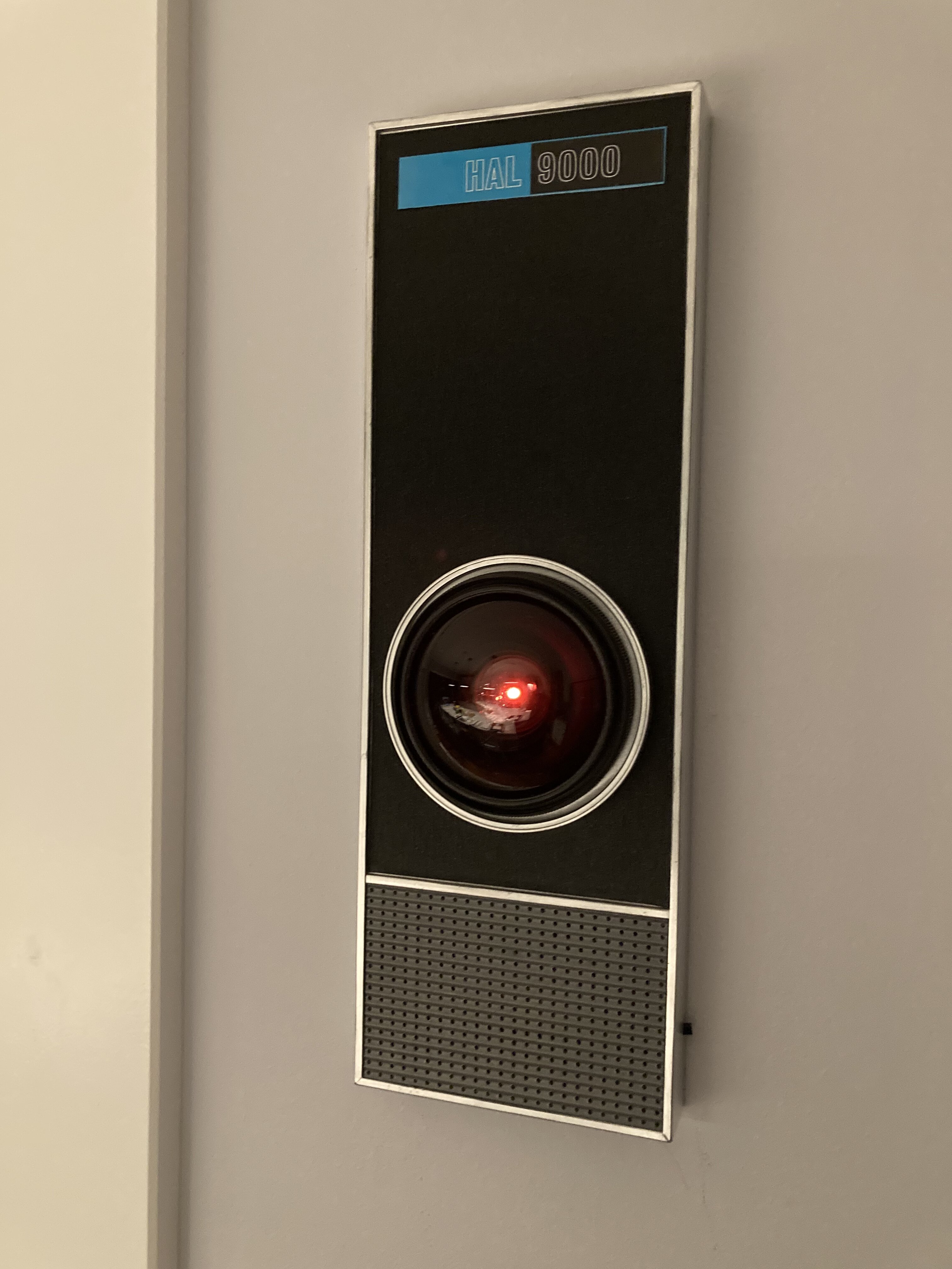

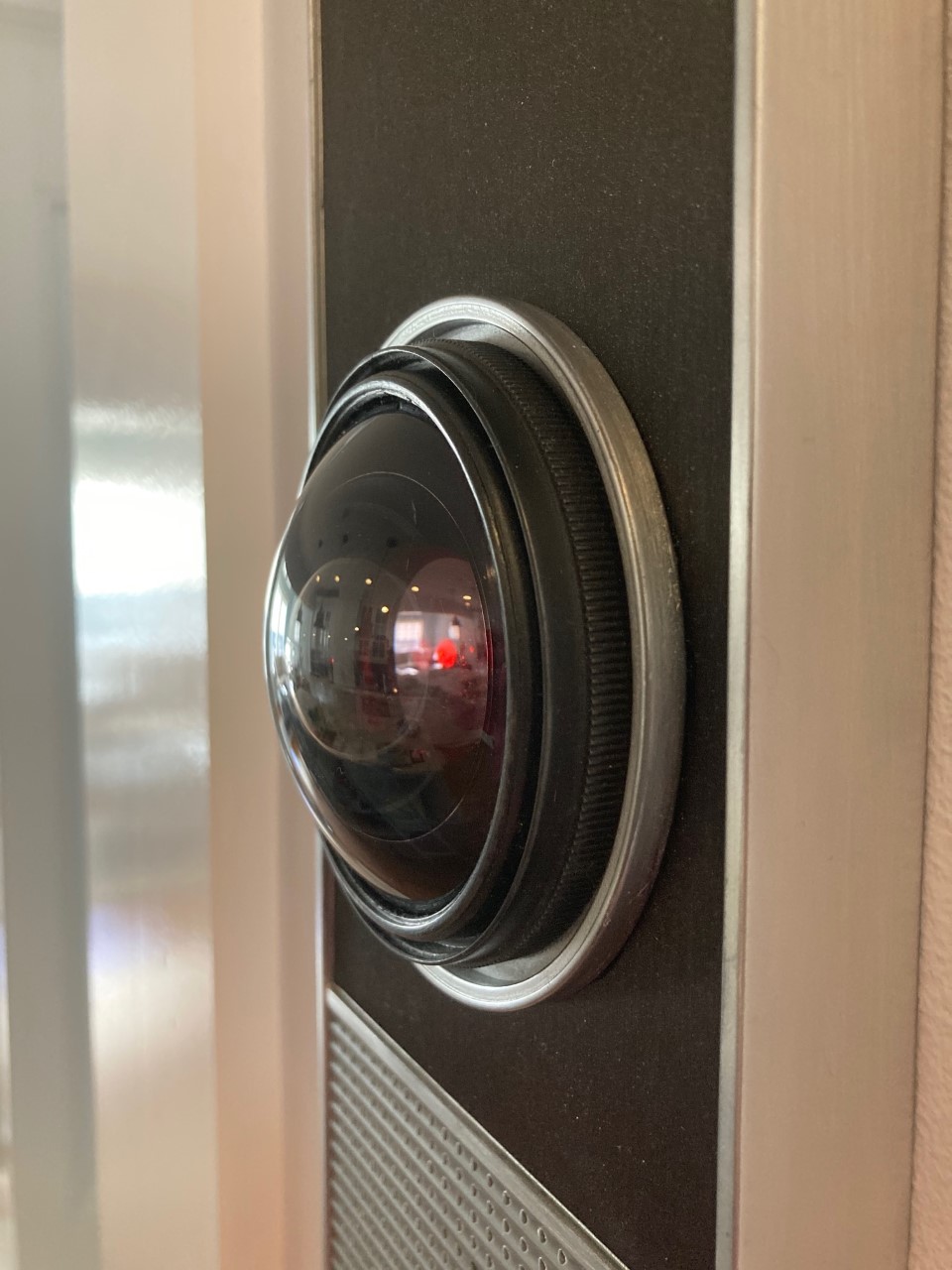

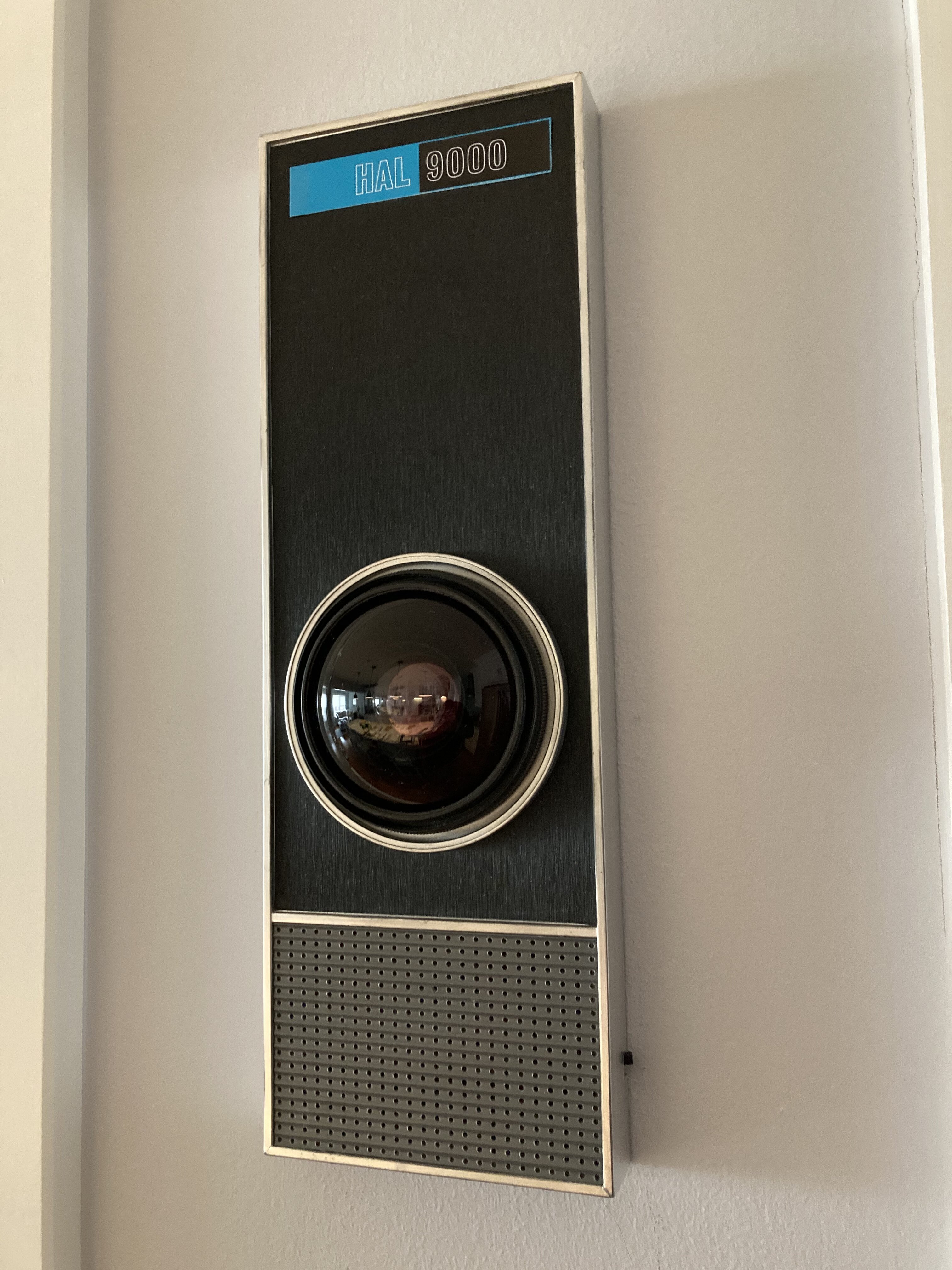

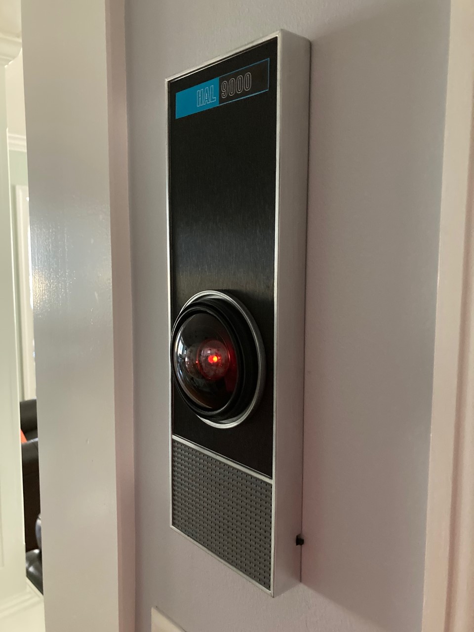

My HAL is now done. Used Alclad chrome paint over grey primer, scuffed before painting with a Scotch-Brite pad on the sides, and ultra fine steel wool on the top surfaces and ring.
ON EDIT: Replaced the photos with those taken in natural light; my camera introduced an odd rainbow effect under artificial light / flash.

Thanks. I didn’t even paint the grille. I will (most likely) if I can find a suitable color, but since it’s gunmetal grey anyway...
