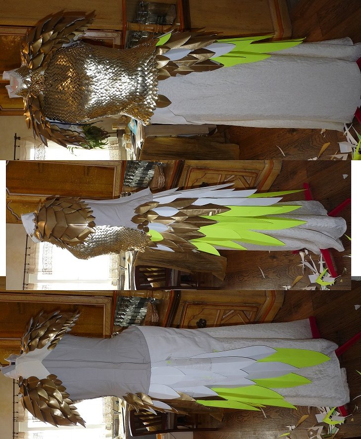

I'm working on the hip armor today...
I made half of it in cardboard and gold wrapping paper just to be sure I know how much I need before I start the craft foam process. The lower part of the skirt will snap on under the vest so that I can take off the armor skirt if I need to.

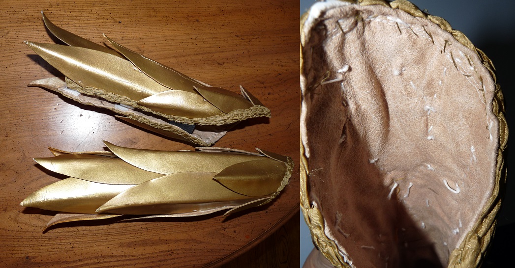

So here are the steps for making foam armor. I didn't take photos as I went because of just being focused on getting it done. But I will try to take more when I make the wrist guards. I do have a video tutorial on making craft foam look like leather, though, and that has almost all the same steps:
https://youtu.be/4IZSr2CZRp4

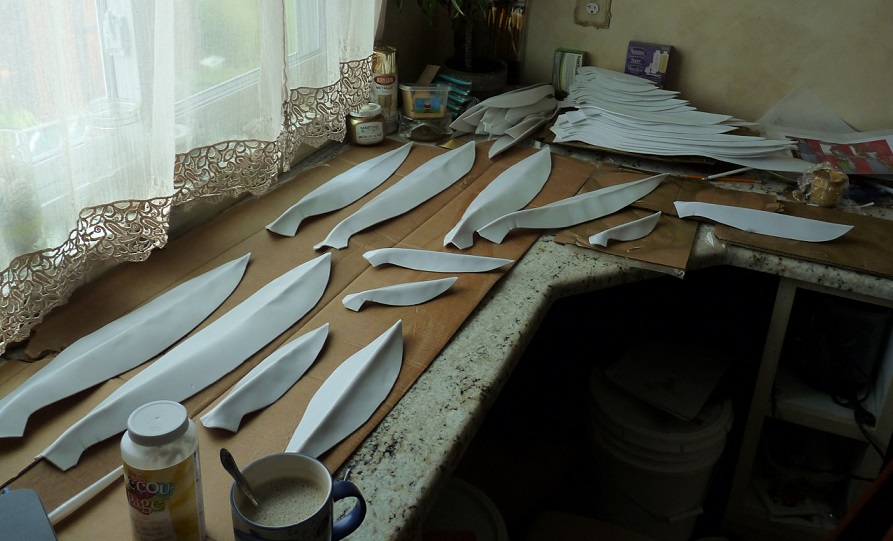

First step - cutting out templates in paper/stock paper (above)
Second step - Iron the foam on both sides to seal and this shrinks it as well
Third step - Iron heat n bond on to fabric
Fourth step - Iron the fabric to the back of the foam
Fifth step - trace out the templates on the fabric and cut out
Sixth step - iron each piece, fold in half to form and when it cools it stays that shape
Seventh step - put two to three coats of mod podge glue on the foam side to seal it further
Eighth step - spray paint gold 2-3 coats
Ninth step - touch up with paint brush on the underside and edges in case it is ever seen
Tenth step - sew it on.
I numbered every leaf and wrote them on the above image so I could keep of the templates and the foam pieces... there are 40 template pieces, which makes almost 80 altogether because there are some center pieces which did not get doubled. Thankfully foam is light. haha!

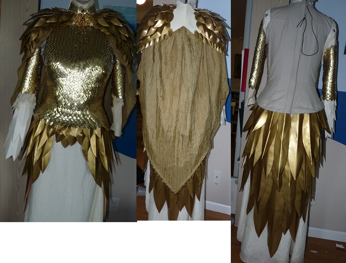

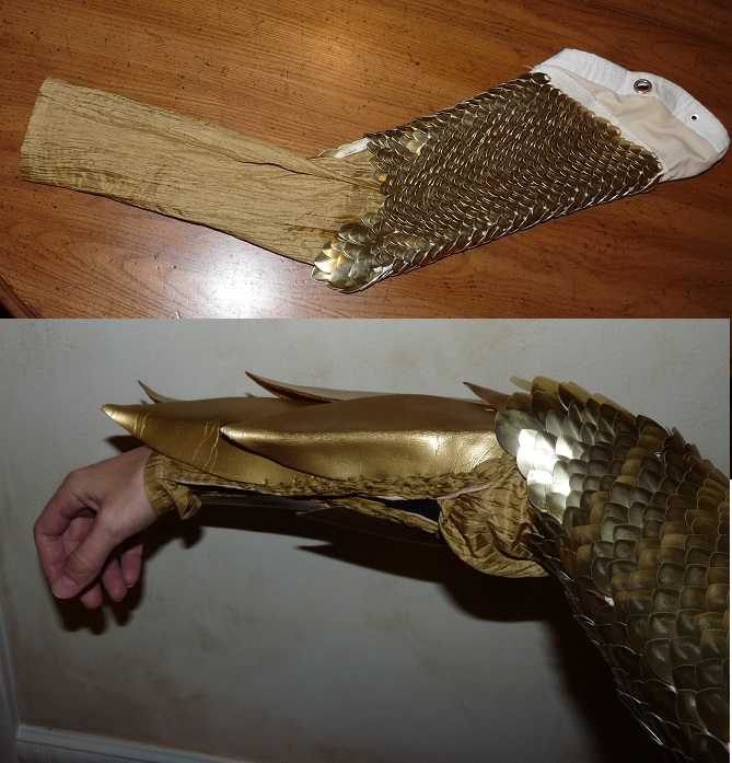

Some progress... the upper armor and skirt armor is done and I"m sewing leaf maille pieces on the cape. I still need to make the crown and the hair 'jewelry' and figure out the lower arm pieces.
The fabric that is gray and beige will eventually be covered with extra gold fabric from the cape or more leaf maille, depending on how much time I have.

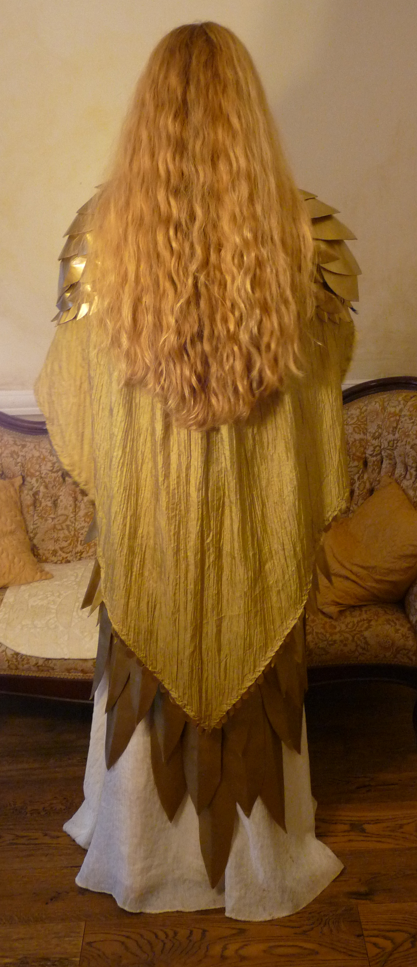

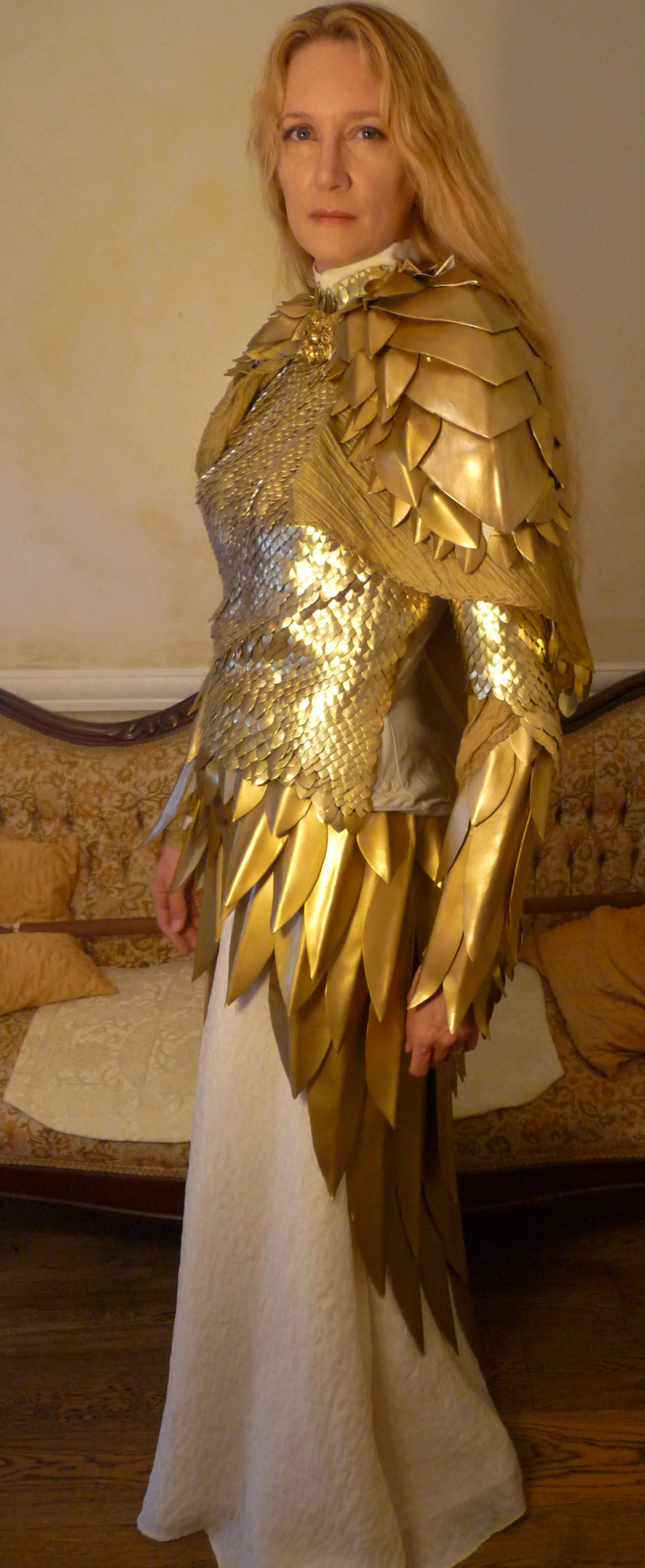

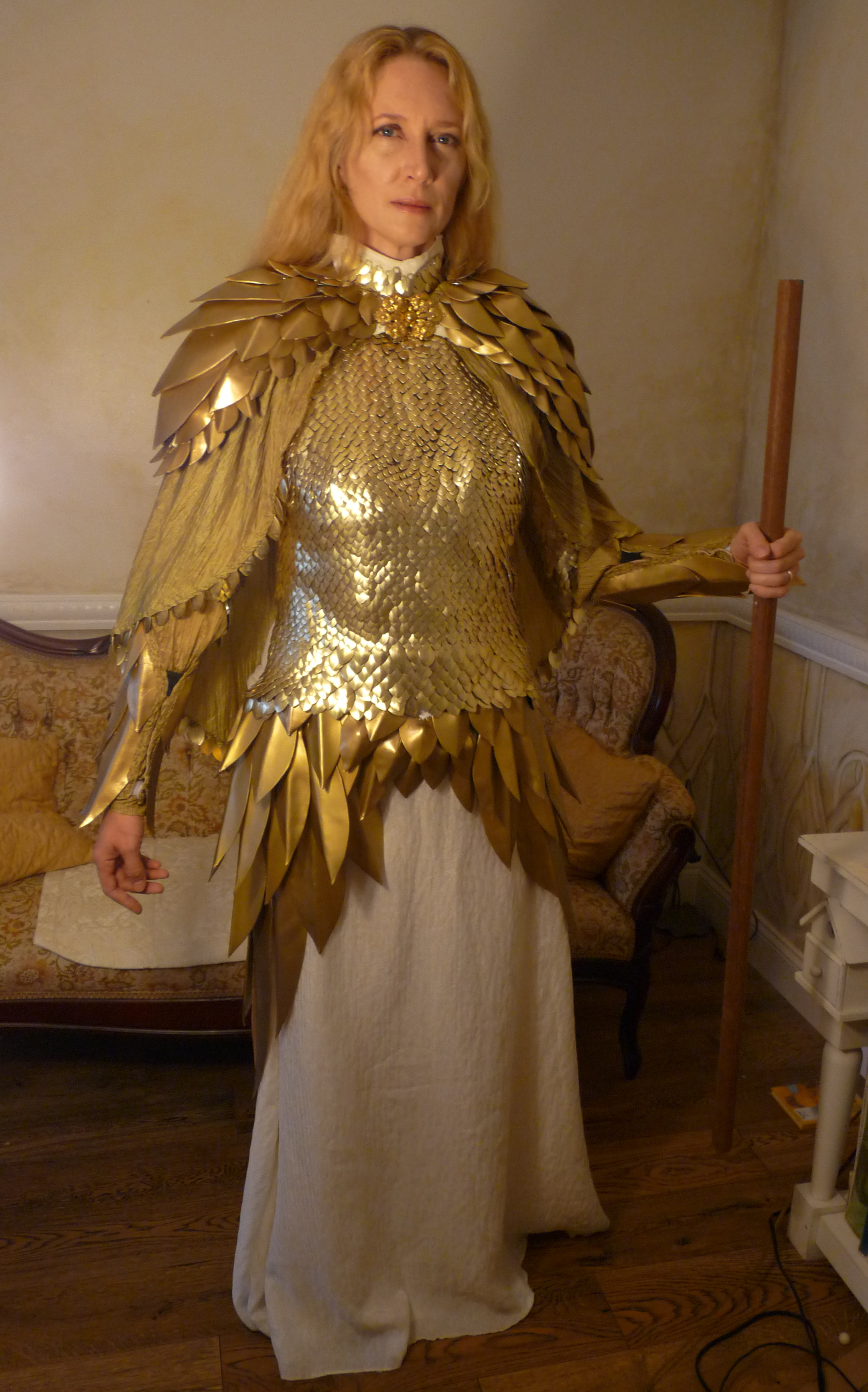

Here are some more progress photos - almost ready for DragonCon! There are still some details that need to be done, and the crown.

This is absolutely stunning! I cannot wait to see the finished product!
