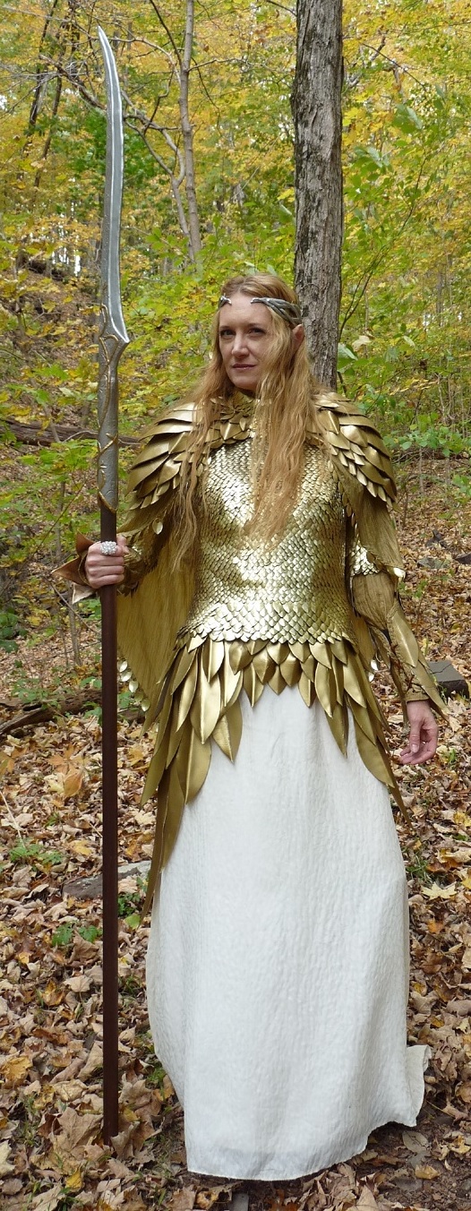

As a submission for the 2015 RPF Costume Contest, here is easier access to my proof photo and gallery photo that were posted elsewhere in the thread:

The first stage of the pattern for the fitted underpiece that I will sew the scailles on. This is a striped sheet that really aids in seeing how the pattern matches up. it's on the form wonky so they aren't parallel. The places that have marks on them are where let myself know to match things up. I started by pinning it all and then had to decide what to sew.
Templates for the scales with gold wrapping paper and poster board and found that the straight scales stood out around the curves - which makes sense according to physics... So I changed the shape a bit and made them in craft foam and ironed and bent them, which helped. I'm also thinking I should get some of the larger metal scales as well, as you can see in the photo, to help transition from the small ones to the craft foam/faux leather.

I gave it a go for a couple of hours today and figured out the distance necessary to get them as close together as possible but still cover the punched hole when they are at rest. This fabric is used for cross stitch and it's pretty heavy - the thread is embroidery strength. It's a bit stiff, but that could be a benefit for holding its shape. The best part is the weave of this fabric makes it super easy to count stitches and get the scales even. The color is nice and neutral too, though, I thought about dying it a more gold tone, but I don't know that it's necessary... thinking about it.
Next; to try and cut/sew this material in the pattern I created to see if it will hold up or have too much of a potential to fray. I think if I finish the edges well enough at every seam it should be fine; maybe even do some fabric glue over the edges after the scales are all sewn on.

Progress is slow, but there is some progress.
Early on in the process.
After the vest was done I started working on the craft foam pauldrons.
The pauldrons are painted, but I still have to attach them. You can sort of see the right arm is started here.

I love the different sizes of scales. It looks like a golden armored bird. So shimmery!
Re: Galadriel Armor - concept design from The Hobbit
Thanks all! :D
Duncanator, Yeah! It feels so nice too, like a reptile. It looks like I'll be making a lot more sizes too because of the way the design is working out for the shoulders, hips and arms.
It's been funny finding little golden scales around the house as I tend to drop them here and there - it's like a dragon is shedding or something. haha!
