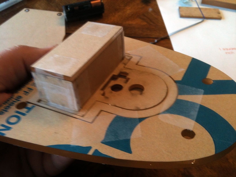

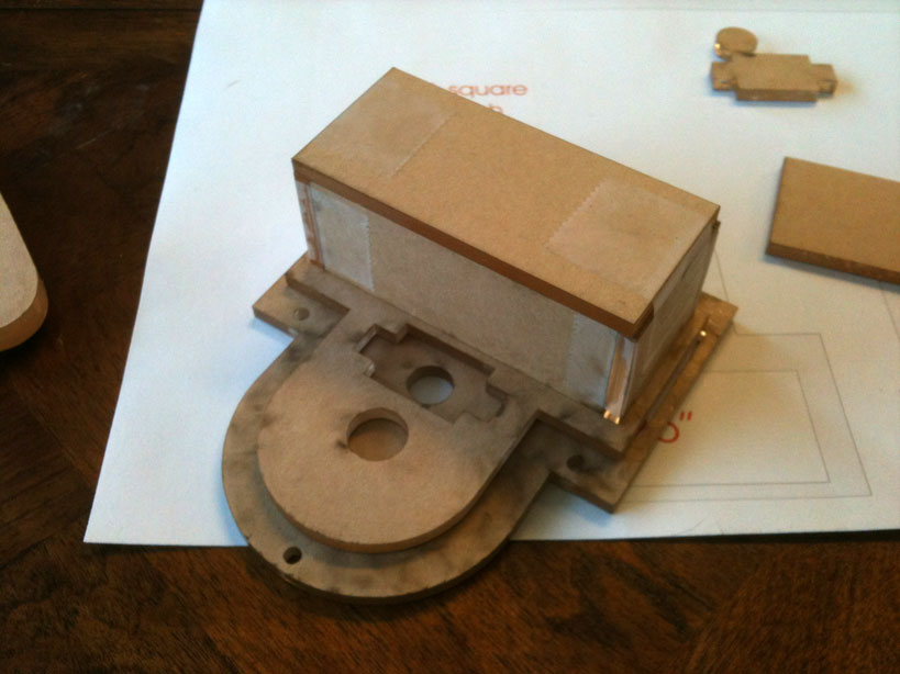

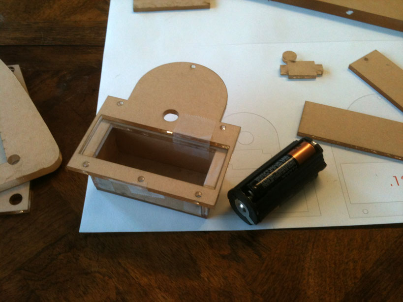

I started to dry fit the new base parts that will also hold the electronics for the lantern. Here are a few shots of the battery/electronic housing assembly:

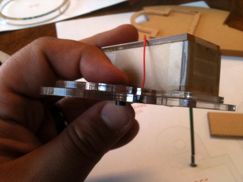

That funky cut in the middle is where the switch will go:

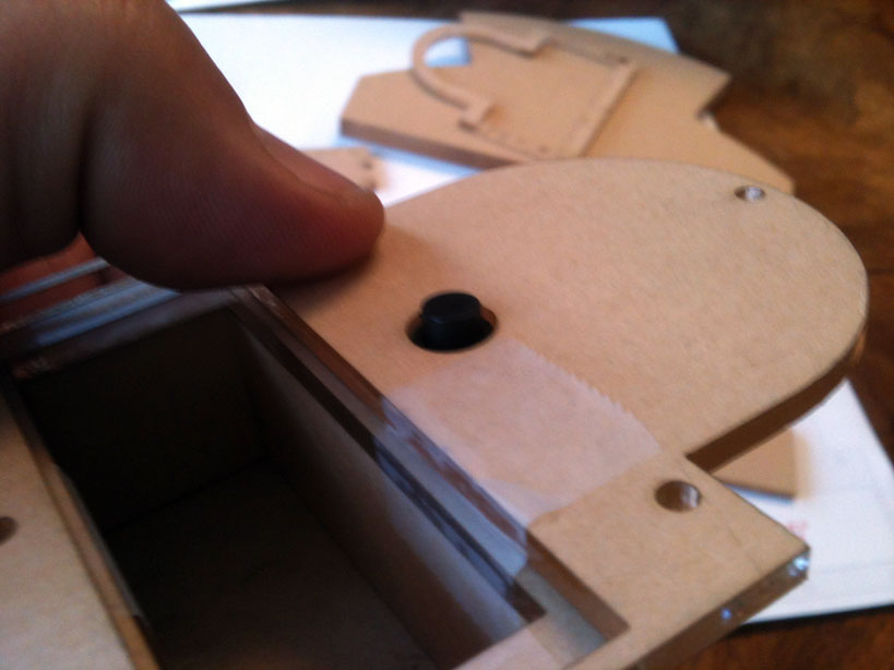

The button protrudes out just enough so it can be switched on and off easily:

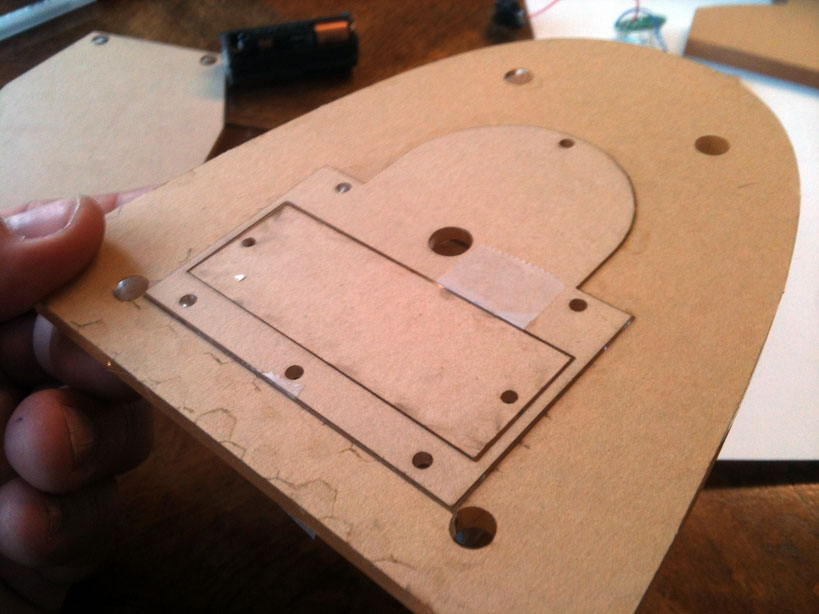

That assembly will the slip into the base opening as one unit where it can be screwed to the insert:

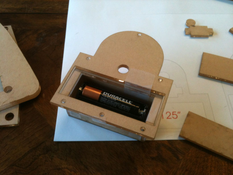

And of course I designed it so the battery door is the only thing you’ll have to take off in order to change the batteries:

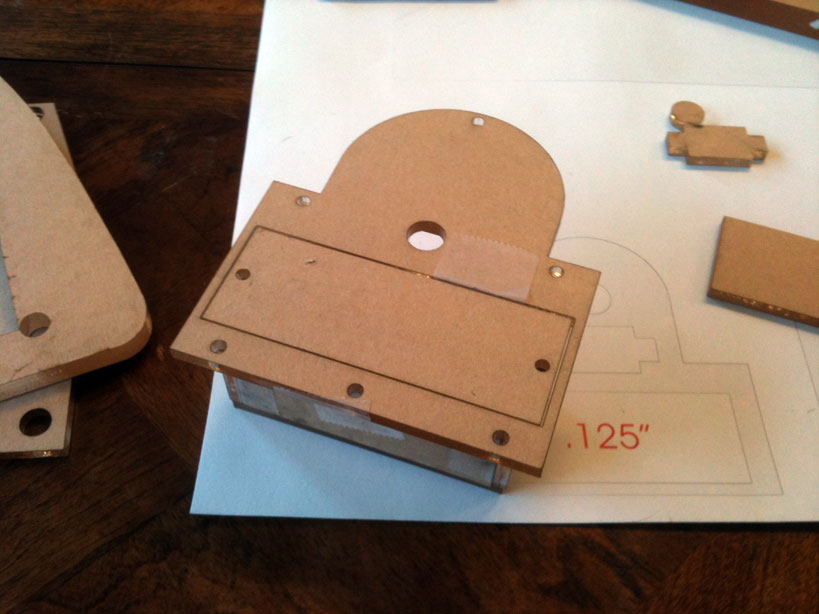

This is the “inside” of the base:
I’m so jazzed these cam in today. I can’t wait to get assembling these. I still have the back-end to redo and the handle. Oy, the handle is going to be the trickiest thing, but I came up with a spine/rib assembly I think will make it not only easier to build but symmetrical on both sides. Now I need to talk to my machine shop and see if they can make me some curved bars exactly the same each time. I’m going to cast metal handles into the lantern so it won’t break when someone picks it up. I’ll show how I’m doing that when I get to it. That reminds me…I’ve got to order some molding silicone and casting resin.
