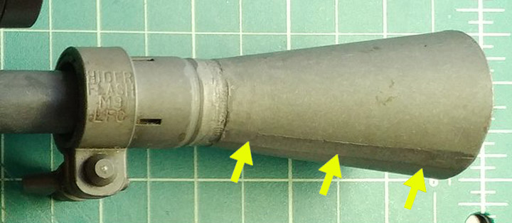

As for the flash hider, my Marco doesn't have the "fold" in the steel of the cone like the LFC does (if I may use a bit of one of your pics):
And of course the Marco wingnut is cast, unlike the LFC stamped/folded wingnut. And the phosphate (?) on mine definitely looks darker than all of the LFC examples that I've seen.
I think I'm basically OK with that though, since I'm going with a Weaver scope and a real Mauser.

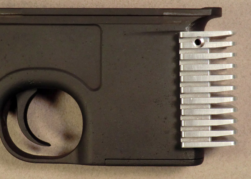

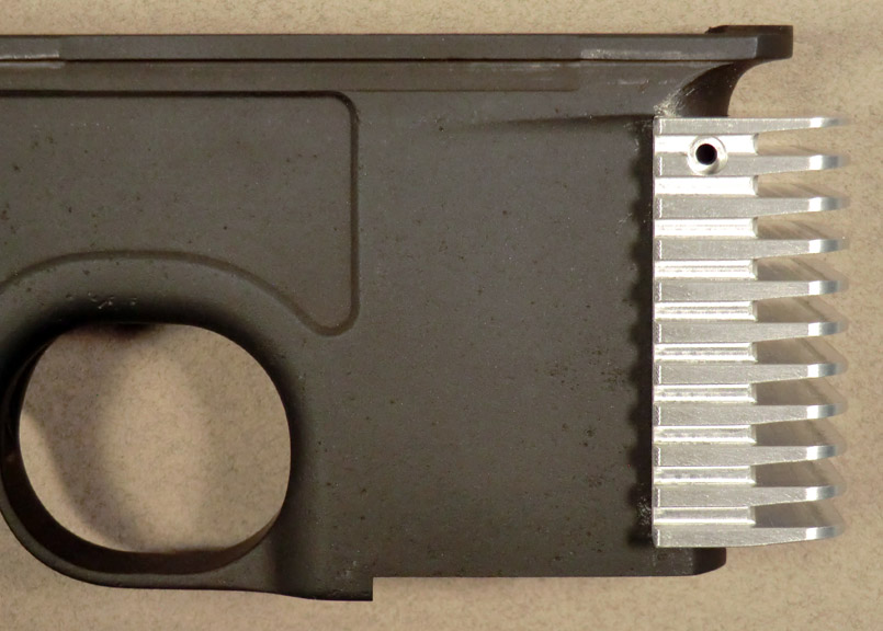

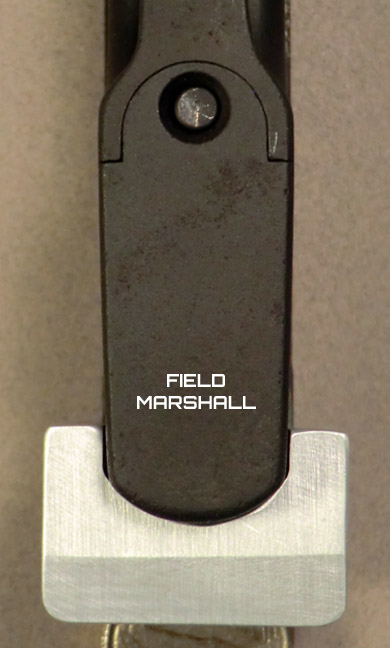

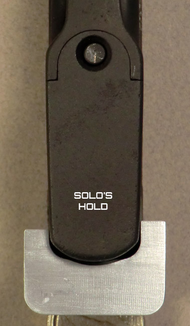

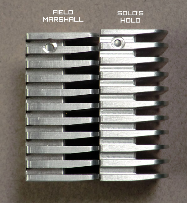

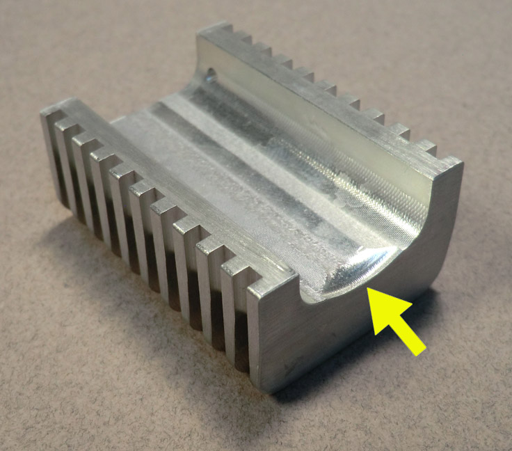

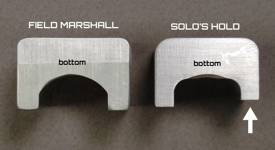

So I finally received the Solo's Hold heat sink last week. It's interesting to compare it with the Field Marshall. I think I prefer the overall shape and proportions of the Solo's Hold, but does anyone know the reasoning behind the short left side and the resulting asymmetry?

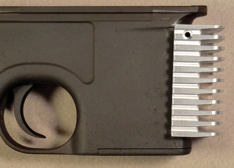

The Field Marshall seems to have a better cut-out shape to fit the contours of the mag front:
The Solo's Hold cut-out is definitely more square:
Also, the Solo's Hold is slightly taller:

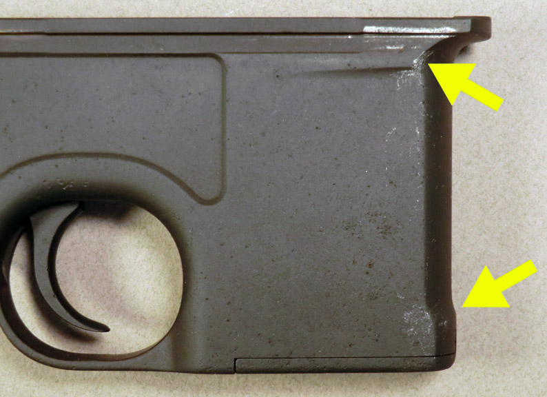

This presents a problem for me, since a real Mauser is smaller than a Denix or an MGC, and because of these flared areas on the front of the magazine:
So neither of the heat sinks fit particularly well, as-is. The Solo's Hold actually has a small scalloped area at the bottom of the cut-out:
This helps a tiny bit with getting it to mostly fit over the contours of the hump at the bottom of the mag, but its extra height prevents it from fitting very well at the top, with the flared areas there:
And if I place the Field Marshall under the top flares it doesn't fit over the hump at the bottom:
So both would require a bit of modification/grinding.

I used the FM Heatsink for mine, with the scope mount on I found It wasn't able to sit right, so I used Milliput to mould the rear of the heatsink to better fit the front of the Mauser, shifting it that extra 1mm from the mount and squaring it off. Also allows for better adhesion. If that makes sense?

For me the biggest issue on the Field Marshall grill is the positioning of the set screw on the side, it's so much forward, I wish he corrected that on his model.

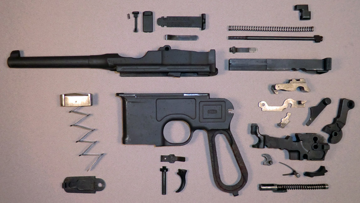

Anyway, I got the Mauser completely stripped down...

And I did a little grinding on the Solo's Hold heat sink so it fits a bit better now.

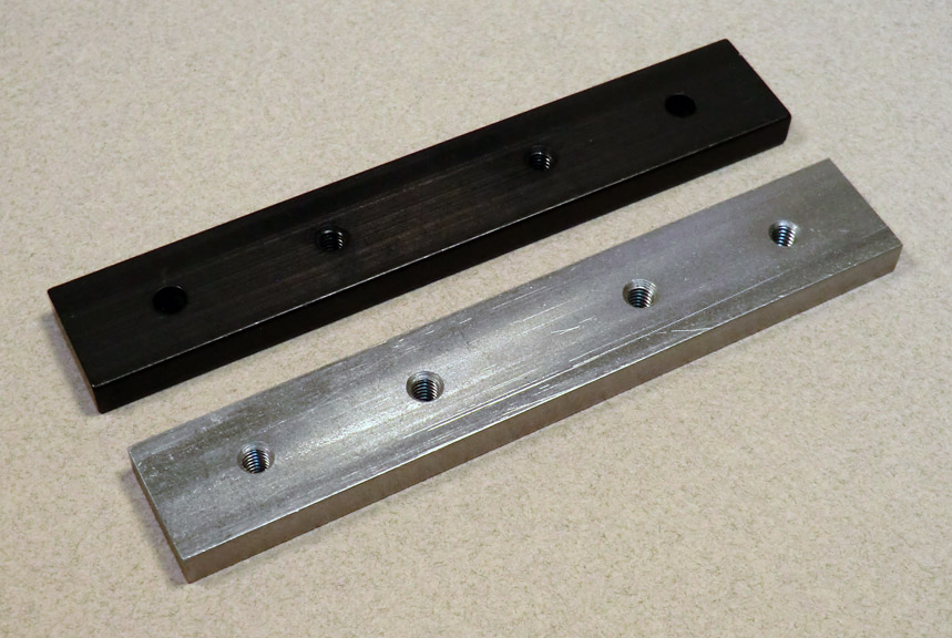

The metal fab department at work had some steel that was the exact same dimensions as the cross bar of the Field Marshall scope bracket kit. Got a piece chopped down to length and I got the holes drilled and tapped.

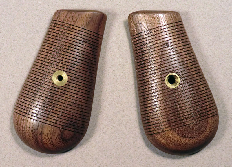

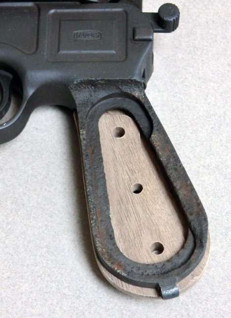

I eventually received the proper grips from Chris and I got them fit to the grip frame with a tiny bit of sanding. The walnut was already pretty dark, so thanks to tennantlim for the tip on using shoe polish for stain - I think if I had used actual wood stain, they would have turned out way too dark. I gave them a couple coats of Birchwood Casey Tru-Oil and then a light buffing with superfine steel wool. I also ammonia fumed the brass escutcheons for about an hour to knock down the shiny "newness" before I installed them. Yeah, I'm neurotic that way. :p

On the solo's hold grill: Aaron determined that the original part is not symmetrical side to side. I provided the reference photo of the original prop to him for that along with the MGC reference measurements to determine scale, and that's what he came up with. I can't fault his finding, as when you do proper scaling and measure it certainly looks like one side overlaps longer than the other. (shrug)
Anyway... the SH at least is scaled to the proper proportions for an MGC since that is what the original prop was. I don't 100% know about the FM, on what he scaled from, but I know initially he was making things to fit Denix, since he told me no one has MGCs. Those were his words at the time.
The 48th Ronin
Thanks Scott! That's what I was wondering - I stared at those pics until I was cross-eyed, but couldn't really make a determination one way or the other.

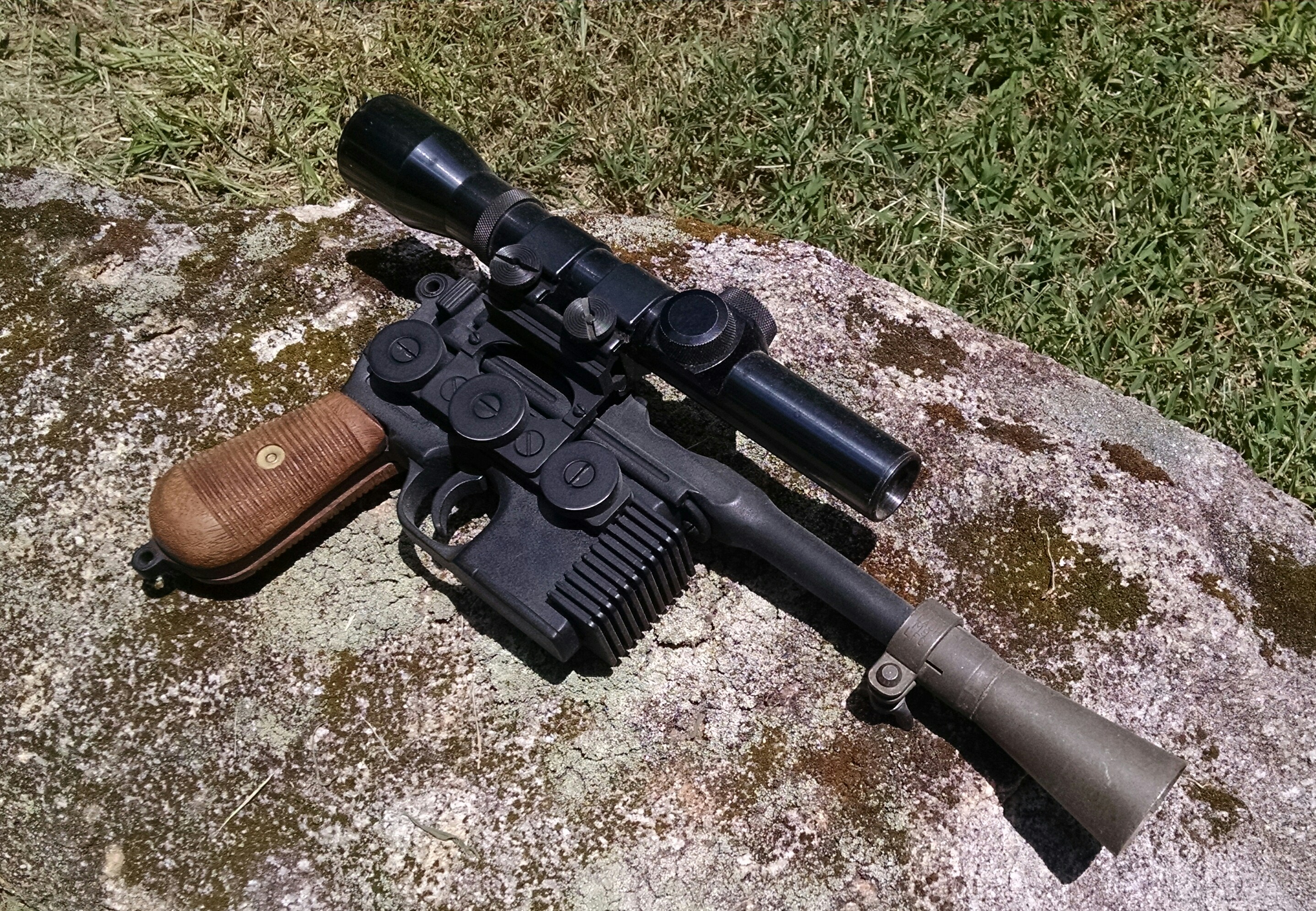

Not a great picture, but it's hot outside, lol
If my memory is right, I bought the scope, flash hider and the scope bracket/hardware from Gavidoc. 95% of this forum were not around back then to know him, but he knew his stuff and helped me quite a few times. A great guy.
