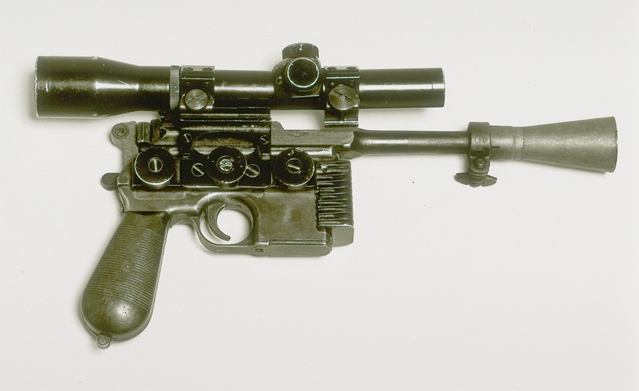

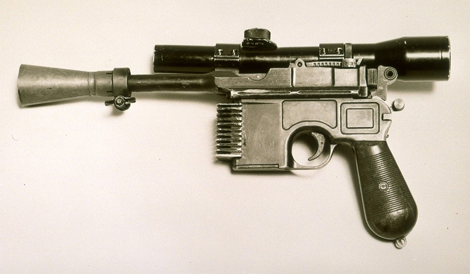

Okay...now I'm all excited :thumbsup Btw...been hunting all over the old threads, and it escapes me. Anyone have a solid scene pic of Solo with this blaster?
10621281_10205611426631992_10338719_o.jpg10813699_10205611426551990_1204548202_o.jpg10813704_10205611426511989_1928738035_o.jpg10815251_10205611426311984_809486334_o.jpg10815476_10205611385070953_1050918904_o.jpg10819393_10205611426431987_811480111_o.jpg10819667_10205611385030952_1462897935_o.jpg10819667_10205611385030952_1462897935_o.jpgThese are the ones Scottjua shared with me, and used for his prototypes, and one offs for reference.
Here are some others that Kpax,Adamanta, and I believe Odiwan? posted in other threads. compacsuper-big.jpgnew-cs2.jpgnew-cs4.jpgnew-cs5.jpg

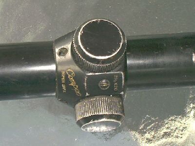

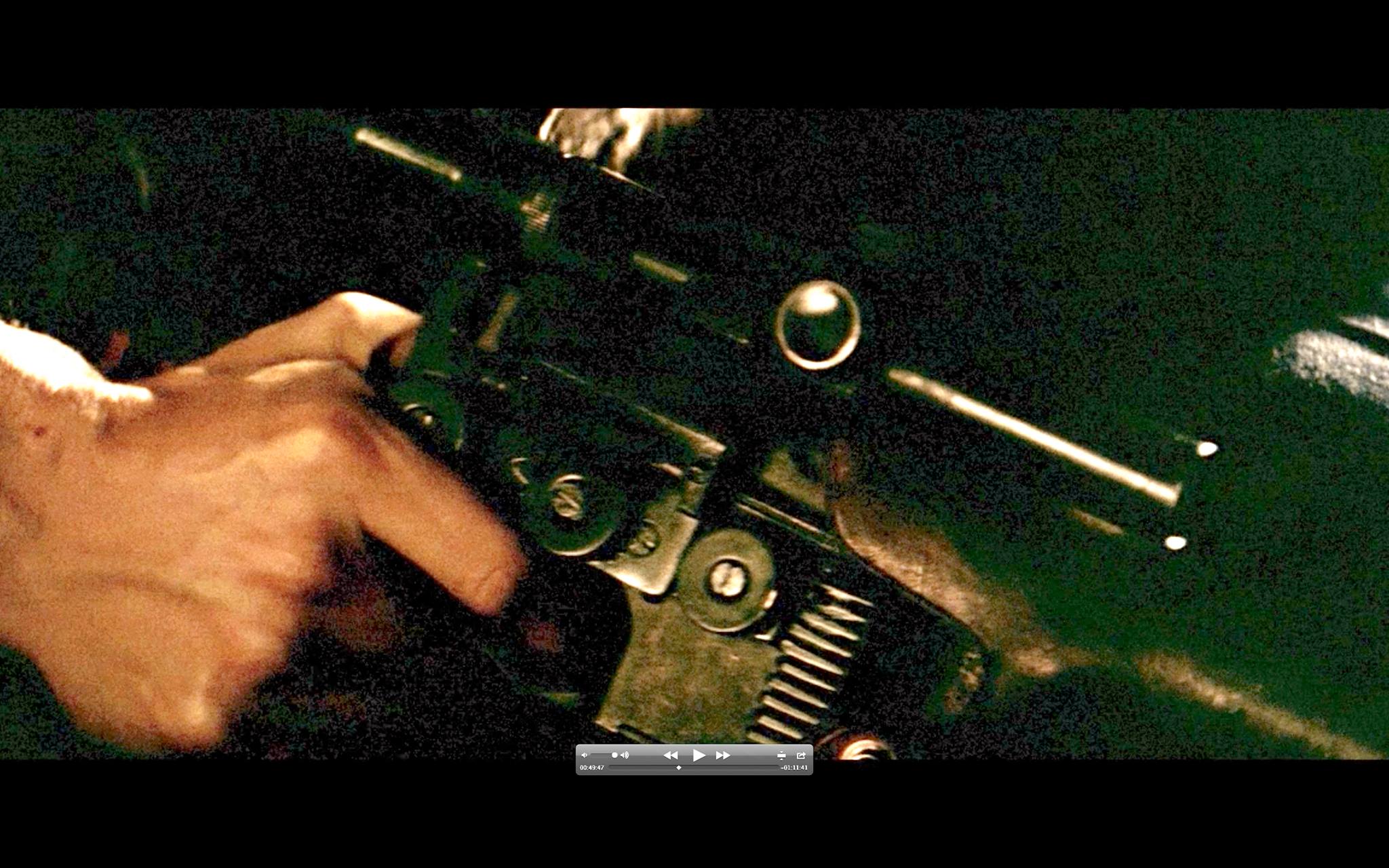

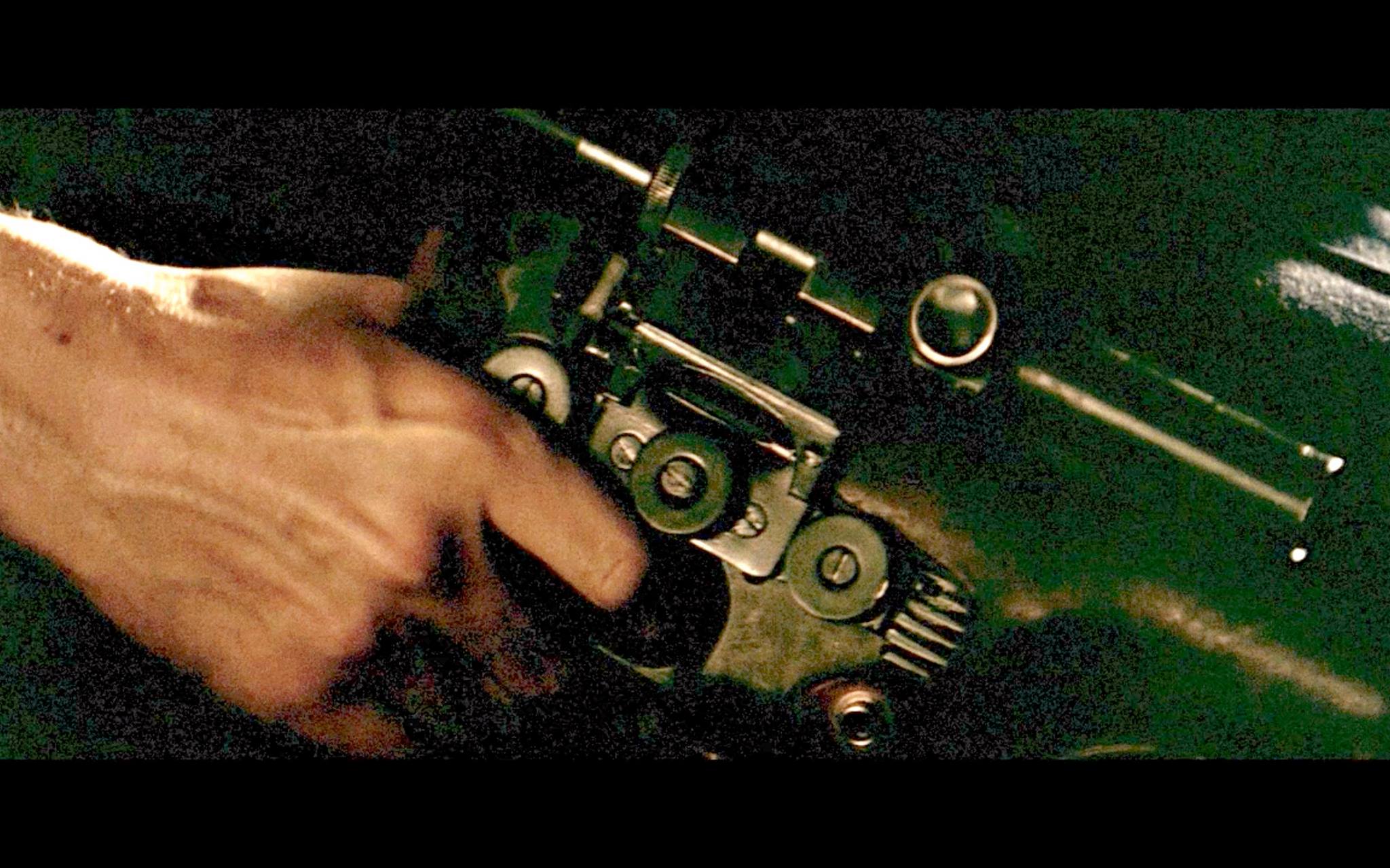

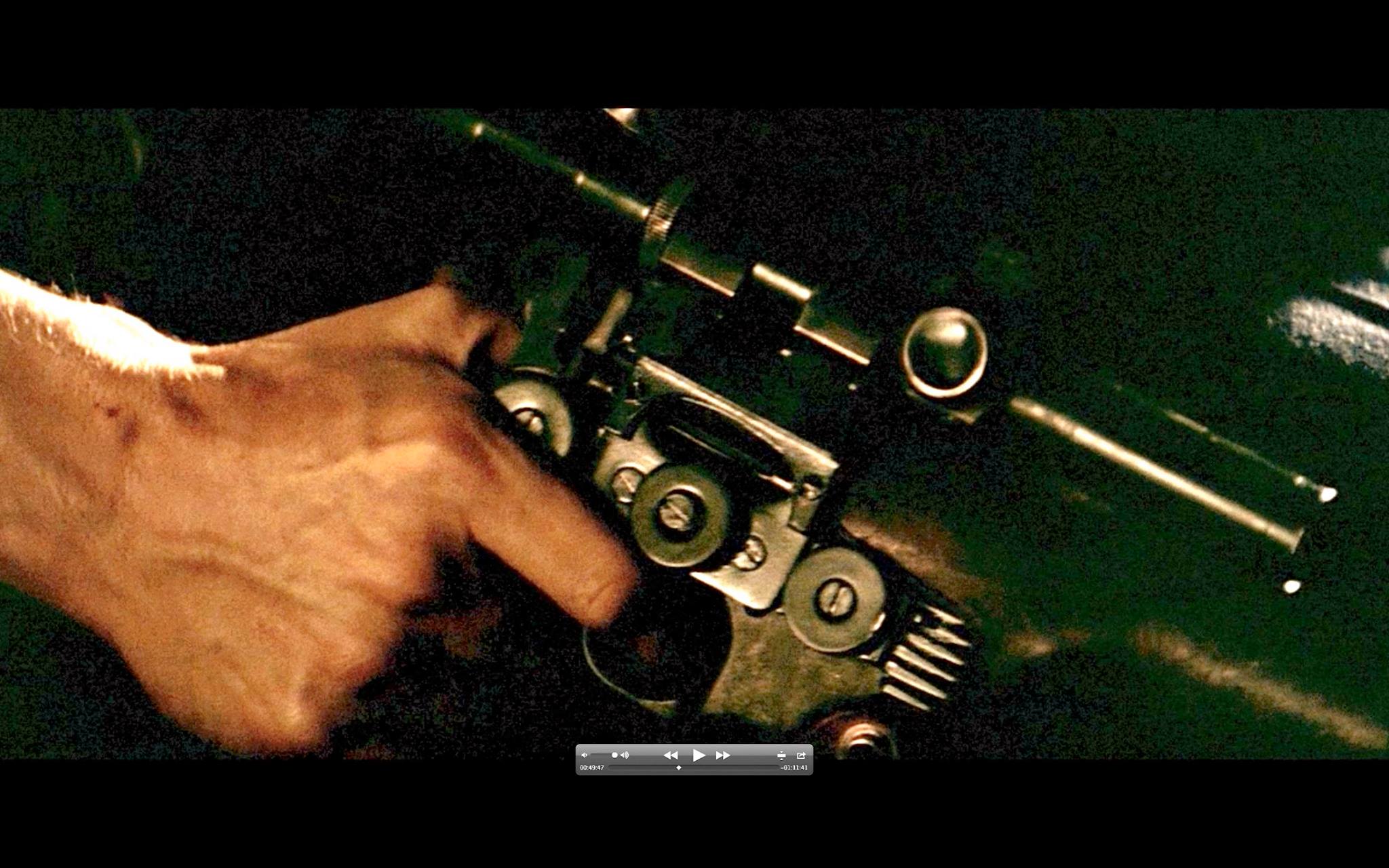

It is commonly believed that the scope rings on the screen used GK are different than those shown on the archive images. I personally have those different rings on my blaster. However when I stare at the screen grabs, I cannot for the life of me see anything that makes me think they are different from the archive photos (except for placement). Could someone convince me one way or the other?
yes... they are completely different from the post production chronicles shots.
you can very clearly see the weaver rings here. They seem to be the mid - high variant, or a low variant with the coupling face mounted high above the tension ring.
Same as in my pics above that Aaron posted.
If you look at the two styles straight on you'll see the difference. The "football" style don't have a flat edge to them...

I see what you're saying. I guess the big problem was that I could interpret the line/reflection of the rings as the line where the top and bottom half of the football style rings join. But now that I look at it; if that was the case, that line would have to be higher up and halfway between the bottom and the top of the scope itself.
I find it odd that the fasteners/thumbscrews are almost invisible. It seems like with all the reflections going on, you would see some of the details of them.
Thanks.
they're definitely flat sided on the screen used. I BET, they changed it because the football style was not able to go into the holster...

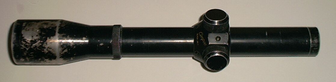

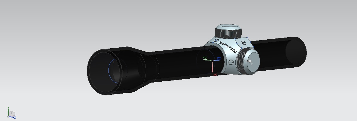

Here is the deal with the weavers, you can find them on Ebay and Gunbroker pages pretty easy. Now I mocked up this style weaver, and as you can see I didn't concave the face of the knob.. My big question is since they obviously bent the scope to make the forward weaver perch on the barrell, and I was under the understanding that the KIT consists of the following:
1. Supercompac REPLICA
2 Greasegun Flash hider Replica
3. Grill with 11 fins and screw
I have all the fasteners Scottjua sent me for the Scope mount, I left some stuff open to you guys to Nitpick, and from looking at some of the members( SCOTTJUA's) recent GK commissions I understand why he mounted the weavers next to each other.( I just have to add the through holes and countersinks on the mounting bracket parts) For consideration, making Weavers is gonna be a real nightmare considering that Weaver setup tooling for god knows how many parts in production. I suppose there is a couple ways to approach this. The other thing is that I did look up the same source that DEC used for the DL-44 parts GS mineral glass, and I have figured out the threads on the scope, whether they are purely cosmetic is a factor as the scope replica would have none functional Windage knobs, and the lenses would be cosmetic... Lets here it??

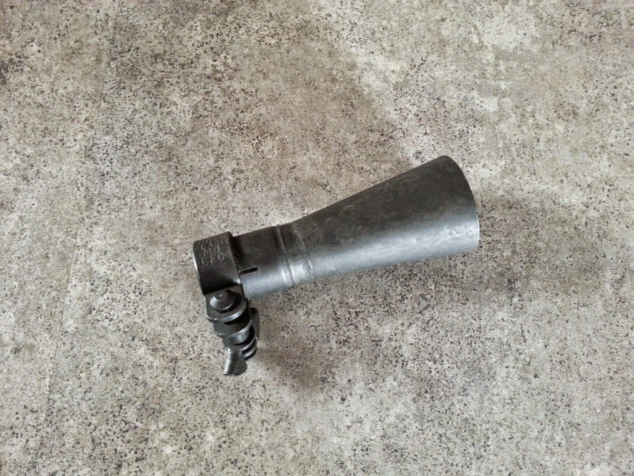

Also the Flashider thumb screw is a PITA, I think about how they made it back then, those guys and girls in those factories were hardcore, and quite brilliant. They took the stamped part and folded it.

The football style weaver rings: The front one just free floats completely. It doesn't actually touch the barrel at all, best I can tell. There's a couple photos of Ford holding it semi-toward camera in the post production promo shots, and it looks to me like it's just floating in mid-air. Kind of pointless.
The screen weavers: I think there's little to no point remaking these, as people can find them online AND make up their minds on whether they are high, mid, or low rise versions. I THINK the screen used were mid or high... but I've had those and prefer the LOOK of low rise. The high looks goofy to me.
For the scope: I think a see through (read: straight tube) with glass lenses would be fine. Making a functional scope would be WAYYYY too expensive, with real optics. IS there any way to do a cross hair? Even just for bobo goofball purposes?

Yes of course the Mount parts and hardware would be part of the Scope kit portion, I am sorry guys, I failed to be specific I been crushing daylight into the night and getting a little crispy lately.
Let me pay some scrutiny to the Grill, and work out the size of the Lenses. Now please help me out here on the dimensions of the mineral glass for the none functioning scope.
I know you guys went through this with the DEC kit Wetzler Scope. domed w/ flat bottom??? My question is really thickness, 1-2 mm? Please chime in. I will be contacting GS here pretty soon.
The way I have the Knurled windage knob is actually 2 fold, they are Faux and actually hold the Windage Bumpout on the scope tube. the short screws are Faux, and are only 1/8th".
I will break it down asap.
