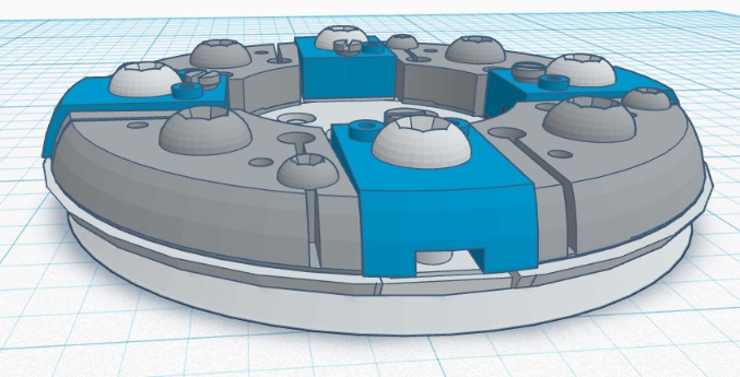

At least the part isn’t too hard to replicate. I already made a 3D model a while ago that’s almost spot on, if I make a few minor tweaks it should be just about perfect.
Now, as for that wedge greeblie... XD
I went ahead and tried to tweak my original greeblie model to match the accurate part. It still needs to be cleaned up a little bit what do y'all think so far?
Oh I love it! You even got the blue sections raised over the silver ones.
It seems to me the edge is a little lower of an angle, and straighter, leading to the backplate of the part, which also seems to be one layer and only slightly beveled inwards

Which edge are you referring to? What should be lower and straighter?
Sorry about that, the actual rim of the piece, I'm not sure it's so curved, more of a flat bevel
Ooh, I think I see what you mean. The edge around the top half you think appears more conical than beveled. It could be, it's hard to tell from the pictures. If it is straighter it would certainly make modeling it easier.
But I think you might be right. I'll go play around with that on my model. I also think that I made the middle hole a little bit too deep.
