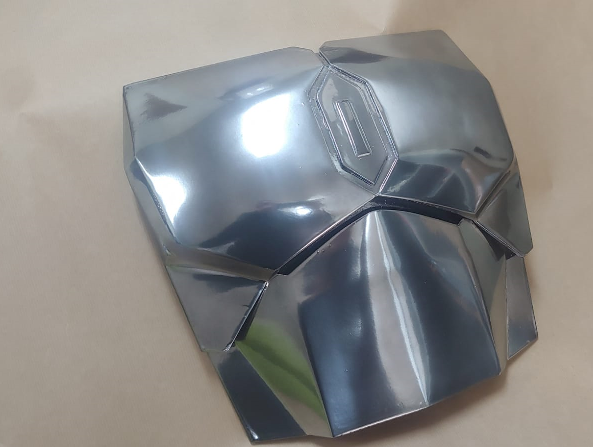

Hi BobRoss. First of all, you need a VERY smooooooth surface. Smoother will became better results. After that, paint with a shiny black finish. Now you are ready for the chrome effect. I´ve used Alclad 2 chrome.
The result will be something like this:
