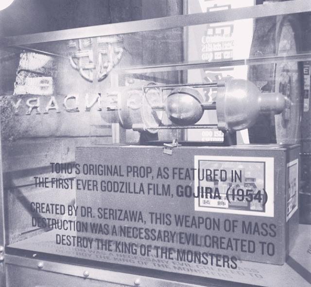

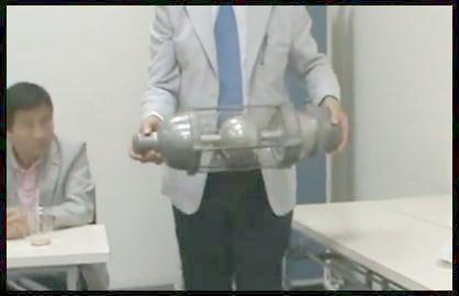

The one in the film doesn't appear to have one at either end, but the kit replica talked about further up this thread has one at both. And some shots of one being shown off at TOHO have one:
(That's Akira Takarada, by the way.) I'm wondering if they have more than one? Perhaps there was a hero prop for the actors to carry around and a functional one for the scene where it pops open. Or maybe they have a repro for showing off to visiting foreigners and the 'good' one locked in the glass display case:

which also looks perhaps a bit shorter, and more authentically metallic than just painted..

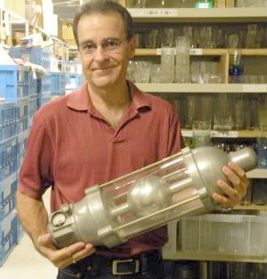

Here are, I think, the photos that were on this page as well as others I've collected.
These are the original prop.

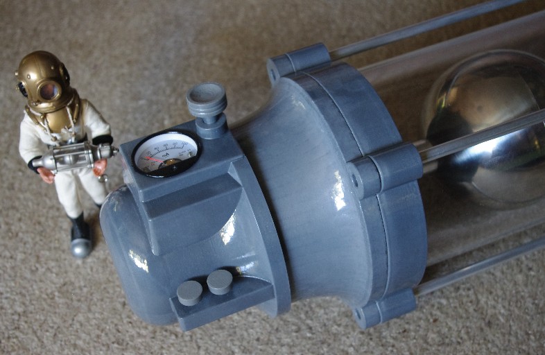

macropod80
Thanks for that ED209! Those are some great photos that I wish I'd had a few weeks ago.

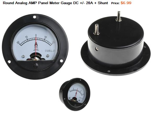

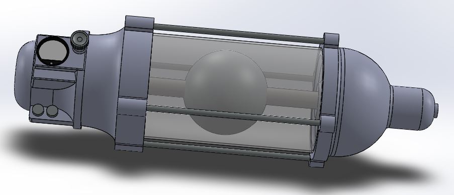

That panel meter seems big to me - I've got one on order from China that's 45mm dia. (I think China's the only place that still uses them.) Tried one at 60mm and just couldn't squeeze it in. Though I'm still not satisfied with the proportions of the box it's set into. Will have to keep tweaking.
62cm total length of that replica is reassuring - mine's currently turning out right on 60cm:
Still not convinced those TOHO people aren't waving around two different ones...
Thanks again.

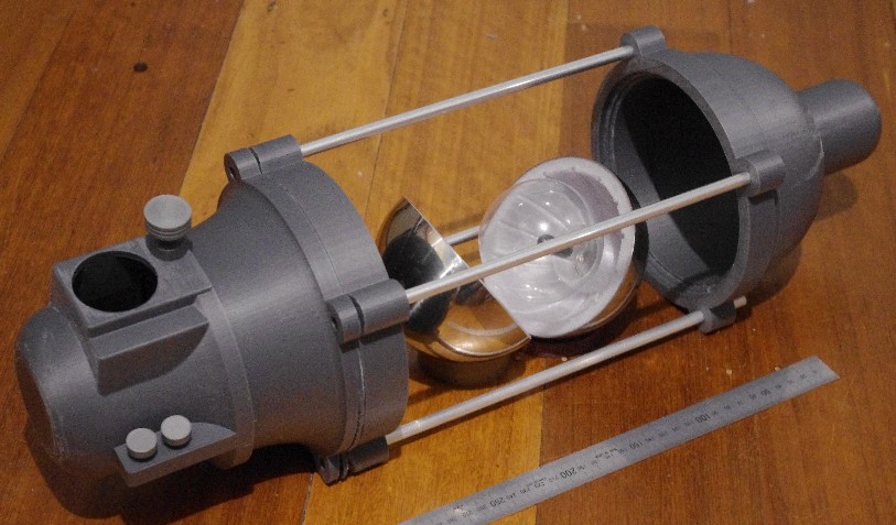

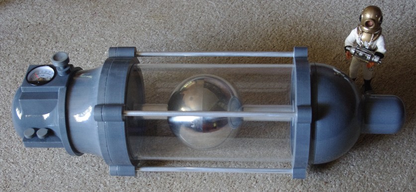

Getting close to completing the static version:
It compares quite well to the photos further up this thread, I think. The shiny grey bits - on the left (I'm calling that the 'control box end'), and the right 'dome end' - are printed in ABS that's been acetone-vapour- dipped, giving them a nice light gunmetal kind of sheen. The other big bits are currently just PLA, which I hate because it's a bugger to sand and smooth, but my printer's still having issues with warping on the larger ABS parts.

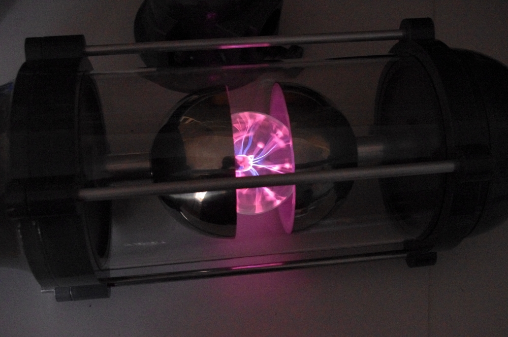

The plasma ball comes apart and reassembles surprisingly easily (the glass globe just pops off - no desoldering required), but haven't yet found a piece of wire to extend it with. The wire up the centre of the thing is rated 20000volts, 20 Amps.
I only need to extend it about 10cm to get down that 25mm aluminium tube to the circuit-board inside the main body, but the electronics guys at work get nervous when I tell them about the 20kV. I can buy the correct stuff in a 100m roll for about $150, but obviously I'm looking for a cheaper alternative.

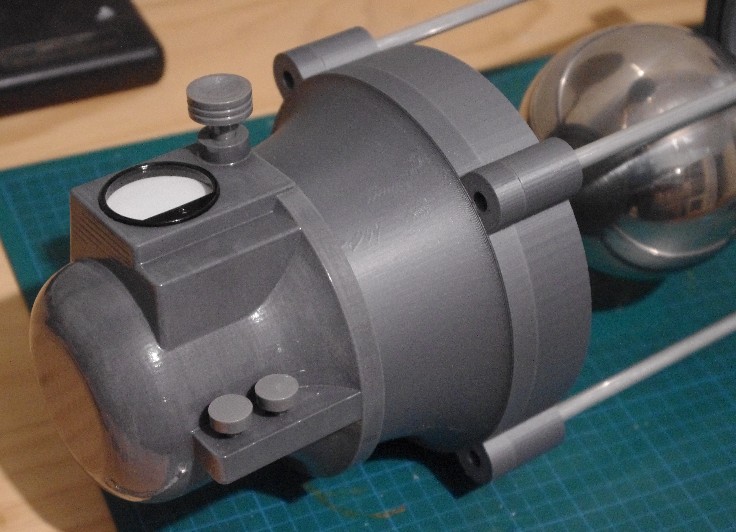

Still waiting on an actual meter from China, so have printed a dummy temporary hole-filler:
Ultimate aim is to be able to have the central sphere pop open, to reveal the glowing plasma ball, and maybe some blinky/flashy LEDs around it. But first stage is finishing the static version once I get the meter and some acrylic tube.
