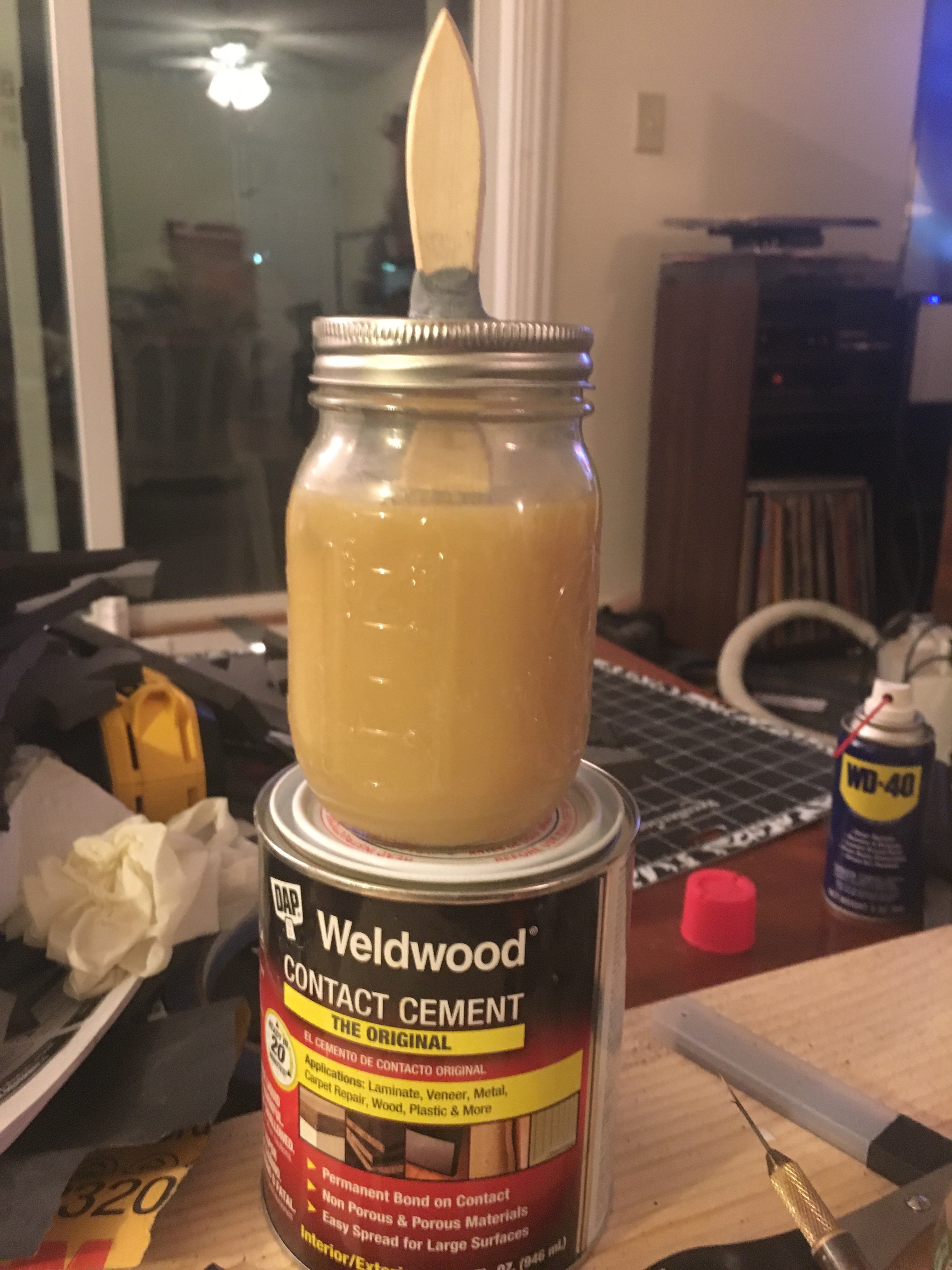

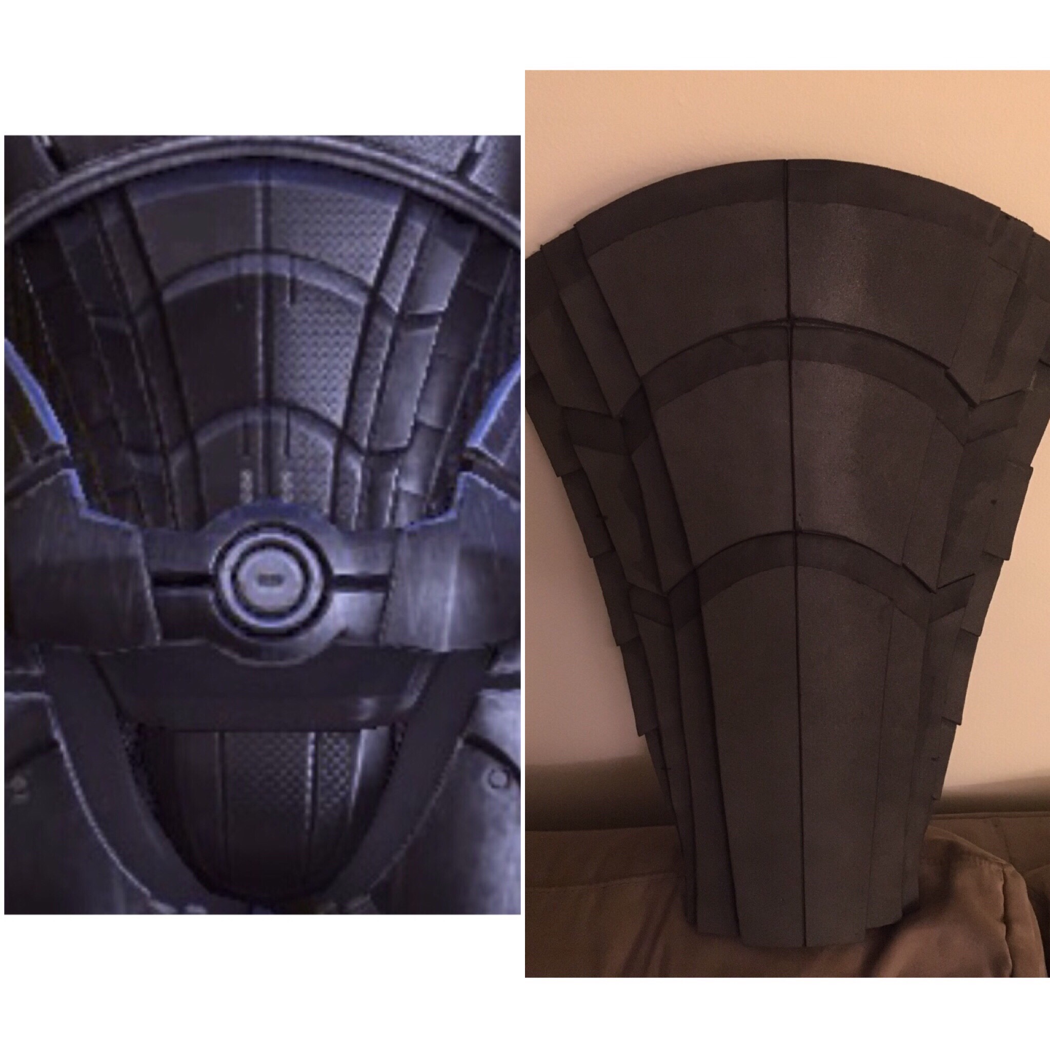

Working on my mass effect 3 build, and as I'm working on the abs, I glued 5 thin layers in total. As I'm beginning to heat it and shape it, I'm getting a little worried of things beginning to come undone. I know I can finish shaping it in one piece, but some edges and corners look like they may come off a bit. I'm using DAP Weldwood Contact Cement. Instead of tearing it apart and redoing it with extra layers of glue, is there a way to reinforce it to ensure it'll stay together? Should I just use a glue gun in key spots? Or when I patch things up with Kwik Seal, you think that'll be enough?

I was initially going to get barge, but didn't find it at any local stores. At least the couple I checked out. So I just went ahead and went with DAP Weldwood Cement
