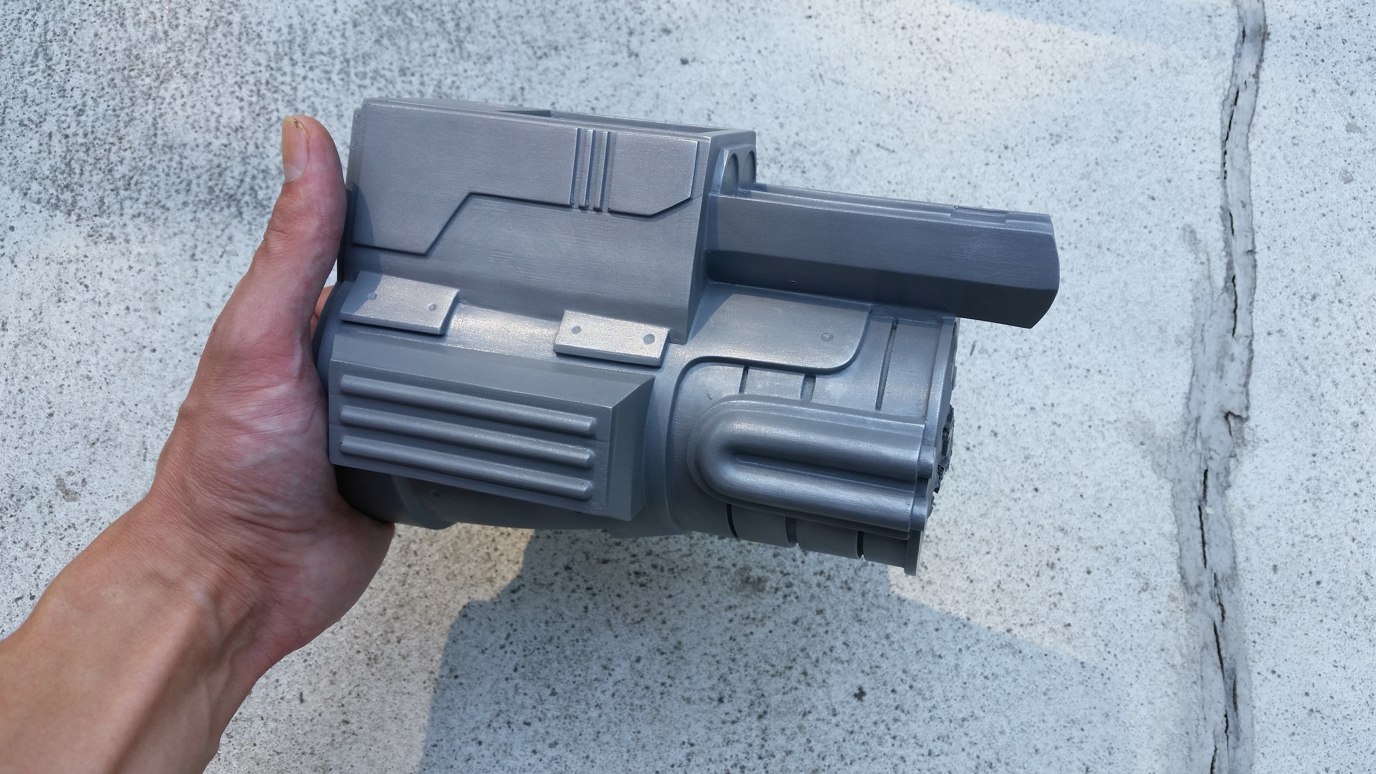

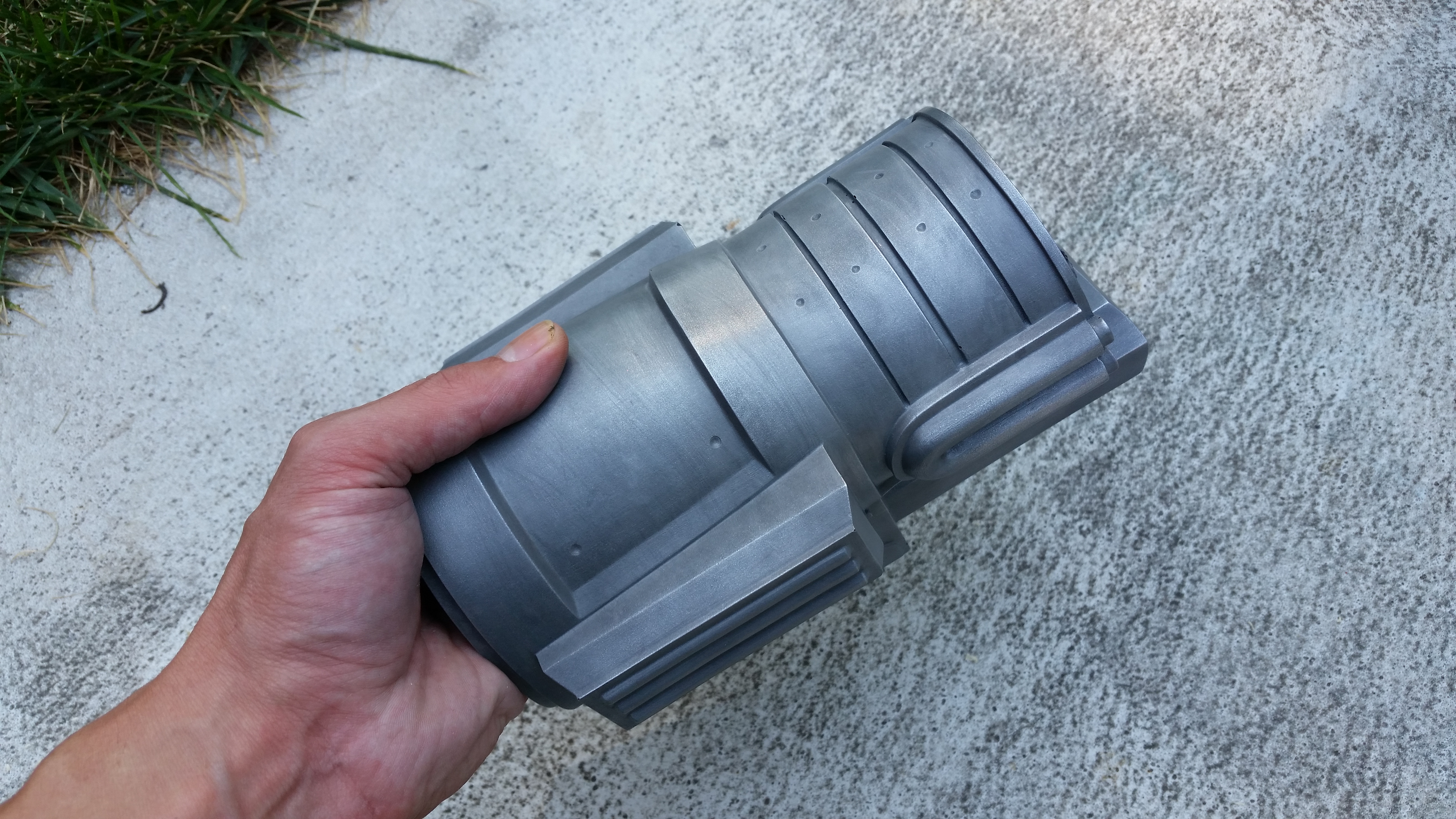

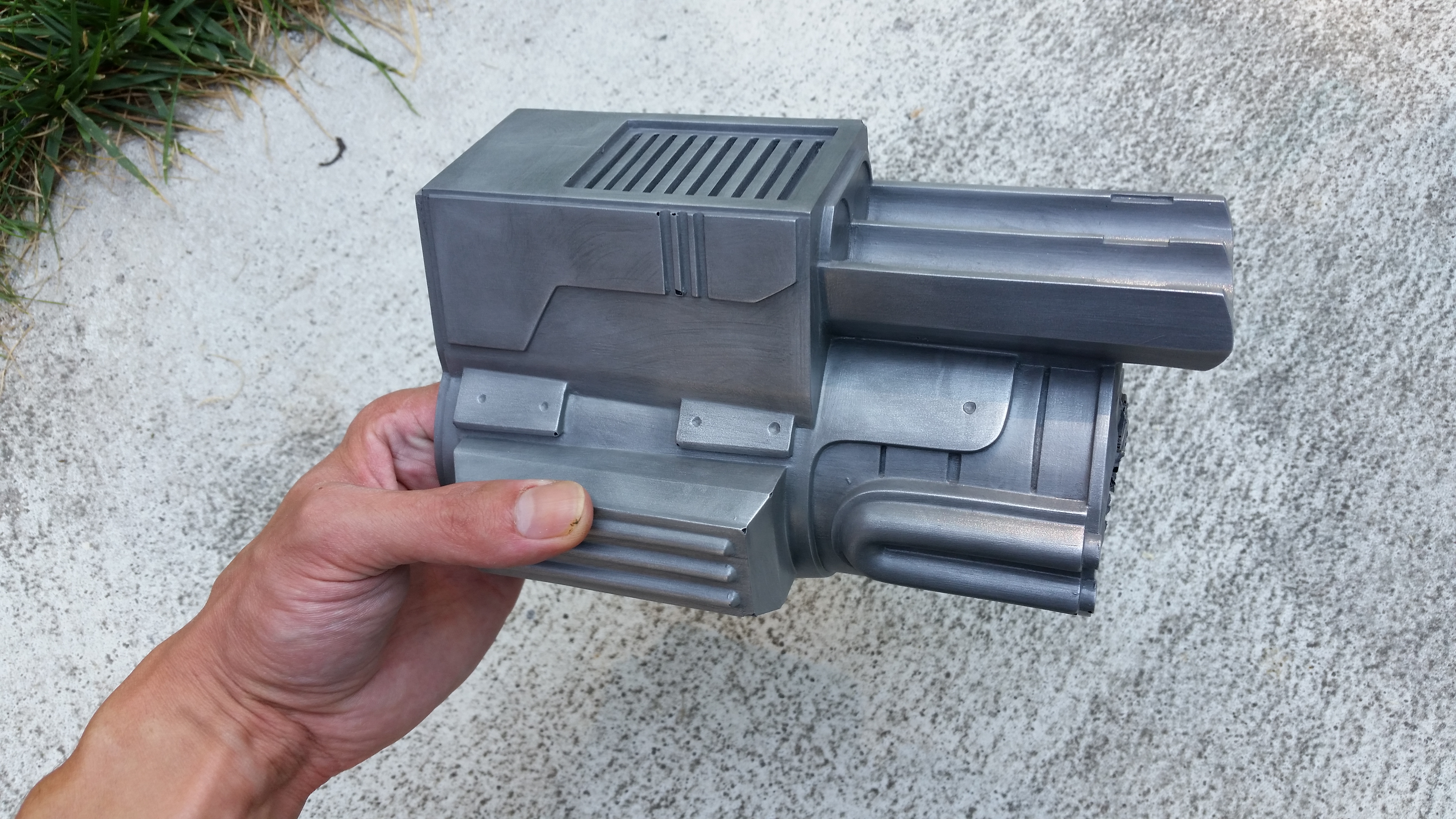

Did this one with aluminum powder and Smooth Cast ONYX. I think the ONYX goes better with the powder for stuff like Fallout props, the part looks dirtier. Note the pictured cast is with no weathering, just a quick buff up with steel wool. You'll see a few surface bubbles there, too. I sort of powdered my mold a little too much, had a few areas effected by that. It's okay, though. These holes will be used for rust pitting when the part gets finished. These look pretty rusty in the game, so that's what I'm aiming for.

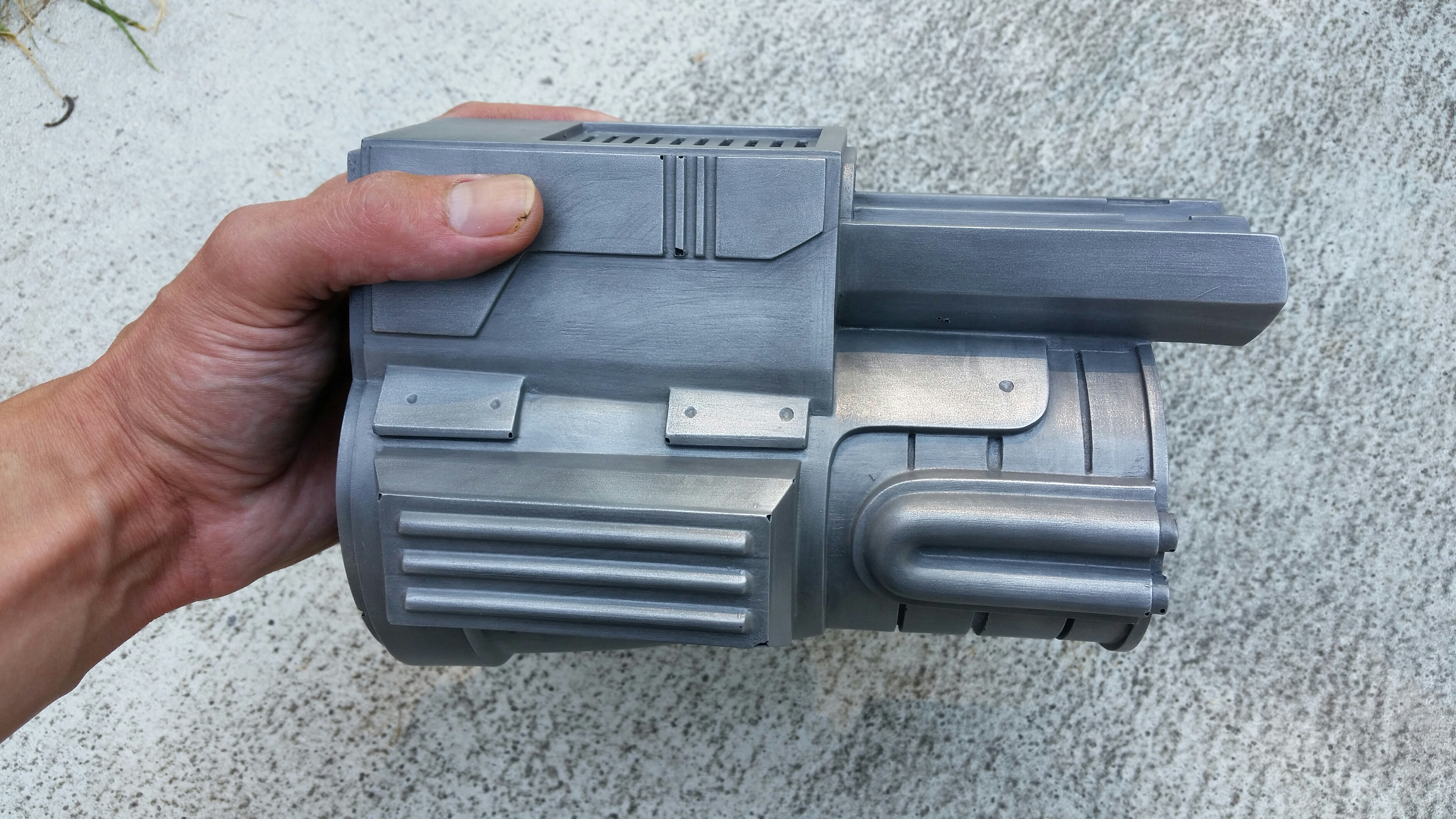

This one I did with aluminum powder and Smooth Cast 325. No tint added to the resin. It looks nice, but is a little cleaner than with ONYX. This would be nice with most props I'd imagine, but as mentioned, the ONYX suits a Fallout prop better. Still, quite happy with it. Hardly any bubbles at all, just a little flashing to clean up.

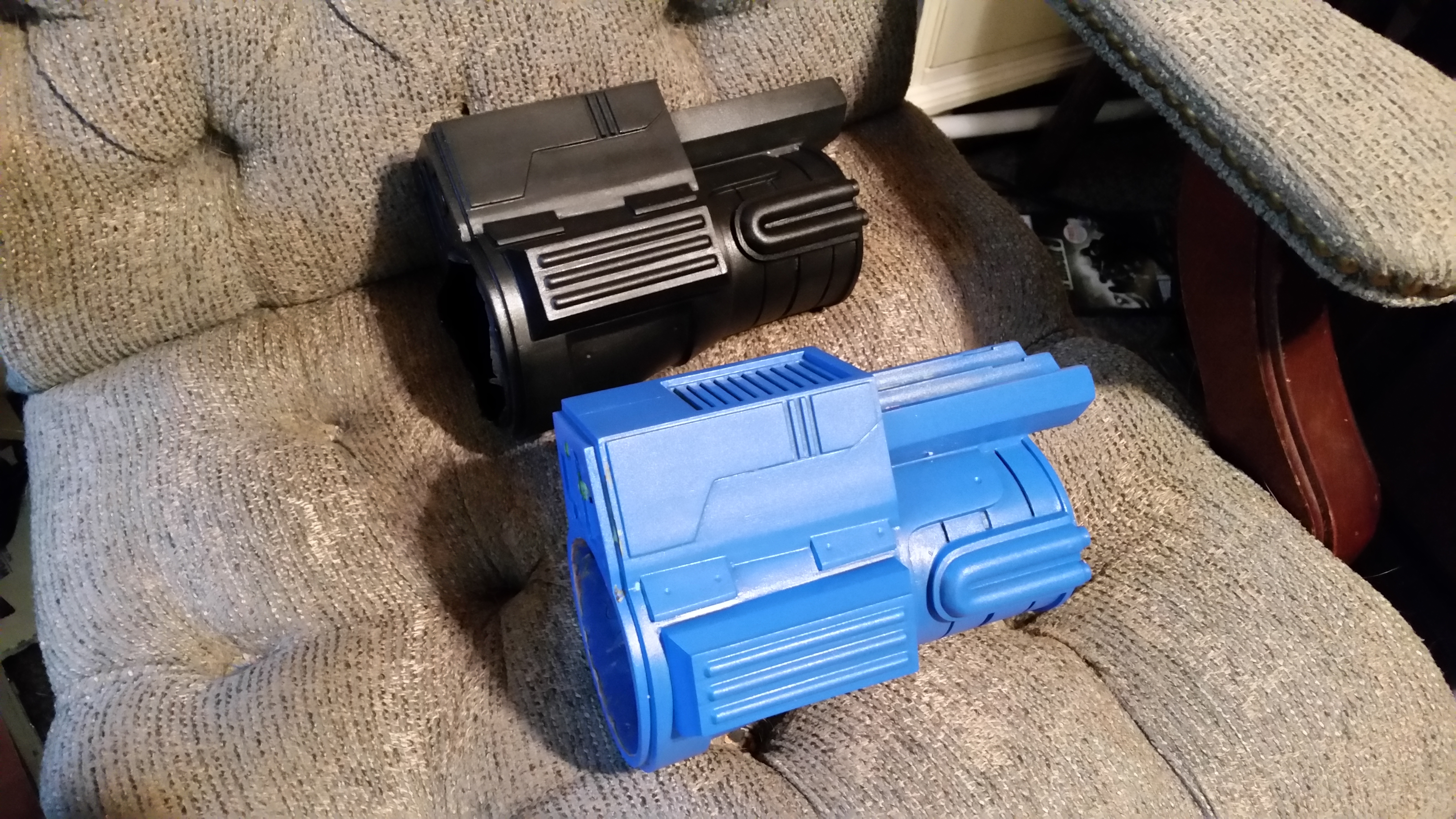

A little more progress on this one this weekend. Still needs some more love, but it should be ready for painting soon. Need to finish cleaning up the trim and the grille. Hoping to have paint and rust kits in the next week or two. Also need to modify the glove still. Once everything else is done, I'll add the various screws and rivets. Overall though, I'm very excited with how it's turning out.

The metallic finish under the paint is actually the cast. I cold casted it with aluminum powder, then buffed it real good to expose the metallic surface. In the earlier pics of the cast, it had not been buffed up yet, looking more greyish than metallic.
I painted with a dark gey, then I use steel wool to wear and weather the paint. As long as the enamel is fully cured, you can use a little acetone to break up or chip up some of the paint as well.
