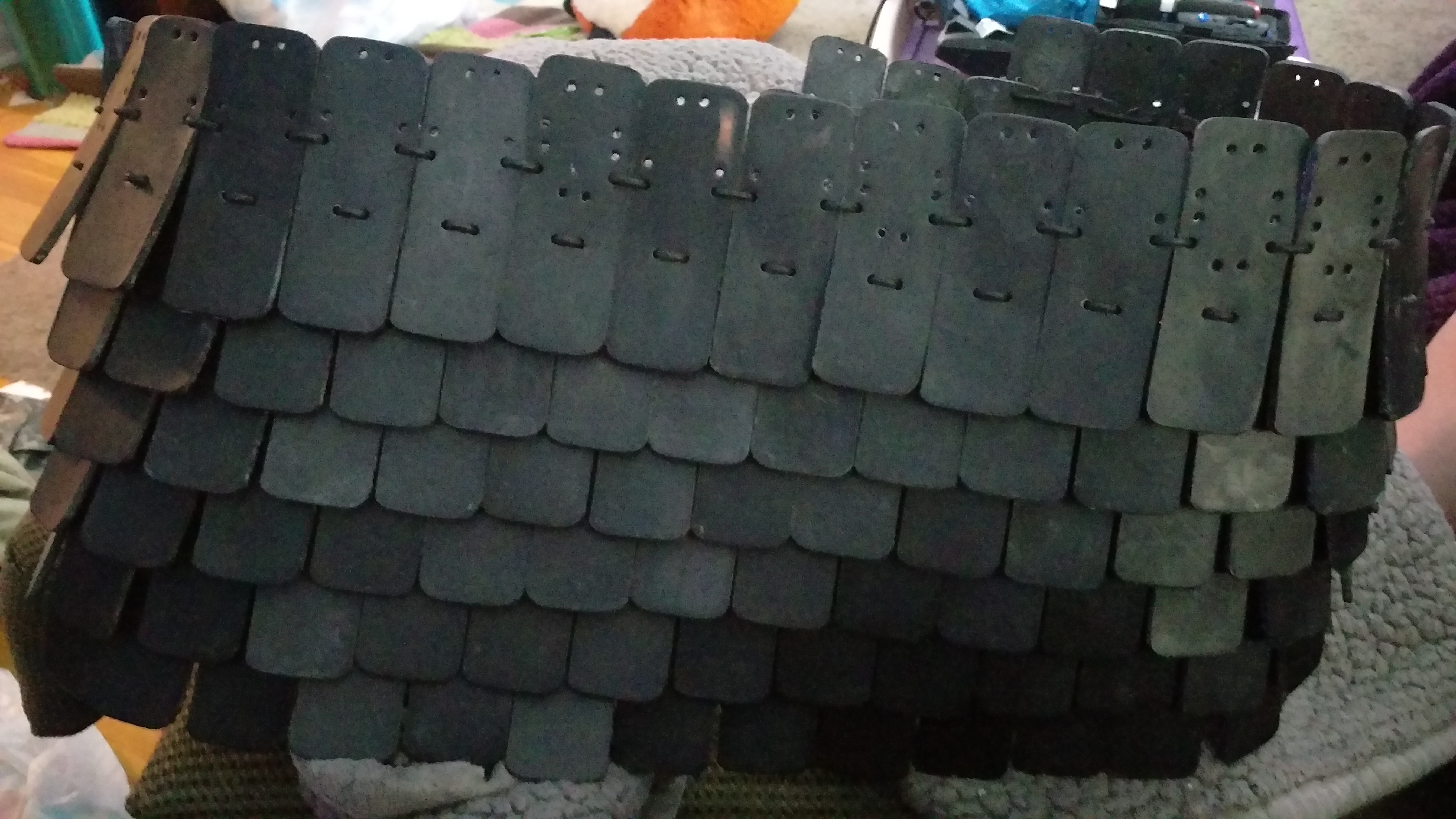

Here's the result, set out to finish drying. I'll do another layer of oil, then beeswax solution tomorrow, then I start the build while I wait for another batch of vinegaroon to brew.
Cheers!
And we did the vinegaroon in stacks, so the coverage wasn't perfect. The only spots that didn't get covered are going to be hidden by overlapping layers

Also otter, the plates are pretty well uniform. The differences in color you're seeing are from oiling. Some plates were thirstier than others and so the oil hadn't been soaked up by all the plates, leaving some looking wet and glossy, and therefore darker, for the picture.
There is some variation, just not as much as it looks in that photo
Four coats of linseed oil, and a beeswax finish.
I'm applying the wax in groups of 90, then adding them to the armor. The rows are 30 plates wide, sp every day I'll add 3 rows. It'll be about 6 days before the chest armor is done, then I get to work on designing the mantle.

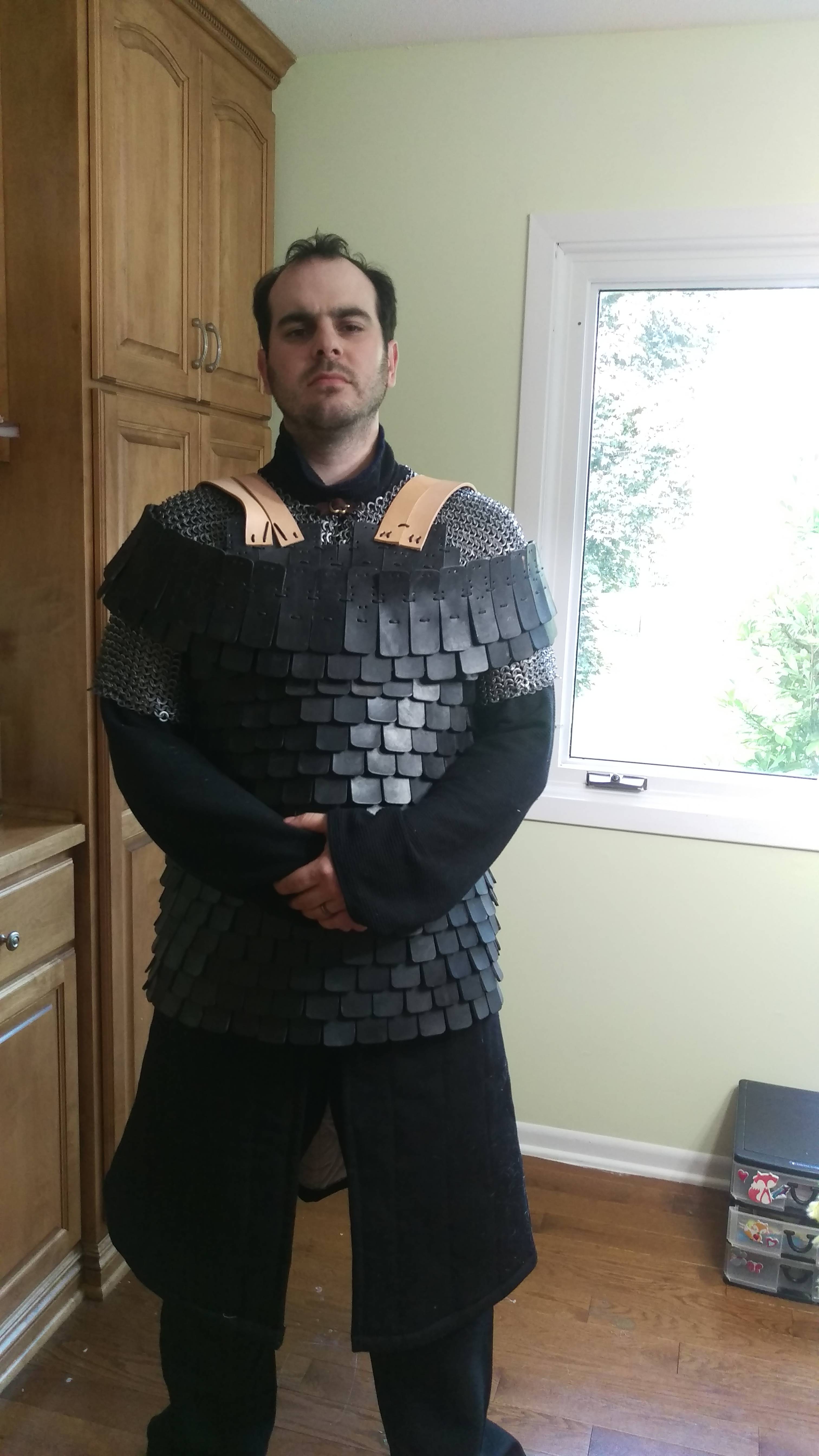

Making some good progress on the armor, as well. Need to dye and oil some more, and make another batch as I will probably need to cut more plates. I'll post more pictures when the gambeson comes in, and I finish the body portion of the armor
As you can see, things are really coming along.
I have a long way to go, still. Need to finish the mantle, which requires me to design a way to do that. Then make the plaque, fade the clothes, and fasten the armor.
I think it really is looking good.
