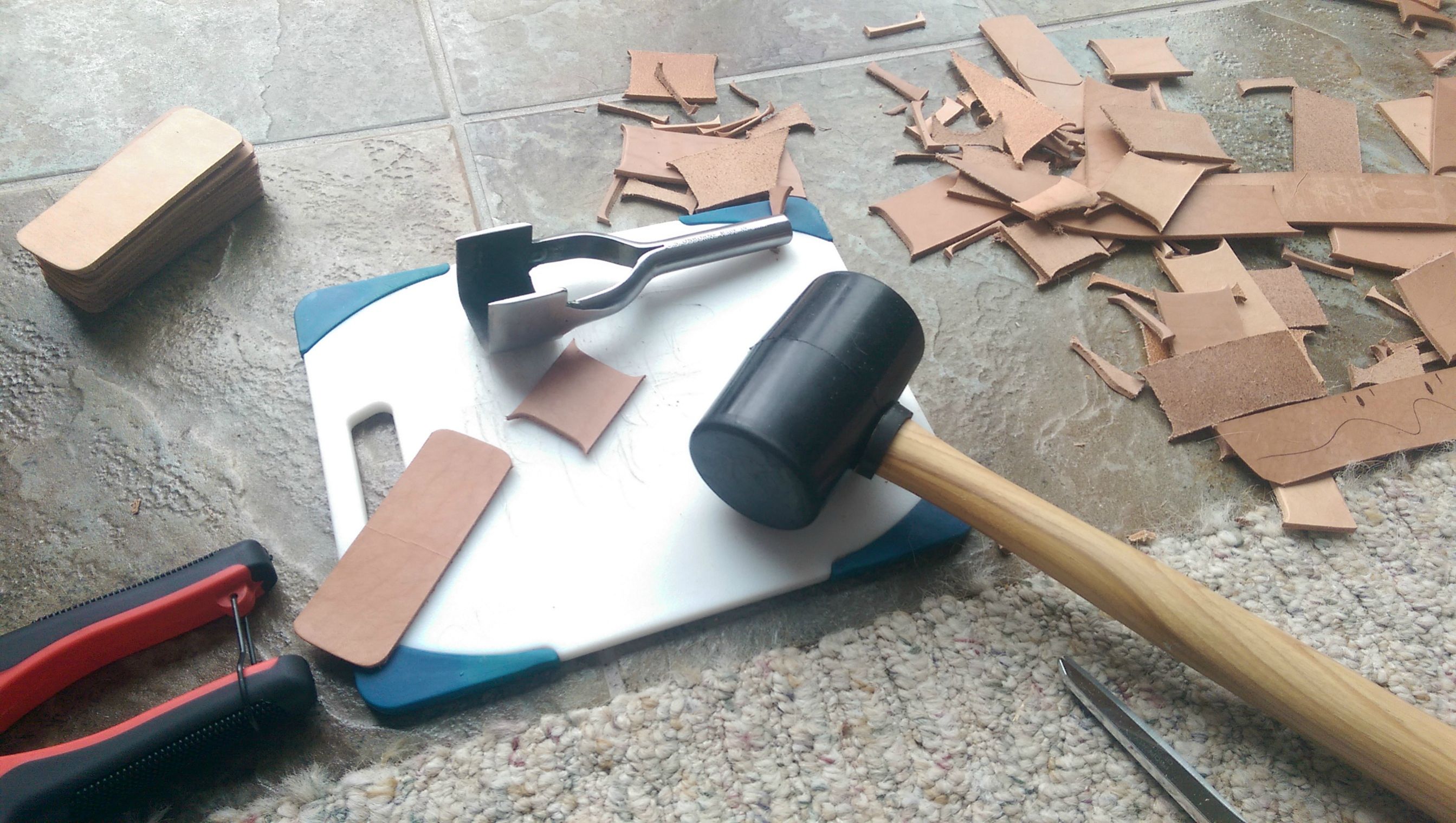

Tools and materials:
I found someone who was selling 1.5 inch wide leftovers from his belt making business. Every one is long enough to make at least 1 lamellar plate, some long enough for two. I've upgraded my mallet to a proper maul and things are moving much quicker.
30 pounds of belt scrap:
Should be plenty. It's a LOT of leather.

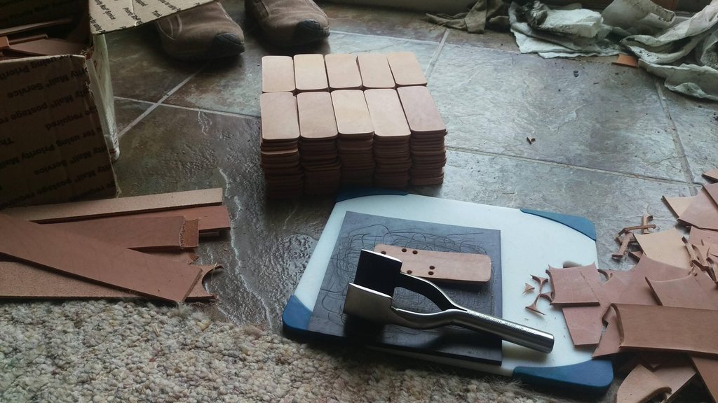

The cutting process:
My end cutter is 1.5 inches wide, same size as the leather. I'm using a "Master Mold" for the guide both for length and hole punch
Some cut and punched plates:
The top and bottom holes are offset so it looks more like fish scales and less like lamellar plates

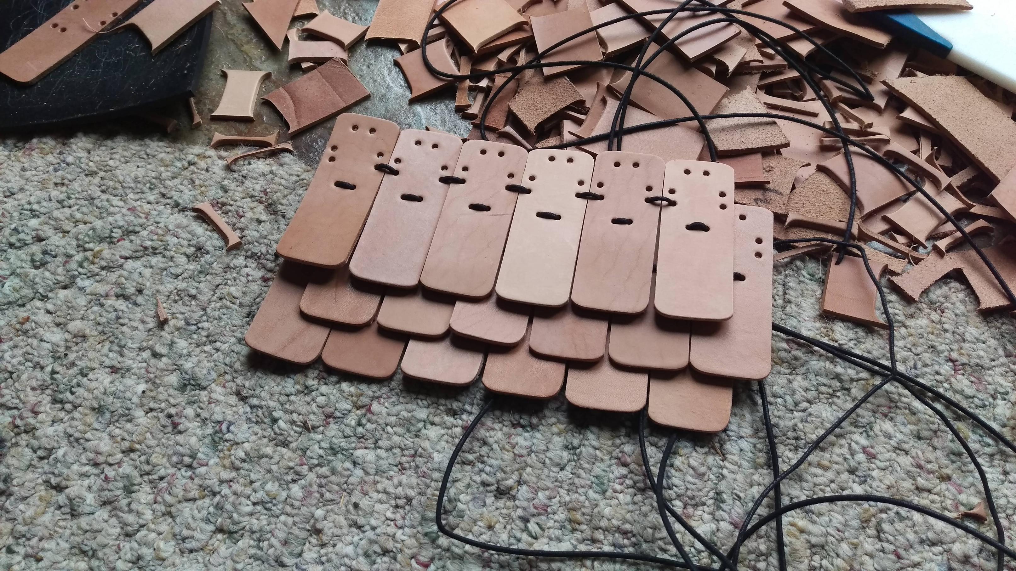

Proof of Concept:
Once there's lace running through, the tabs will be pushed off of the scale under it, giving it more volume. Otherwise, the scales (after some alteration, getting the holes lined up correctly) look like they're work exactly as intended.

PROOF OF CONCEPT
This will work just fine for my needs. Looks great, feels great. When bent (like to contour a human torso) there's a beautiful amount of flare as the scales press off of the lower rows.
This is going to work, and it is going to look amazing (after an absurd amount of work)
