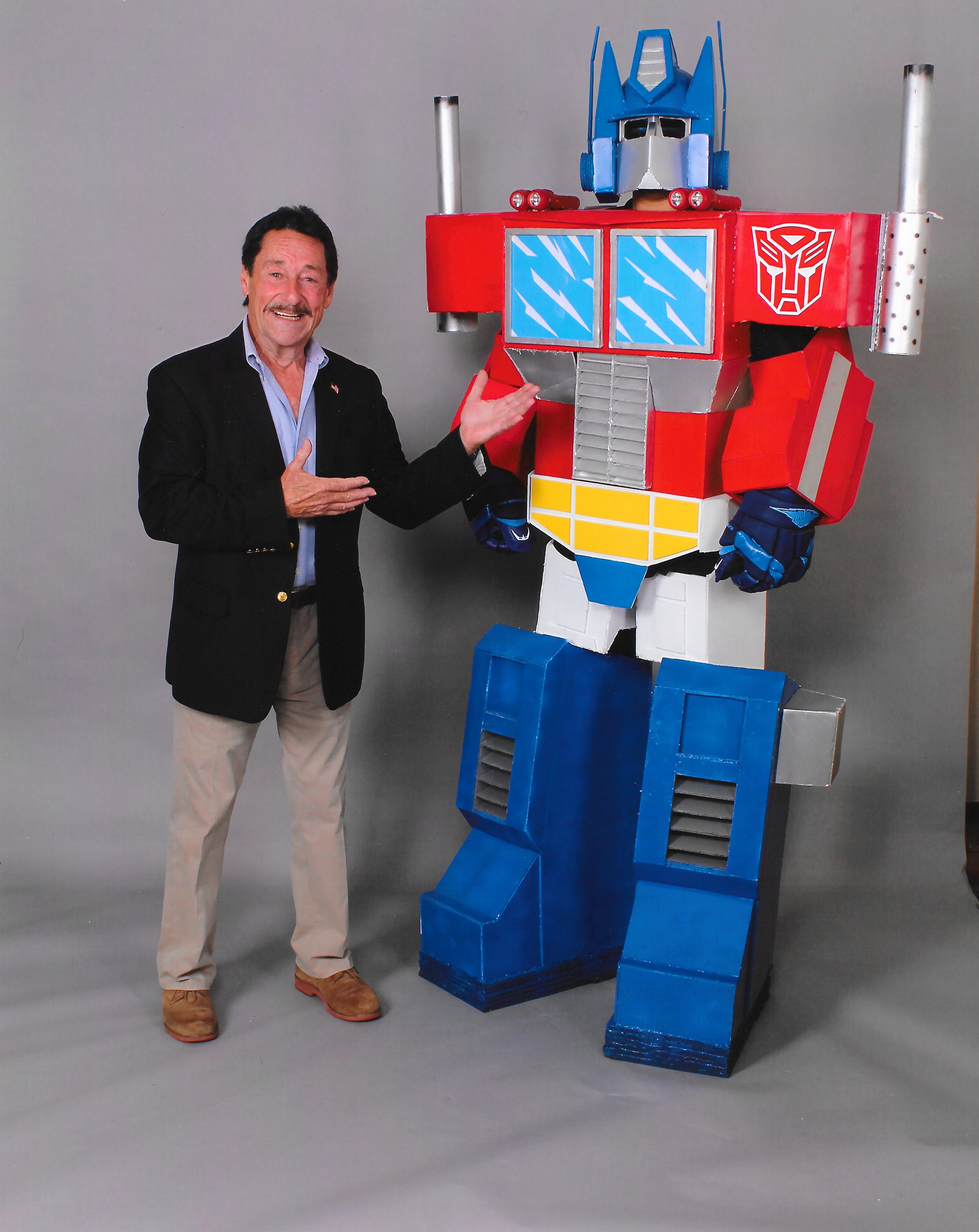

hello!!! awesome builds!!! I like your method of adhering the eva foam onto the cardboard boxes for stability and a template of sorts! my 7ft optimus prime (with Peter Cullen as reference lol) is built from Elmer's foamboard which is basically paper glued on a foamboard which can rip if not careful. I wanted to improve my optimus with eva foam so I can wear him at more conventions and events. you're thread gave me the idea of simply using my existing optimus prime and adhering eva foam on top of it. what glue do you use to work with eva foam? any tips you have for me? thank you in advance!!!

Hey Carlos, we have just been using hot glue to adhere the foam to the cardboard, it's working great so far.
As far as paint, we mostly just spray a few coats of plasti dip on the foam, then paint with rattle cans. There are some nice ones with the shiny, silver fleck in them that you can buy at Michael's.
