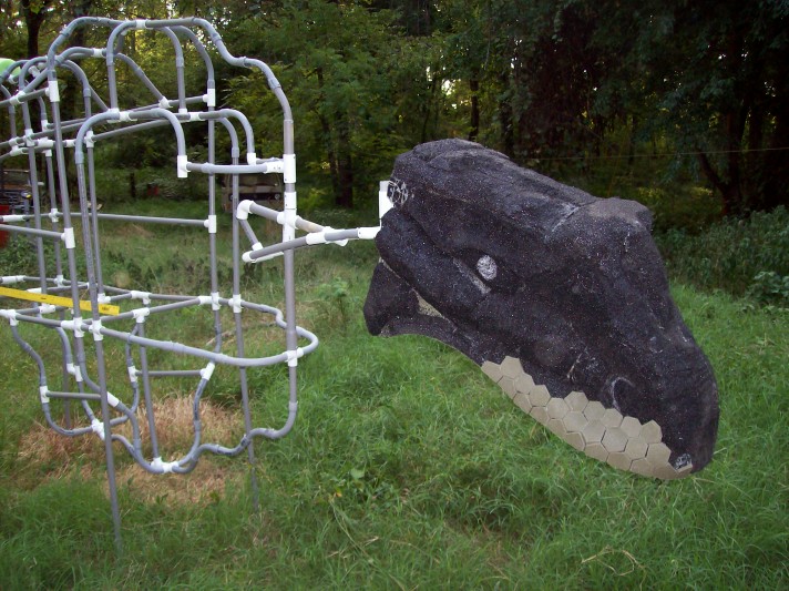

It's a PVC structure underneath, with semi-rigid packing foam constructed in an airframe like structure, then surfaced with very thin sheet foam. The scales are army PT mats.

Thanks for the kind words Matt. Looking at my old posts here, I just realized that I apparently never did a post about the Dewback on the RPF before! I thought I had done so right after SW Celebration where it won Best of Show in the costume contest. I will try to post some more images of it under construction.head and frame.jpgDewbackcostume.jpgView attachment Dewback head 1.jpgdeweyvsjarjar.jpgdewback.jpgDewback hide.jpgdewback head carving.jpgDewback head stage 1.jpg

How on earth do people get into it/see out of it?
Yyou get into it between the legs , front and back. It's a bit of a struggle. The front guy looks through a slot in the scales, partially hidden by the Dewback's mane, the back guy cannot see at all. I have always been the front guy since I built it and know how to work the controls best.
