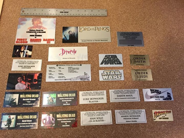

I'm clearance out some plaques that have been on my bench for a while. They are prototypes, items that weren't paid for, etc... thus the discounted prices.
Your pick, $8. Discounts if you buy a few. Combined shipping.

Re: Full Color Custom Plaques for Props (Clearance items post 404)
Replied.
Both SW logos are spoken for. The Luke saber is as well.
