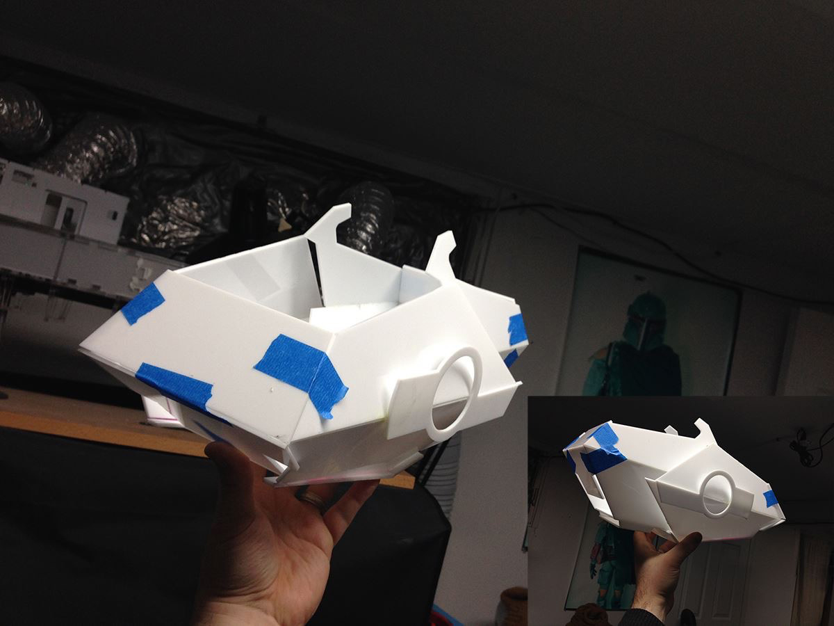

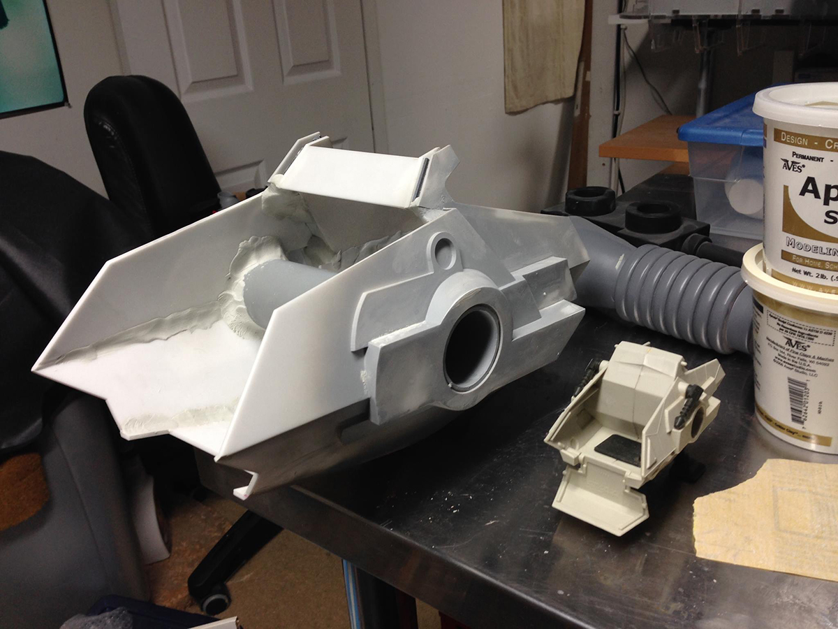

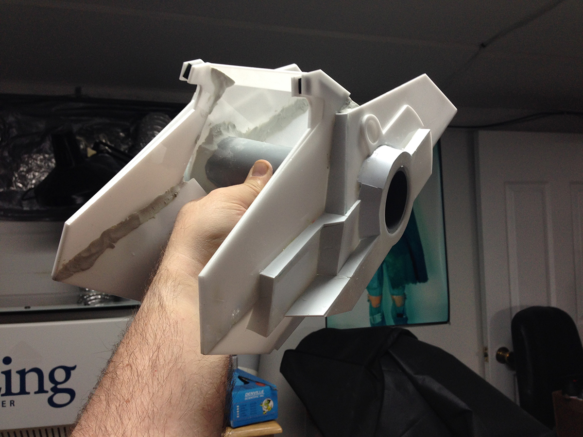

I started with the toy itself, and laid a ruler to the body, deciding a nice upscale from 1/18th to 1/6th would do the trick. A couple of days later, I had a drawing in Illustrator, which I lasercut in acrylic. Using my powers of "hacking the crap out of spare plastic bits" I finessed the shape. So with the use of Aves, I smoothed 'er out.

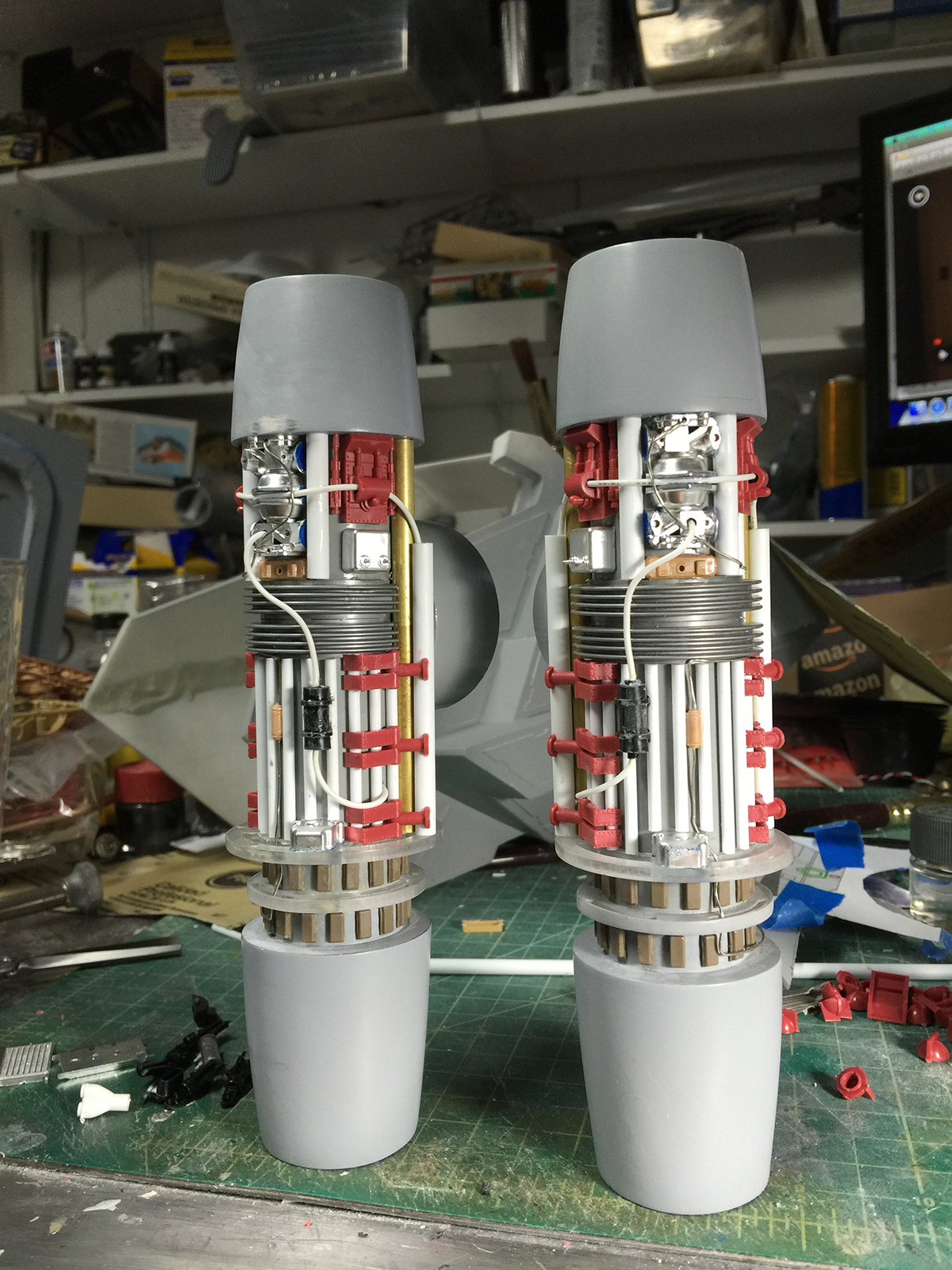

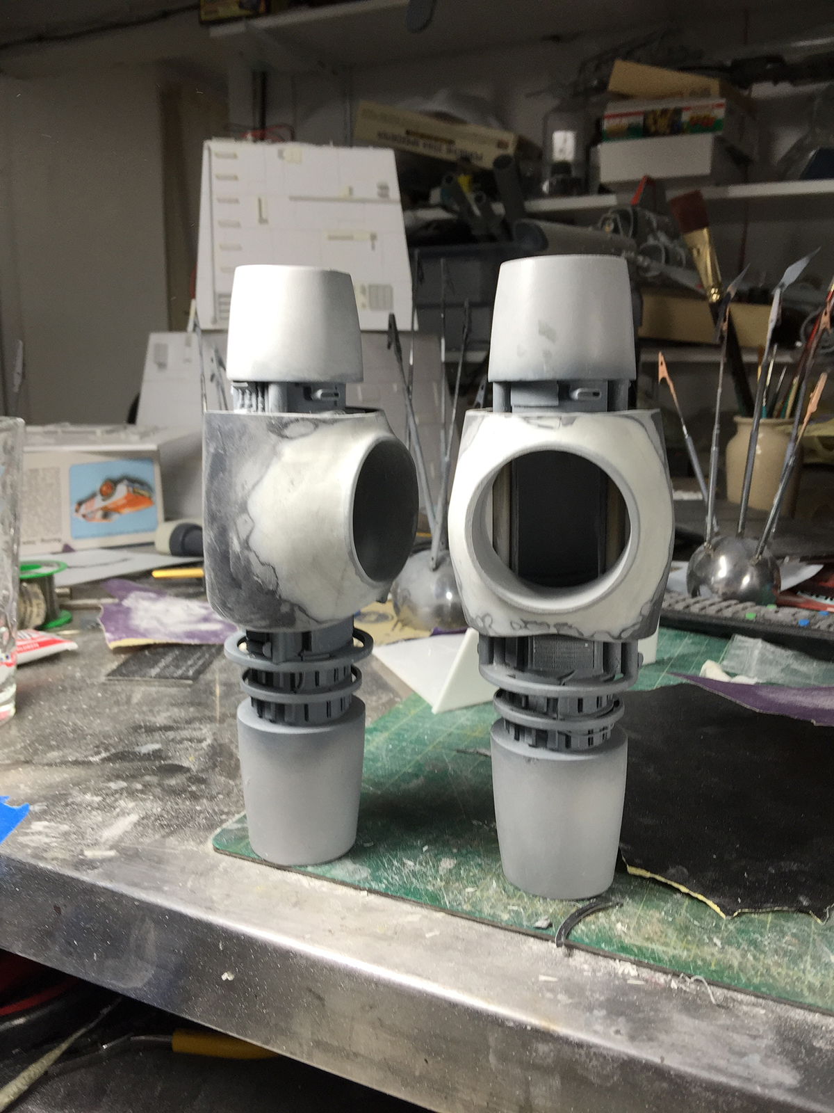

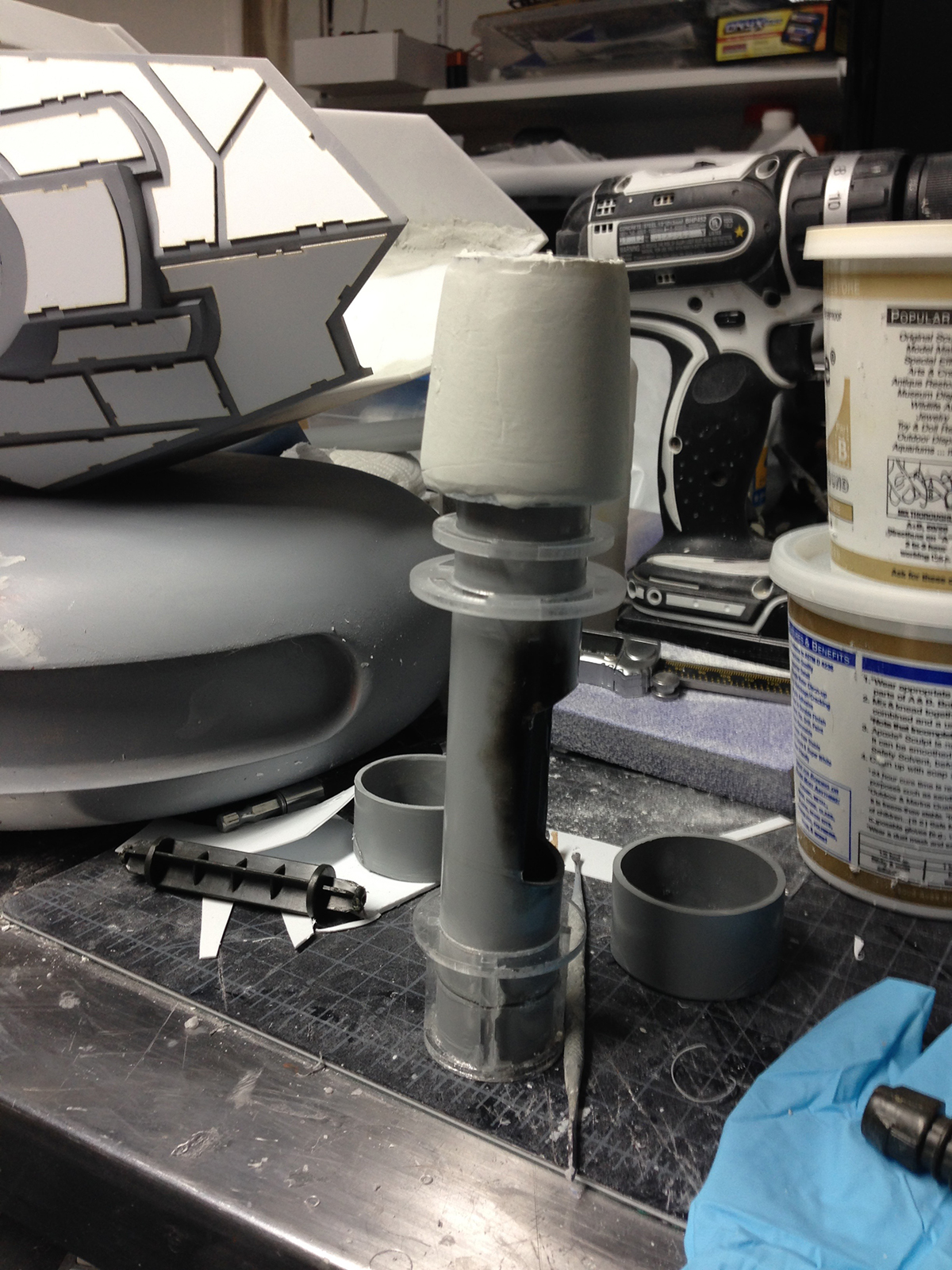

I made some engine pods with Plastruct, acrylic, and Aves, smooshing the Aves to get the cowl shapes. I laser cut some discs to match the Plastruct's ID tube dimensions, epoxied it to an old screwdriver bit, added some tape, friction fit it to the inner wall, and bam - instant ghetto lathe against a disc sander! A couple of rounds of putty and primer and they are smooth as silk.
