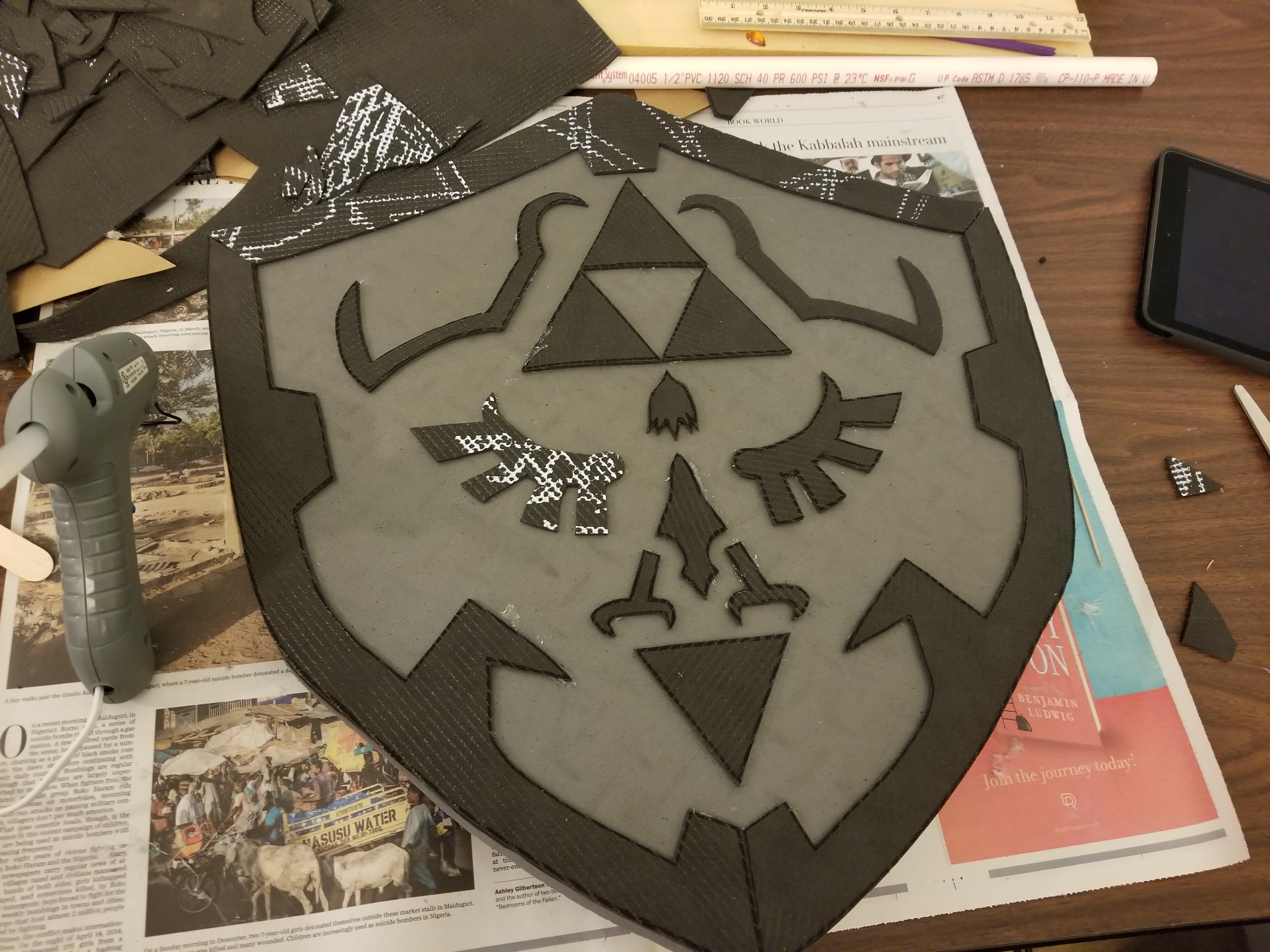

I could use some advice on a shield I'm making. The base is EVA foam with raised design features cut out from a sanded down yoga mat. I plan on covering the shield and the raised design features with worbla (already purchased).
The advice I need is on the order of doing things from here.
Should I cover the raised pieces with worbla first, then glue them to the shield or put them on the shield first, then cover with worbla?

Hi MC,
assemble the whole thing first with details/raised pieces,then cover the shield with worbla.Shortly after heating it,make sure it's tucked in and pressed down in every corner and gap.
Painting is the last step.

Yeah id go with that, it will really help hold the raised pieces in place and you'll still be able to get the pieces painted neatly with some good masking and blending.

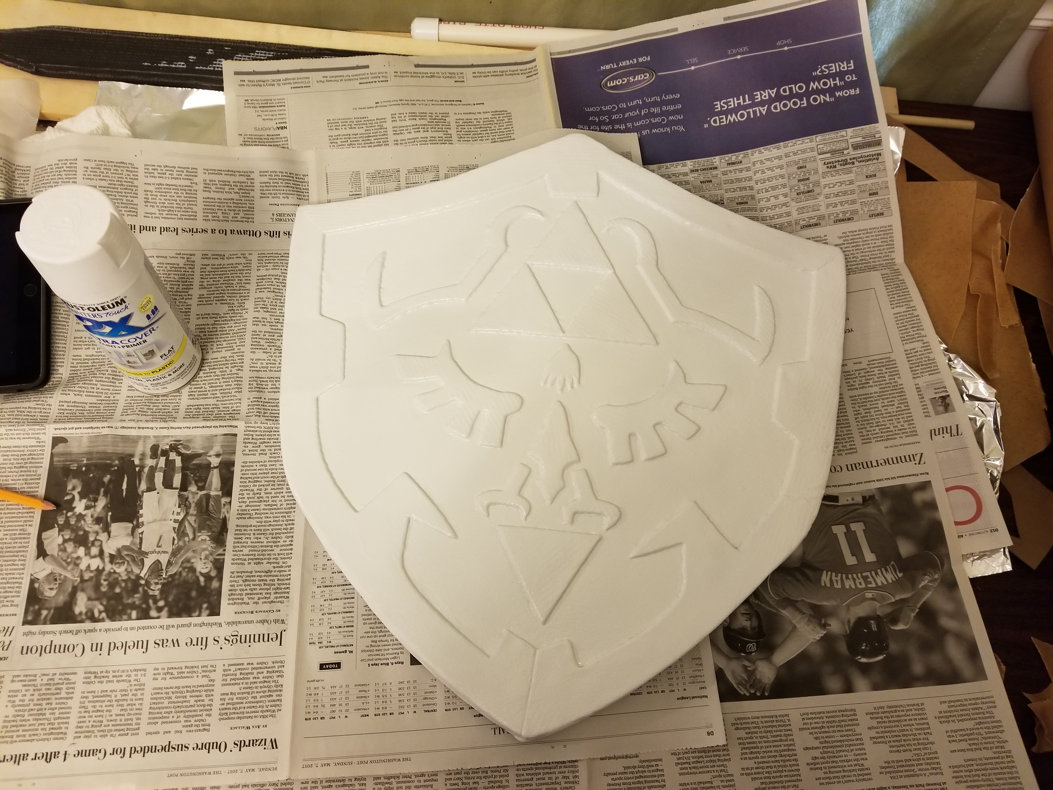

Unfortunately, some of the pattern of the yoga mat I started with made it through the worbla and the spray primer I used. I've got some gesso and I'm hoping with enough layer of that plus some sanding that I'll be able to smooth i out. Lesson learned, start with smoother foam instead of a sanded $5 yoga mat. :)

I took some of the brown paper and pinned it to the top of the shield and cut out the shape (could have used the original pattern but wanted to keep that in tact in case I needed to start over). With it still pinned to the shield, I started drawing the raised parts. Took a good bit of drawing, erasing, re-drawing to get it like I wanted (I'm not an artist). Once I had the shapes drawn, I cut them out and pinned them to the yoga mat that I had sanded down with a mouse sander. I traced them with a sharpie, then cut them out with an exacto knife on the self healing mat. Any of the pieces that had more than one of the same kind, I used the best of the drawings I had done for the pattern so they would match from side to side.
Once I got it all cut out, I laid it all out on the top of the shield. That's when I couldn't decide which way to go and came here for help. :)
Once I got the advice to glue it all down first, I started with a hot glue gun and glued it all in place. Being my first time working with a hot glue gun, I'm happy to report that although there was a decent amount of pain involved, no lasting injuries occurred. :)

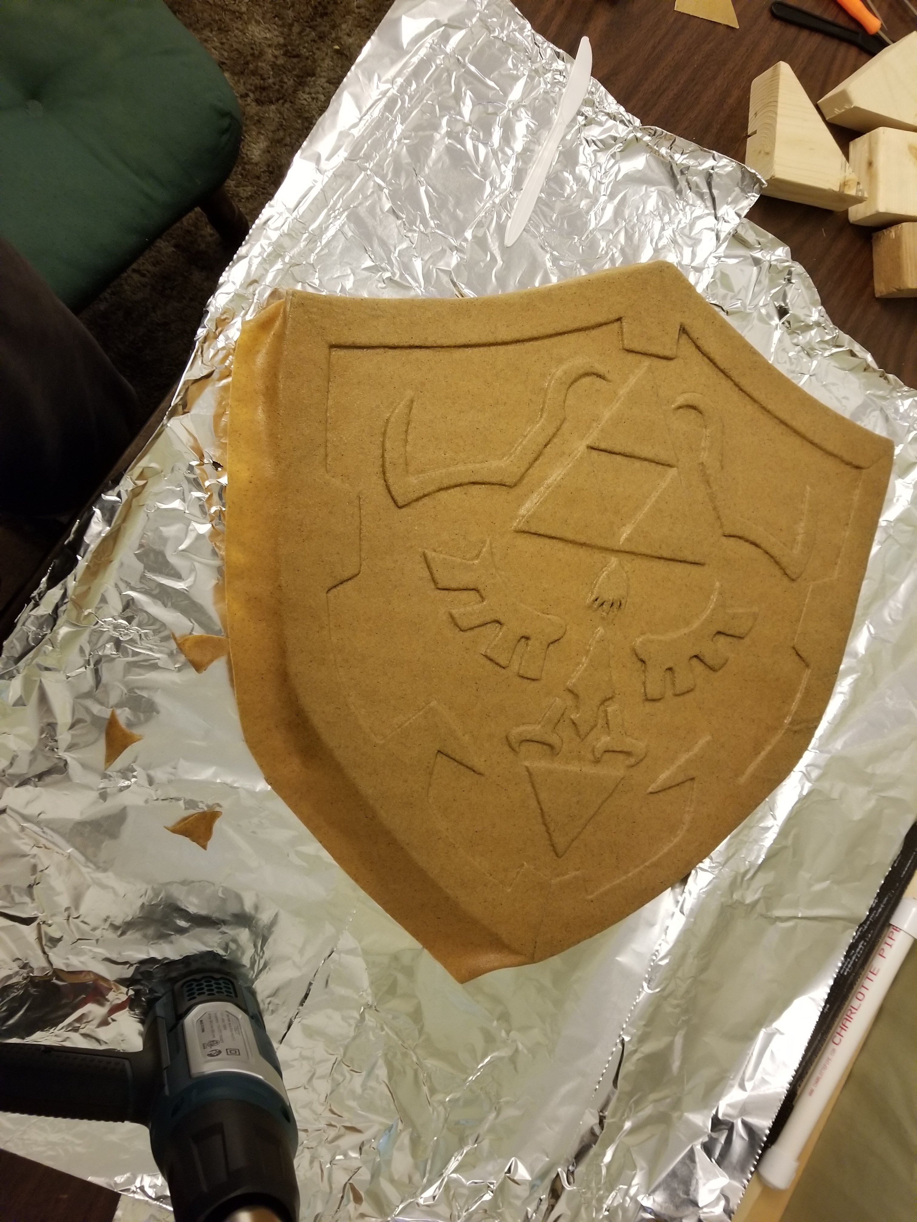

Then it was back to the heat gun, heated up the worbla while wearing my heat resistant gloves, fitted it over the whole thing using a dulled down plastic knife to get the fairly sharp edges, then let it cool back down.
I laid down some newspaper in my front yard, put the shield on it and painted it with the spray on primer. About 45 minutes later, resprayed with a second coat and let it dry for about an hour. That's when I noticed the pattern of the yoga mat peeking through to the surface.
I picked up some gesso last night and plan on putting many layers on top of where the pattern pokes through, then sanding it to make it smooth. Hopefully I'll be able to get away with just doing that in spots instead of the whole thing.

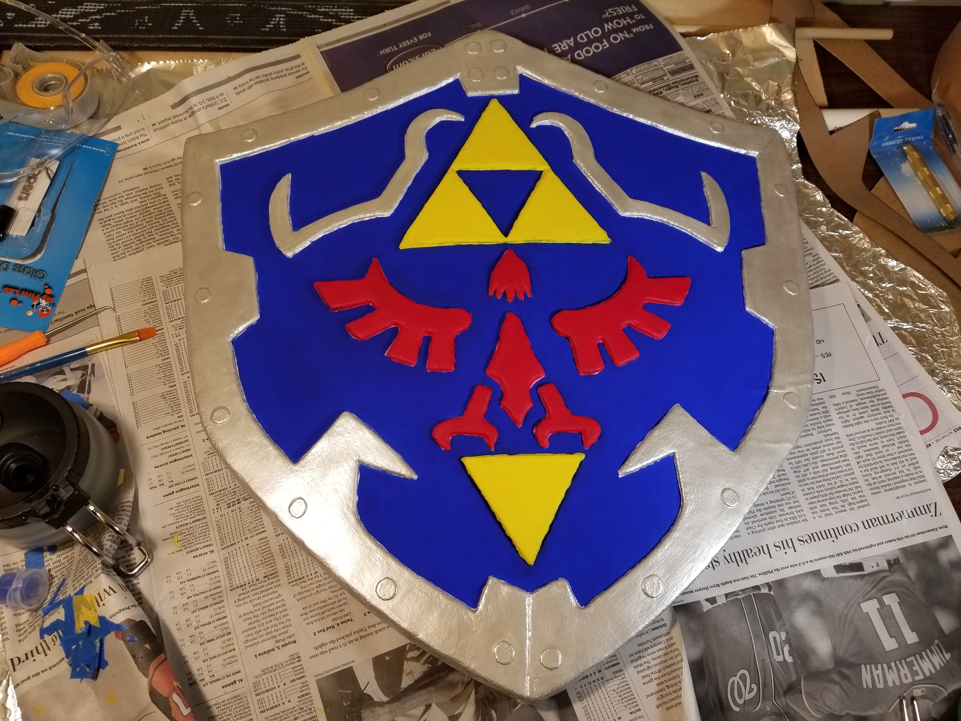

I certainly have learned a lot so far with this project. One big thing I've learned is that I am horrible at painting with acrylics using brushes. Looks awful. So I've decided to give airbrushing a try. System should be here Saturday that's gotten decent reviews.
More questions. I've got multiple layers of paint already on this thing.
Will I be able to get a nice paint job by airbrushing over the existing paint?
Should I try and remove the existing paint, and if so, how?
Should I put a couple layers of primer over the existing paint first?
Any advice would be greatly appreciated. Thanks!
Question 2 should be easy to solve I recon,since the heatgun initially is meant to heat and remove paint (later adopted by the cosplay scene to heat-form foam).
Learned a lot during this project. Many things I would do different if I started today. Still some spots that could use some cleanup. Still, for my very first project, I'm pleased.
Now I just need to figure out how to get a nice clear coat on this thing to protect the acrylic paint job.
Try the Punished Props youtube channel for advice on this.I believe they have the info you need
