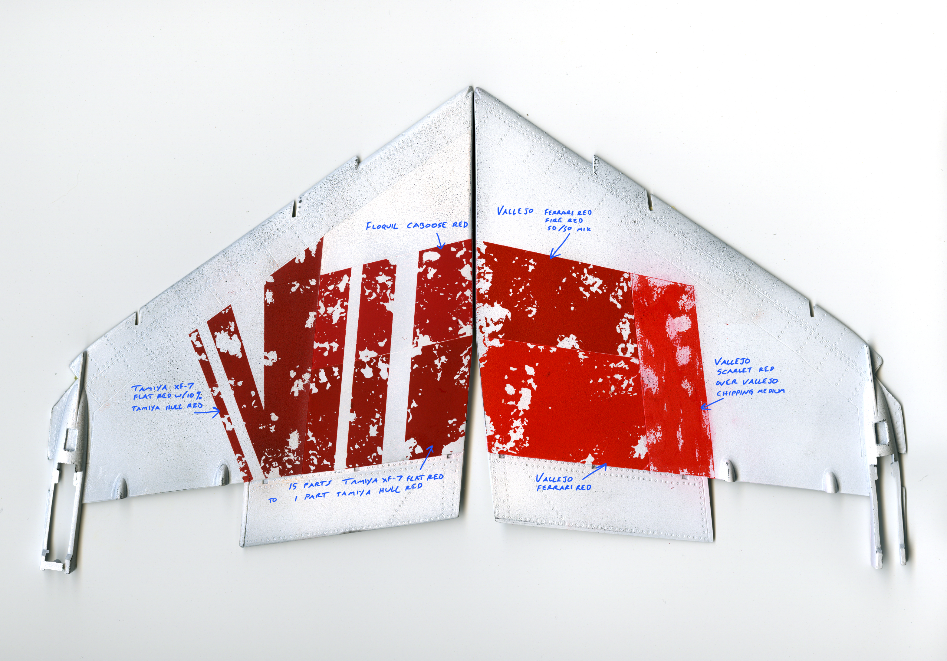

Well, here's an experiment to see if I'm approaching this the right way. I've been doing tests to find a good acrylic match for Floquil Caboose Red. Because it's time consuming I figured I'd also practice my chipped paint techniques which is why my test pieces look like this:
Both wings were primed with black Mr. Finishing Surfacer 1500. The left wing was painted with Tamiya flat white and the right wing with Vallejo flat white. I sanded the white down and then began testing reds. I started with straight colors from the bottle that have been reported to be close to Caboose Red. Not so much. Then I began mixing. I'm getting closer with the Tamiya paints, which I like the best for the way they go through the airbrush, but the closest match I've got so far is a fifty-fifty mix of Vallejo Fire Red and Vallejo Ferrari Red. That's the test patch at the middle top of the right wing and it's butted up against the Floquil Caboose Red on the left wing.
I scanned the wings and took that into Photoshop. I used the 11 pixel sampling eyedropper and took three samples of each color and then averaged those RGB numbers. Here's what I got:
Floquil Caboose Red - R: 159, G: 22, B: 16
Vallejo Mix - R: 168, G: 20, B: 1
I didn't know what to expect because I don't know what size numbers indicate a big difference in colors, but they look really close to my eye.
Using the technique @stonky is talking about, would the idea be to add a touch more blue to the Vallejo mix to bring that number closer to the Floquil values? Would more blue slightly darken the mix and bring the red value down?
I figured I'd ask before shooting more tests because they take time, and if someone has an answer to help send me in the right direction that'd be great.
On the other hand, I'd be perfectly happy with the Vallejo mix as a substitute for Caboose Red on any X-Wing build.
Sorry for the long-winded post and thanks for looking.
Have you tried Testors Model Master Acrylic(Acryl) Caboose Red?

I've been avoiding the Model Master Acrylics because I find them to be fragile, especially when masking over them, but I will give this one a look. For what it's worth, I tried the MM aged concrete, which is meant to match the Floquil color, and it was a decent match, but not great. And it was how i learned the paints were fragile. Or should I say they don't have much "bite" to them.

I've been using Testors Model Master Acrylics and find they are tougher than Tamiya acrylics. I have had no problems masking over them. However I use Tamiya masking tape which is made for masking over hobby paints.

Interesting. I use Tamiya tape as well and have had the opposite experience. But I tend to use the lacquer based Tamiya thinner which gives the paint more bite. How do you thin the MM paints?
As for the Micro Mark Caboose Red, I tried it and unfortunately it wasn't even close.
