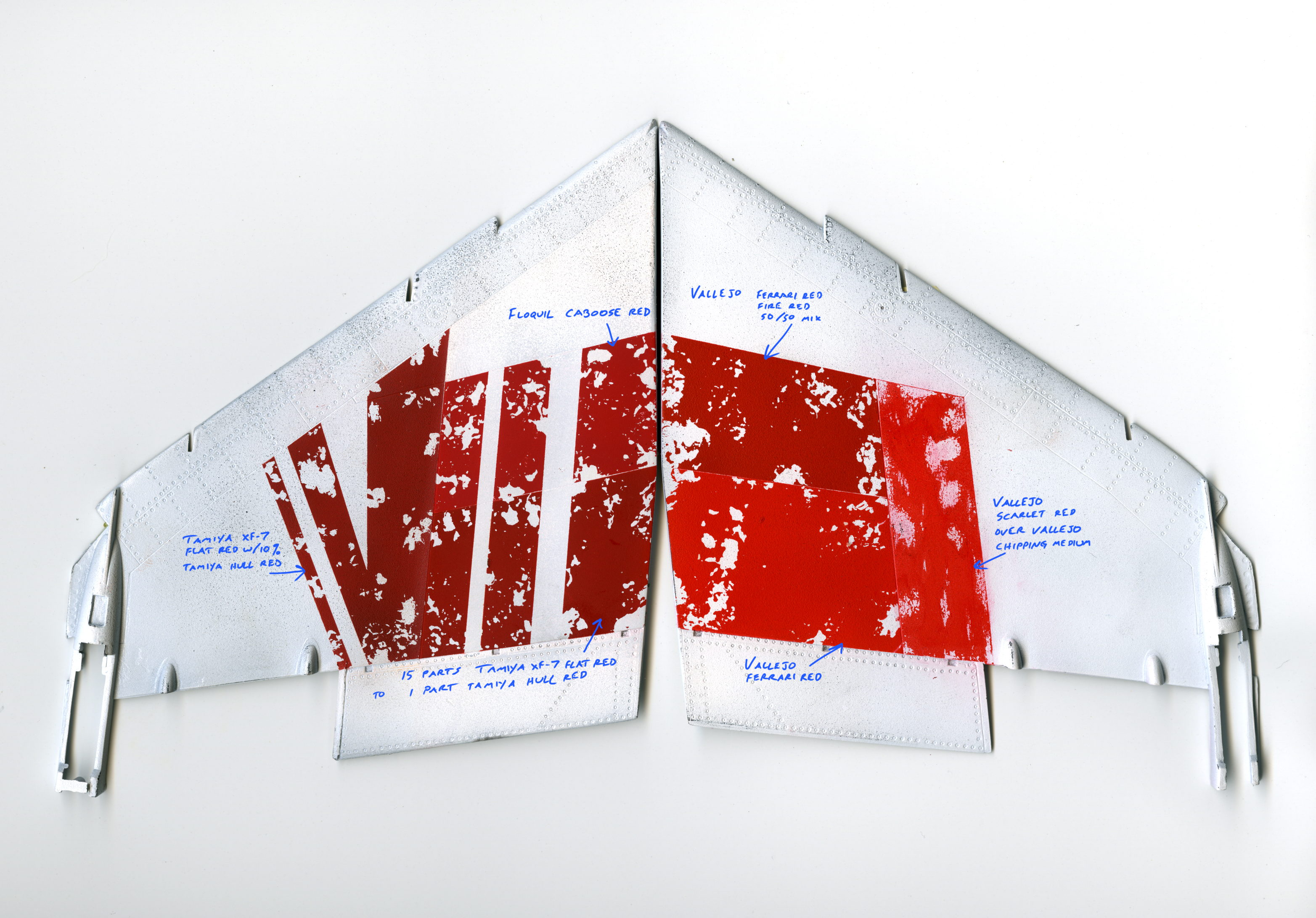

Well, here's an experiment to see if I'm approaching this the right way. I've been doing tests to find a good acrylic match for Floquil Caboose Red. Because it's time consuming I figured I'd also practice my chipped paint techniques which is why my test pieces look like this:
Both wings were primed with black Mr. Finishing Surfacer 1500. The left wing was painted with Tamiya flat white and the right wing with Vallejo flat white. I sanded the white down and then began testing reds. I started with straight colors from the bottle that have been reported to be close to Caboose Red. Not so much. Then I began mixing. I'm getting closer with the Tamiya paints, which I like the best for the way they go through the airbrush, but the closest match I've got so far is a fifty-fifty mix of Vallejo Fire Red and Vallejo Ferrari Red. That's the test patch at the middle top of the right wing and it's butted up against the Floquil Caboose Red on the left wing.
I scanned the wings and took that into Photoshop. I used the 11 pixel sampling eyedropper and took three samples of each color and then averaged those RGB numbers. Here's what I got:
Floquil Caboose Red - R: 159, G: 22, B: 16
Vallejo Mix - R: 168, G: 20, B: 1
I didn't know what to expect because I don't know what size numbers indicate a big difference in colors, but they look really close to my eye.
Using the technique stonky is talking about, would the idea be to add a touch more blue to the Vallejo mix to bring that number closer to the Floquil values? Would more blue slightly darken the mix and bring the red value down?
I figured I'd ask before shooting more tests because they take time, and if someone has an answer to help send me in the right direction that'd be great.
On the other hand, I'd be perfectly happy with the Vallejo mix as a substitute for Caboose Red on any X-Wing build.
Sorry for the long-winded post and thanks for looking.

Thanks, VAC! I sprayed all my test chips on gray primer, but I wanted to practice weathering techniques and see how the red paints would look on the paint I'd use on an X-Wing build. The reds are even brighter on the white than I expected. They look quite different on the gray even after many coats. So I decided to try matching colors on the white. I'm about to spray the Tamiya and Vallejo colors on a gray chip to see how they compare.

I sprayed the Tamiya and Vallejo reds on gray primed plastic and they do look completely different. And they look completely wrong compared to the Caboose Red. Still more work to do, I'm fairly new at this color matching stuff and it's harder than it seems.
