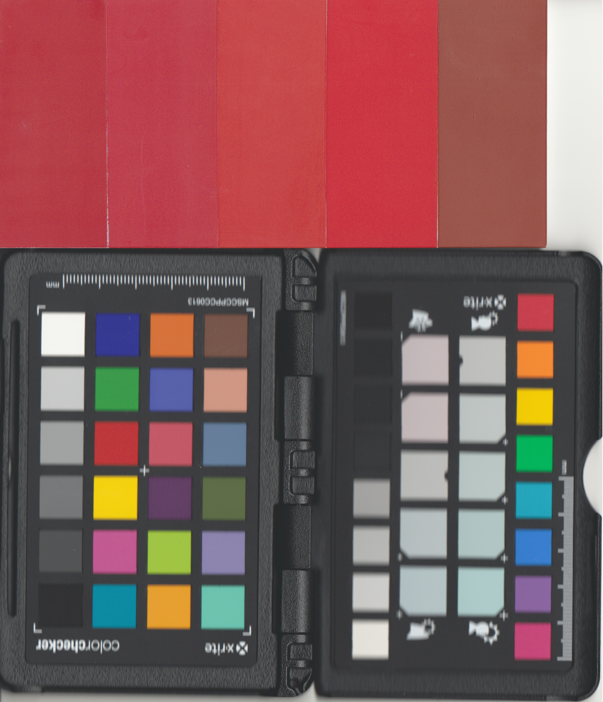

I believe the color checker chart needs to be scanned or photographed together with the color you are matching for it to work.
I agree. I think it would be easiest if the color checker were in the scan with every paint-chip chart. I color corrected the X-Rite color checker using a Curves layer and the black, grey, and white-point sampler tools. But it's not easy in Photoshop to copy that correction to the image of the paint tests. It can be done as an action, but it would be simplest, I think, and more bullet-proof to have the reference in every scan.
Oops, I spoke too soon. You can copy the adjustment layer from the corrected color chart to the paint image pretty easily:
With the adjustment layer active, go to Layer > Duplicate Layer and in the Destination > Document : drop down, choose the 'other' image file and click OK.
And when I'd done all that I got Pantone 484C for Caboose Red, which is even further off than the original. Hummph.
Yes, Zenwalker is correct...as I understand it, the color chart must be scanned with the exact same scanner and the same scan settings as the original paint chips, then the two are color adjusted together in order to match the colors properly.

After color adjusting the paint chips using the color checker I also get Pantone 484C for Caboose Red...just as VFX Freak is getting, so at least we are adjusting correctly ;)
I think the Pantone system is the only way to get close to the original Floquil colors. There were some other Pantone color sets in PS that were closer to the original Floquil Caboose Red than the 'solid coated ' one. I am not sure how those ones work or what they are for. I will do some more checking.
When I go thru all of the color libraries to find the nearest match for each color I get much better matches using the TRUMATCH or sometimes the FOCOLTONE systems, does anyone have experience with these color systems? I think the PANTONE system is rather limited, just not enough color variation to get a proper match.

My system is completely calibrated (Gretag MacBeth system to calibrate the monitor and printer and generate custom printing profiles for each type of paper.) and I printed out the red paint chart with my Epson 3800 on Epson matte and luster paper. The luster looked a lot better and the next step is for me to paint a test chip with the Floquil Caboose Red and see how close it is to the print out.

Color corrected scans of the paint chips and color chart in the same scan for each set seems to the way to go.

I'll put in another vote for uncorrected scans with the color chart in each scan. No need for you to do any more work than you're already doing that way, and we all know what we're getting.

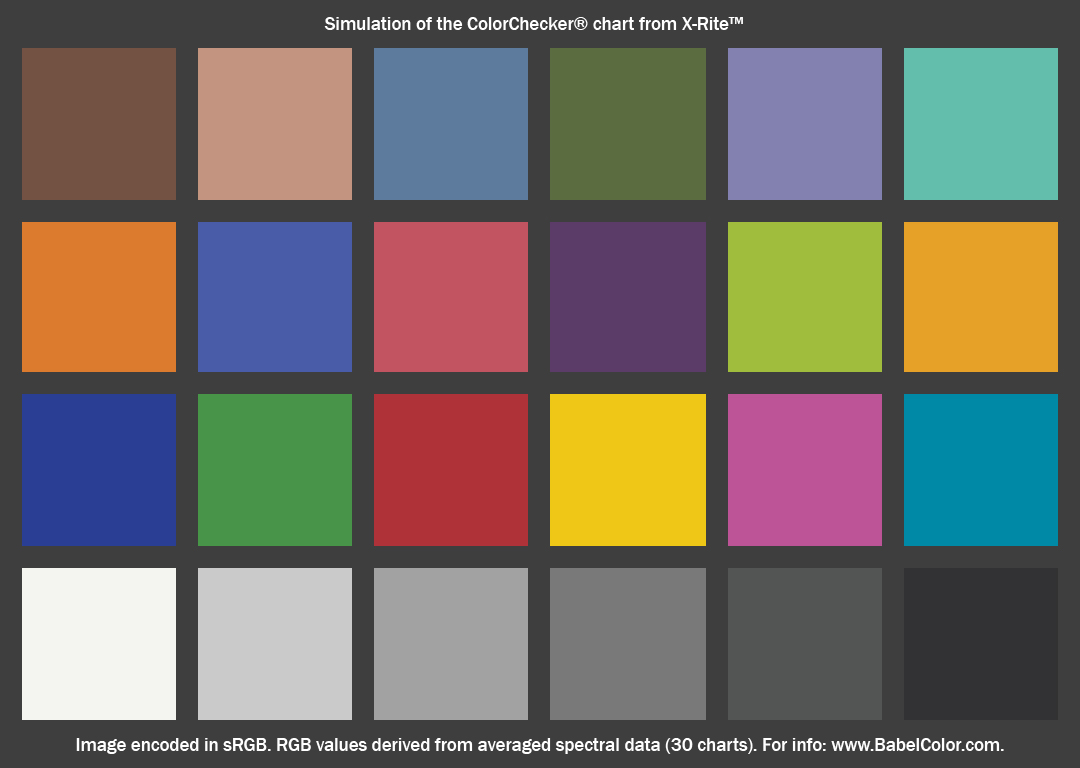

There's a bunch of resources online that take a bunch of charts and averages their colors to try to eliminate even the slight differences between charts, here's one:
Here are the RGB values for each of the "grey" square in the above image, dark to light:
50 50 51
83 85 85
120 121 121
161 161 162
201 202 202
245 245 240

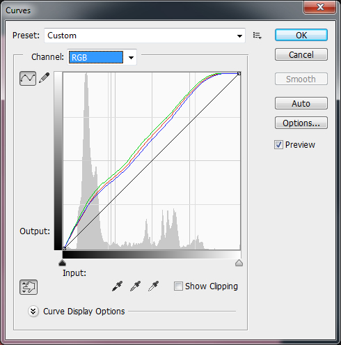

So if you're doing this manually probably the best way to do it is to use photoshop's curves to match each greyscale square's values. Here's what I got after some quick fiddling:
If you open the curves tool you'll see an icon that looks like a hand with up and down arrows:
Press it - this will allow you to eyedrop over the color square in the chart image that you want to change, click and hold, and drag up and down until the new "Output" value in the curves window matches what you want it to be:
You'll see that after you get to the value that you want and you let go that there'll be a new point on the curve, in a new position. You have to do red, green, and blue separately, and do all the squares. I went through and did all the red, then all the green, and then all the blue, probably the quickest way - just change the "Channel" option in the curves window to red, make your corrections, then to green, make your corrections, and so on. Here' s what the curves looked like when I was done:
If anyone has a better way, great, please share. :) That said, I'm happy to do them all and then post my results as -... . .- --.. continues to kindly post scans. :)
