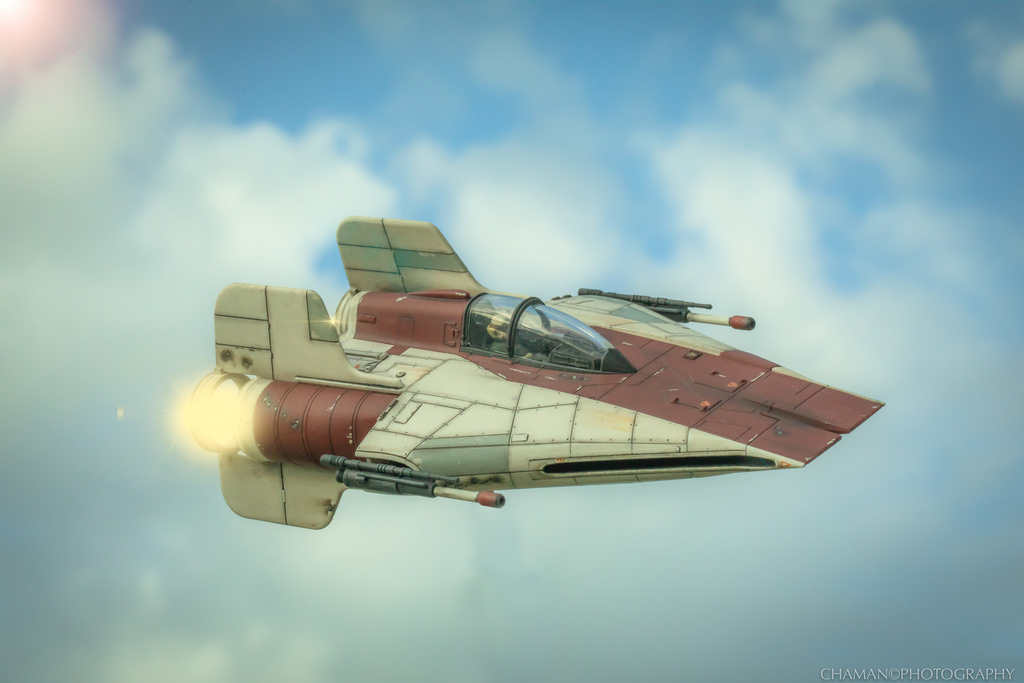

I dont know what you have decided but I was looking for the same thing as you are doing now and decided to use this:
20181101_172659 by Oscar Baez Soria, on Flickr
Dries lighting fast, does not attack the plastic, gives a nice dull finish with almost no grain at all, does not react with acrylics, oil base paint or enamels as far as I can tell. Its very resistant and so far havent notice any yellowing. It was the finish of choice for my latest Bandai build:
269A1875-Edit by Oscar Baez Soria, on Flickr
269A1853-Edit-2 by Oscar Baez Soria, on Flickr
I think is a great alternative if not better than acrylic based ones which I have found chip easily quite often.
