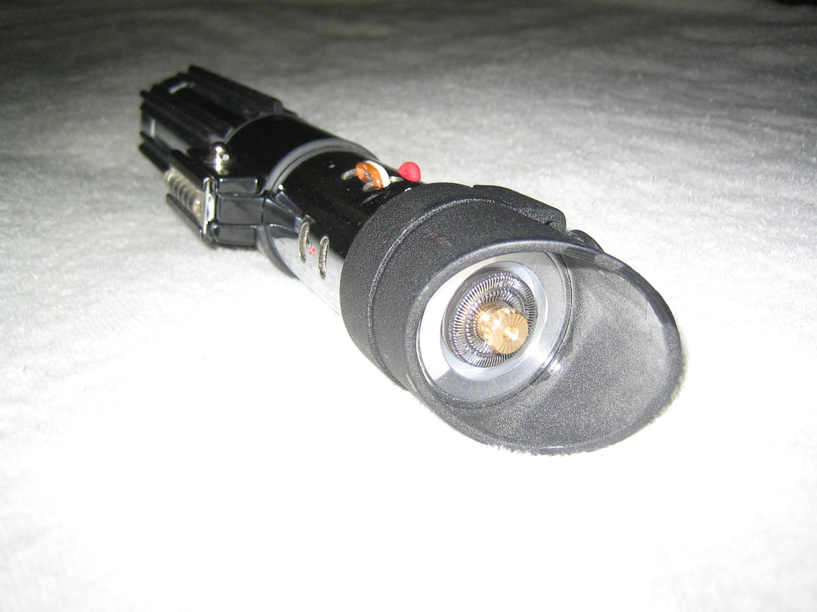

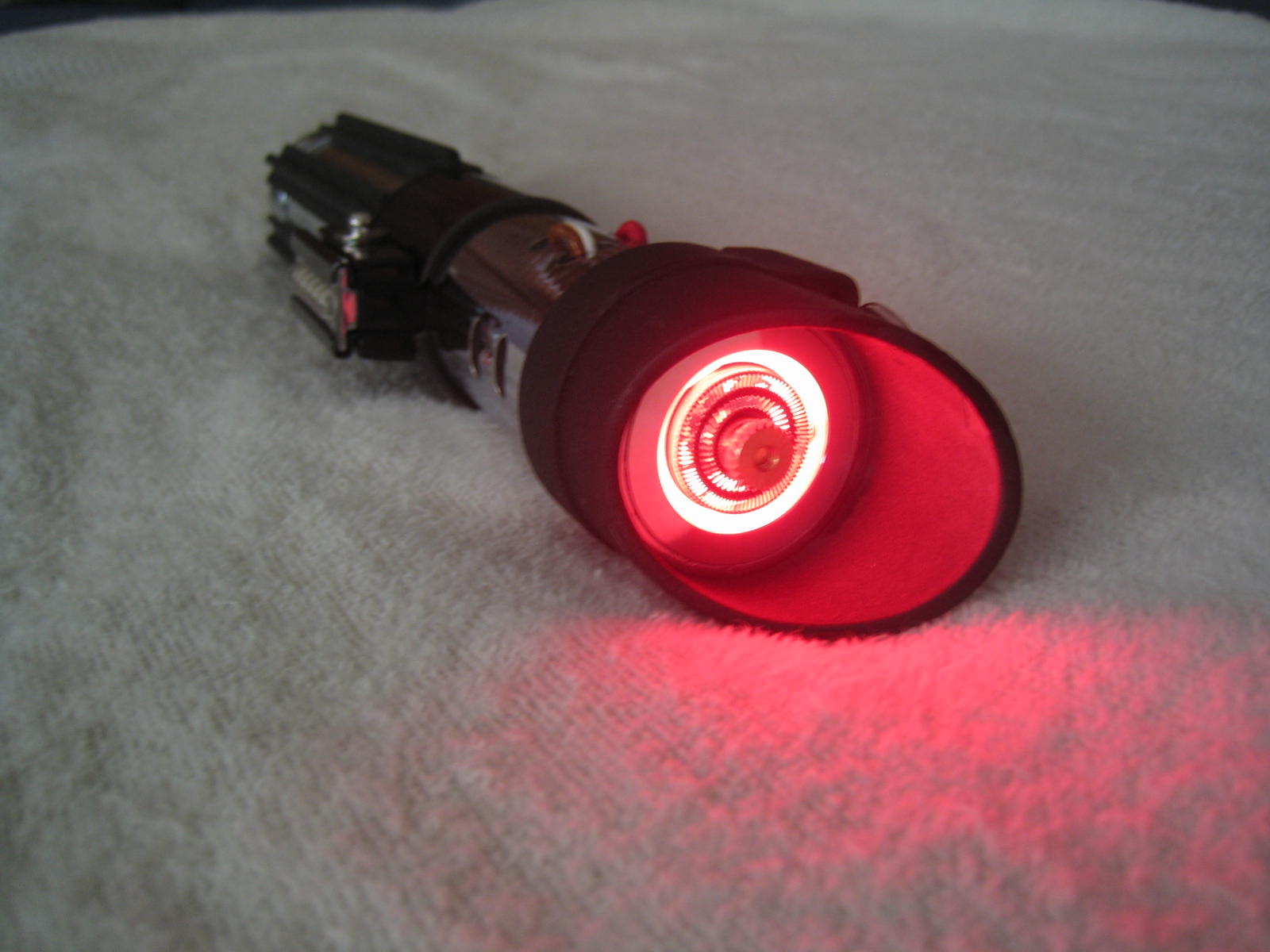

The Custom Saber Shop has conversion kits back in stock for the FX Vader:
http://www.thecustomsabershop.com/MR-or-Hasbro-FX-Vader-conversion-kit-P343.aspx
It's about as easy a conversion as you are likely to do. Here's the tutorial for the Vader ANH:
http://forums.thecustomsabershop.co...HFX-Vader-ANH-Disassembly-only-kits-available
I did it on an '05 Vader ESB and the kids have been battling with it and my 2 converted Luke ANHs for months with no issue.

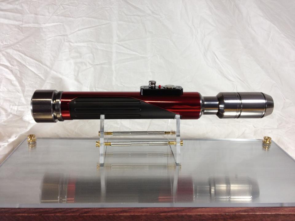

Ive been contemplating building a new saber after having to sell this beauty years ago...
