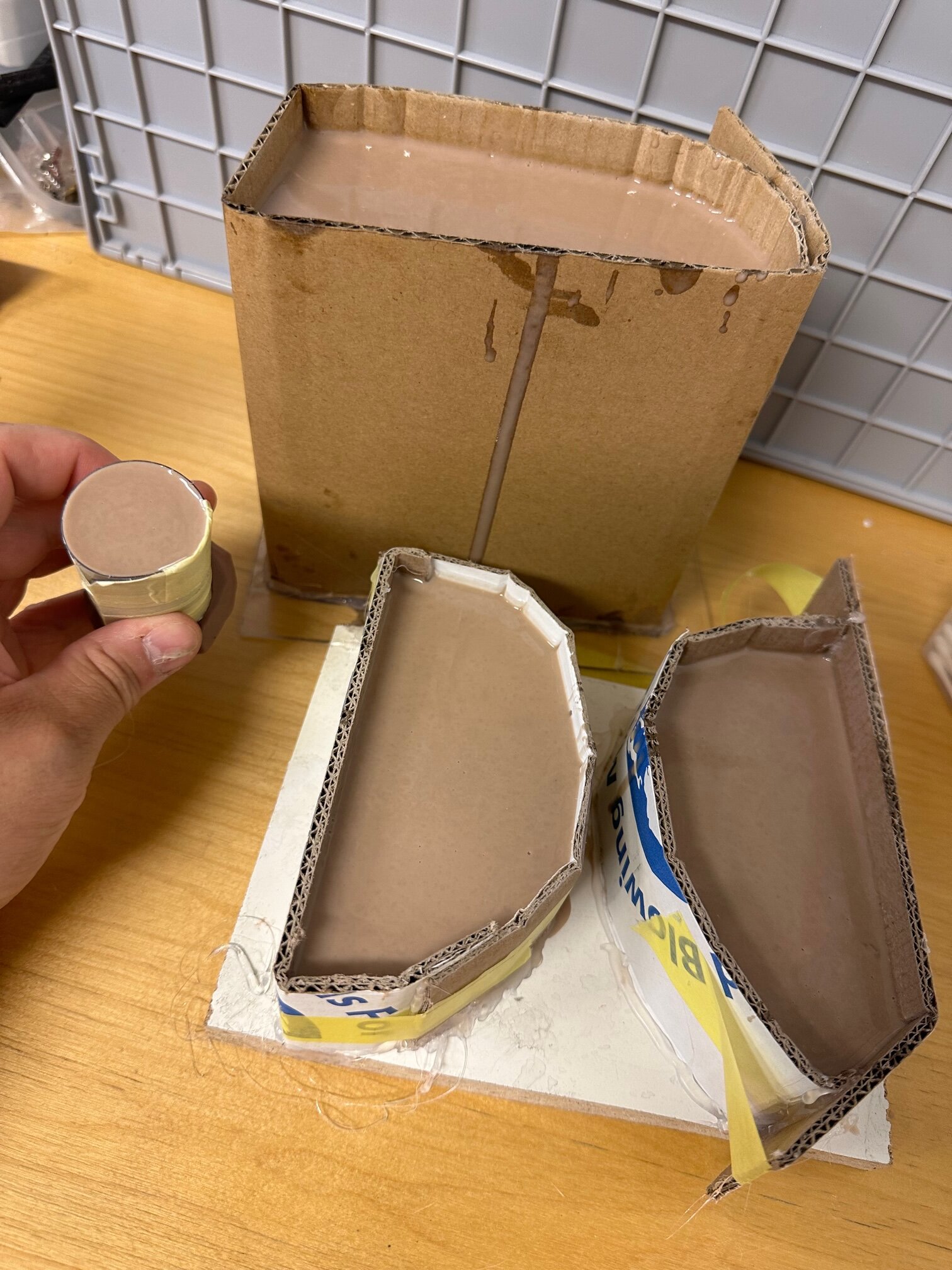

I made my molds, used release spray and mixed up (a few) batches of Compat 45.
I molded both my ears, and five of the teeth I made.
A couple of things learned:
Have more things to mold in case you make too much.
The Compat 45 REALLY expands to 5 times its volume in the vacuum chamber!
Then today: Time to demold!
First off, everything looked great.
I prited off the bottoms and cardboard edges:
I started demolding one of the smaller fangs:
It came out without any issues and I got the clay out without problems.
Next up: The teeth.
The deep teeth were a bit tricky, and mostly so because I made a big block with 4 teeth in it. This was a mistake as I could barely bend or squeeze the big block to manipulate the clay out. I ended up cutting the mold in 4 parts to make it a lot easier to get the clay out. The mold is still 100% intact, but I could squeeze and twist the mold to get the clay out.
Then the ears: Getting the clay out was not easy at all, but after using wooden sticks and squeezing and pushing, I managed to get the clay out. The ears did not look as good once removed..
I cleaned the molds to get rid of any excess clay and was left with this:

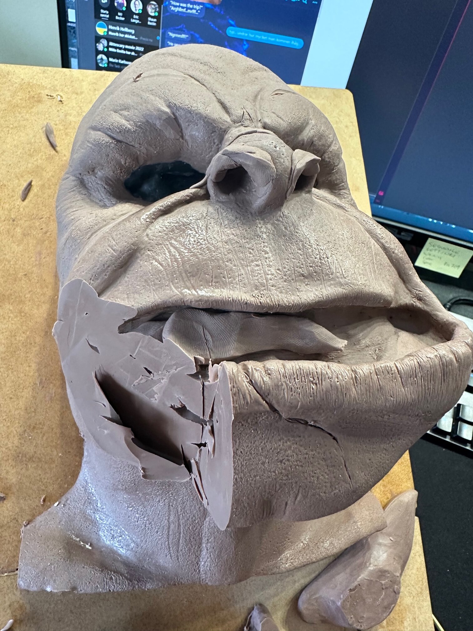

As I'm closing in on molding the sculpt, I had some work to do.
In the long recess of not working on him, there were a few things I was not happy with, and now was the time to fix it.
I started by adding some clay to add more wrinkles in the nose, change the shape of the nose, and I ended up redoing the entire jaw.
I was semi happy with it, but it was too much.
I started cutting away and see if I could just remove material and blend in the rest, but .. It soon escalapted to this:
Full jaw reconstruction. Including upper lip.
First attempt to make it better looked indeed better... but no way I could fit the lower fangs.
A little more reshaping and using the temporary casting I made with my excess Dragon Skin I built up a better jaw.
This pic is a little montage, same tooth on both sides, just to get an idea of where I am.
Of course, I'm back to making more skin texture and all that, but I think this looks better.
I think I want to close his mouth a bit more, but I'll wait until my proper casting of the teeth (which is curing as I type this and will be ready tomorrow) so I can insert the teeth and model the lower lip and have the mouth close at least somewhat.
Still some things I want to tweak when I see this pic with the lower teeth in...
This is major surgery:eek::eek::oops::oops: When I see the image you've posted in you first post, I see that his lower jaw is really protruding more toward the front as to fit his big teeth. Yours is not forward enough.
Ok, so you think I need to push out the jaw even further than now? Even though the teeth fits?
The jaw prior to surgery was a little too ridiculous I felt and was too wide.
I'll test extending it outwards about 1 cm tomorrow and see how I like that.
I like this current version of the sculpt better as a base though. There are still some things I need to change, obviously, but I am really starting to like working with monster clay =)
