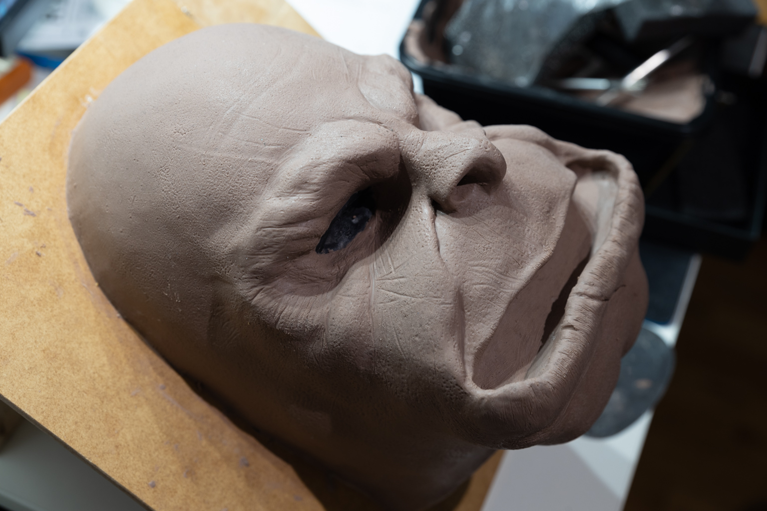

This is the sculpt as it looks like now:
The mouth will be filled with clay to not be as deep, and the teeth are (obviously) sculpted separately.

This guy?
Sculpt looks really great for a first time.
Curl up the lower lip edges. Leave dents in the gums for teef. Holes in the gums would be even better, so you can just anchor the teeth.
Rebound 25 and Thivex is a great combo. Make sure you are not mixing platinum vs tin silicone/rubbers. Spray on release and or gently brush on. Make sure clay wont react with Rebound.
Always brush on the first layer of Rebound 25 WITHOUT Thivex, or you will get bubbles. So, start when you have a couple of hours to do it. Having lillte pieces of foam to make later layers of Rebound Lumpy.
Plaster of paris or Free Form air to make a hard outer shell to hold rebound in place.

That guy indeed.
Thanks, I feel like I've managed to come to a decent sculpt at least.
He might need a few more wrinkles and things like that, but I will revisit him after the weekend again.
The issue is: if I cast him in Rebound 25, can I still cast him in Dragon Skin 10, with plenty of release agent, or will I create problems for myself casting silicone from a silicone mold?
I could make the mold out of Hydrocal or something like that, I just don't know if it will pick up the details of the sculpt and won't have any bubbles.

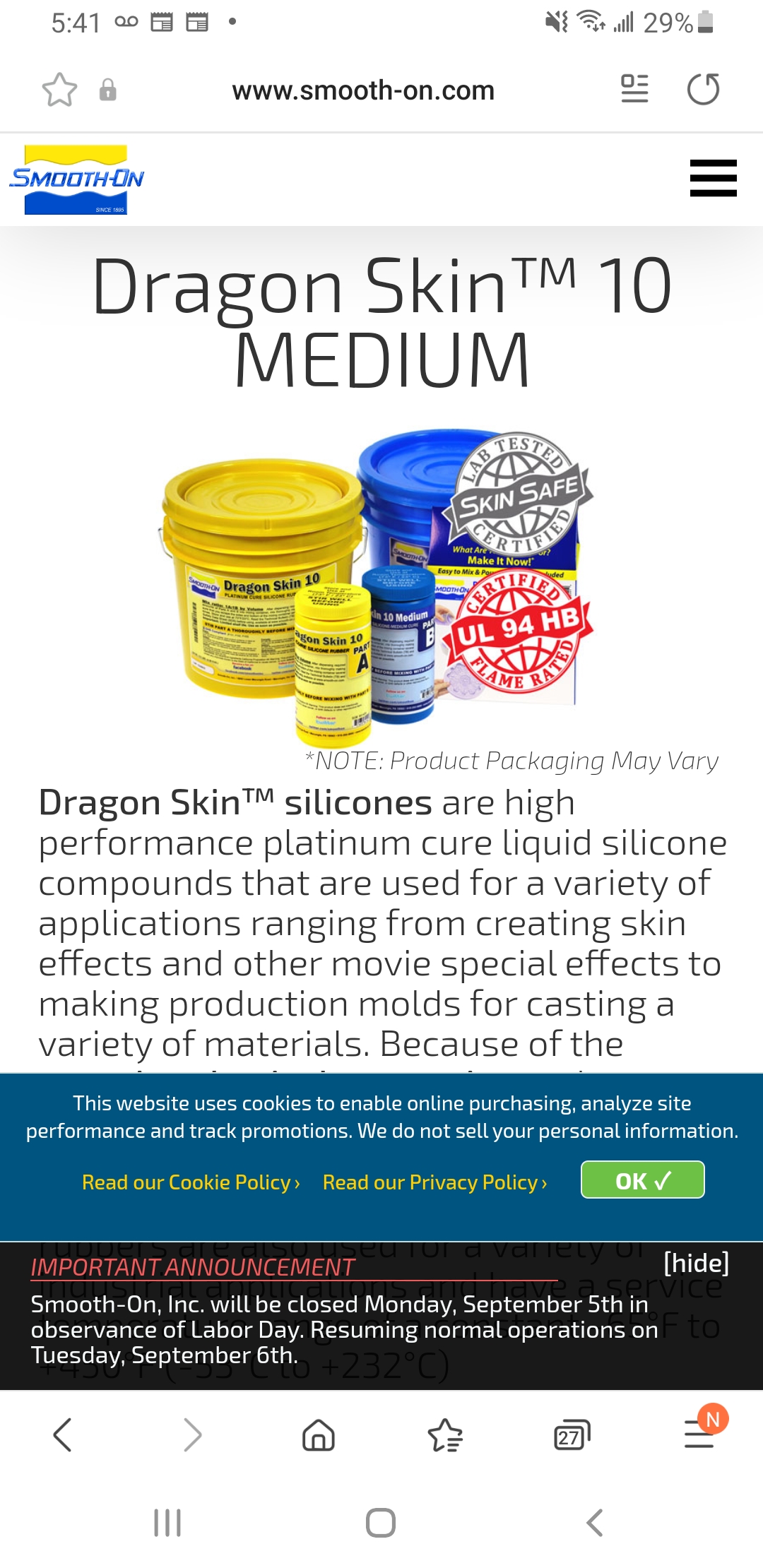

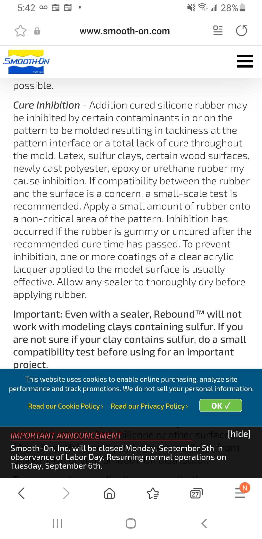

My Rebound 25 and Dragon Skin 10 has arrived, along with mold release and plaster bandages, so that's here at least.
Would you think there is an issue casting a mask in Dragon Skin 10 in a Rebound 25 mold as long as I apply mold release?

I know the silicones are both platinum.
I have sculpted in Monster Clay, which is sulphur free, so I know they are all compatible.
I just need to know if I am making life difficult for me when trying to cast a silicone mask in a silicone mold, when silicone binds well with silicone.. or if I should create my mold out of something else, like Hydrocal for instance.

The Rebound and dragon skin should not be a problem, the clay and the Rebound might. Do a test with a small amount of Rebound and the clay.

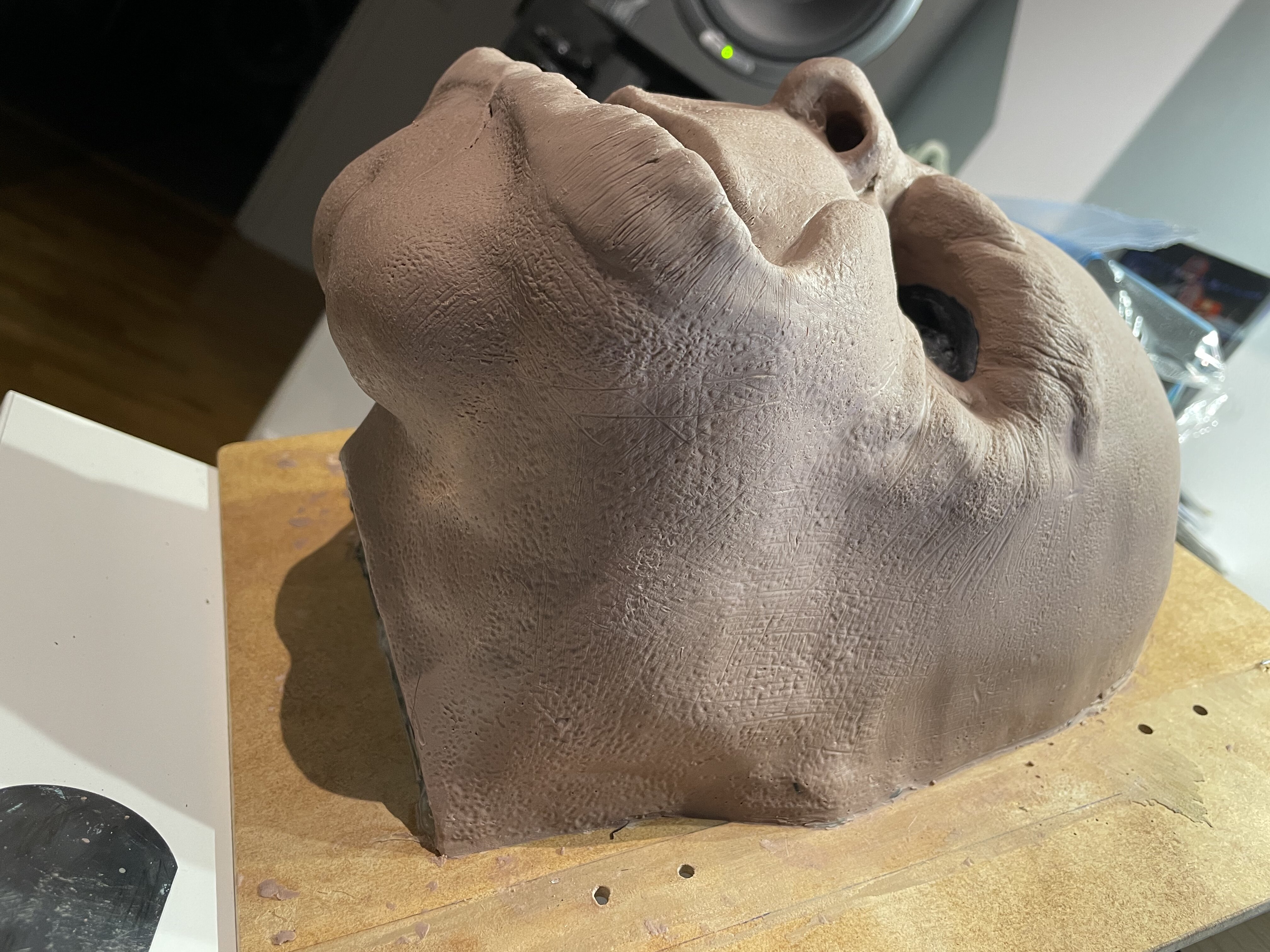

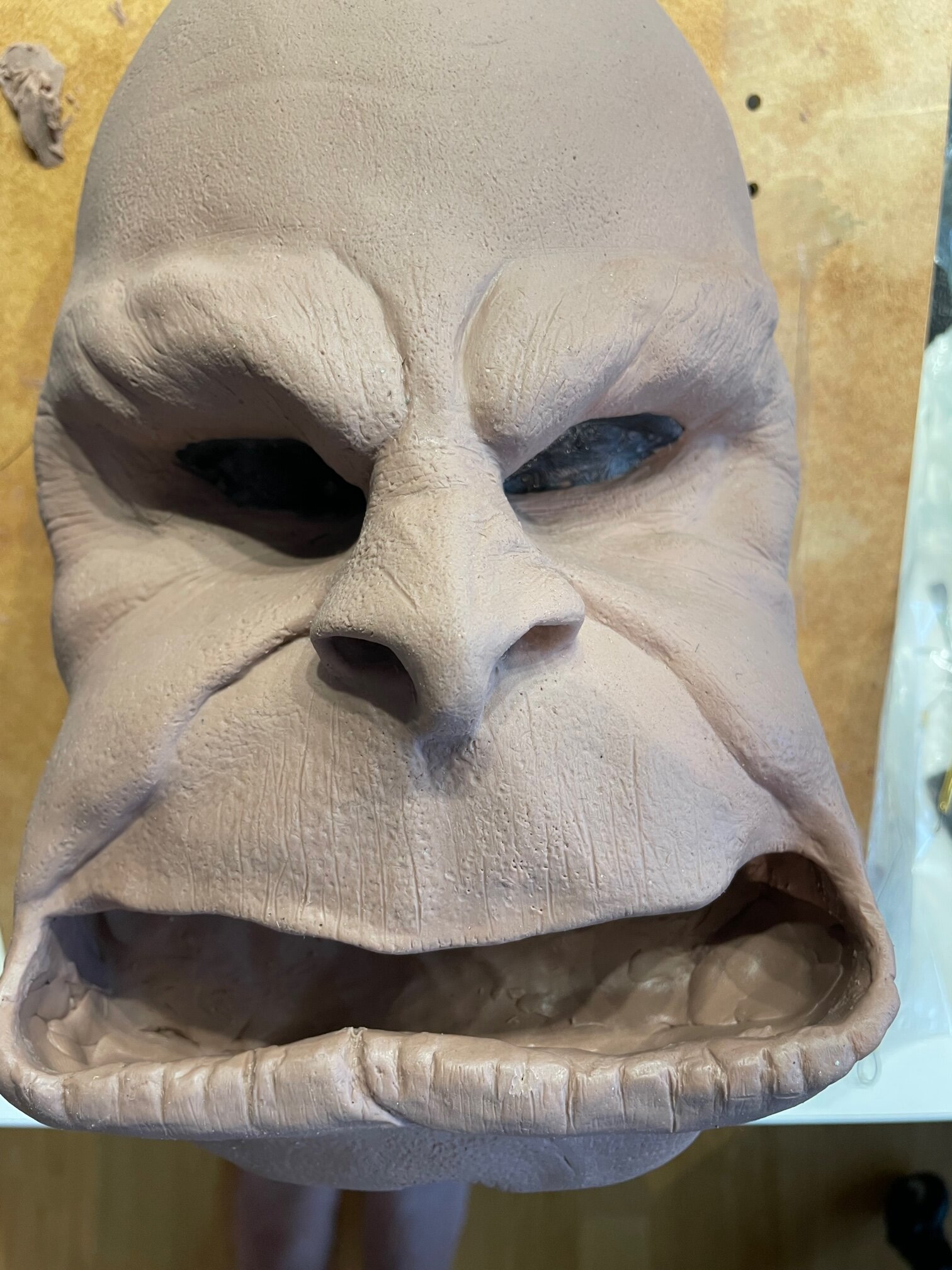

Some progress on the sculpt:
I've gone over the skin with a few more passes to create skin texture, curled up the lower lip and filled in the bulk of the mouth for the upcoming molding of the sculpt.
As I've mentioned, this will only be a "skin thick" mask. The undermask will hold the gums and teeth, but I am getting to a point where I am almost afraid to tinker more with the sculpt before making the mold.
Anything you guys think I should change on this one before I cover it in silicone?
Looks really good. I liked how you made the cheekbones more symetrical.
Will you wear a headress or something to cover the sides of the head or are you just going to have a thick wig?
A side shot to see the jawline and masseter muscle would help.
Great looking sculpt!
Thank you kindly.
It is my first time sculpting, so with that in mind, I'm not half unhappy with it at least =)
Since the character has braids on front of his ears and behind his ears, my plan was to use a wig and attach the braids to an elastic on the inside to make sure they are always at the same spot.
