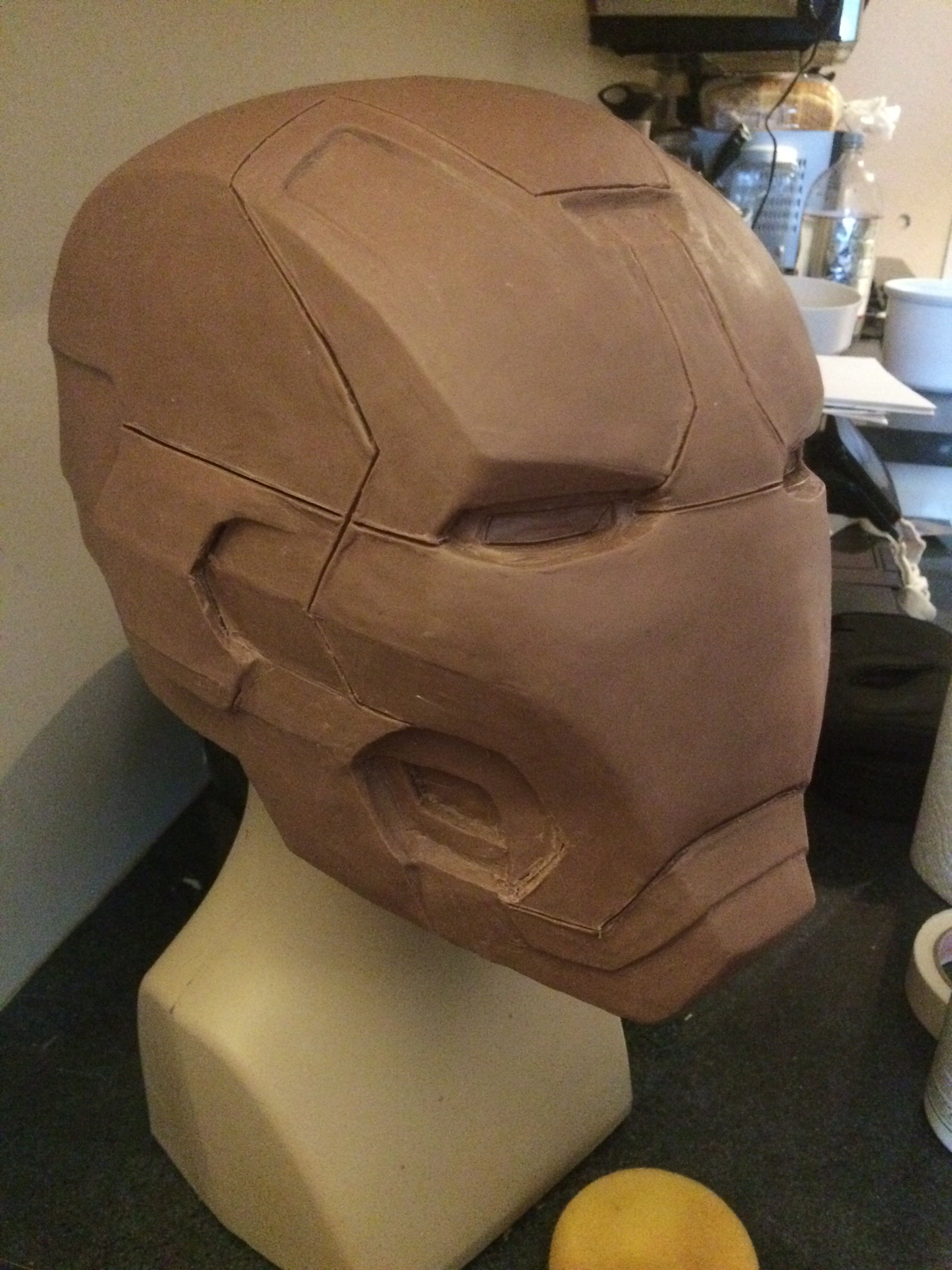

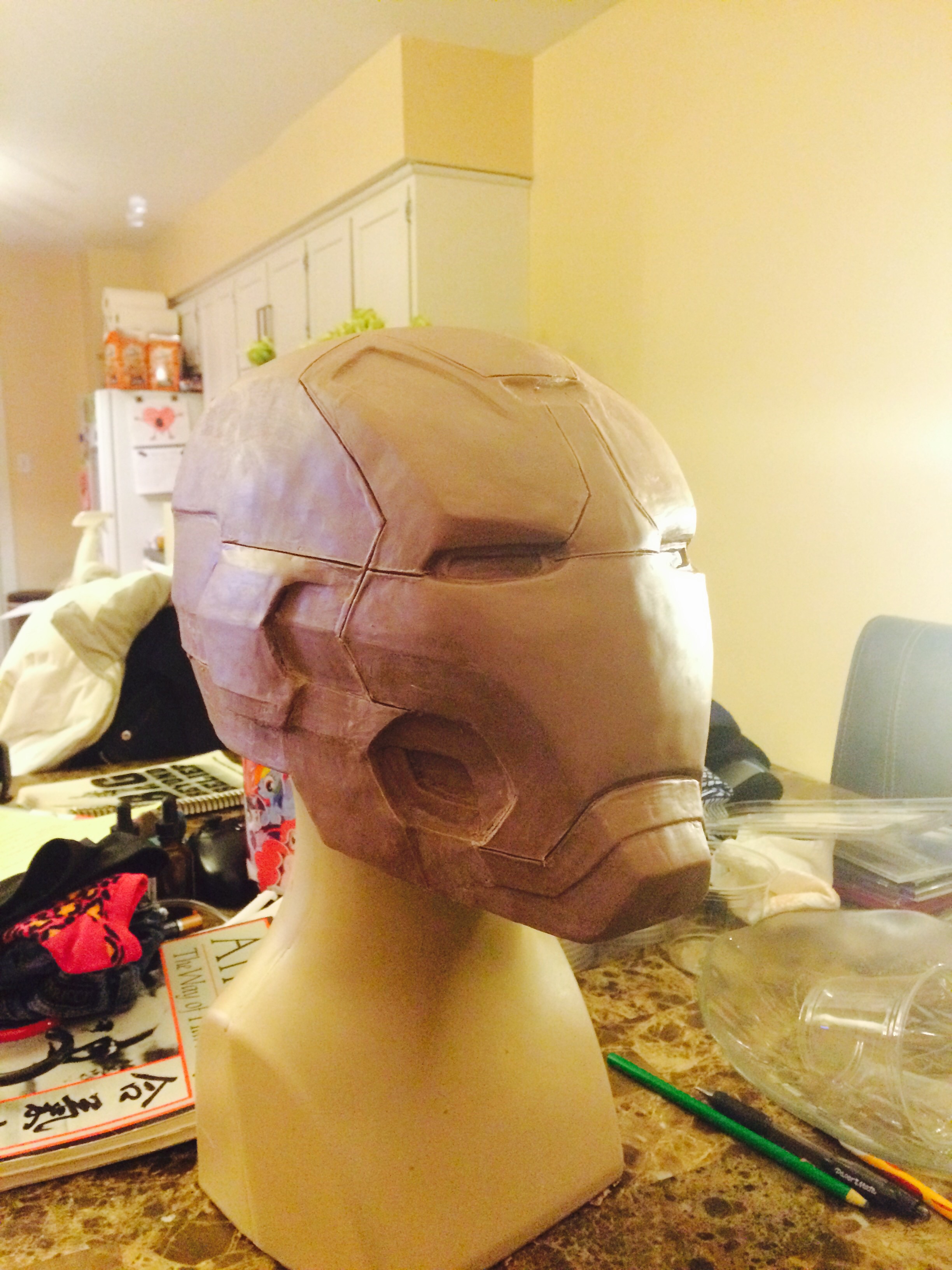

need some help cleaning up the final part of the sculpture. i have been having a hard time getting flat surfaces and crisp edges. any help would be greatly appreciated. iron man helmet is sculpted in monster clay.

Great start...looks like you are almost to where you want to be.Your smoothing technique,I think, is working well,keep refining the surface...but if you want "perfection" you may have to choose a point where you say thats as good/smooth as this material,clay,can get. To achieve an absolutely smooth/perfect surface you may have to mold then cast your sculpt in say...resin and sand it smooth seal it or prime it,then cast again....I know that sucks but it all depends on the result you want.

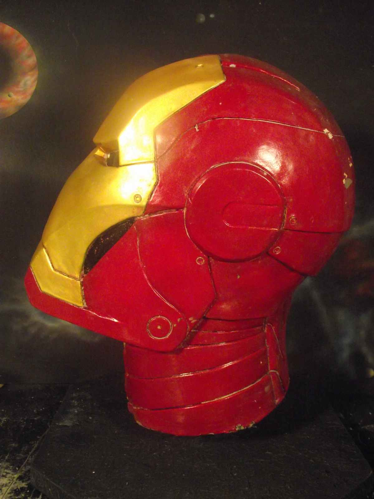

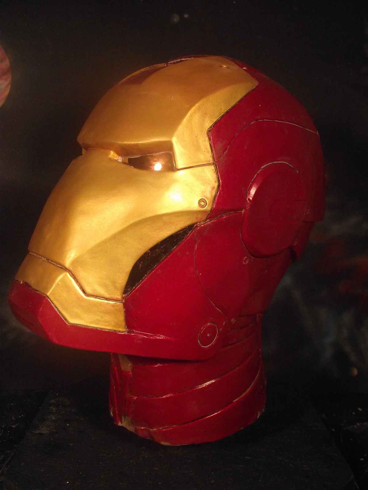

I had the same dilemma with roma plastilina when I did my Ironman.Out of lack of greenbacks (and experience) then I opted for the pretty smooth look...looks ok...but not perfect.Smooth-on has a silicone oomoo reasonably priced and also smooth cast 300 resin.
Here are a couple of pics of mine...I like it but I would suggest...perfection.....good luck my friend.
Looking really good! I've found it very difficult to get surfaces perfectly even and smooth, when working with clay. I know some can do it, but I haven't had much success. Especially difficult with some of the harder clays, like Monster Clay (which I really enjoy using).
Like Colossus601 said, you may be best served by making a garbage mold, which you cast a working piece from. Just something quick and dirty, that you can get a decent pull from. Once you have that, you bondo it, and sand to get the perfect surface. Even then it takes a lot of work, and you may still find a few areas which need a little extra attention, once you spray it with primer. For the lines, you can also crisp them up at this phase. Using a combination of needle files, and blades, you an cut them as you need. If the general shape is there, and you just need to crisp them up, you can use a thin gauge piece of stainless steel (or similar) with 220 or so sandpaper wrapped around the end. Run that up and down the channels to really even them out.
If this is the only piece you're making, then you're done, and ready for paint. Otherwise, time to make the REAL mold.

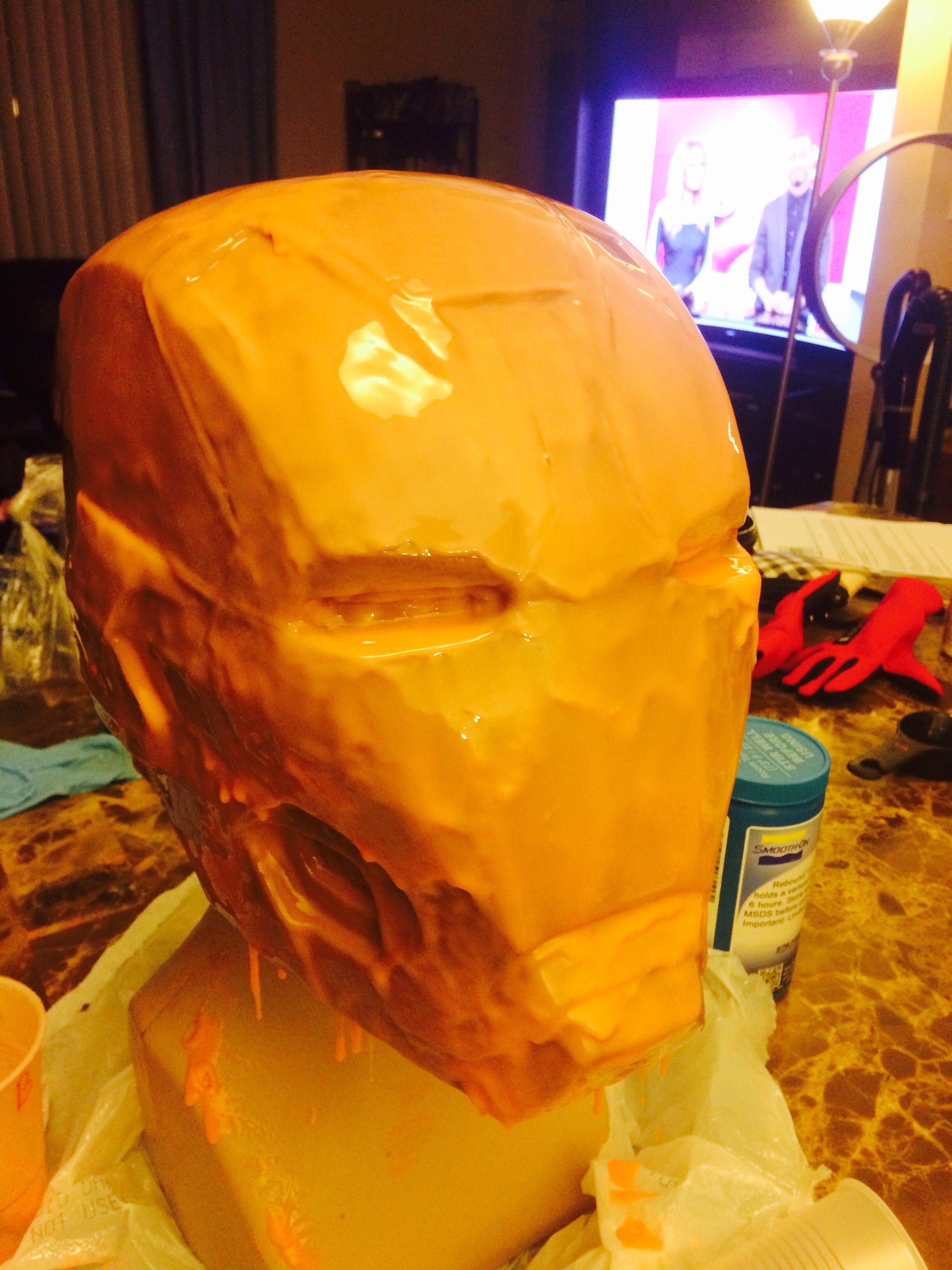

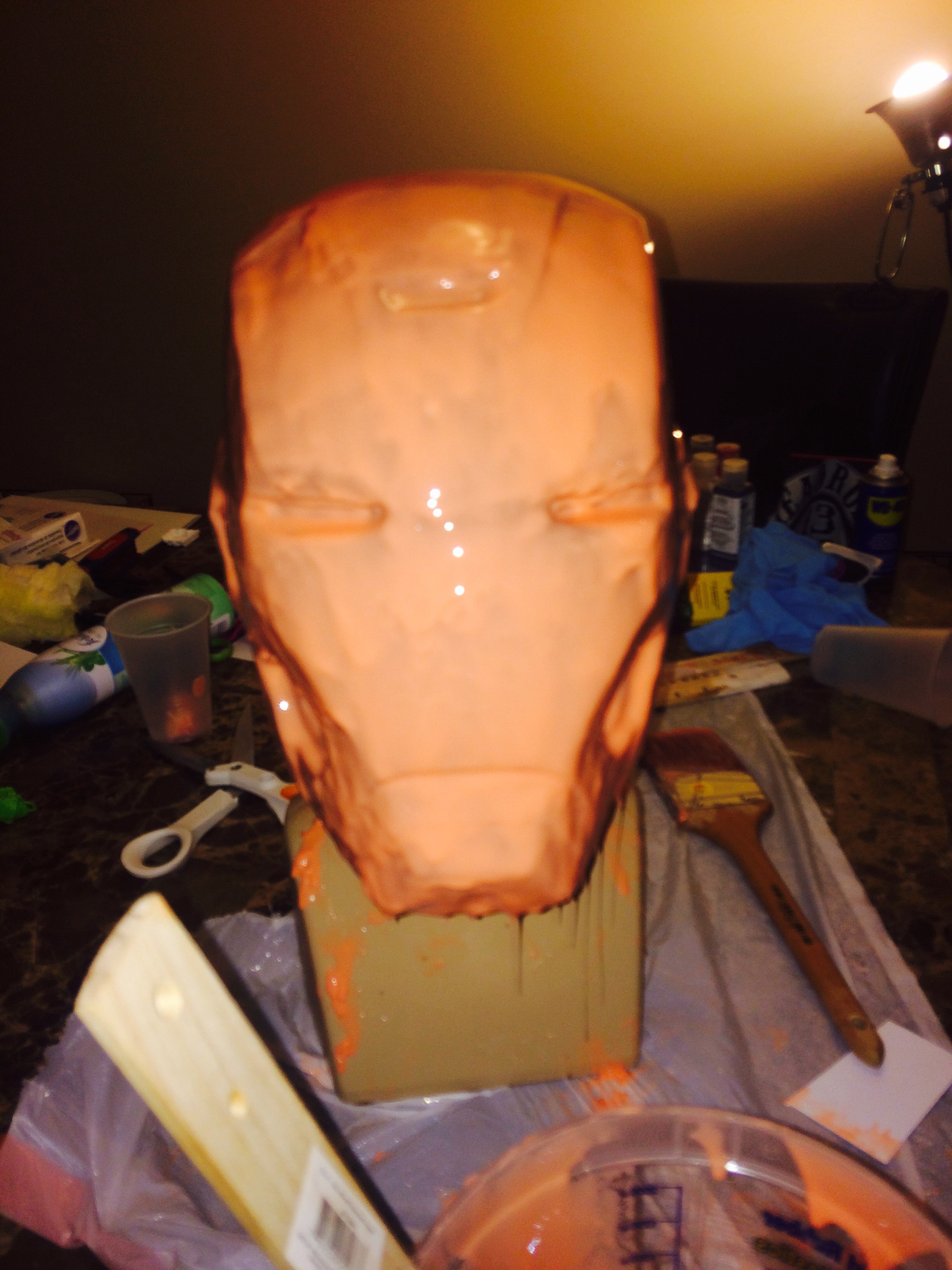

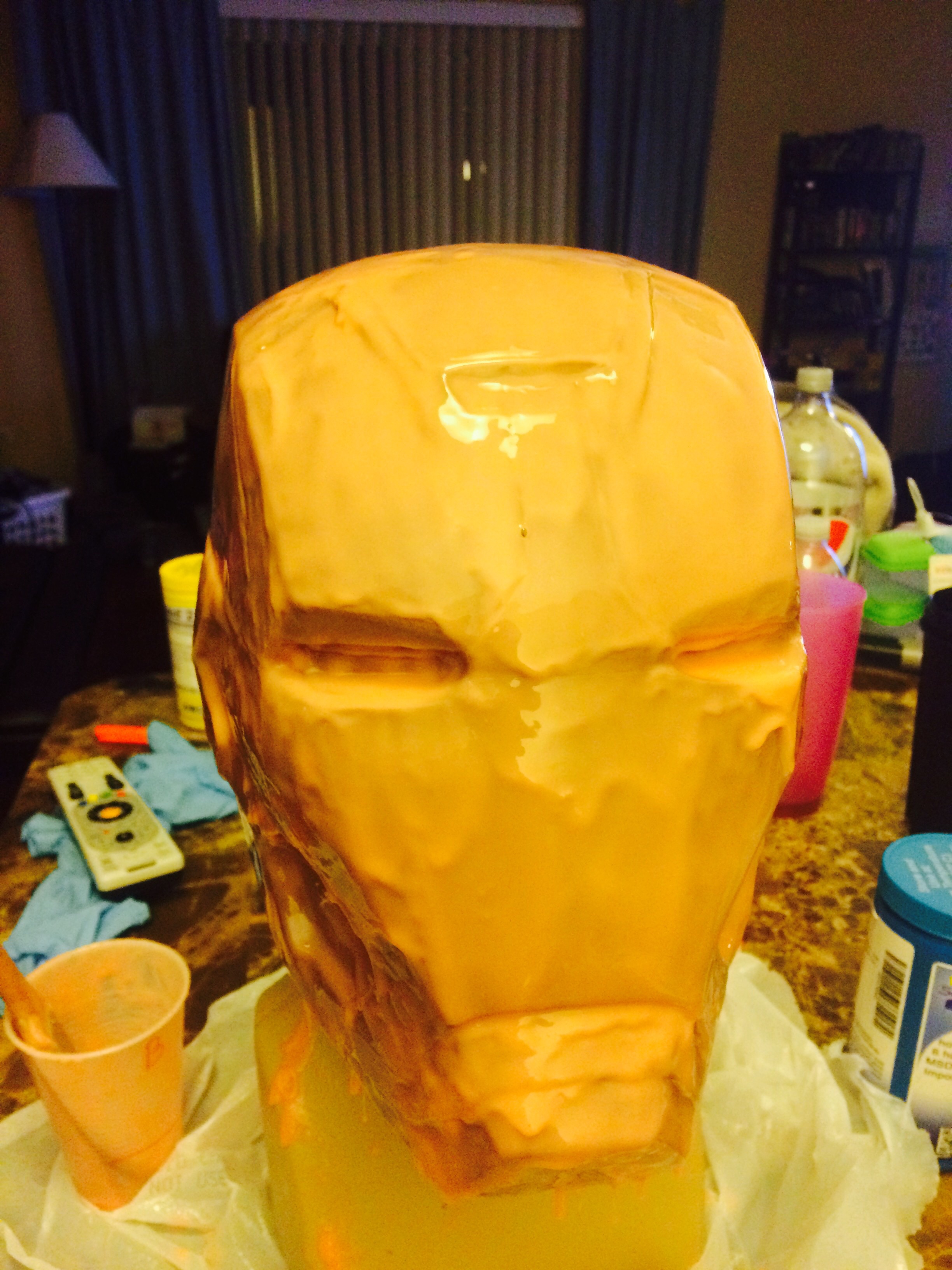

So here are some pics of prosses rebound 25
5 total coats
2 regular
1 slightly thicker couple drops of thi vex
2 with 20 drops of Thi vex
i used 2 total trial kits of rebound 25

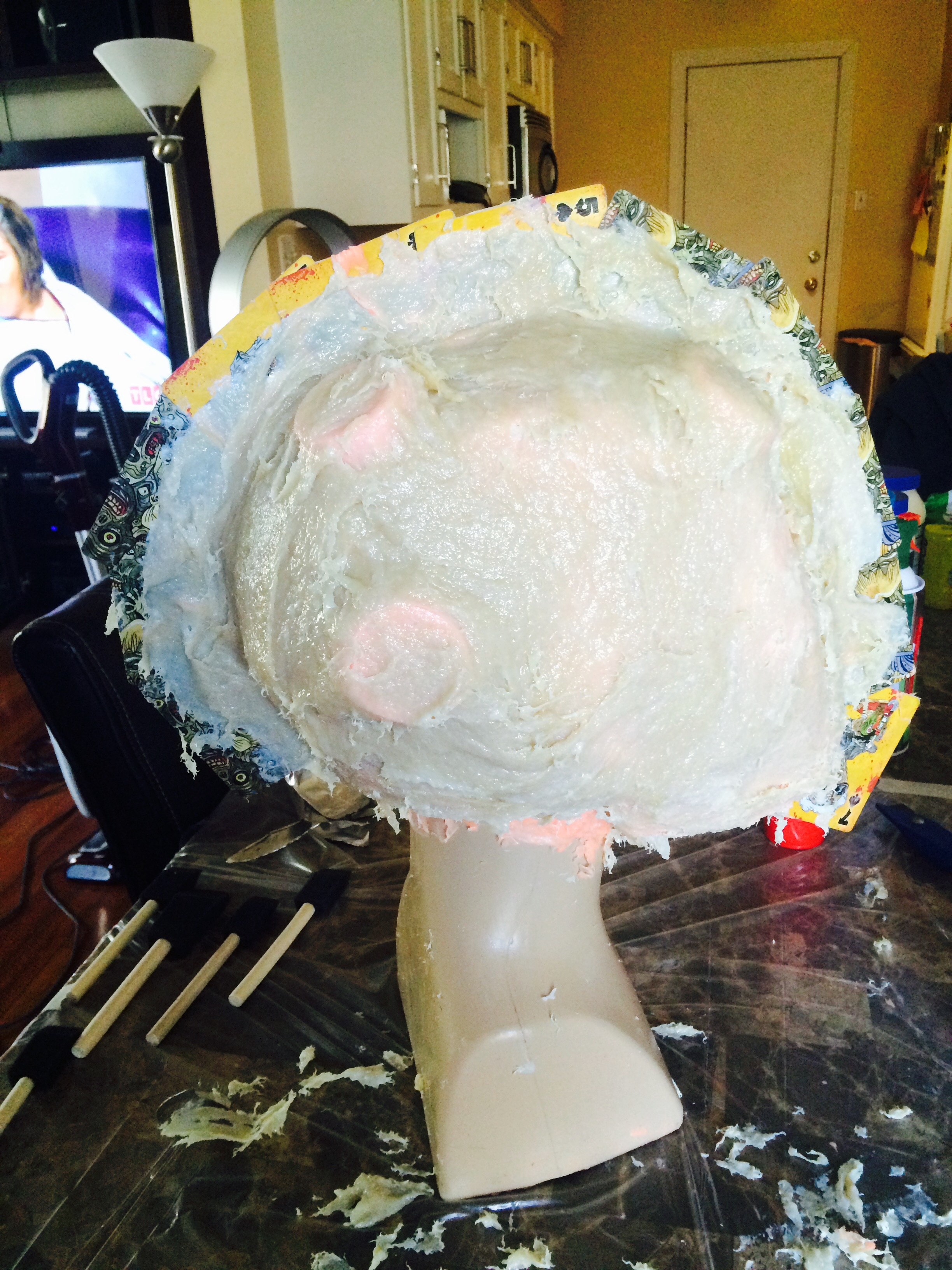

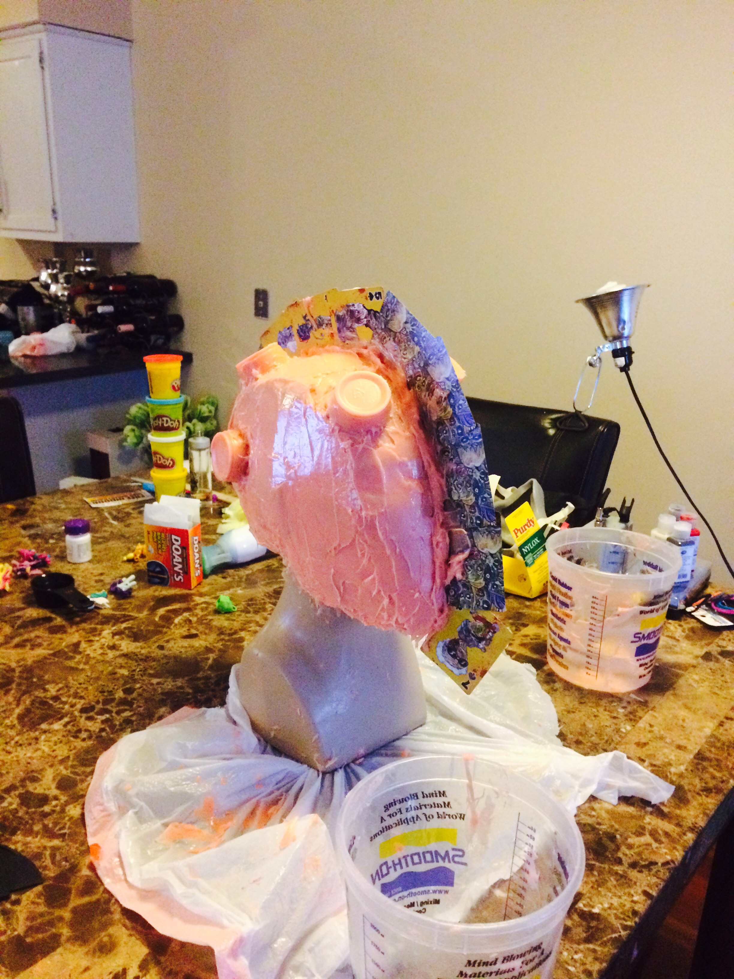

i figured more is better first time. Next I had one trial size plasti past 2 just letting everyone know that was not enough.
one side was thick enough but couldn't make second half thick enough and it cracked on demolding. So I just ordered the 13 lb one so won't run out and I can re enforce the good half and make it smoother.
i noticed that the silicon on the back of the sculpt pulled away some so not sure how it will come out I'm sure bondo and sanding will eventually get it right. Then make a new mold off the final copy.
Total time was like 8-10 hrs I think. I'll get back to you guys once I pull my first copy mid next week when plasti past 2.
next time I will get the thinning stuff you were talking about and I need like 2 color dyes to show were I went over I think that is super important becuase it gets tricky to tell were you just hit or were might need more.
Thanks again with all your help on this.

one more thing on the plasti past 2 either pack the cups tight or weigh them I had issues with how much liquid to past I ended up with. I had more past then liquid. Next time I will weigh it out.
liquids type stuff like rebound or casting resins are fine to just fill in cups but past doesn't seem to work out as good with out weighing it. At least for a newbi like my self.
Cool, looking good! You're right, the shell looks a little thin, but should do the job for your waste mold.
I always seem to wind up with more paste than hardener with plastipaste as well. One more tip there, for next time: pick up some denatured alcohol, and pour a bit into a cup. Once you have the mold covered with plastipaste, dip your fingers (with gloves, of course) in the denatured alcohol, and smooth out the shell; dipping them back in, when the paste starts to stick to the gloves again. Some people do the same with a chip brush, but I personally don't think that works as well as your hands. Anyway, this will make slush-casting much easier on your hands, when you put the real mold to use.
