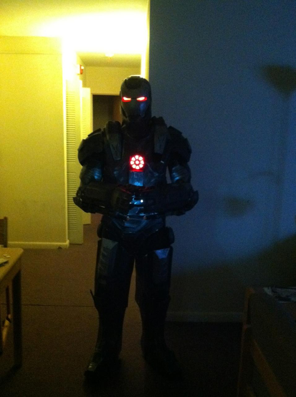

Test of System Electronics

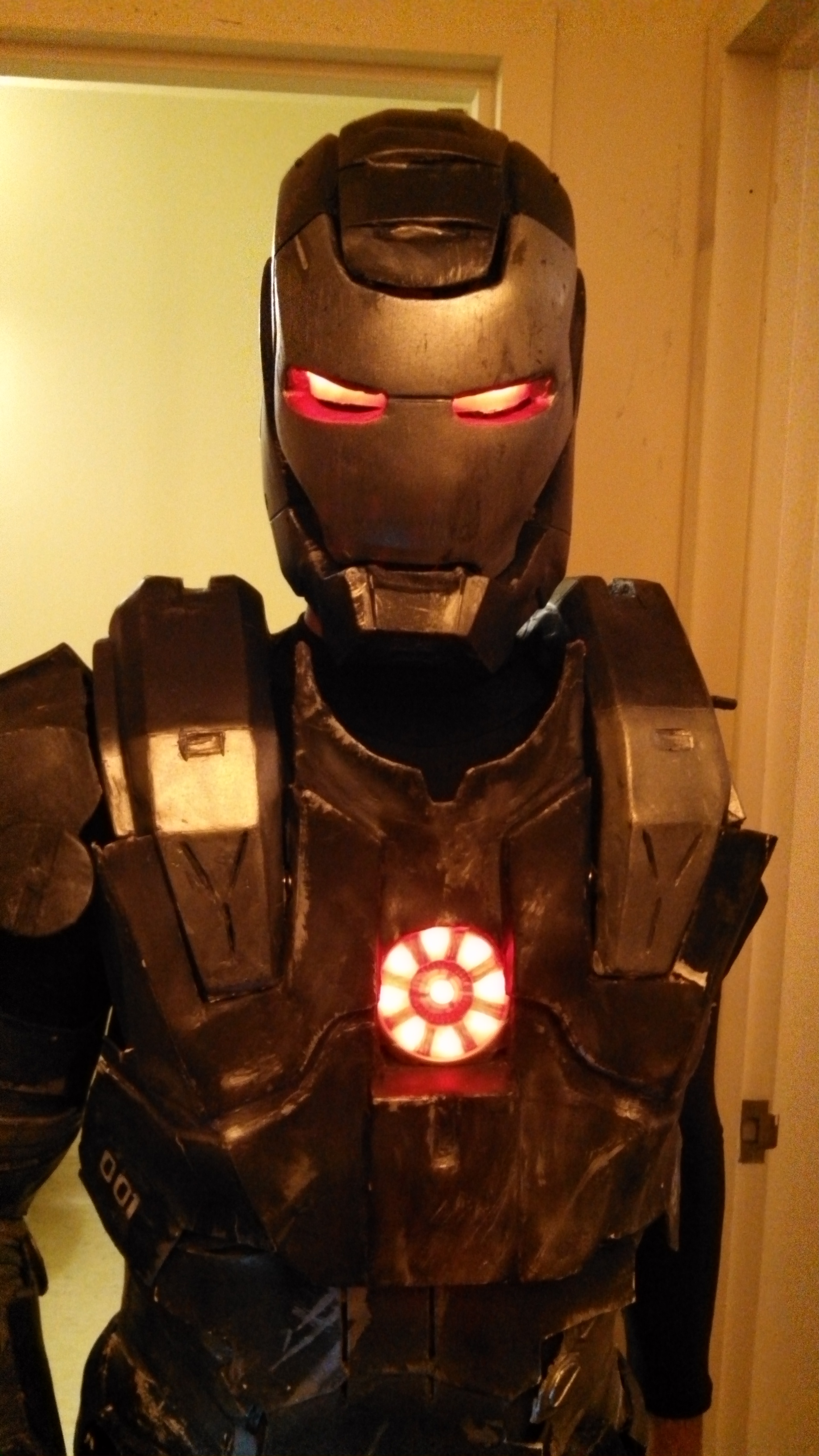

Backstory: So I always loved the War Machine armor growing up and when I found out he would appear in Iron Man 2 I was psyched out of my mind. Seeing this badass come to reality was awesome and every time I watched the movie I just thought "why not me??!". So one day I'm minding my own business on the internet and I stumble upon a video of someone who has made their own armor. Be still my heart someone made their own? Continue my awe to find out it's not just one person there's tons of amazing creative and talented people who have taken the leap to bring their favorite armors to life. Inspired I decide to see what it takes to make armor and begin my education. After watching countless videos from people on all kinds of processes and tech I decide I'm ready to begin my build!
The Build: My original plan was to make a totally foam suit and call it a day. As I began I was still looking at other suits though and as I did I became more ambitious wanting a more realistic and detailed suit. This led me to think why don't I try a technique I saw detailed by user xrobots involving the plastic coating of foam. In his video it made this gorgeous smooth finish over the light foam and seemed ideal. Sadly I'm not as gifted as xrobots and couldn't master the technique so I abandoned it. This led me to a second path of using bondo on fiberglass reinforced pieces. This had a much more favorable outcome and allowed me to cover my mistakes with the plastic coating. When it came time to do the helmet which I considered the most important part I decided to try my hand at a regular pep job with cardstock as a base since my first attempt at a foam helmet came out wonky. The result was glorious and made me realize that for my next project I will be making that my method of choice for the whole suit. I also used cardstock for the mini-gun pep.
Build Time: 1 Year. What can I say I was slow because it was my first project and I'm in grad school. That coupled with not having a constant space for workshop use and having gaps of a month where I couldn't work on the suit made progress at times crawl
Cost: Somewhere in the Ballpark of $300. Honestly a lot more of my cost came in the fact that I had so few tools or materials to start so I needed to buy basic things like a exacto knife or a sander. Also electronics can add up
What I Learned: SO FRIGGIN MUCH. Honestly there were times of failure or frustration but it was a learning experience and I still wouldn't trade it for anything. As a total novice to such things there was some apprehension trying at all but there were never problems, only obstacles I had yet to navigate. I would offer the following tips to people trying this for the first time (get ready for random advice)
