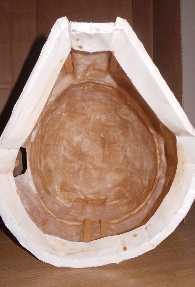

I decided to start with a Boba Fett helmet and use this as an experimentation piece with regards to how it goes together, gluing, cutting etc. I am also having a play around with ways of hardening the final product and smoothing it out. I live in a small flat in the UK and have a 2 year old running around so after reading about resin and fibreglass with how potent it can be I decided this probably wasn’t a good idea. I have decided to try using wood glue from a post I read and also adding Baby wipes as I have plenty around on the inside instead of fibreglass from another post. I have started with the glue layer so far so will see how this turns out and how many layers are required.

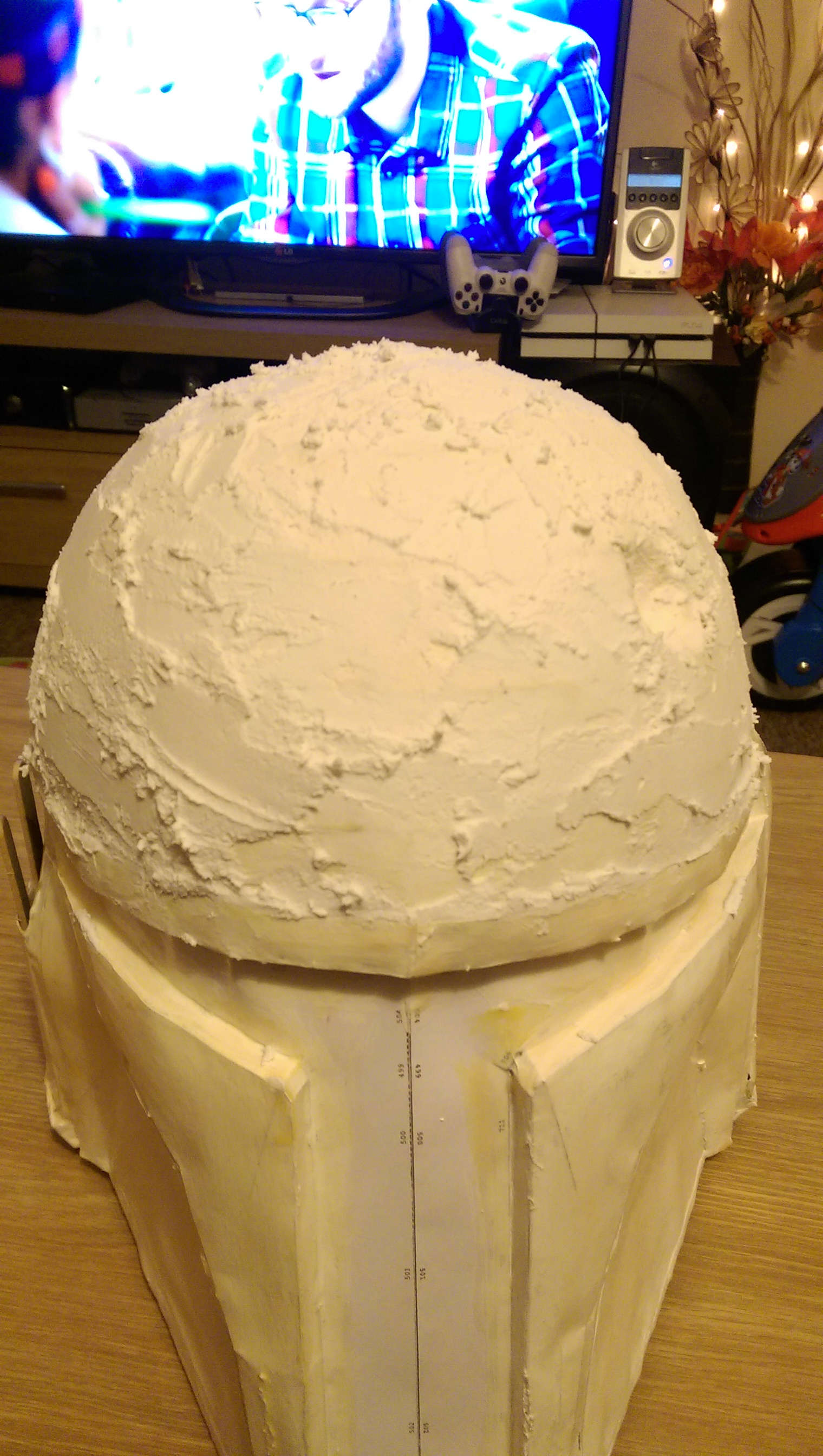

Onto the build, I decided (after much toing and throwing) to start with the top dome which come together quite well but a few mistakes which hopefully I can fix later:
Now the bottom of the dome has a ridge around the entire helmet which was very fiddly and to be honest looks awful at the moment I am hoping that when I attach the bottom it will shape this out and then can fix it later with the putty/filler:

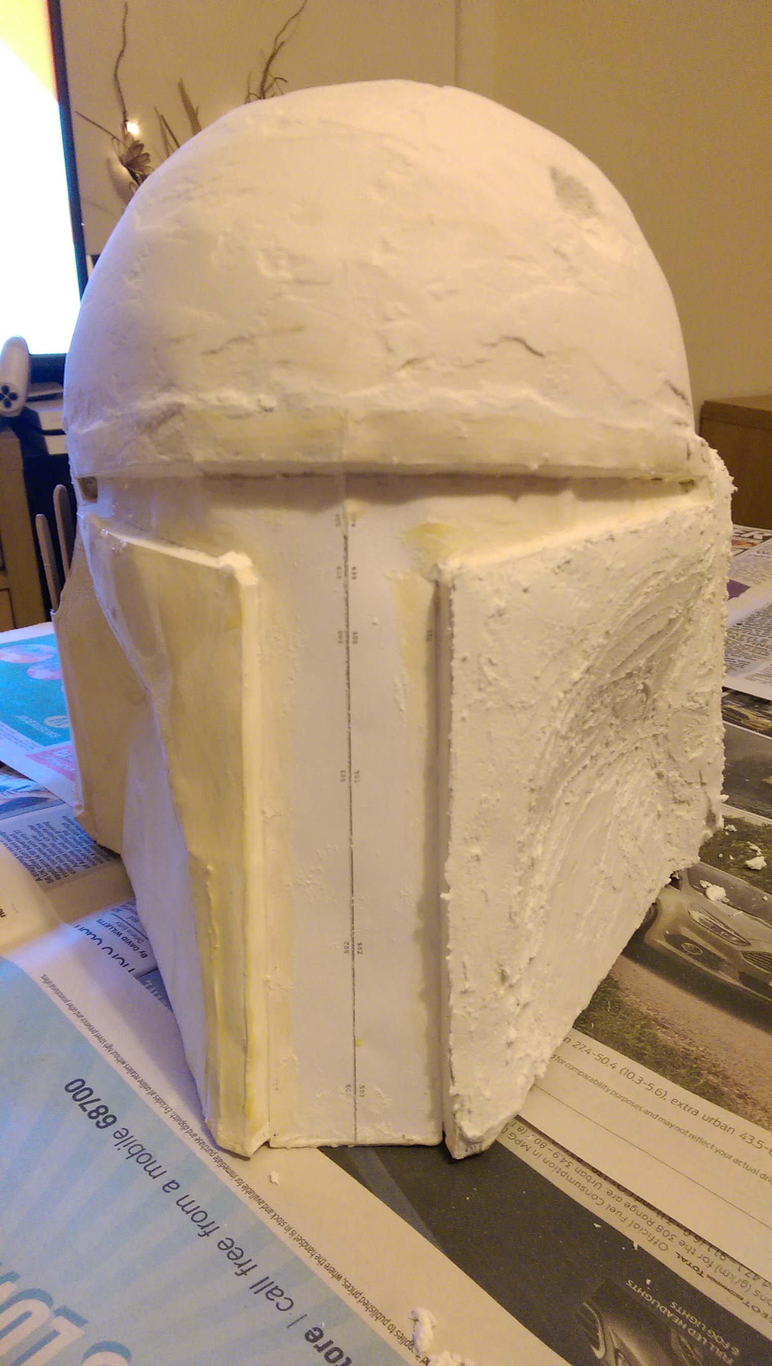

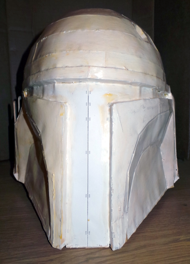

Now I decided to do this in a few stages, top dome, front and then sides/back. Started on the front with the main holding structure and now to put the curved pieces on the side:
One side done and looking OK not the best but again I am hoping to fix this with the putty/filler:

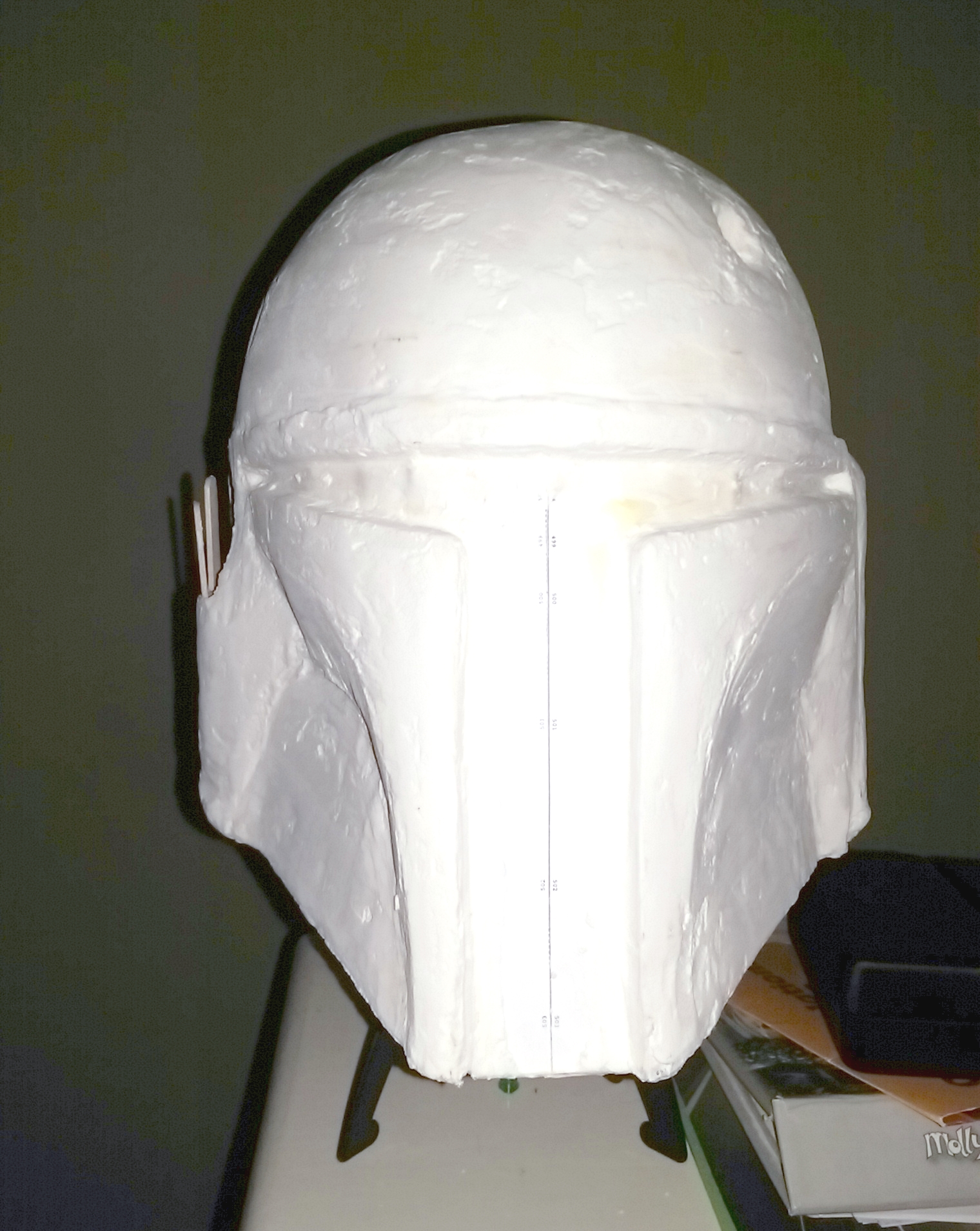

Pepakura stage is now finished with sides and back complete:

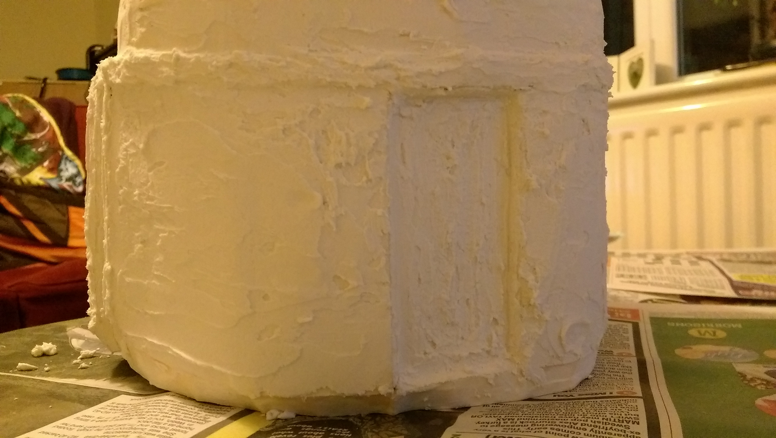

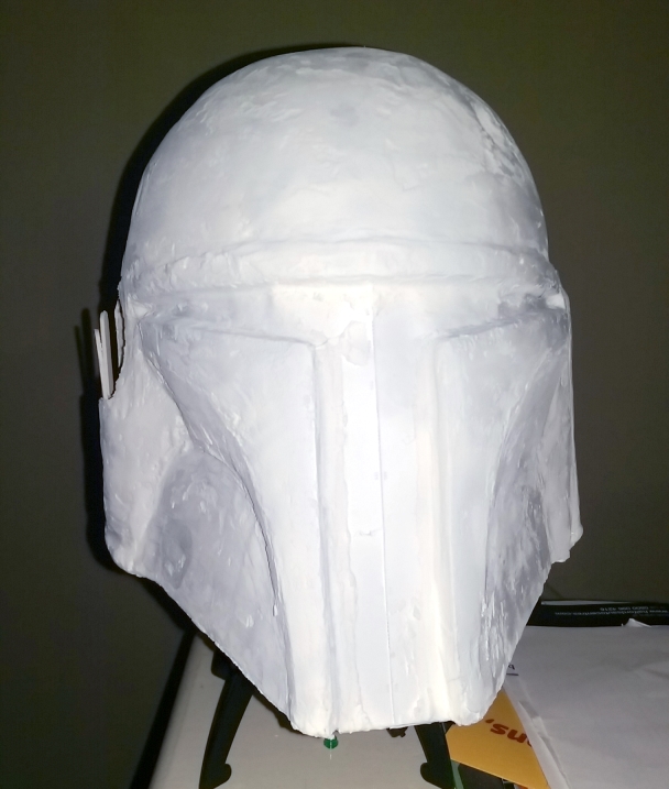

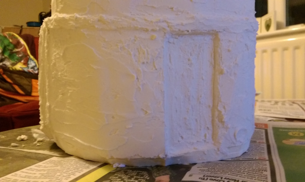

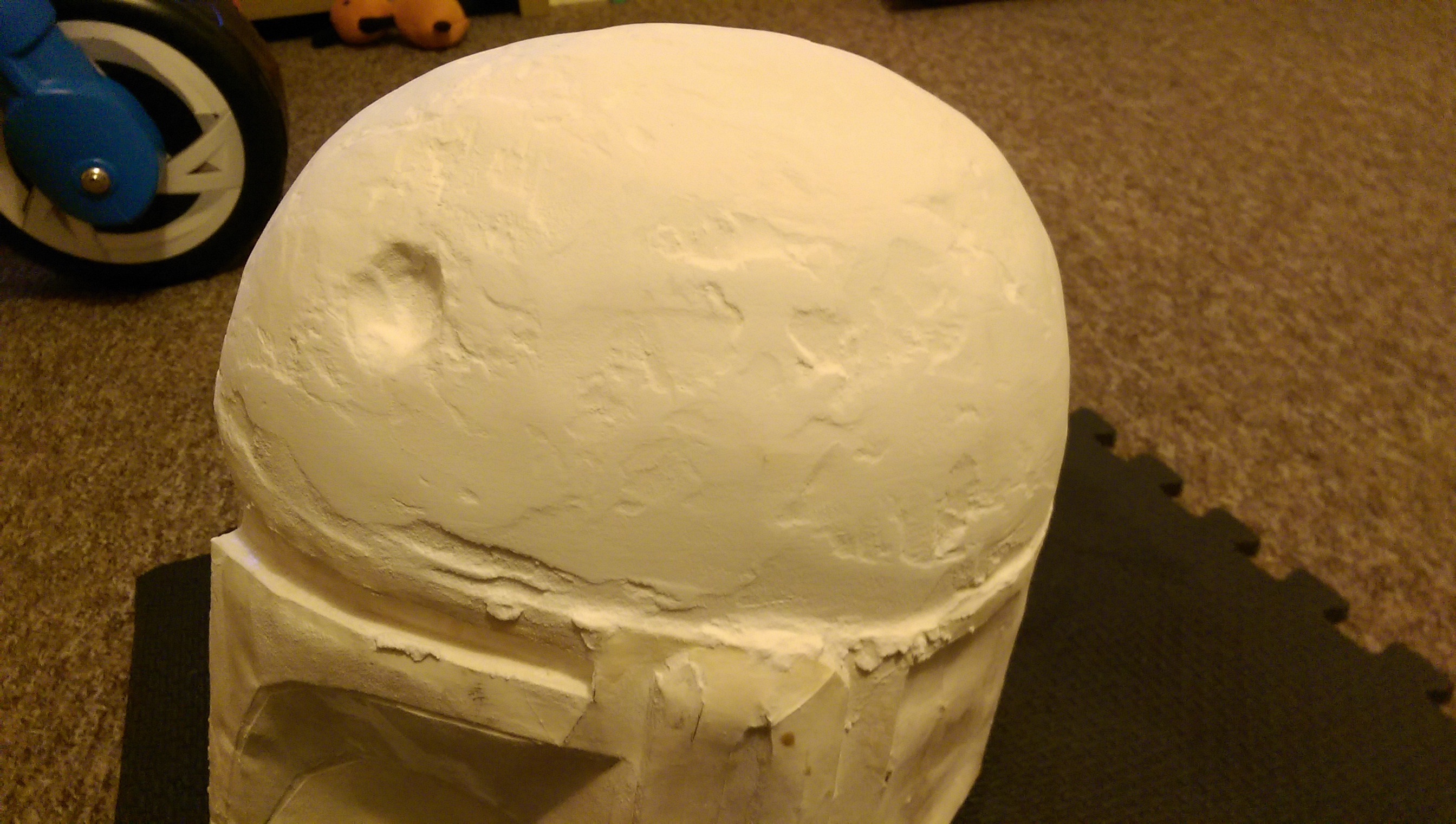

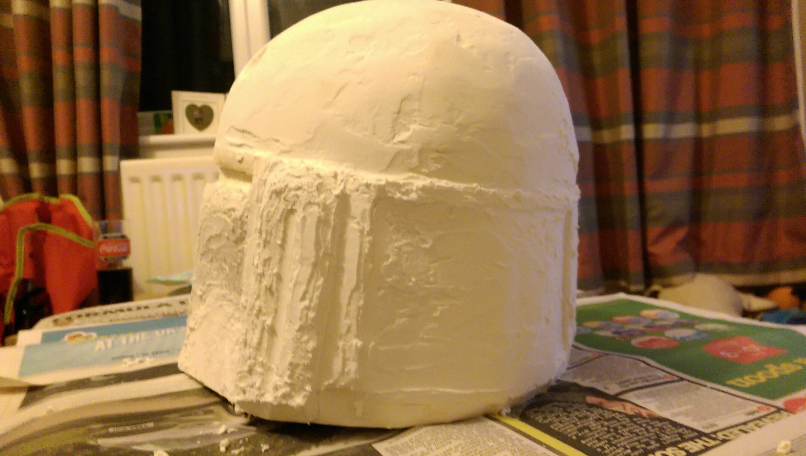

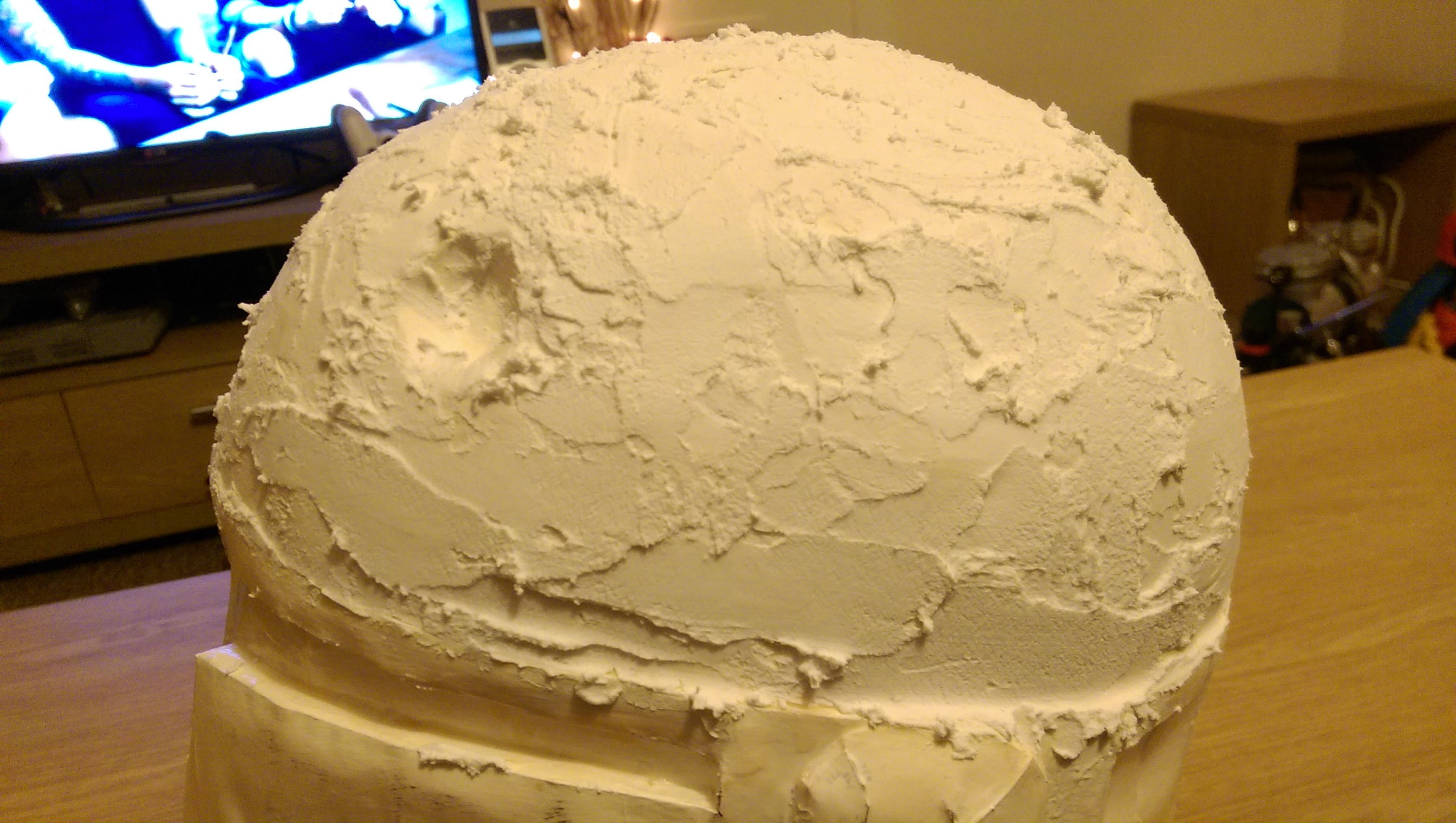

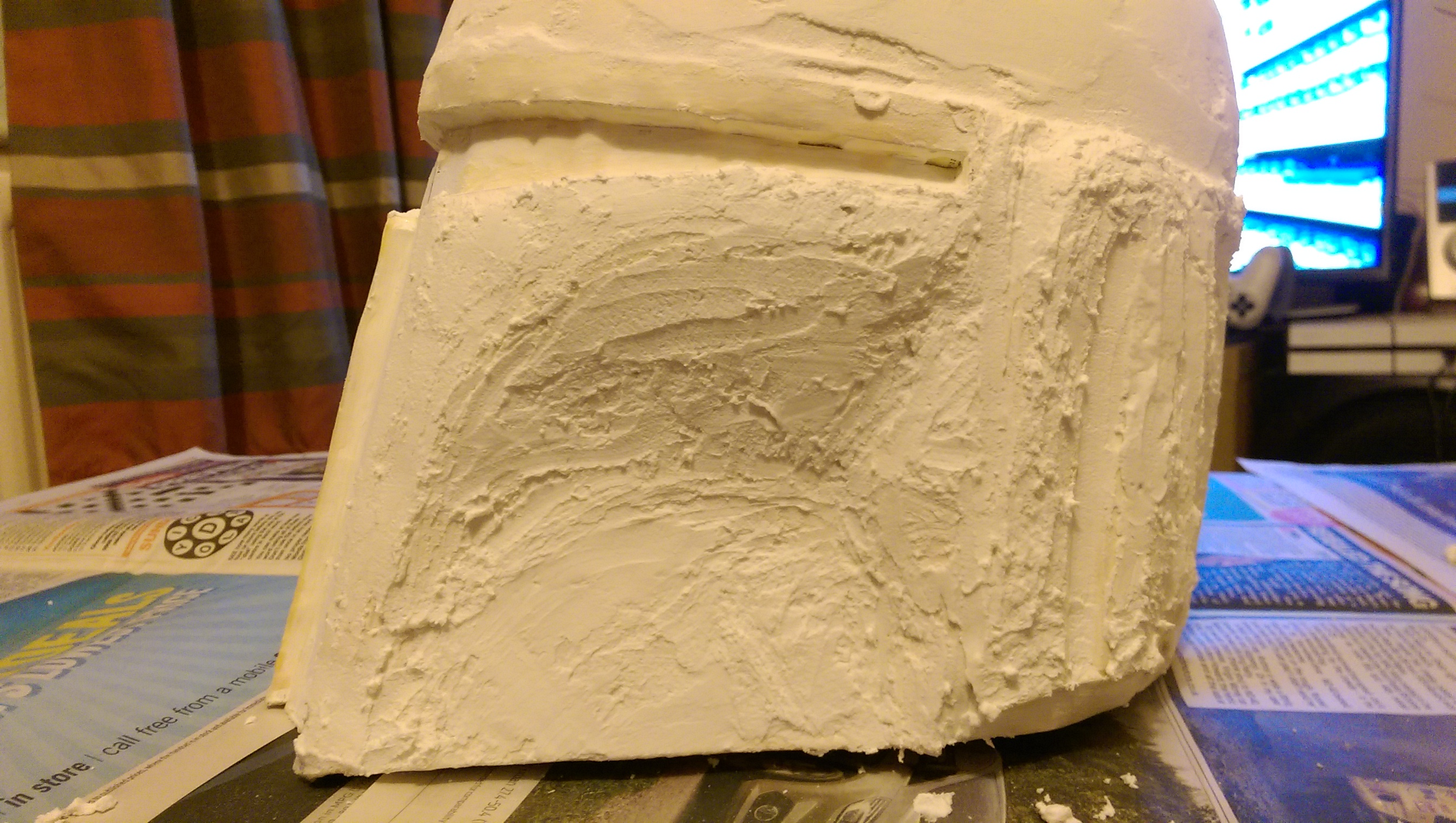

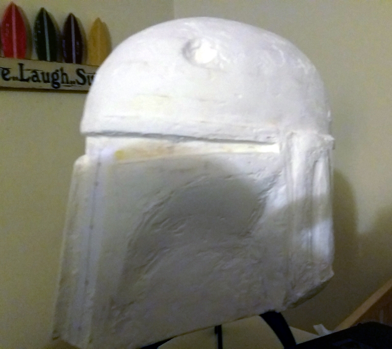

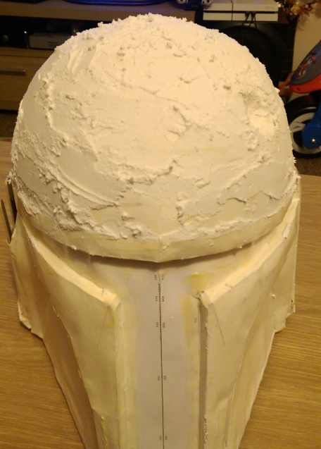

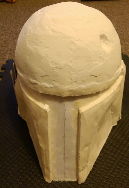

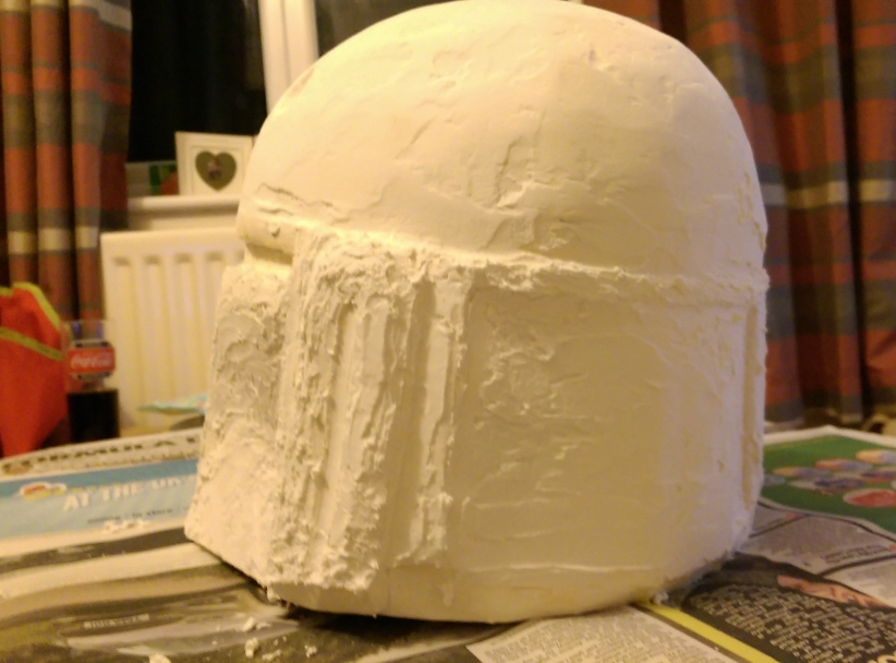

Time to start wood gluing, I have decided to start with smallish sections at a time starting with the bottom to give it some strength and shape and then work up the outside. I done some experimenting with using small amount of water in the glue and without water at all. With water is much easier to apply and surprisingly had a better, harder finish than the side without water. There is slight warping which I expected but as I am doing small bits at a time until it is fully covered inside and out it hasn’t been an issue so far.
I am really pleased with the way it looks for my first attempt at this at the moment, I am sure I will probably remake this helmet later when I get better at the craft but it’s a good learning piece. I also have 2 other models to create and those will need to be done better as slightly more complex – ANH Stormtrooper helmet and Toothless head from ‘How to train your Dragon’ for my son which I will hopefully have more build pictures as I go. I am hoping my wood glue, baby wipes and water putty/filler will hold up as these models are not really to be worn/carried/used over any length of time but for display for my partner and son. I will keep you up to date with progress and with what works/doesn’t work.
