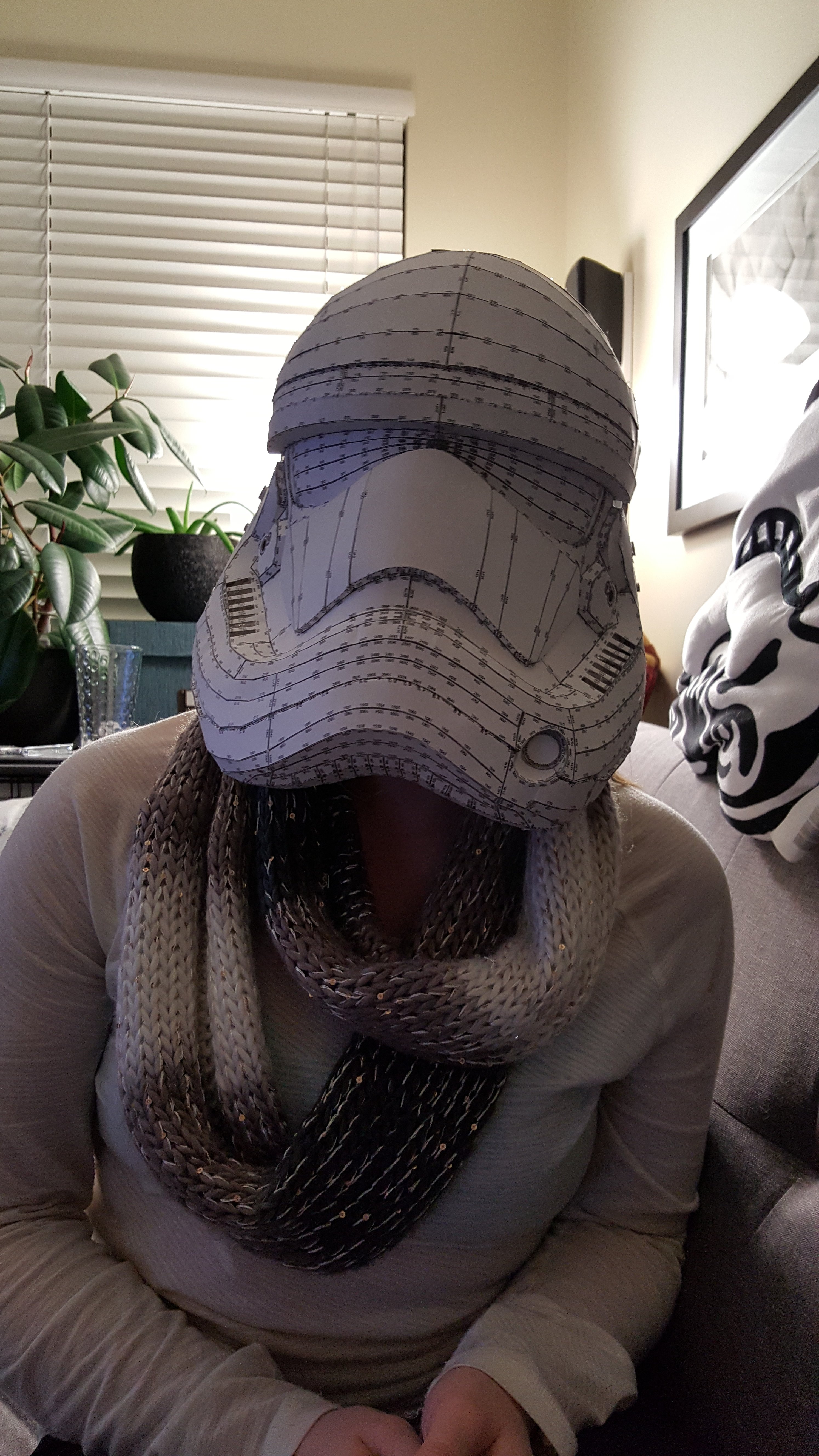

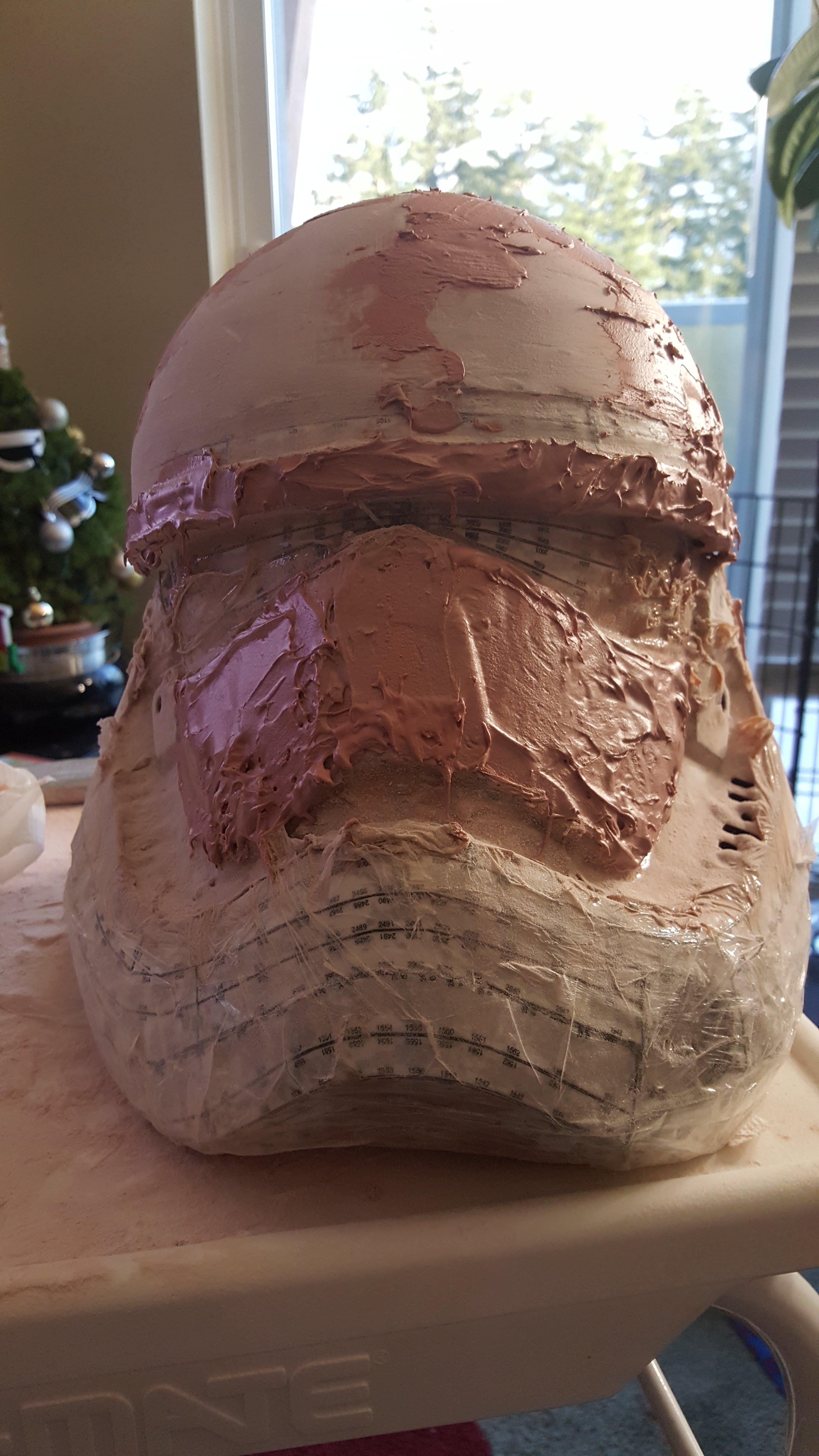

So i made this account inhopes of finding a RC pep file, since i finally i did i figured i would post up my current WIP. this is my first real pep build. So forgive me if my skills are not up to par for most
https://mega.nz/#!toAHkZTb!BBSKtZTVucw-IjyH6w5A0ymJFGsz4MqqCuUPw1TmQAM

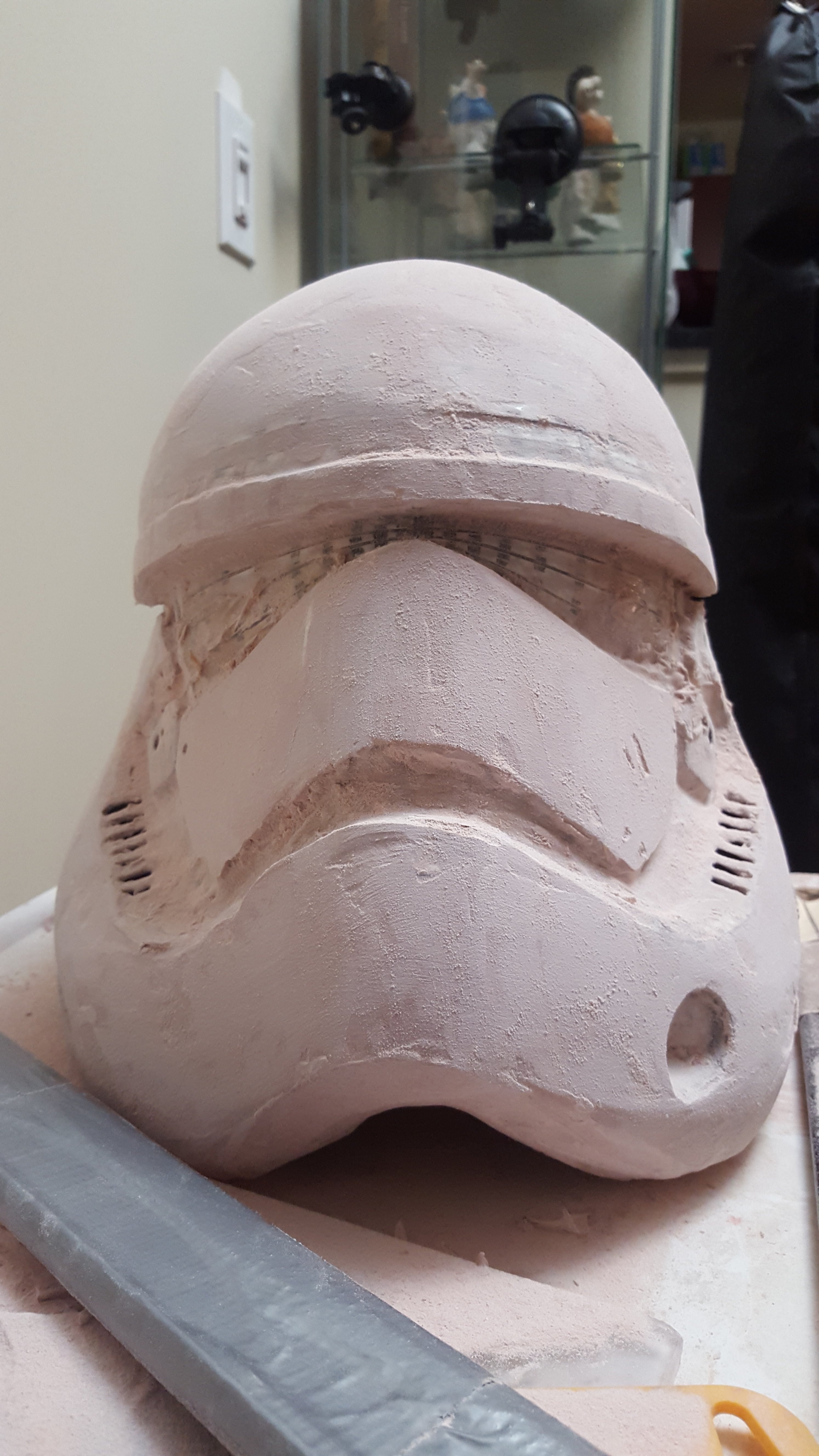

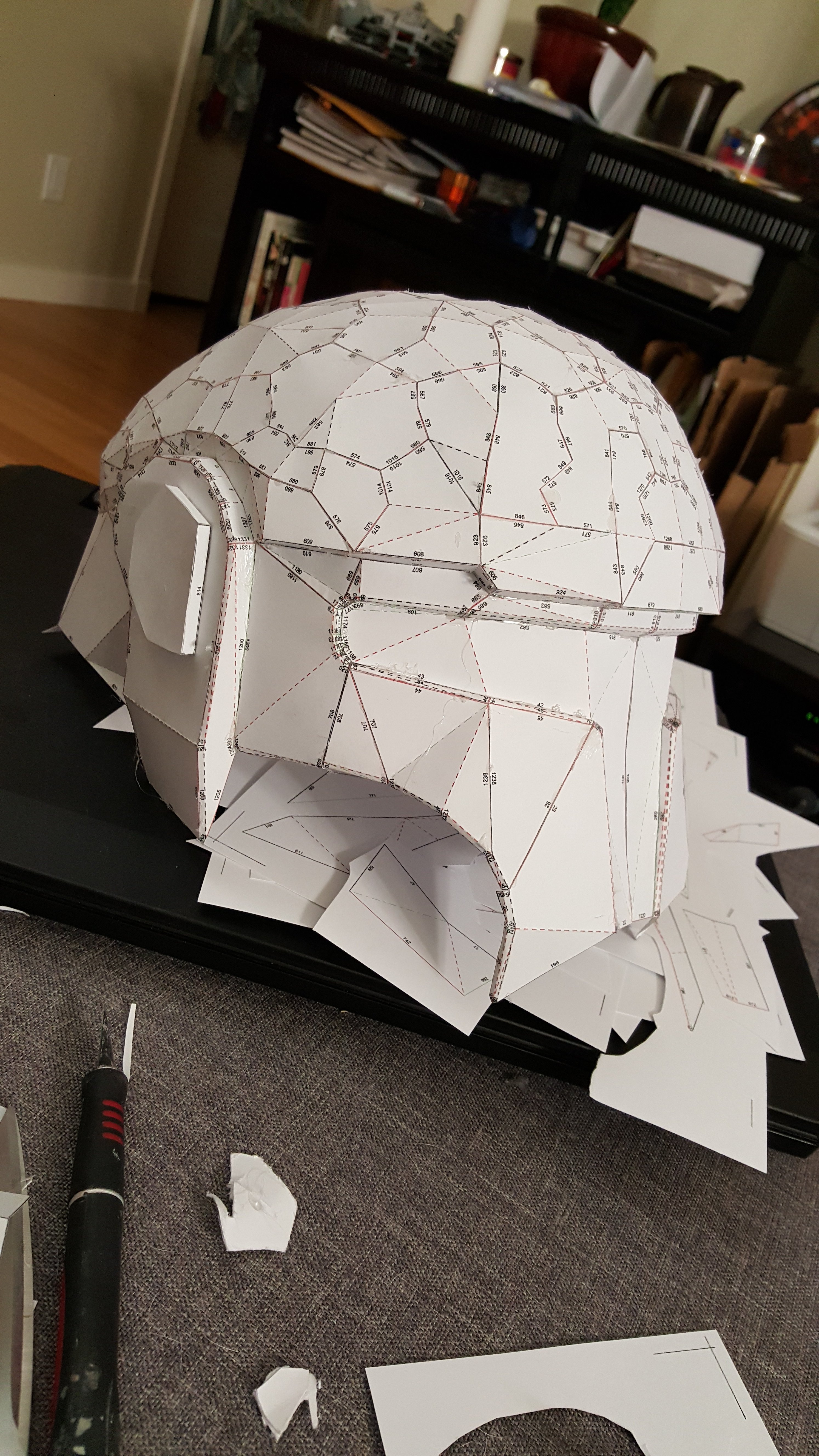

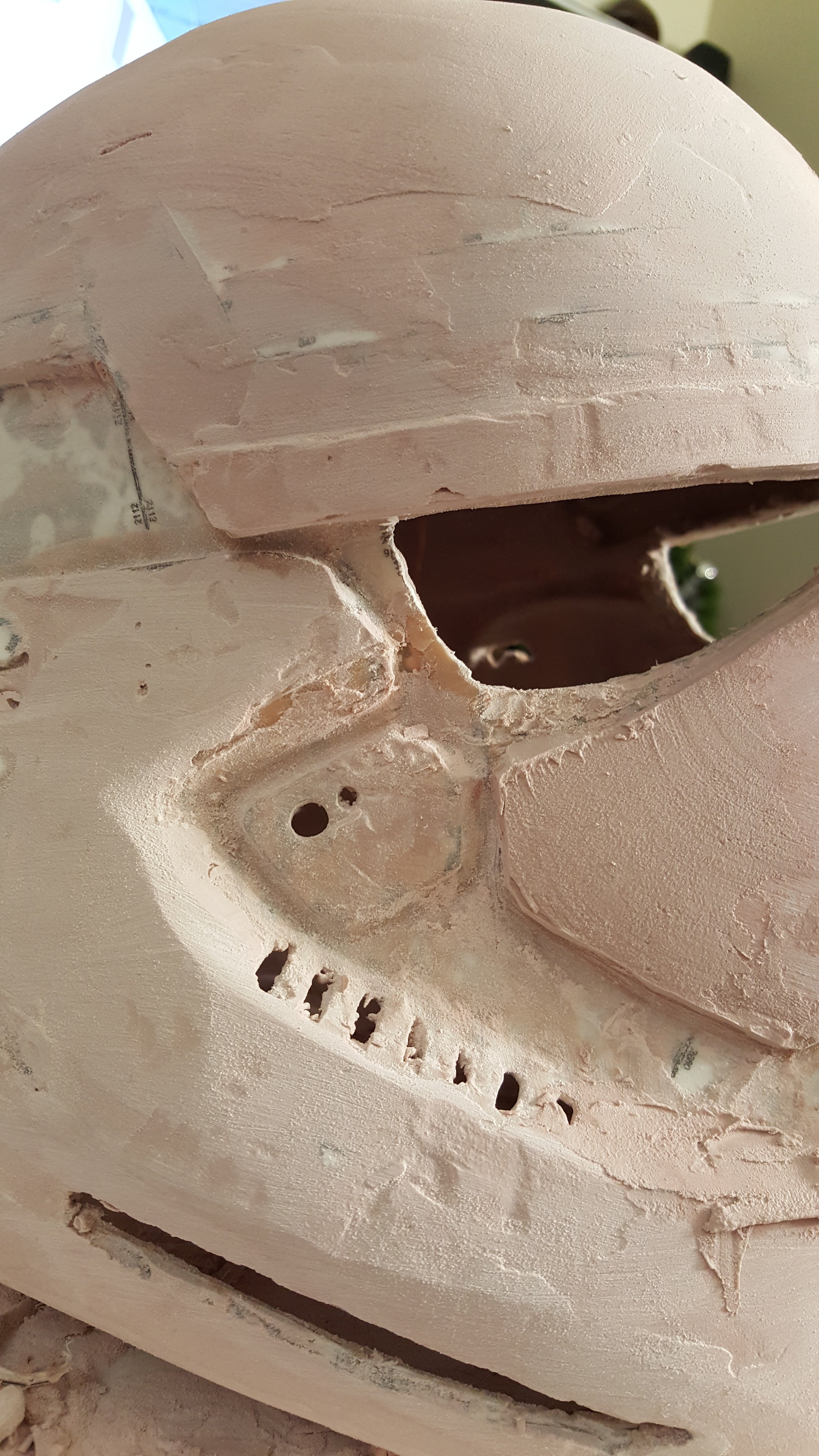

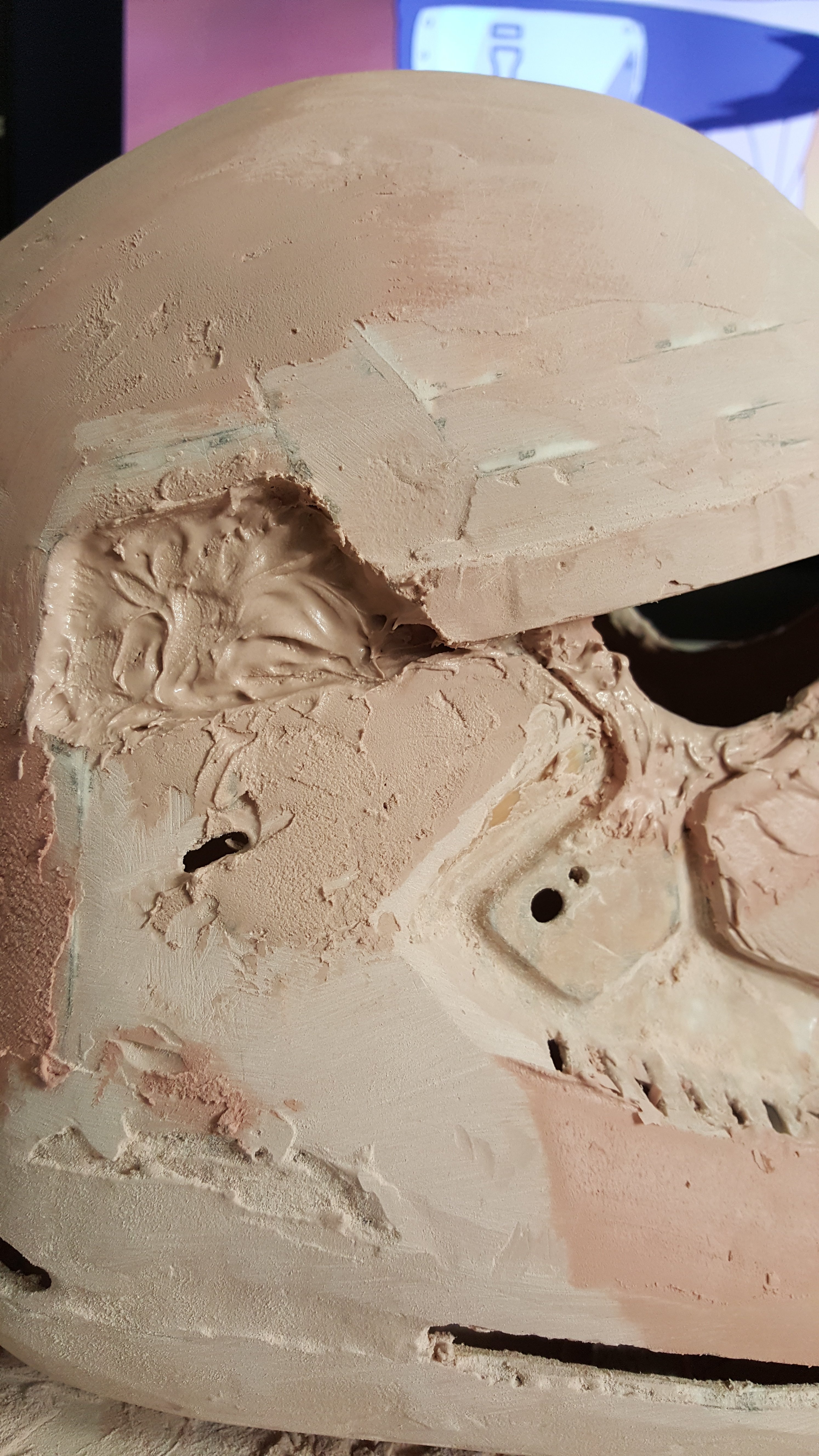

Out of all the files I found this seemed to be the most accurate. All besides this one seemed to be to narrow and just never looked right because most were done pre-release of the movie. I used the 2nd helmet because it was much more detailed. Anyways. Started this roughly one week ago and here's some pictures of the progress so far. I'm sure some or most of you will think I'm quite heavy with the bondo and I'm totally OK with it:p
I found a couple really good reference pictures that did point out a couple differences to the pep file (details around the eyes) which I just started working on today. Not sure how well this is all going to turn out... But stay tuned and I'll keep everyone updated on the progress
And tips are very much appreciated since I'm getting my know-how from YouTube or trial and error 20151229_181742.jpg20160107_181904.jpg20160105_213850.jpg20160103_153638.jpg20160107_175544.jpg20160103_170200.jpg20151229_170518.jpg20160107_180913.jpg20160104_205747.jpg

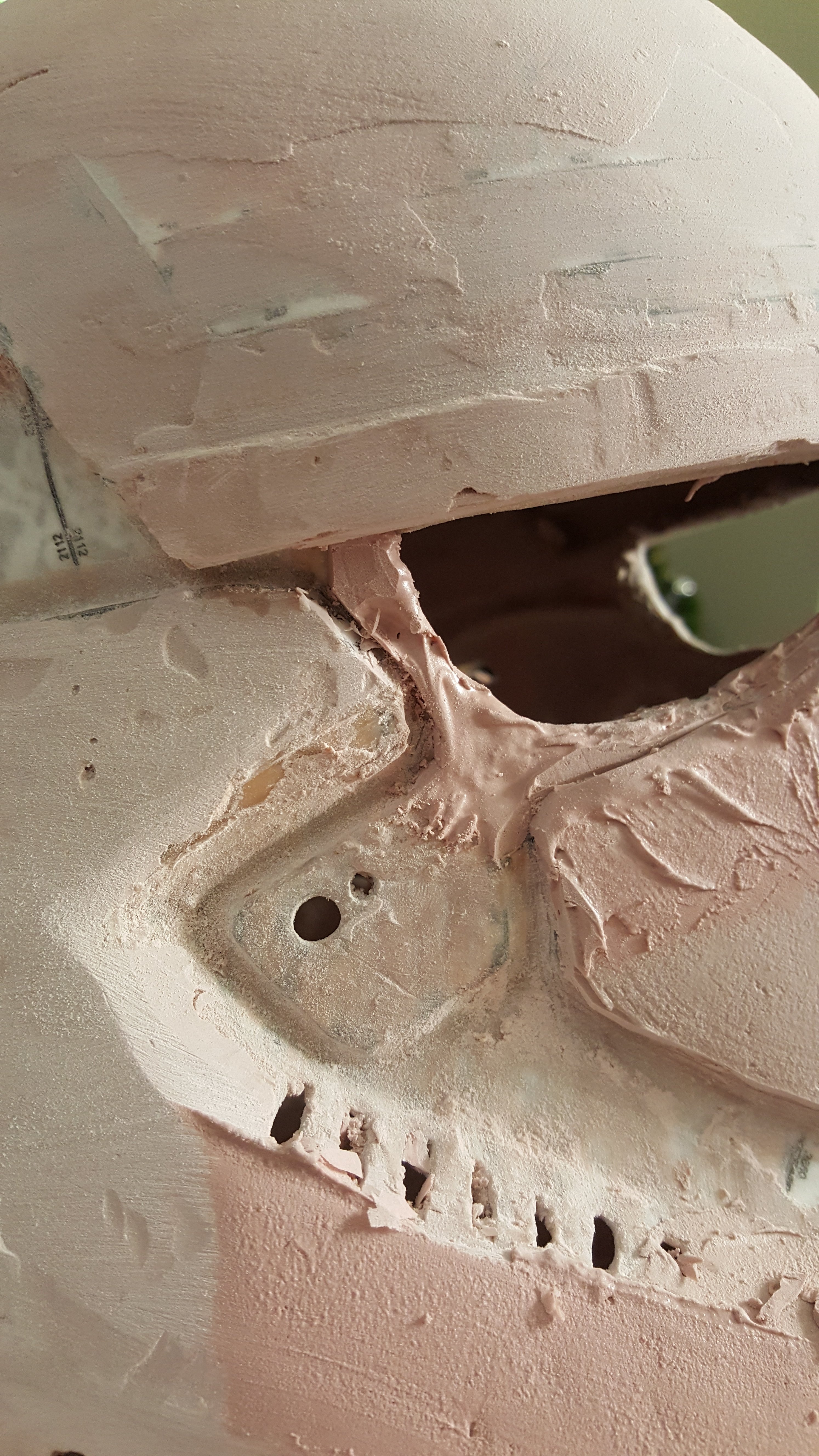

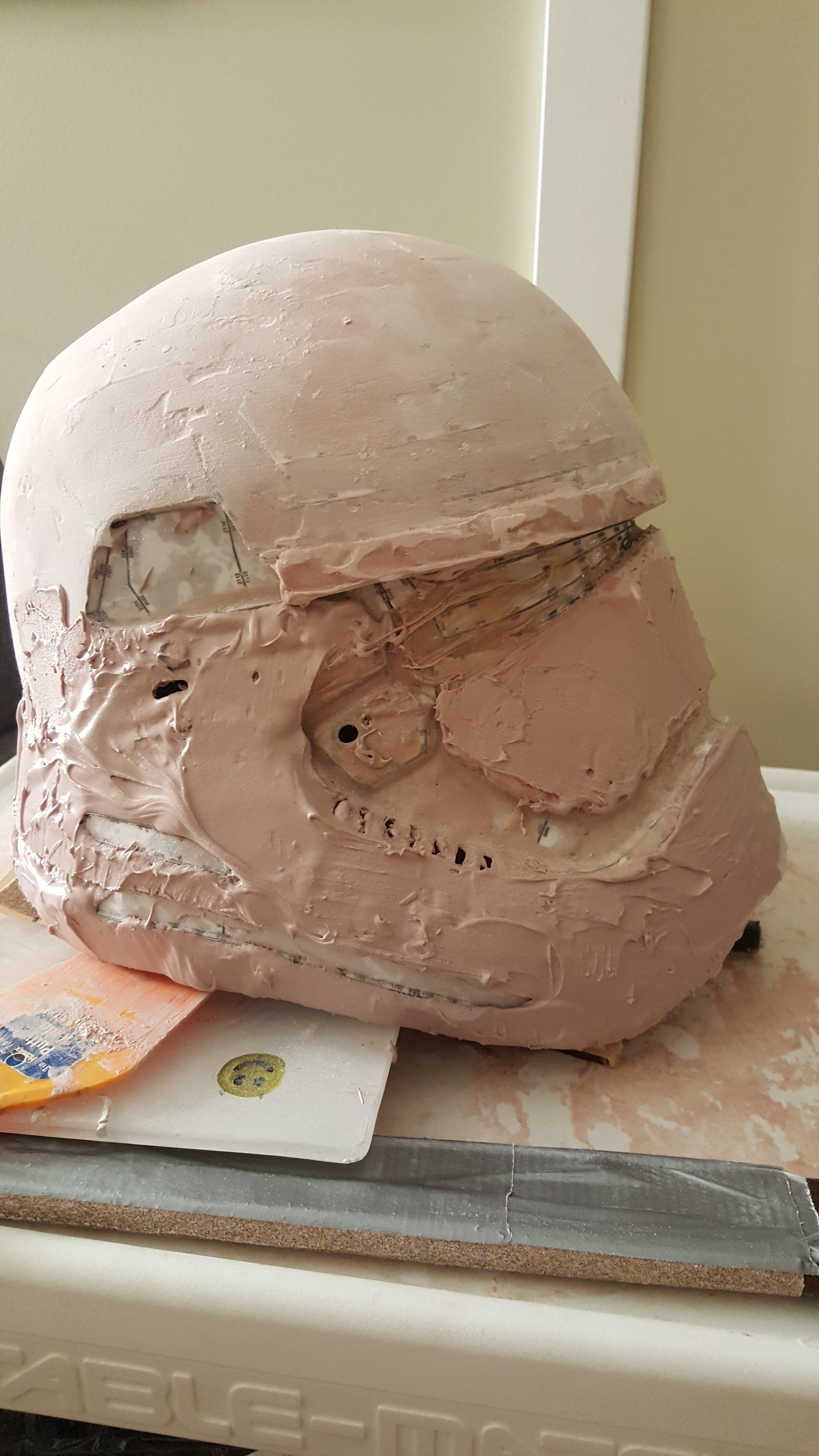

just put in my couple hours before the misses came home. one piece that every pep file is missing is this raised part around the eye as seen in the ref picture below. so started filling and sanding that down.

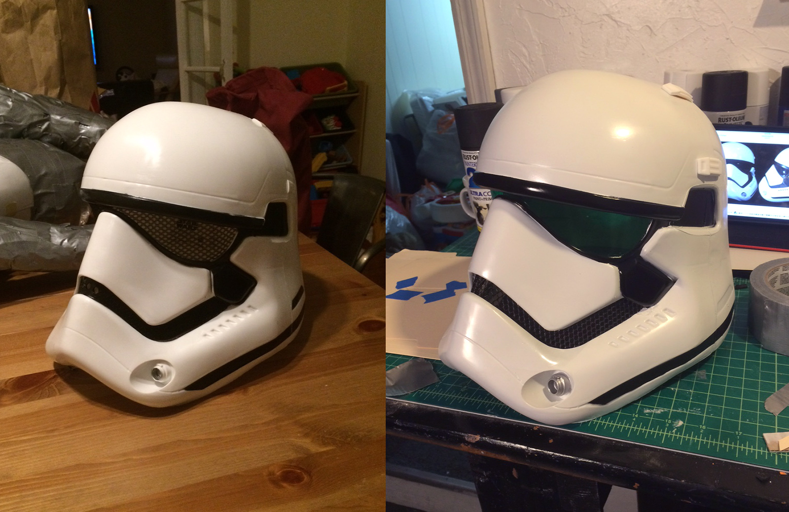

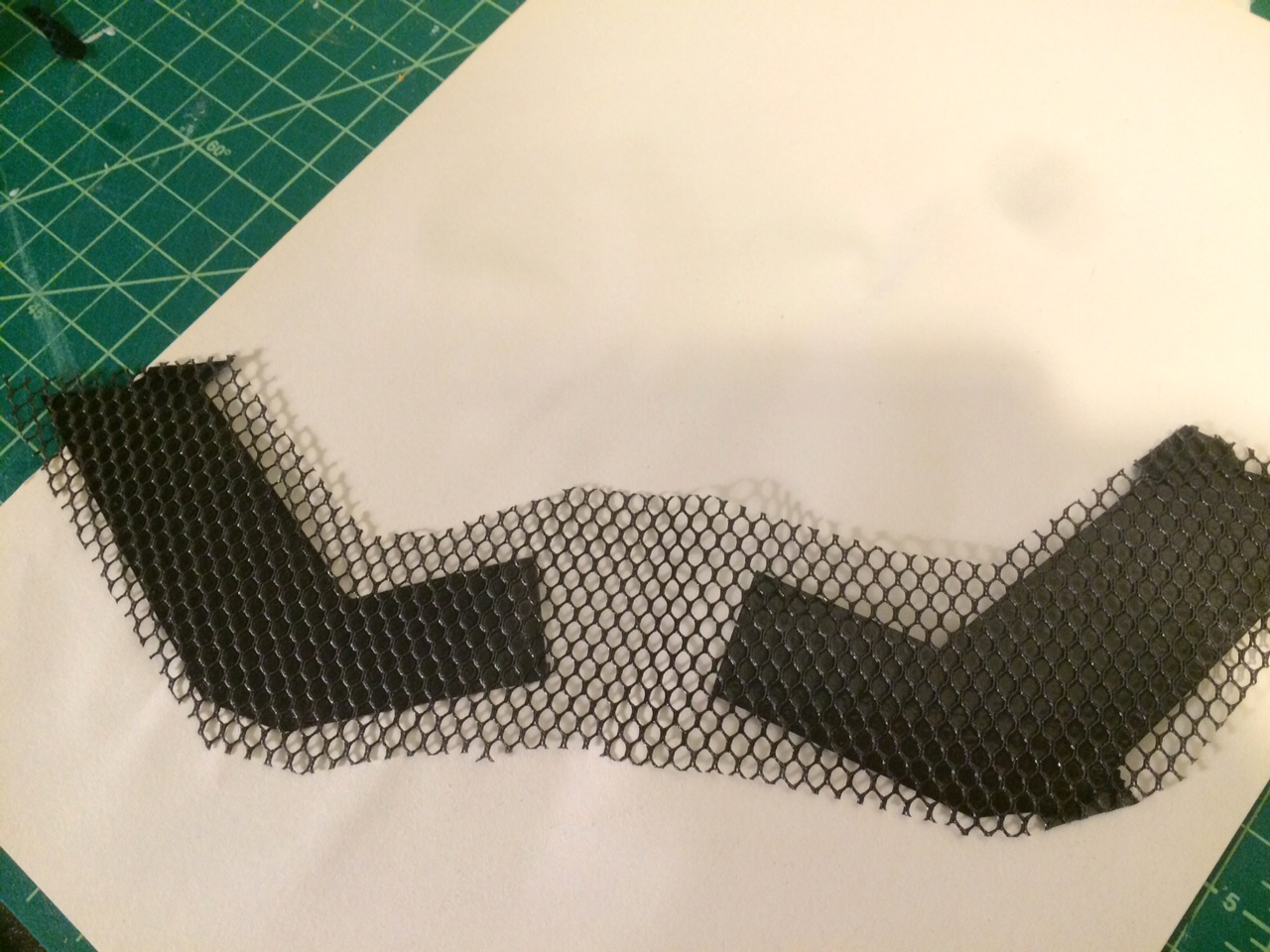

Fwiw when I was modding the crappy Rubies FO helm for my son I also spent hours scouting round Home Depot etc for a hexagonal mesh for the mouth but found nothing. I ended up gluing a hexagonal mesh laundry bag onto card and painting it. Pretty crude but honestly it turned out surprisingly well I thought.
Pic here:http://www.therpf.com/attachment.php?attachmentid=547943&d=1446183150
and on the helm at right here: http://www.therpf.com/attachment.php?attachmentid=547942&d=1446183115
When I was first reading this I didn't think there was any way this could look good, but it actually looks like it could be one of the better options. Thanks man. Looks good

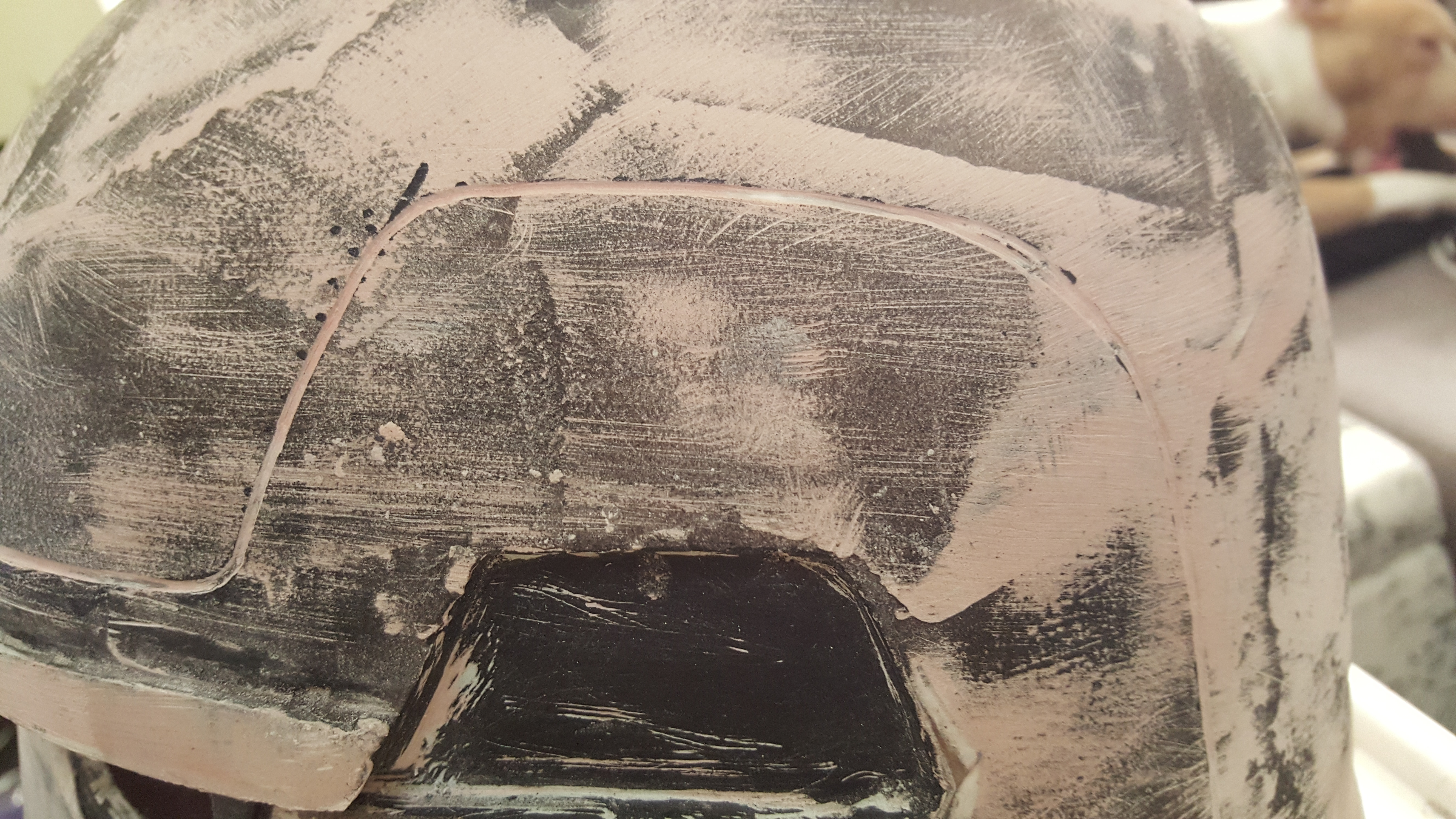

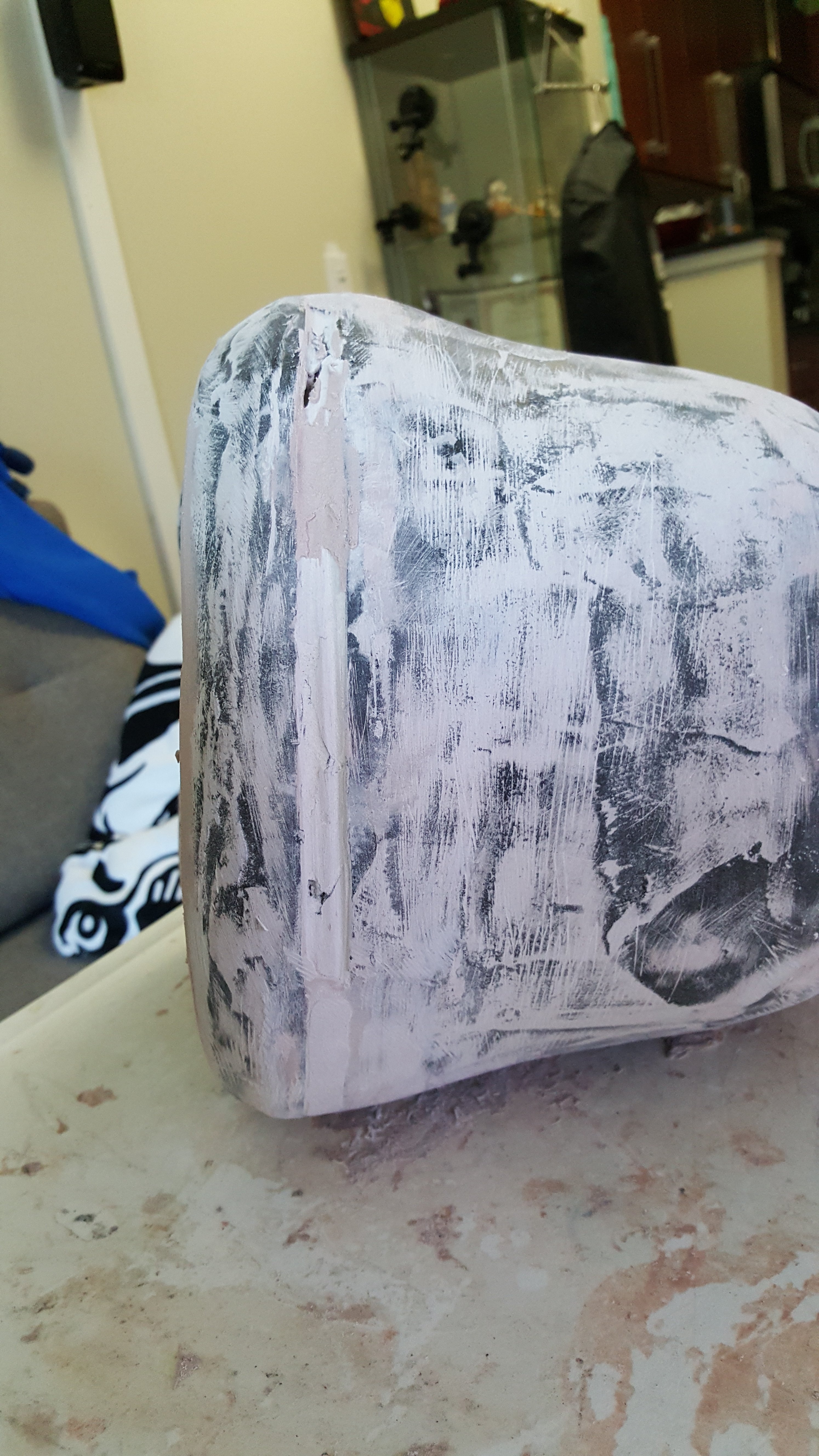

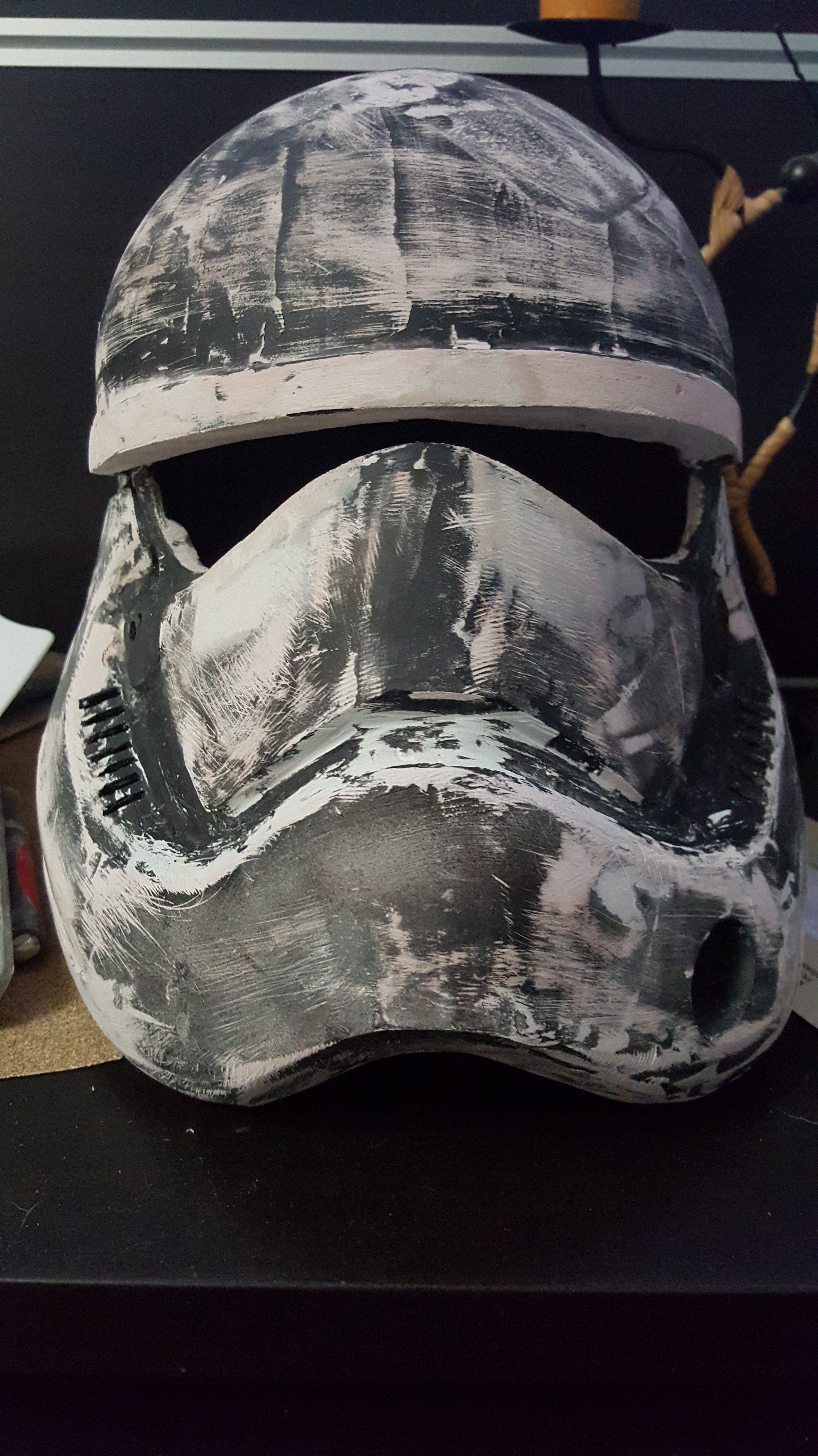

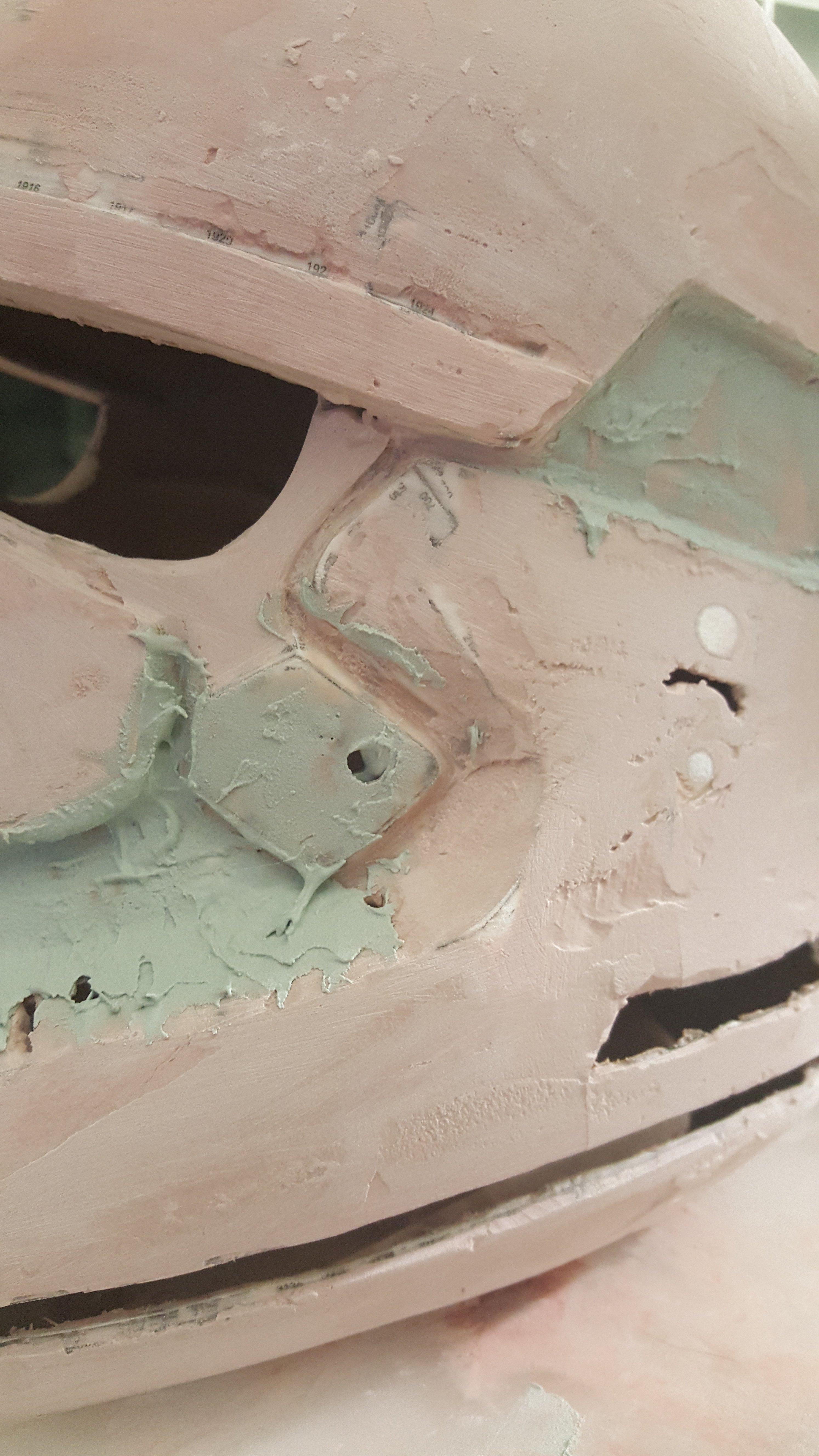

so i did manage to get a little bit more work done over the weekend. because the black strip (is there a technical name for that?) was all messed up during the pep build i had cut it all out while i was doing the bondo work, not really the best idea but i was committed. to fix this i had to pile in as much bondo as i could and slowly sand away. because the gap had now finished it came out very uneven and messy. but it was a start.
i then cut up one of the bondo spreaders to the correct size, filled the entire gap with bondo and used my new magical spreader to make a perfect gap with nice sharp edges.

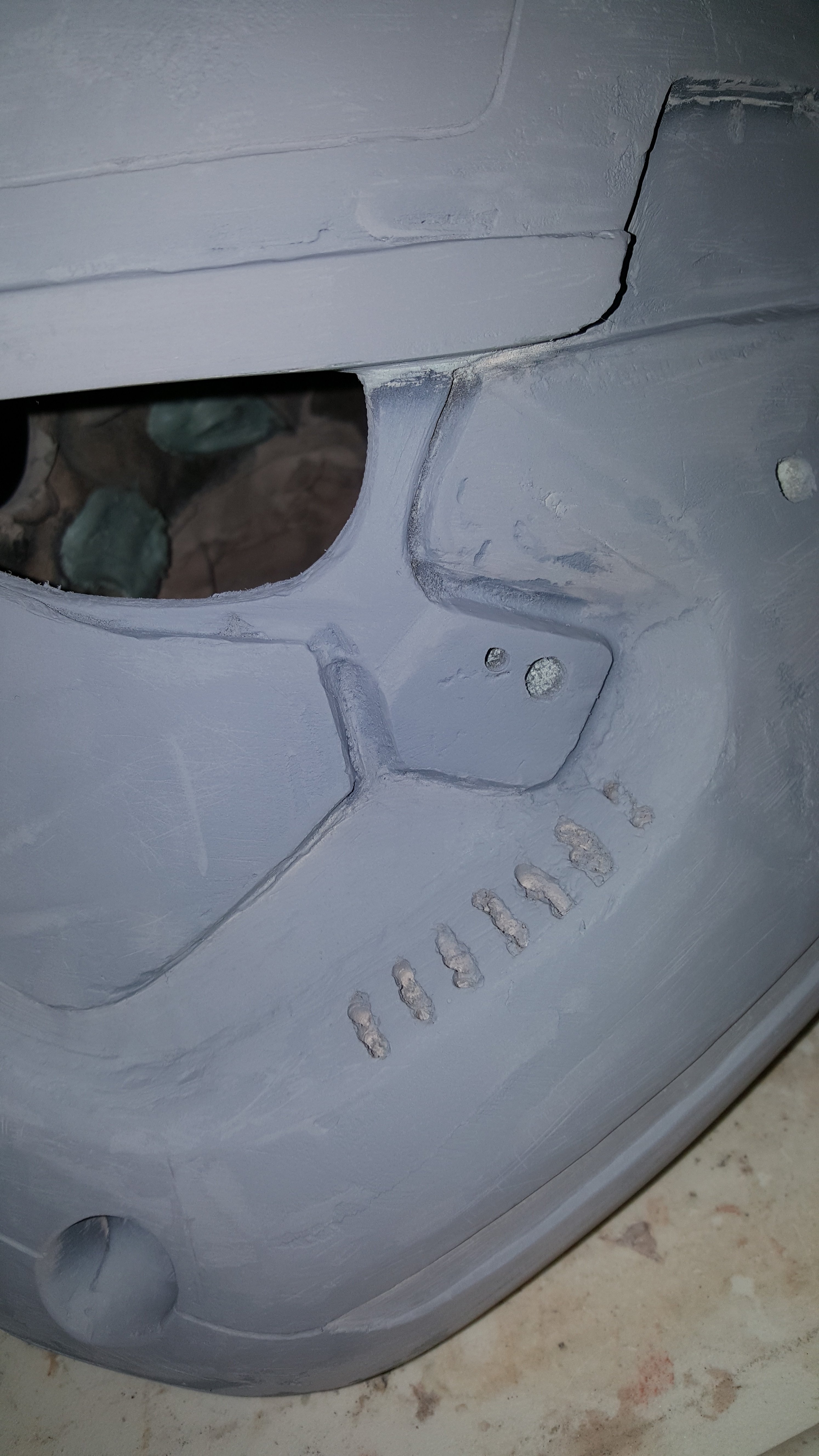

After i was finished with that, it was time to move onto the grooved line around the entire thing. because this was something i actually look out of the pep build because it was nothing but a pain in the ***** this was another part that i had to free hand. so with a couple good reference pics i went to work
i used a clear ruler which aloud me to make all the turns as even as similar as possible. I only thought of using the ruler once i realized how off one of the corners looked.
once i has all that matched up an good to go i through some more bondo on to fix the couple spots that i really messed up

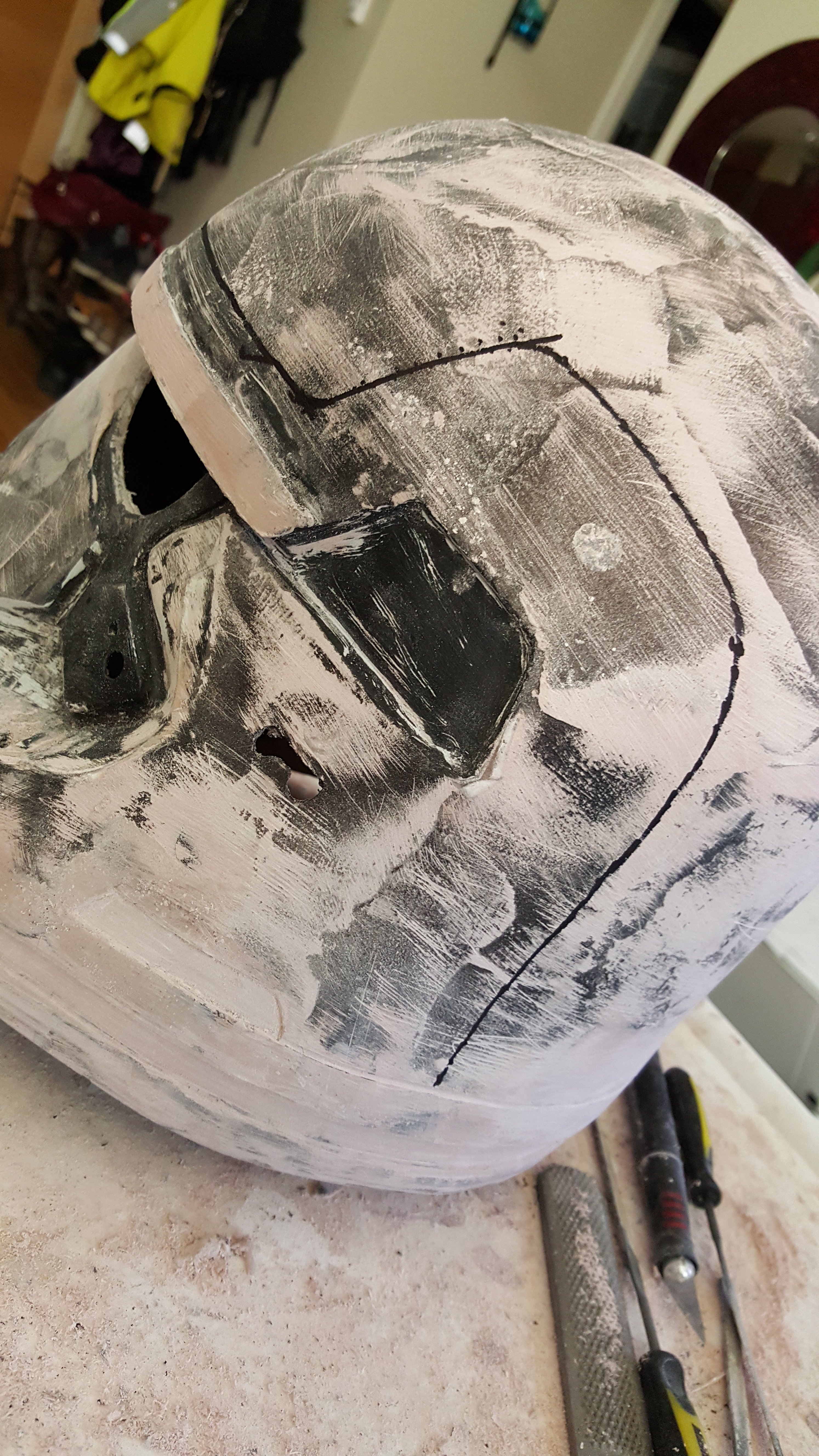

20160117_162422 (1).jpg20160117_172258.jpg20160117_172338.jpg20160117_172358.jpg20160119_183631.jpg
after a quick 100 grit sand down i decided to throw some primer on and see where i was at for missing spots. turns out i have still missed quite a bit
BUT! everyday is one step closer. even though the closer i get to finishing the less progress i seem to be making. its all in the details now
