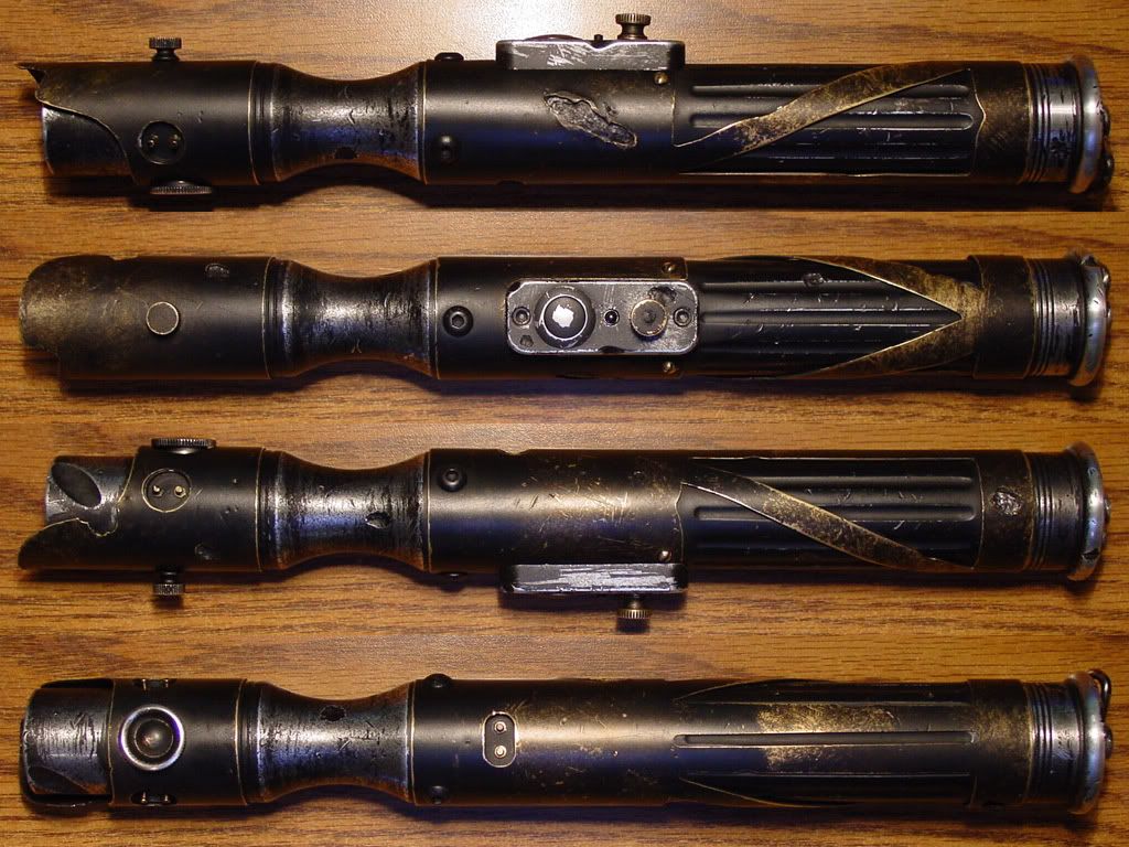

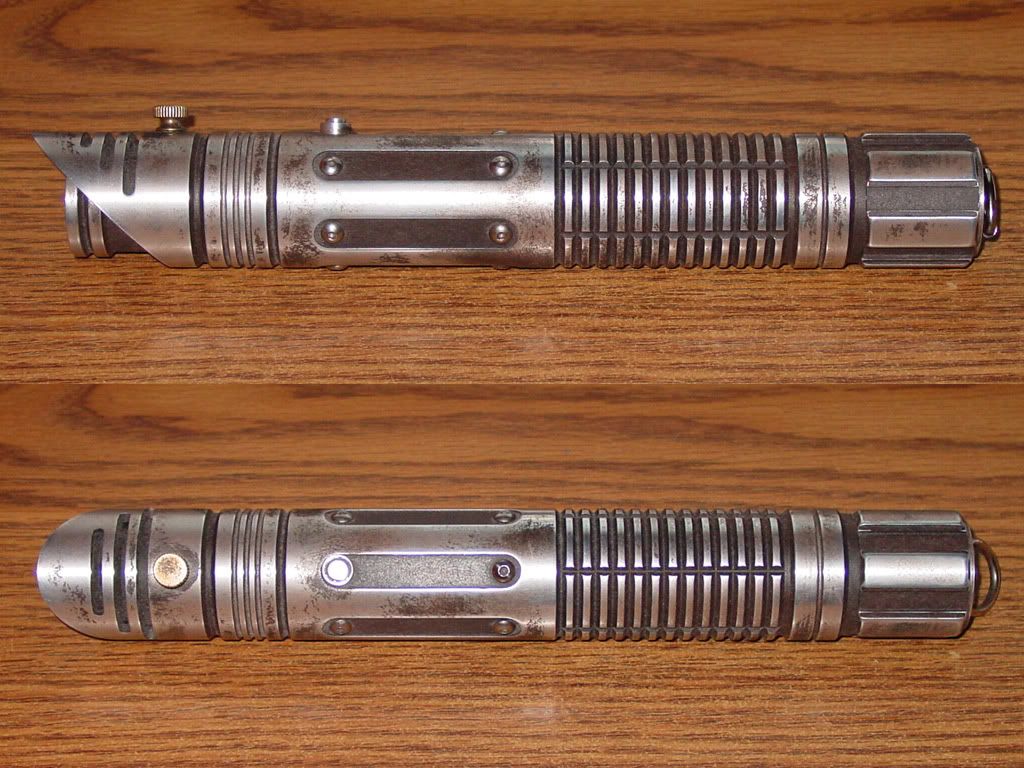

I have weathered a few sabers using spray paint and rags. Usually I use flat black but for adding a rust look, I'll alternate the black paint with coats of some dark brown or reddish brown spray paint. Basically you spray the paint on, wait 5 to 10 seconds and then wipe it off with a rag. On a tubular shape like a saber, I'll put the rag on it, clasp my hand around the rag and apply pressure so I'm, now gripping the saber normally, then I'll twist my hand around the hilt.
Even when using the same color and shine/dull level of paint, the name brand of the spray paint will make a difference as to how the weathering will look. The texture of the rag used will also make a difference so some experimentation on scrap pieces is recommended. Here's some pics of sabers I have weathered. I used different techniques on some of them to achieve different looks. On that last one, I did not wipe the paint off. I just sanded it a little as well as all the edges for a "well maintained but has some age to it" look.
Before:
Saber24-Unweathered-01.jpg~original
After:
Saber24-01.jpg~original
Vindicator_Remodel-01.jpg~original

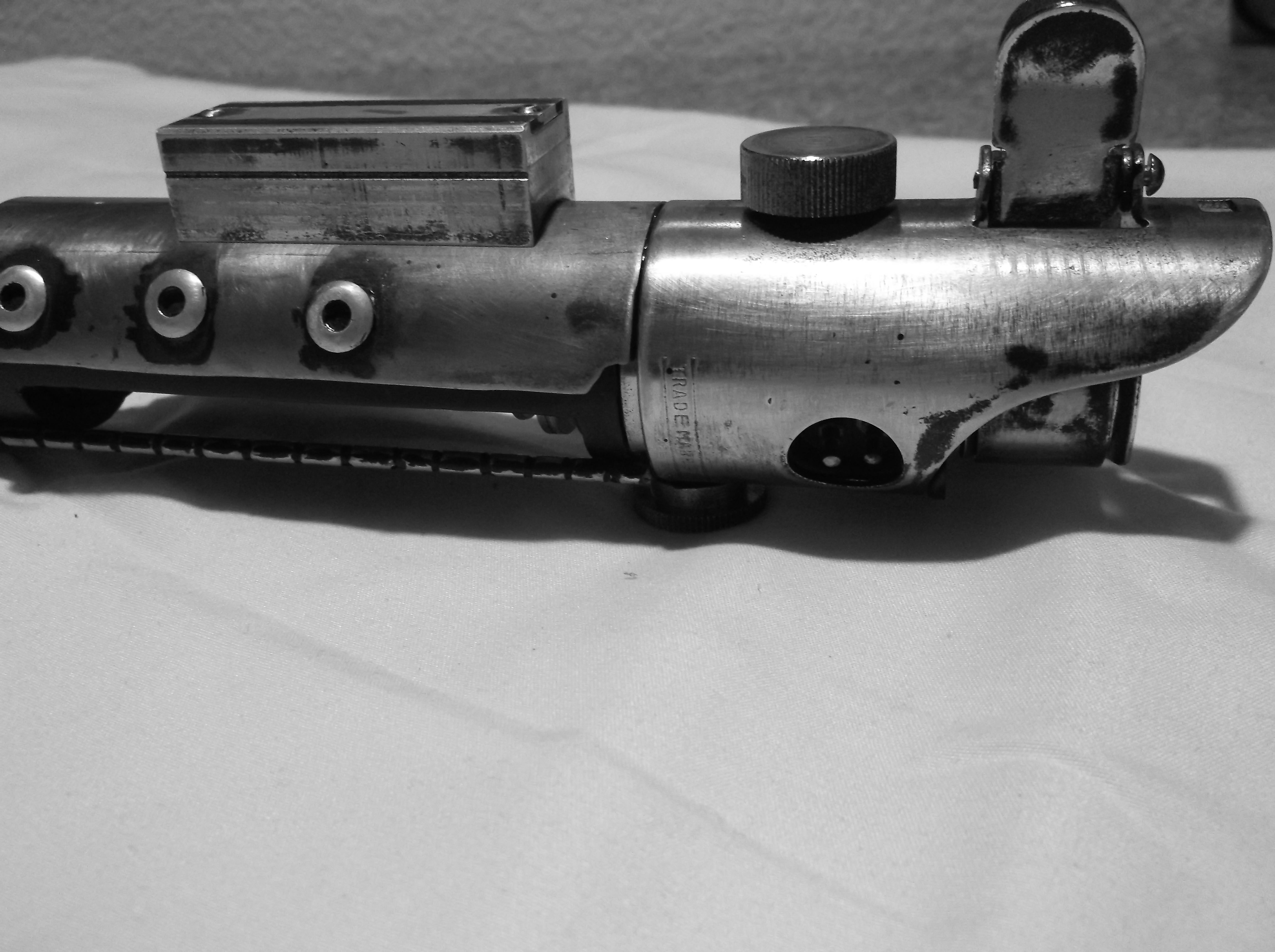

ARKM, how do you do those holes and dents int he aluminum? Those marks really make the difference.
Thanks. For most of the really weathered saber, I used an arc welder (stick welder) on the brass shroud which melted through it to make the holes and used a rotary tool with a ball shaped bit that is probably for engraving, to do the aluminum seen through the holes in the brass. Regular looking dents and dings were from me striking the saber against 90 degree metal edges (such as parts of the vise on my mill).

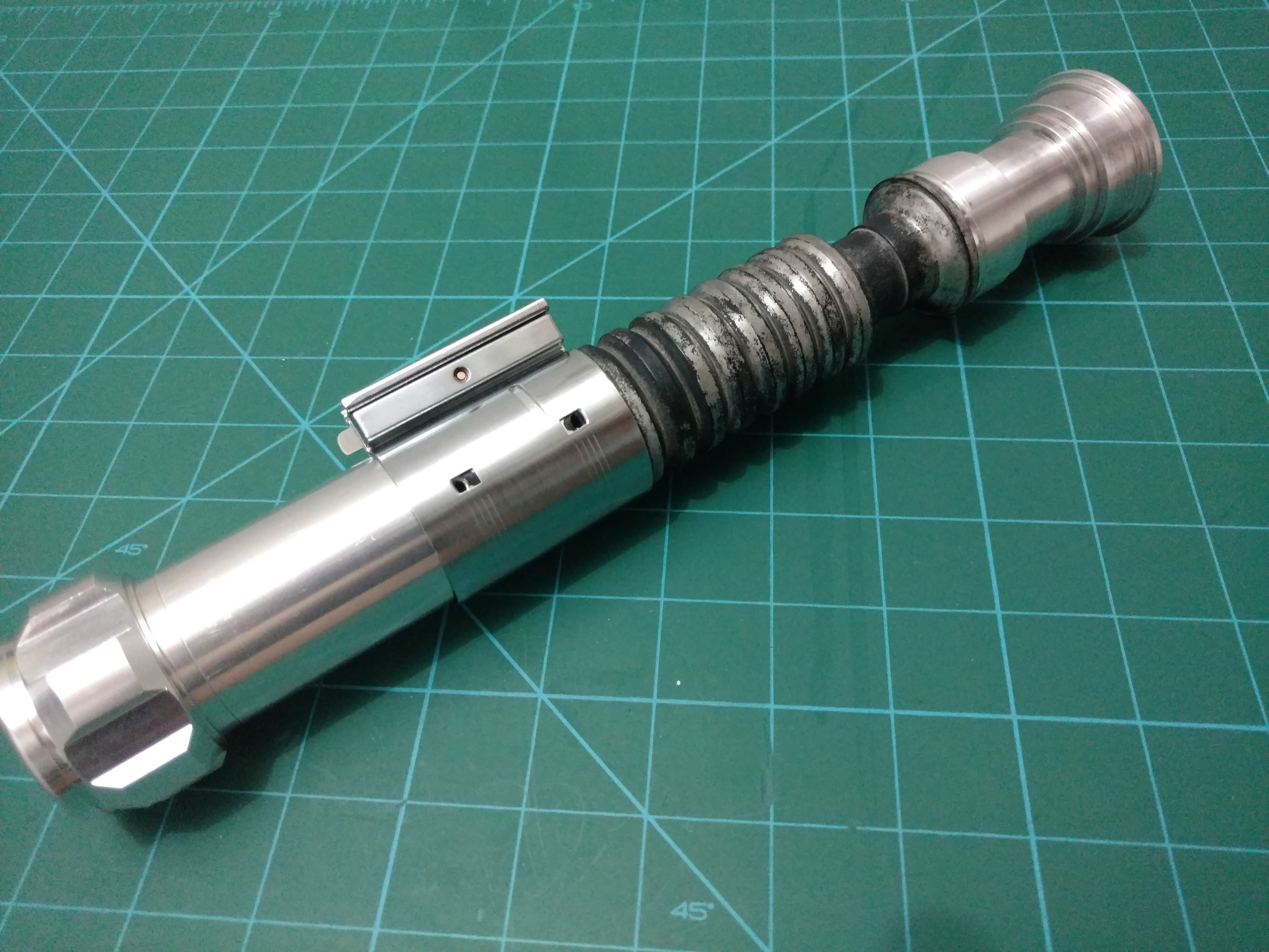

This is my first attempt in weathering my hilt.
I tried to use Birchwood Casey Aluminium Black to give a black coat to the grenade, but it keeps getting off. Just a gentle touch and my hand is all dirt with a very fine black powder. Not what I was looking for, but I liked the way it "grayed" the aluminum. I think I'll give a generous pass in all pieces and rub the black of just for the gray look.
The grenade i'll probably have to pray with a matte black of some sort. Still trying out some options before painting.
Ah! And I used a wire brush to give some texture to the aluminum before oxidizing it...
Anyway. It took me some time to start working on the hilt, but there it is. It's still missing all of the electronics inside, but I very please with how it looks.
Thanks everyone for the tips. I´ll try to update my build more often.
