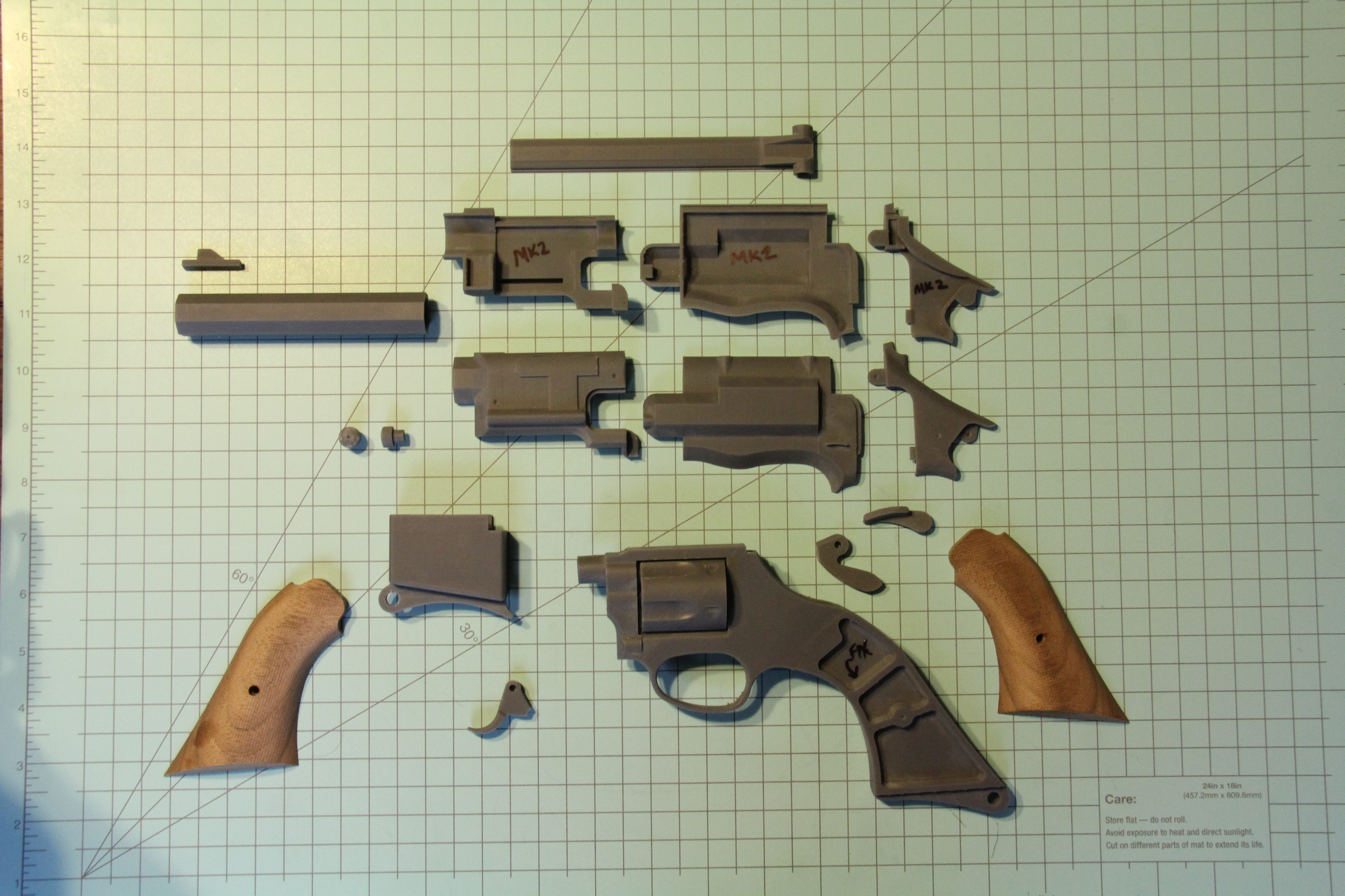

These models are the result of my long running quest to make a metal Mal pistol. I'm still plugging along with that project, but I thought some here may be interested in a resin parts kit. Here's a shot of all the components:

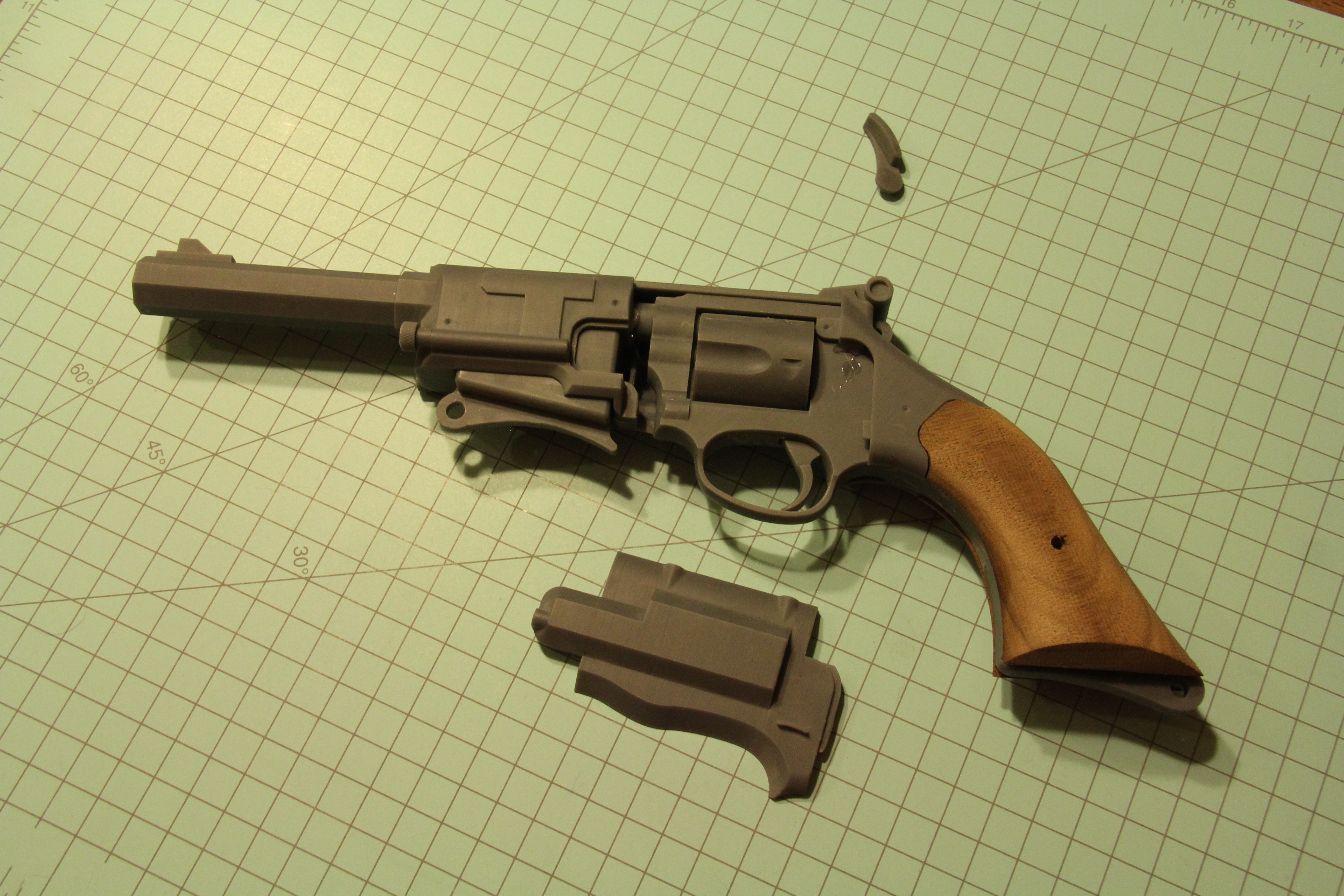

And here's a shot with the parts roughly assembled with hot glue:
They would be pressure cast in smooth-cast 300, tinted brown for the brass pieces and grey for the steel pieces. The grips would be CNC'd from walnut, as well as a brown resin option.
The trigger moves, but the hammer is fixed in place. It is a separate piece to make painting easier and weathering look more realistic.
I can include extra magazines, and plan on building up a magazine insert for display.
All parts will screw together, and I can drill and tap holes for an additional fee.
The thumbscrews will be attached to threaded rod to allow the cover to come off the same way the prop did, to reveal a mock revolver underneath. The threaded rod will come in the kit as well, along with all screws.

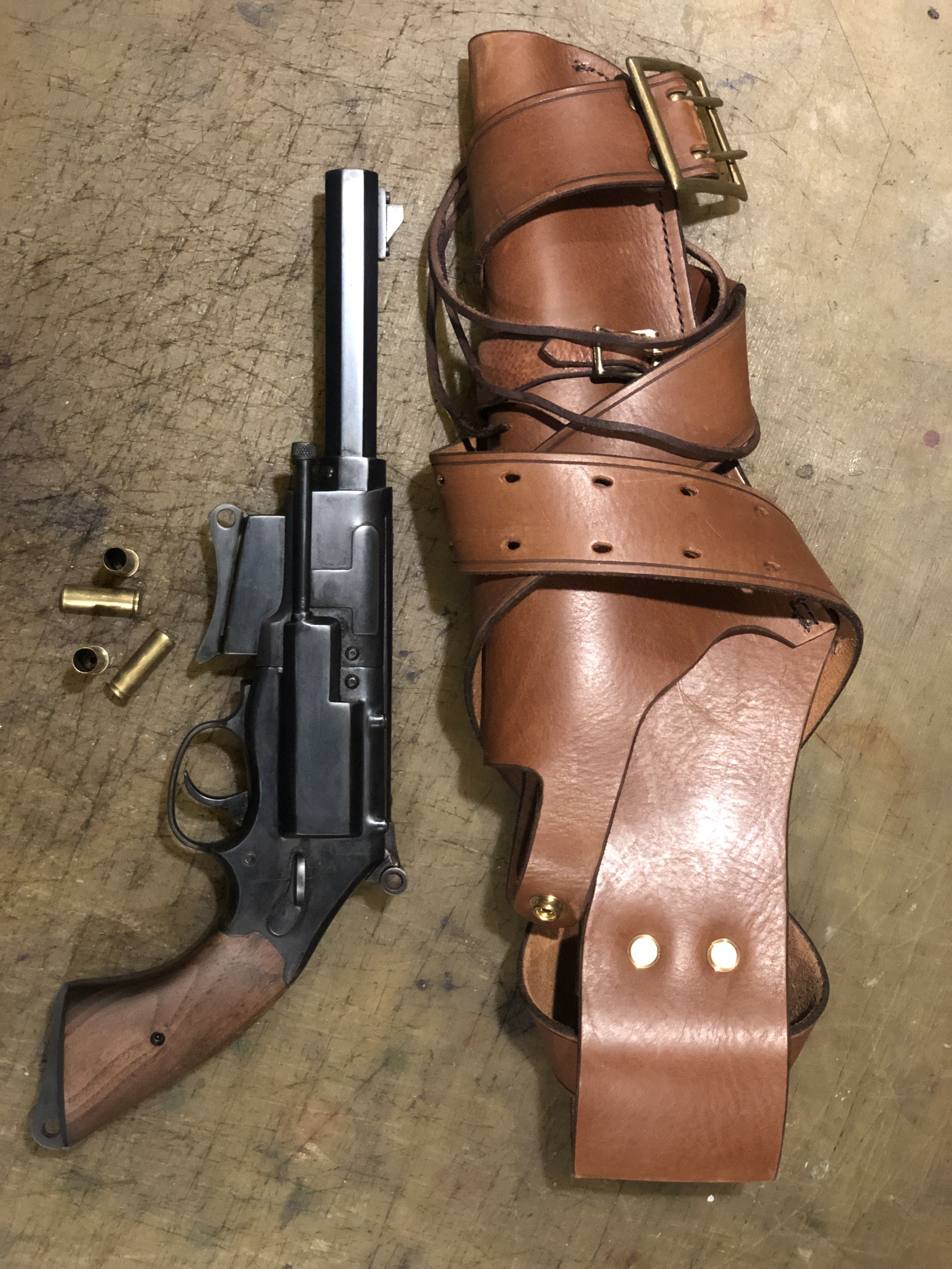

It's not a kit but I did make a live fire version...if anyone has any questions about the construction, I'd be happy to help.
