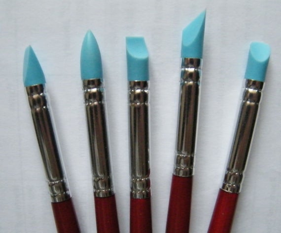

This could apply to application of spot putty too. I was thinking of trying to find those fine-sculpting tools and perhaps those silicone-tip ones I've seen before.

For everything else, I was looking at getting something like these to aid in the clean application of spot putty
