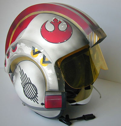

I painted mine with rattle cans and tape and then used decals for the victory logos and the circle with lines bit. Then I used dull coat over top and then a was with watered down black tempra paint
here is a pic.
