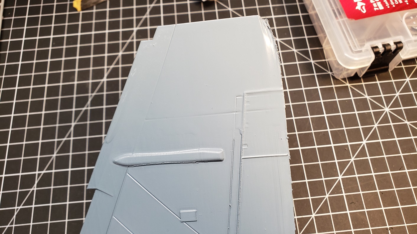

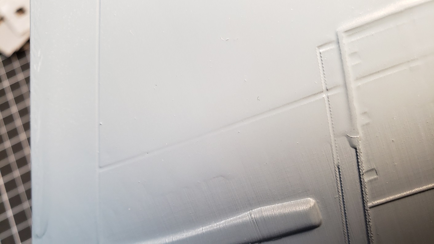

Some more examples, here the top part has been resin coated and the lower half has not. No primer was applied to either section.
Could have used a bit more cleaning before I painted it, but these parts have been sitting around for a while and I am just using them to test paint, primer, and finishing methods.
