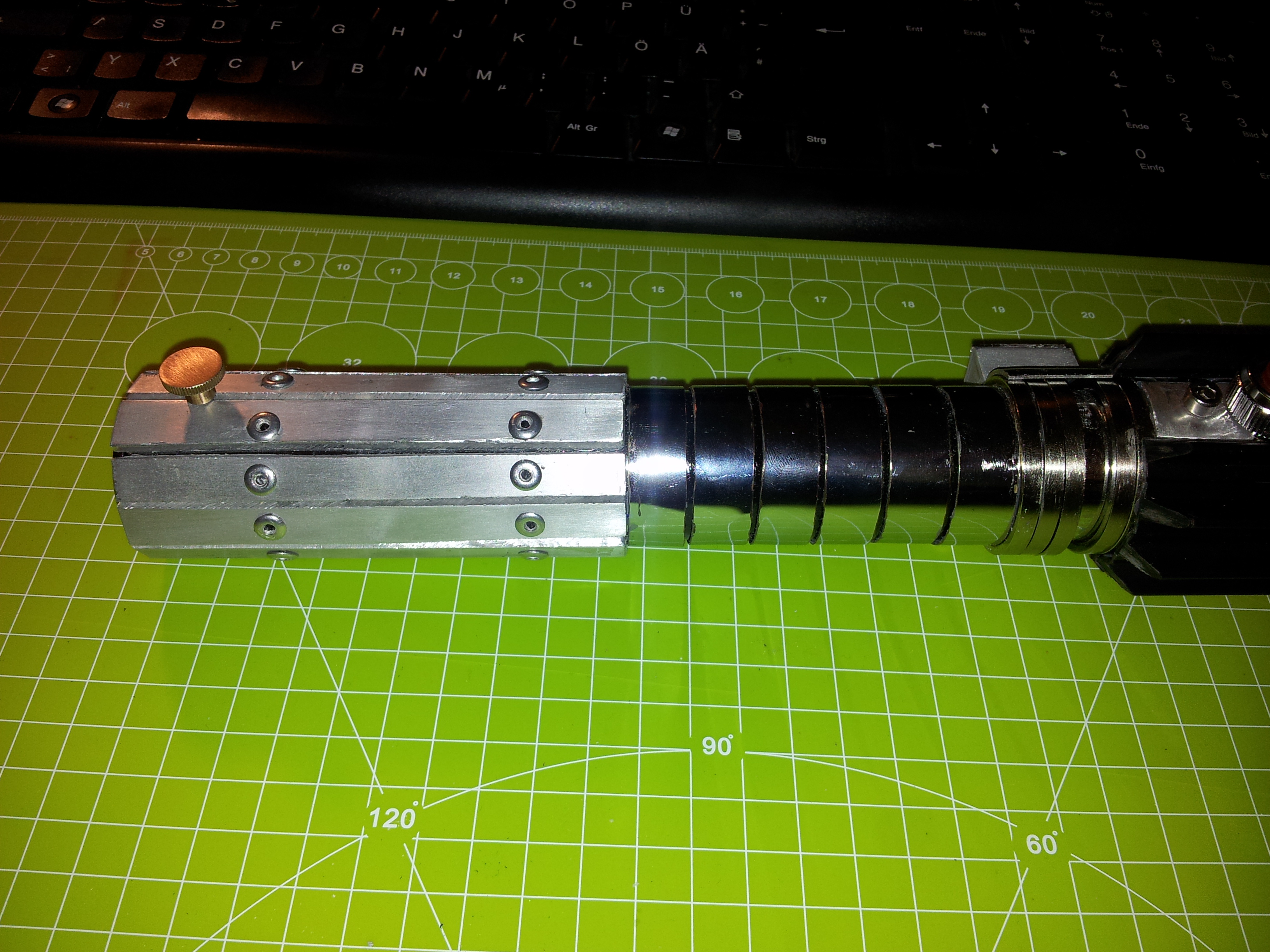

The functional purpose of the thumbscrew is to gain access to the battery compartment. You take the screw out and the pommel slides out.

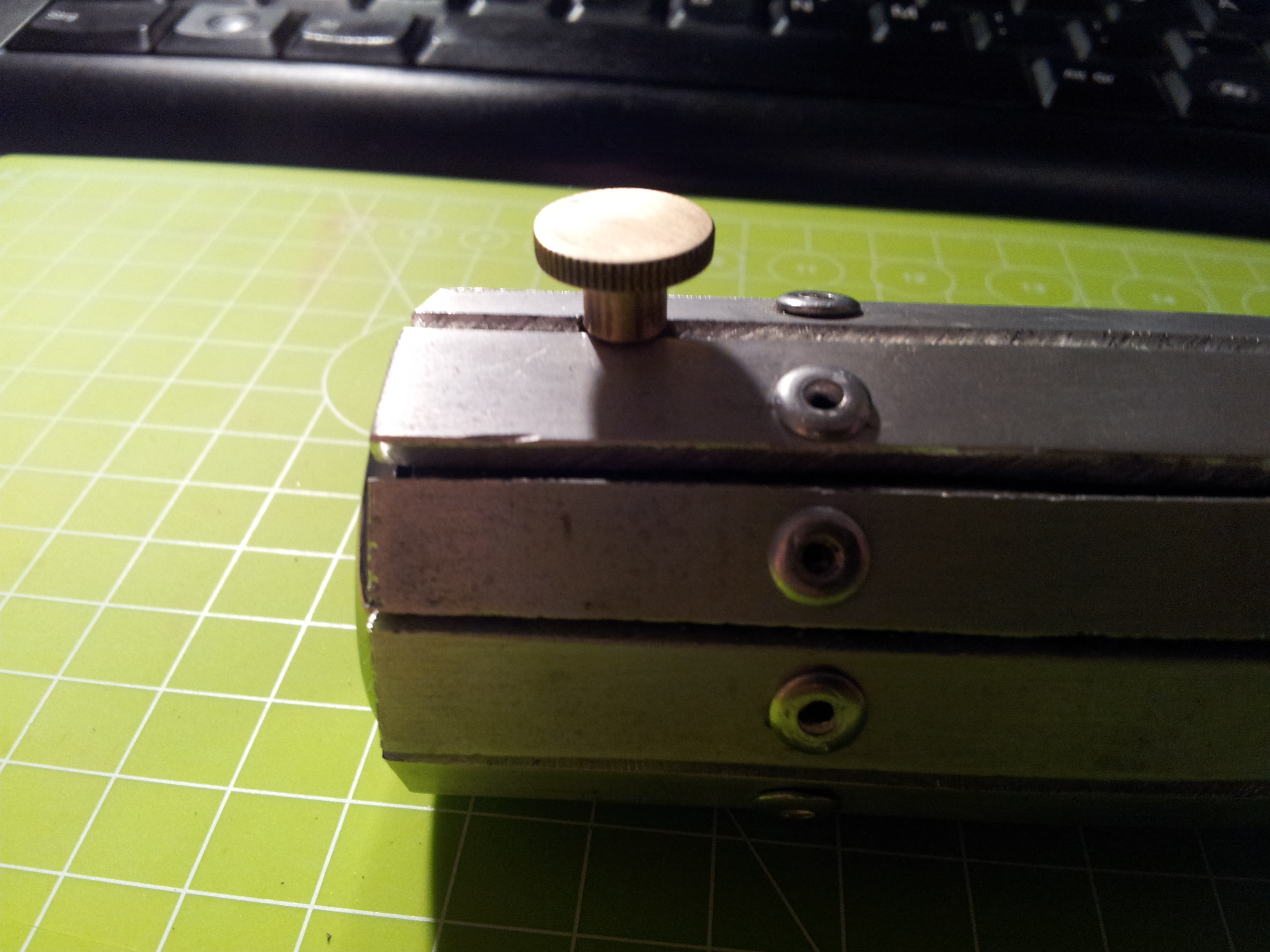

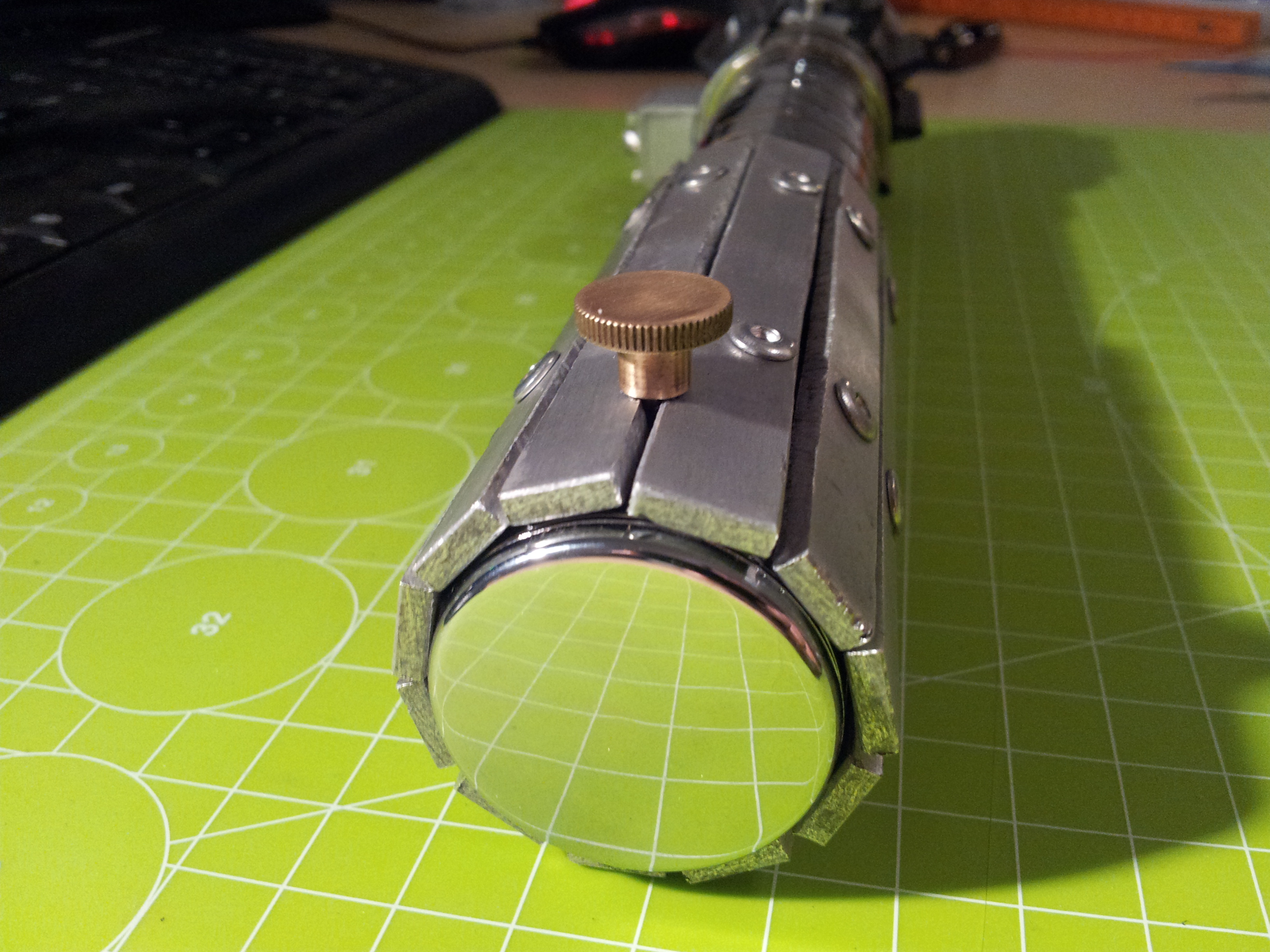

Here is what it looks now.

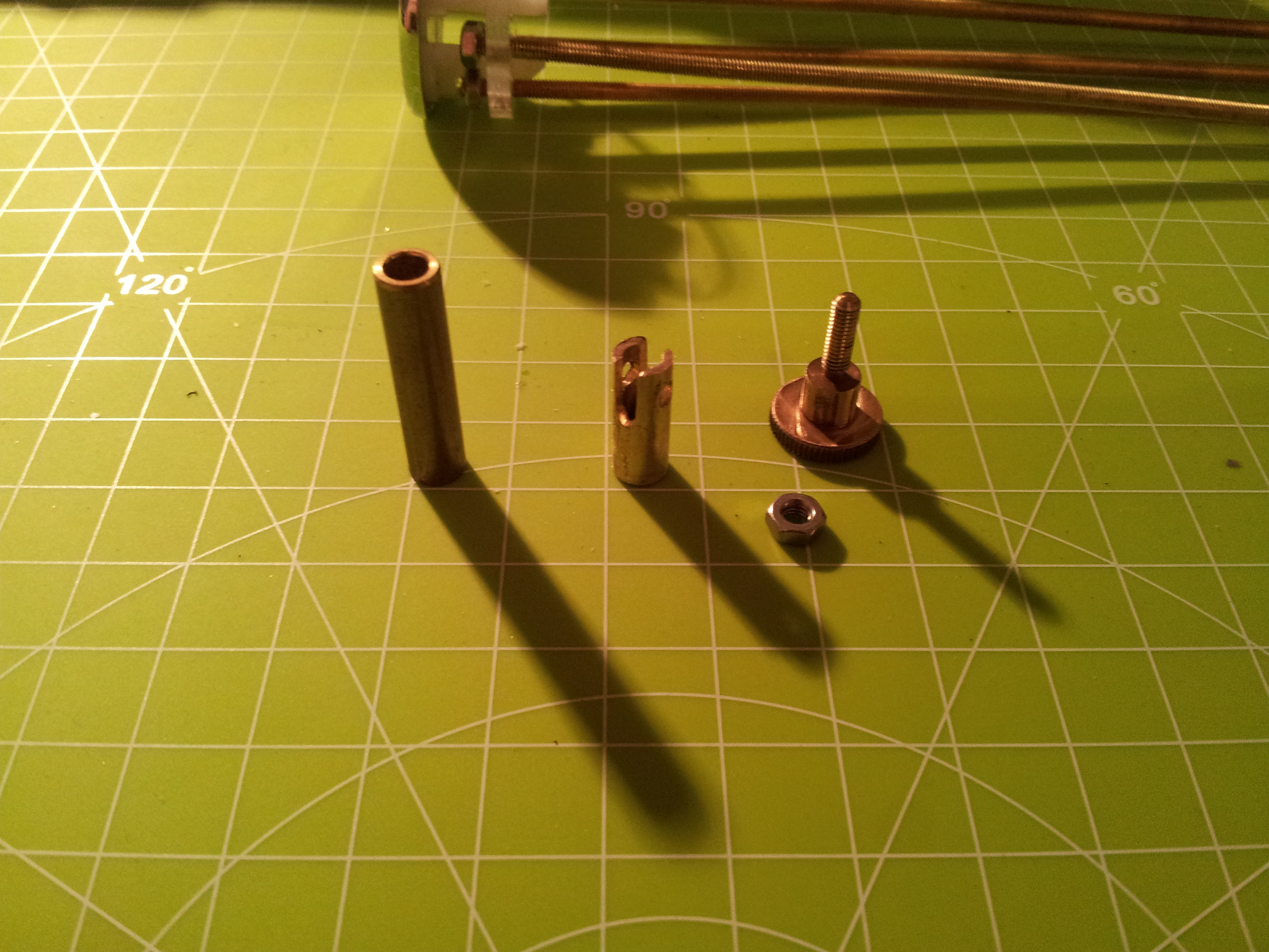

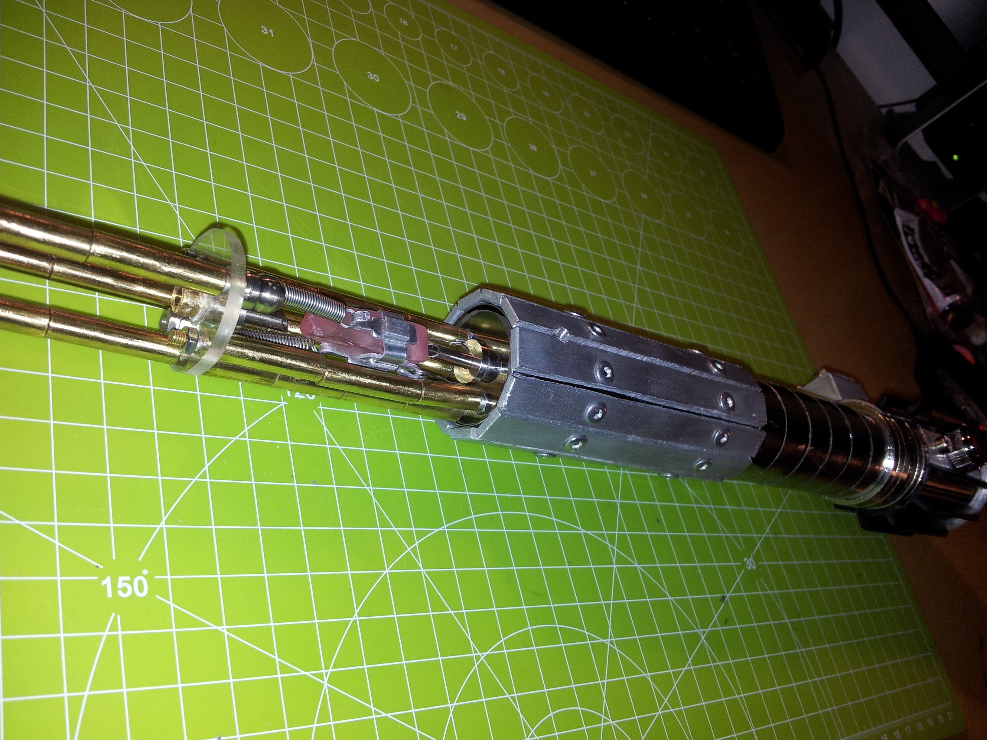

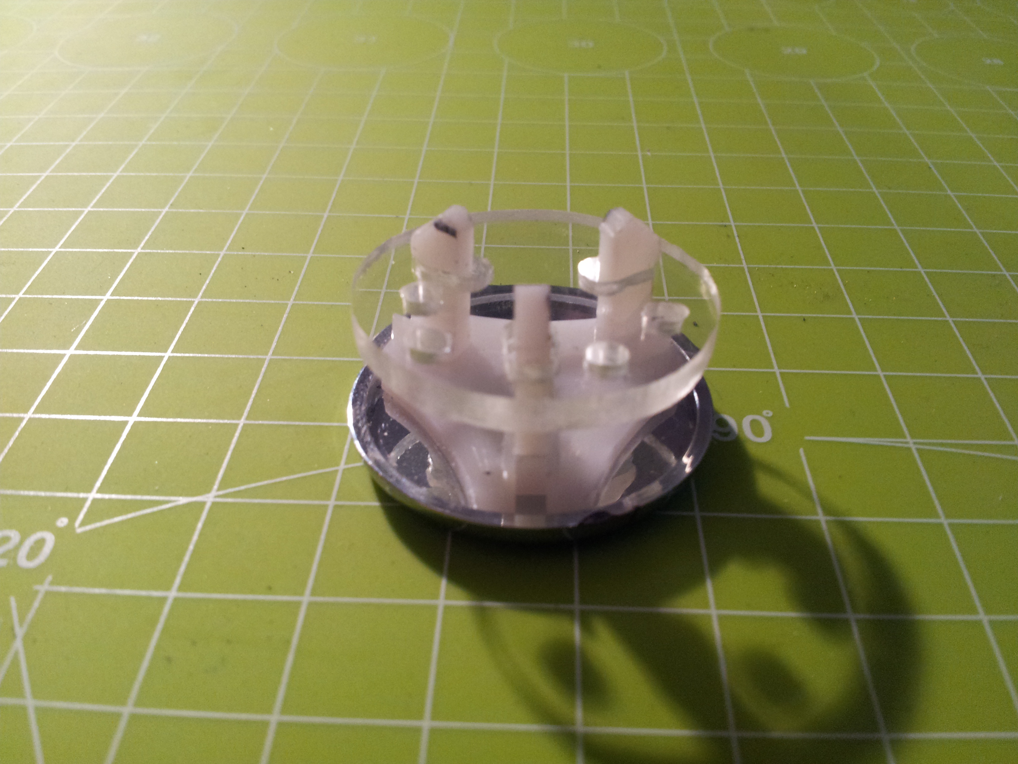

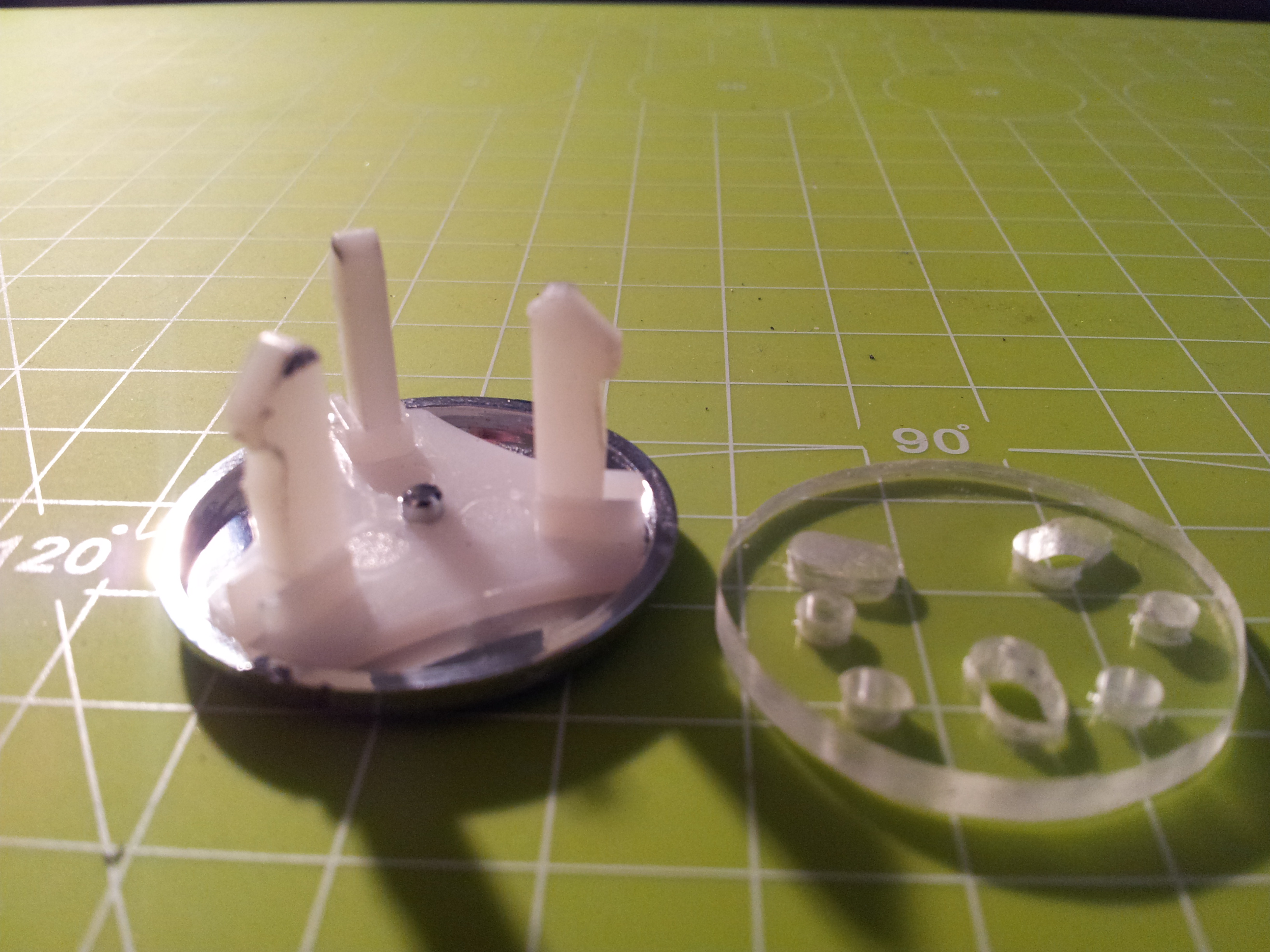

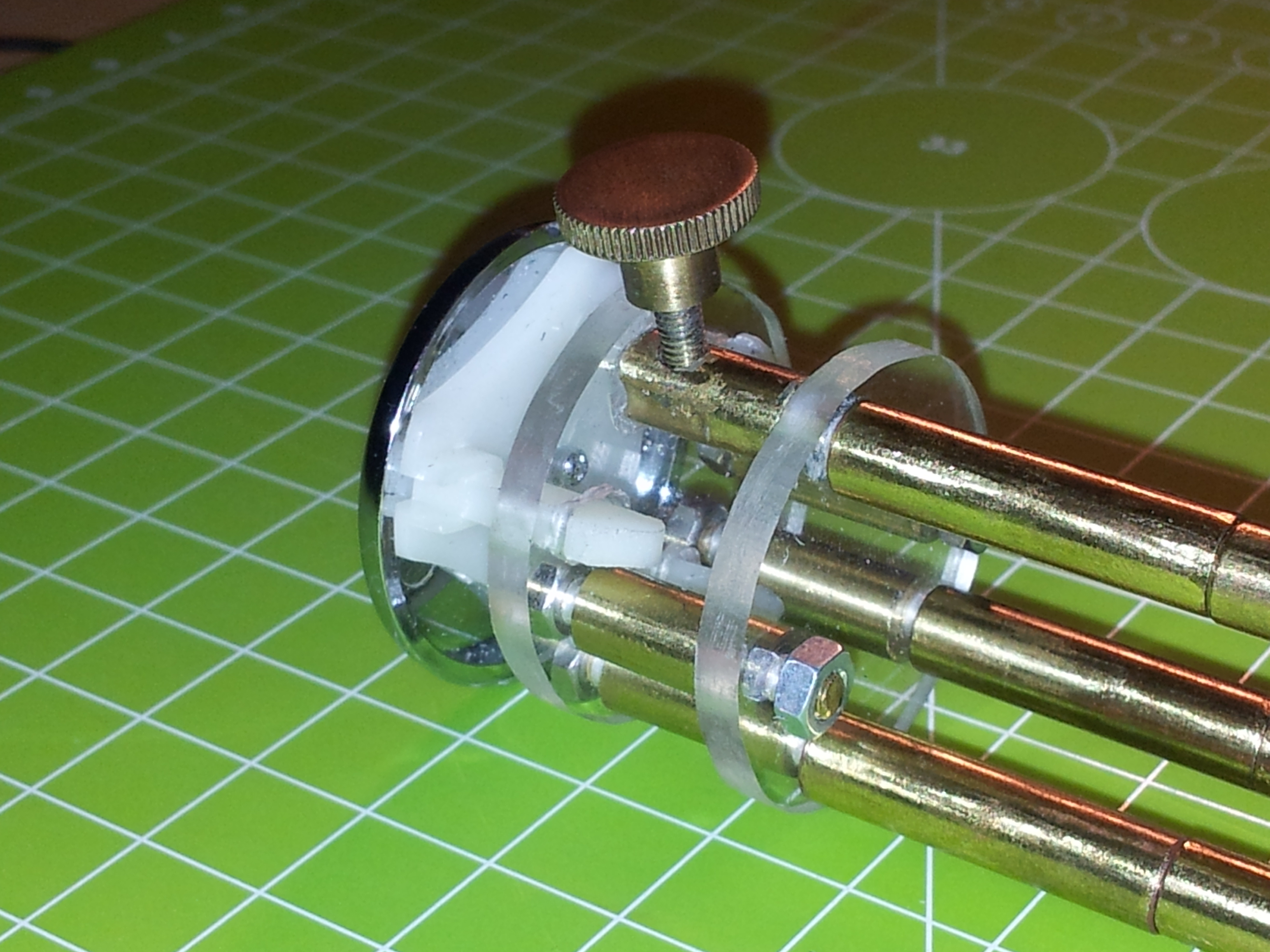

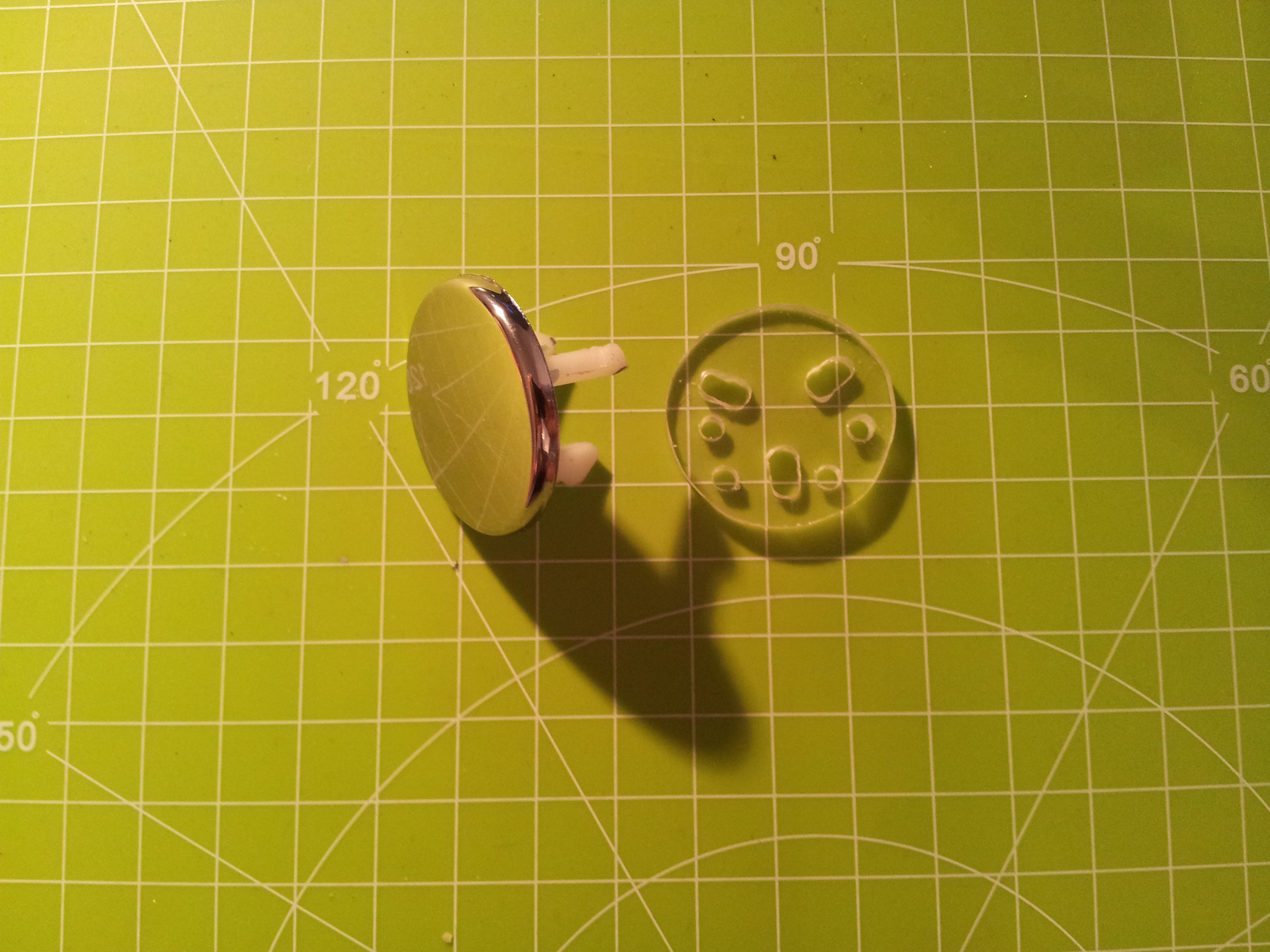

If everything turns out as I plan it will work as lock for the crystal chamber.
When I unscrew the thumbscrew the crystal chamber will slide out together with the endcap.
I fastened the endcap on a acrylic chassis disc I've cut and which is part of the crystal chamber.

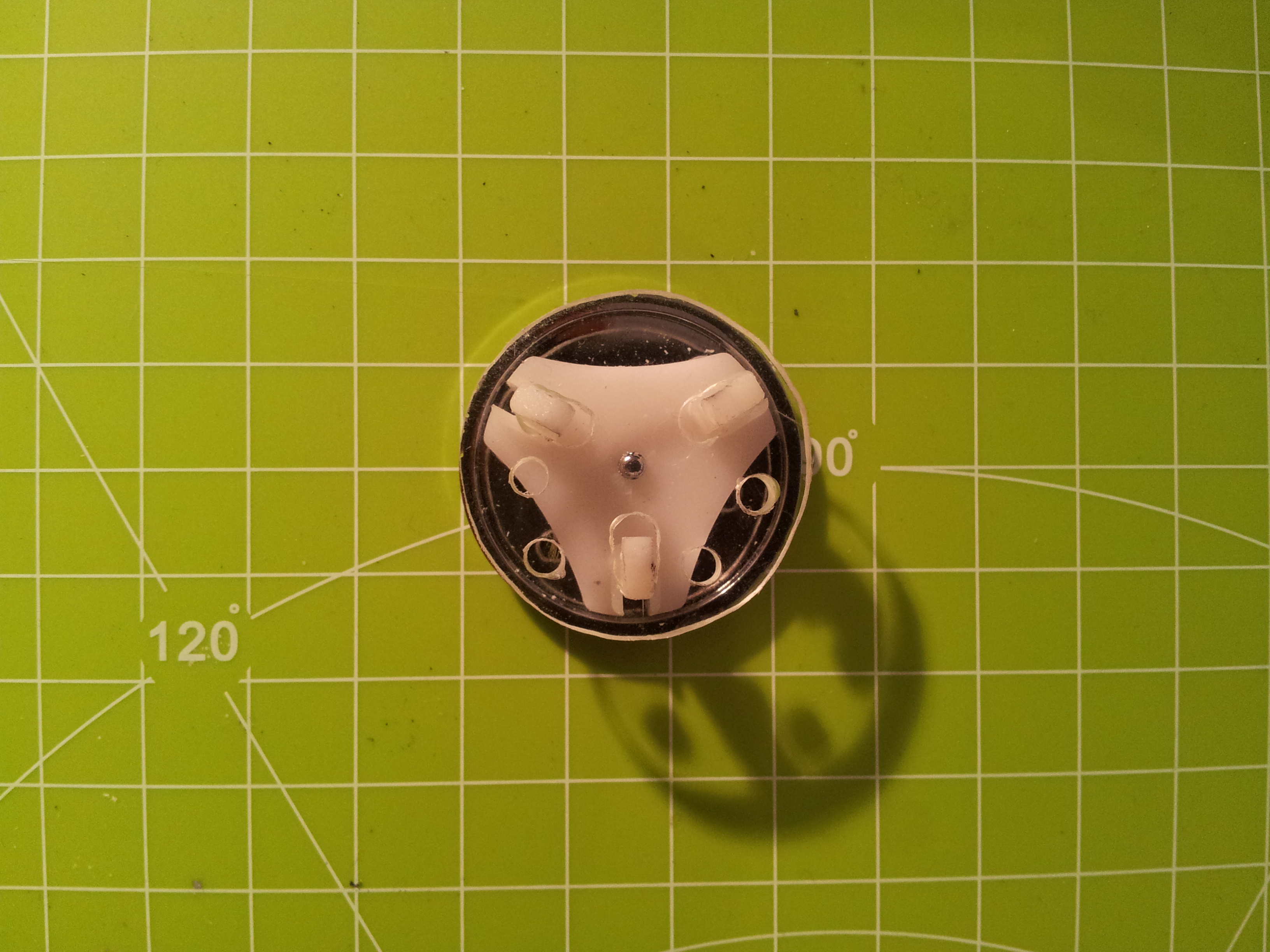

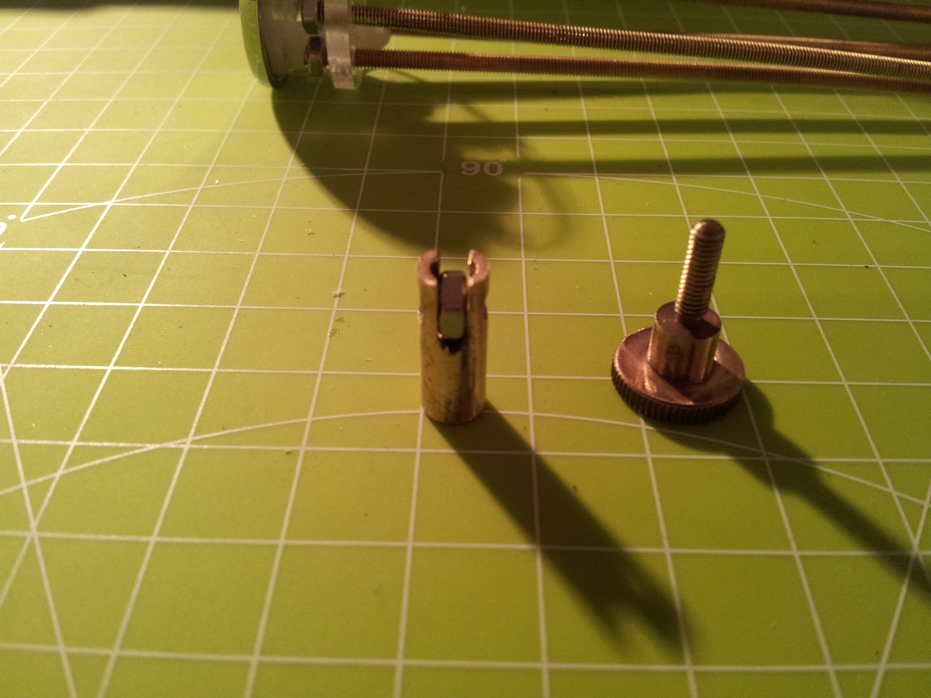

I put the screw-nut - which will hold the thumbscrew on the inside - in a brass tube and will build it in the crystal chamber.
This is what I have at the moment.

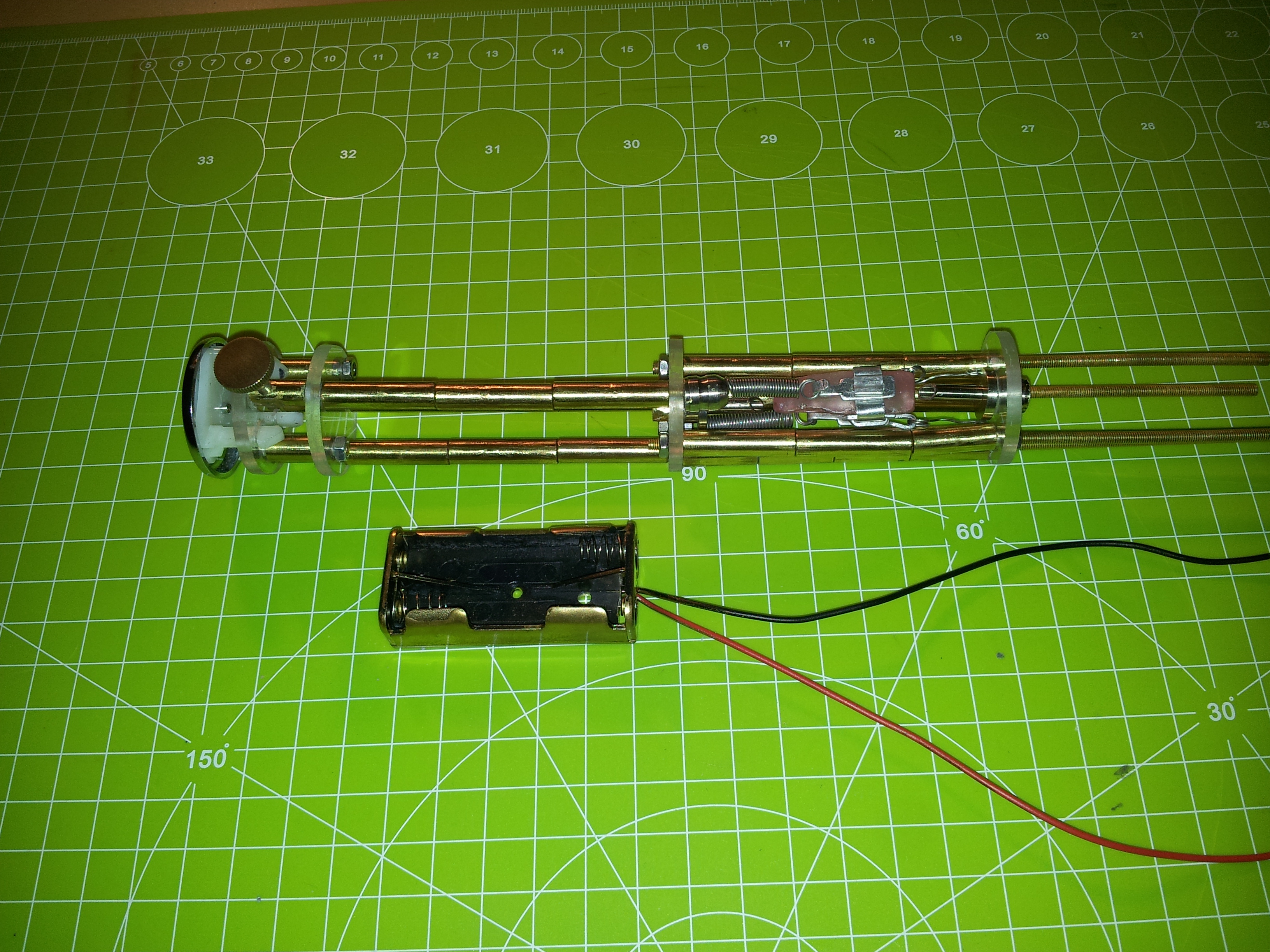

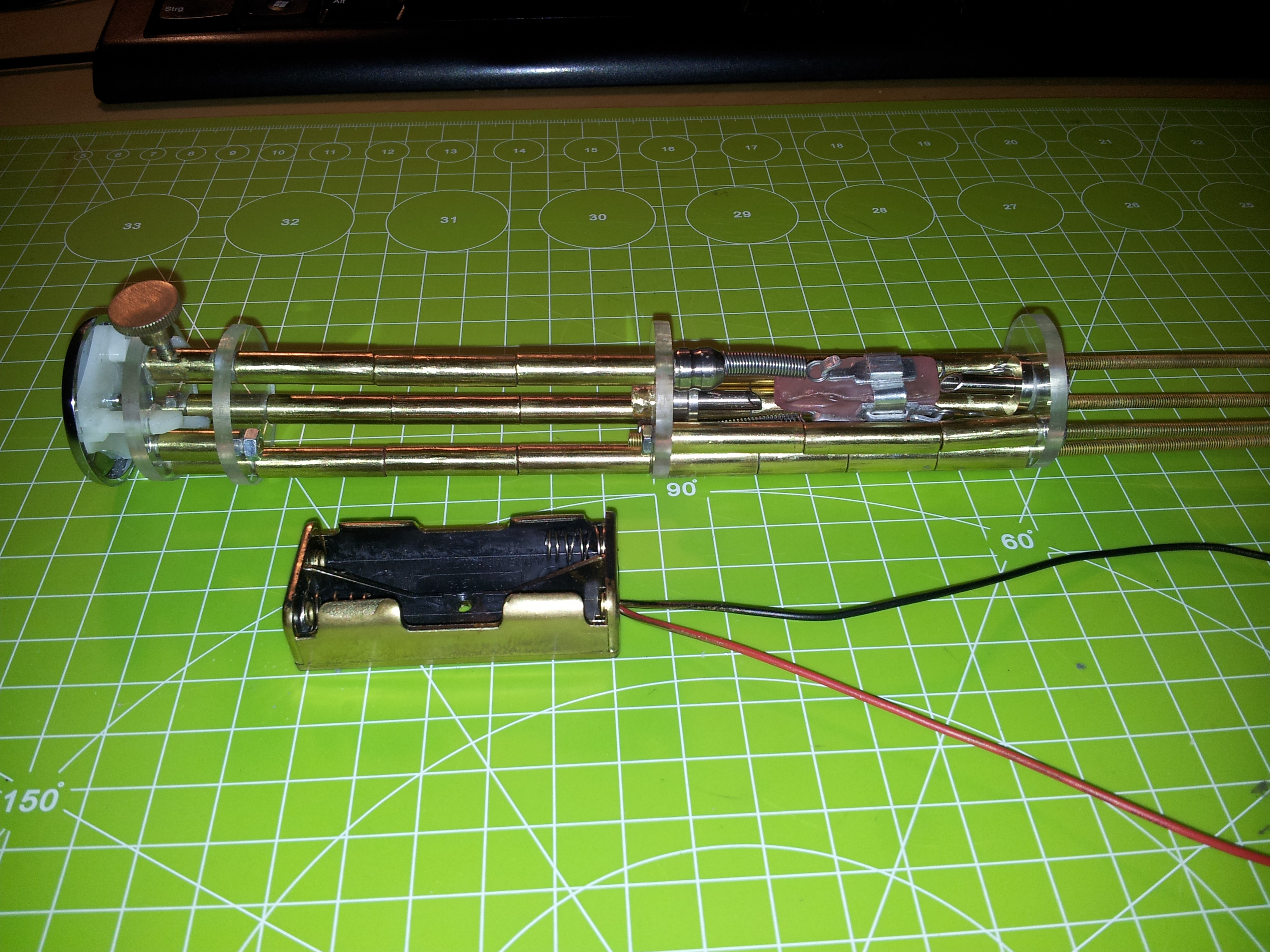

Hi guys,
here are some updates I achieved during the last week.

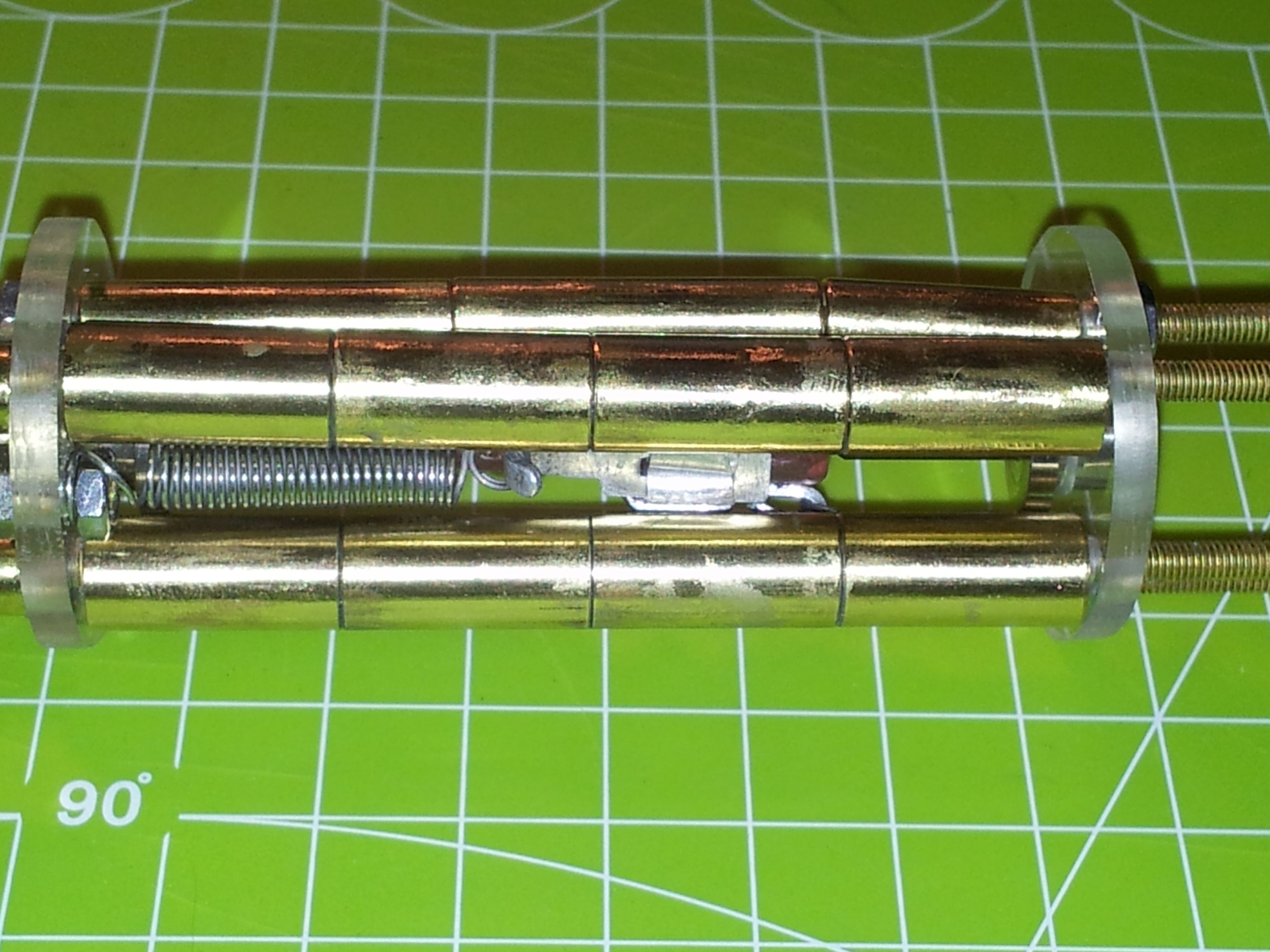

Space for batteries and crystal compartment.
Will add lights and switch soon.

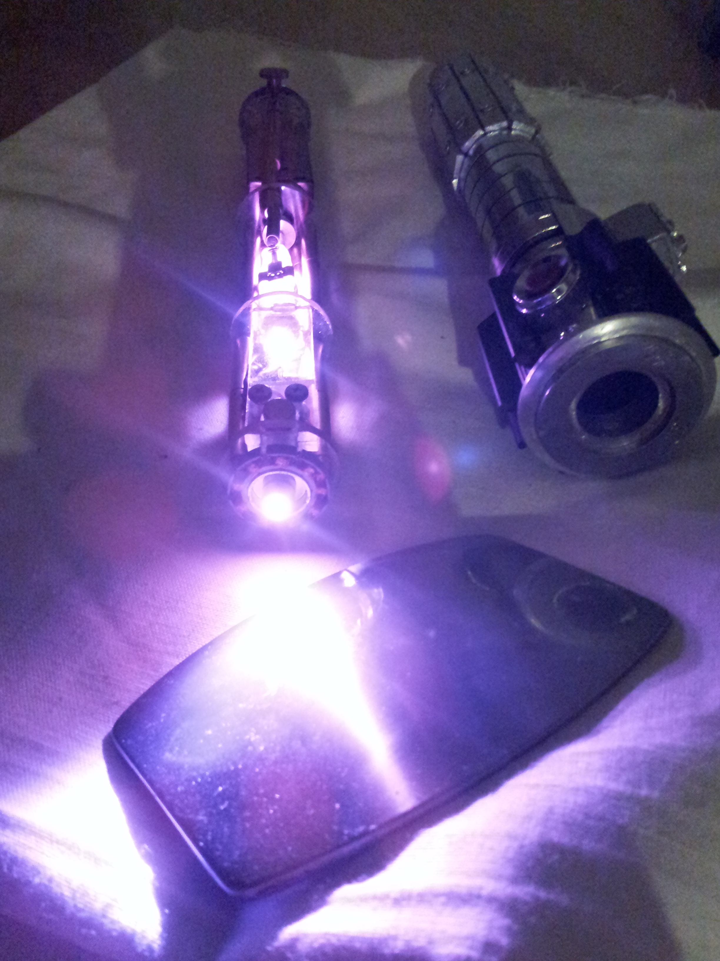

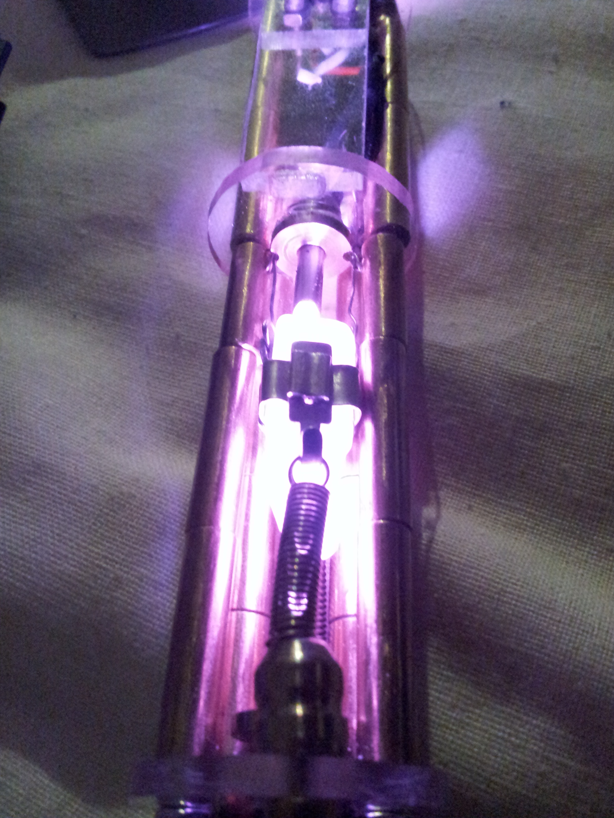

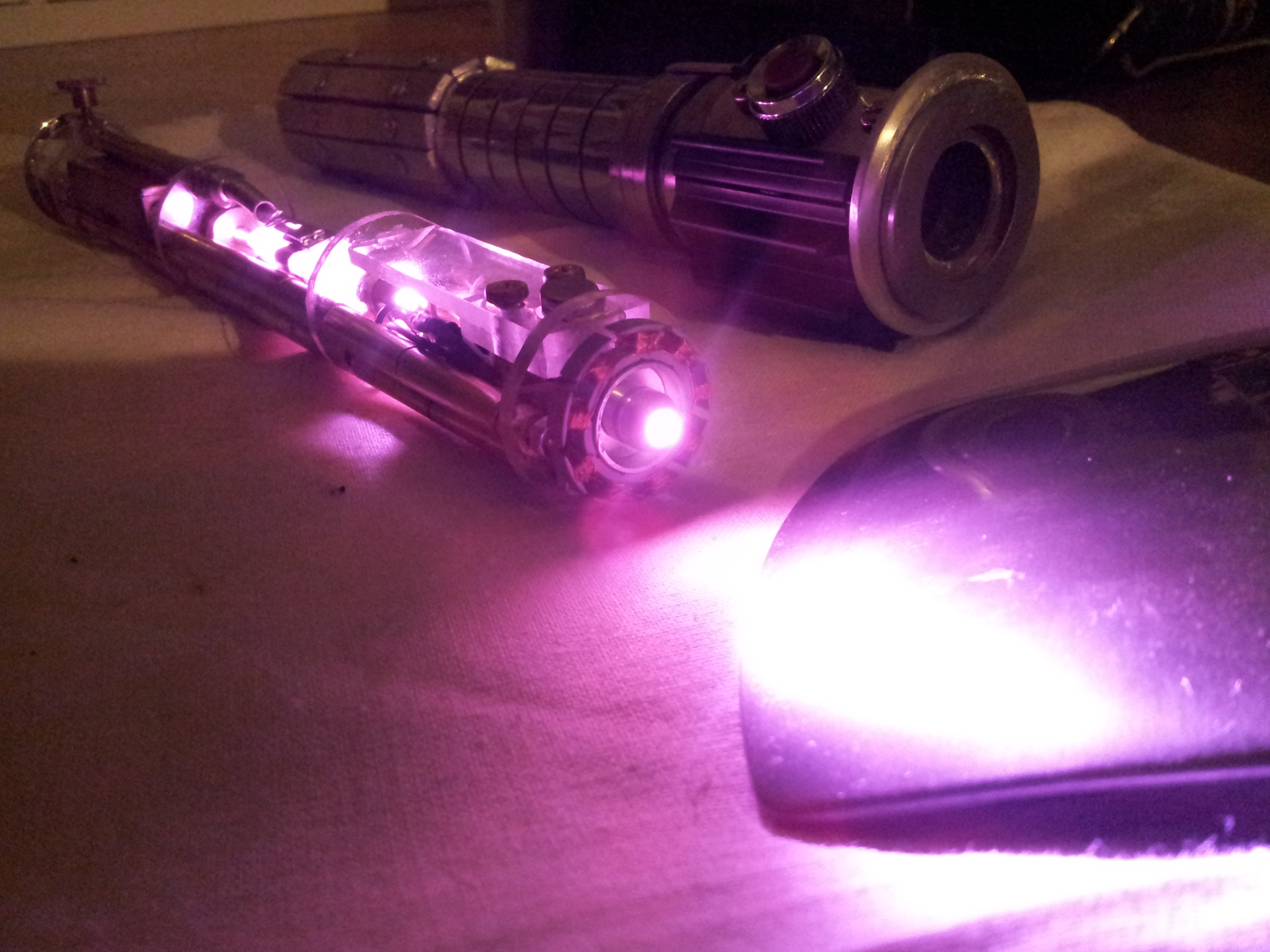

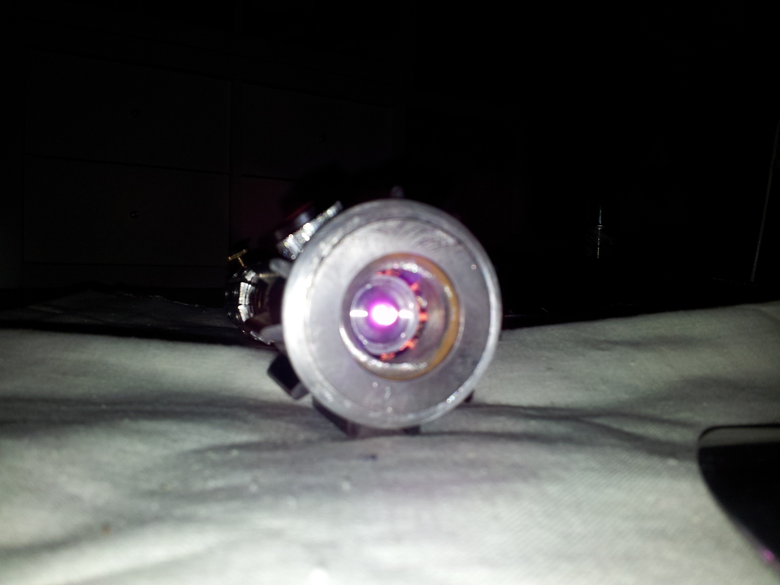

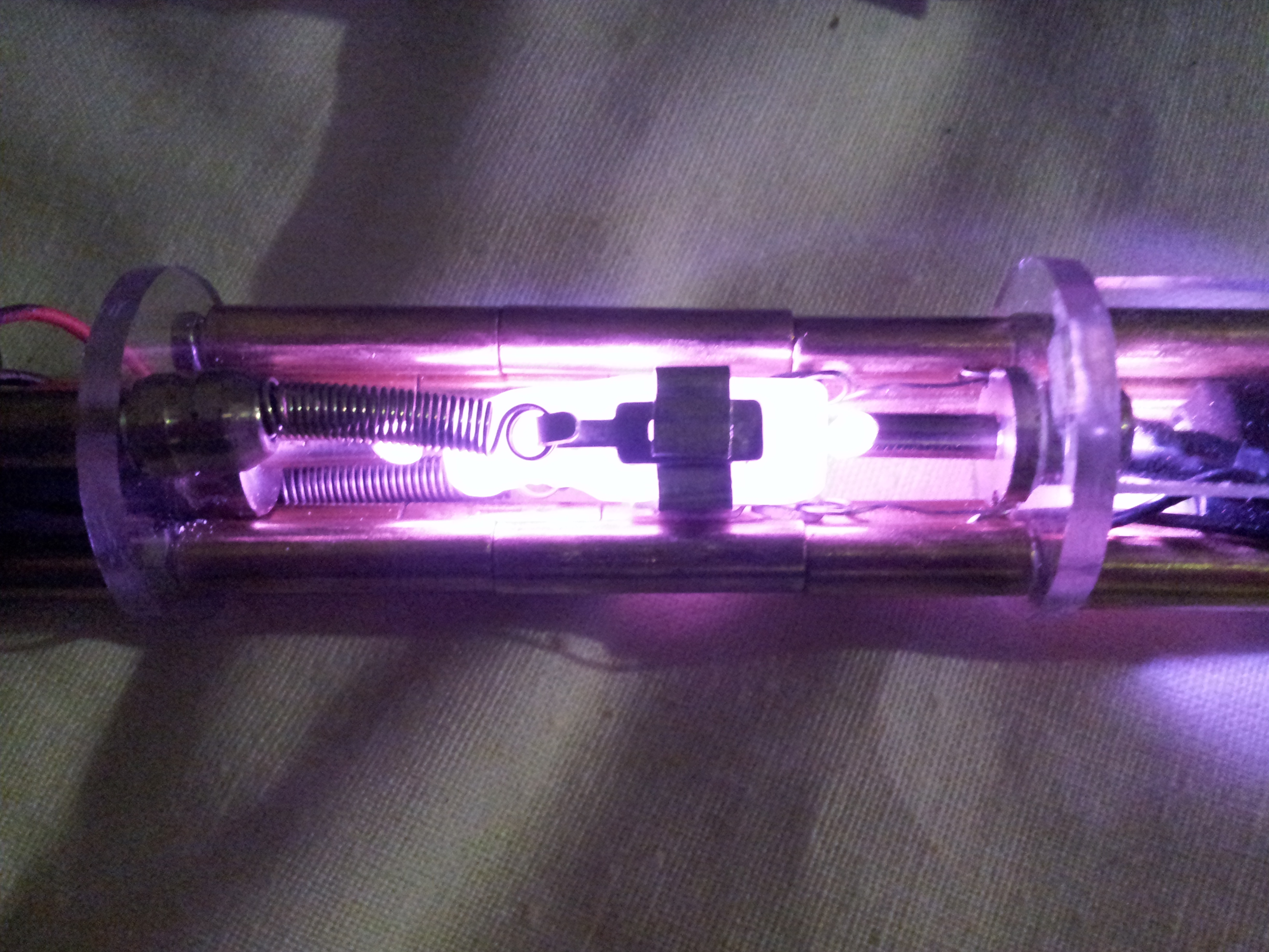

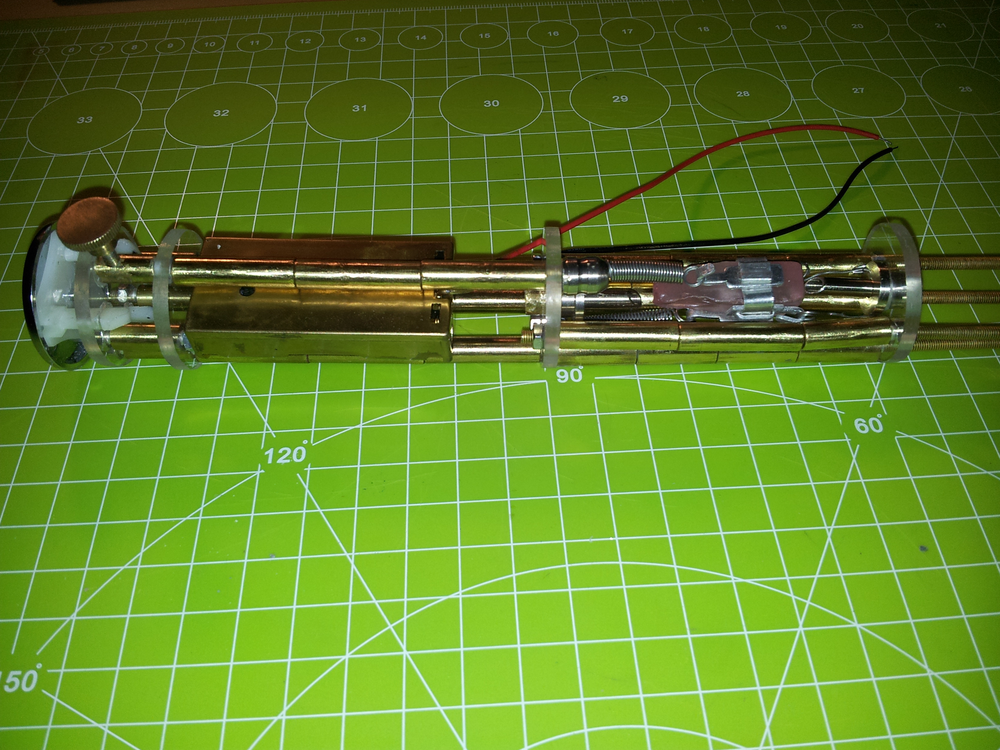

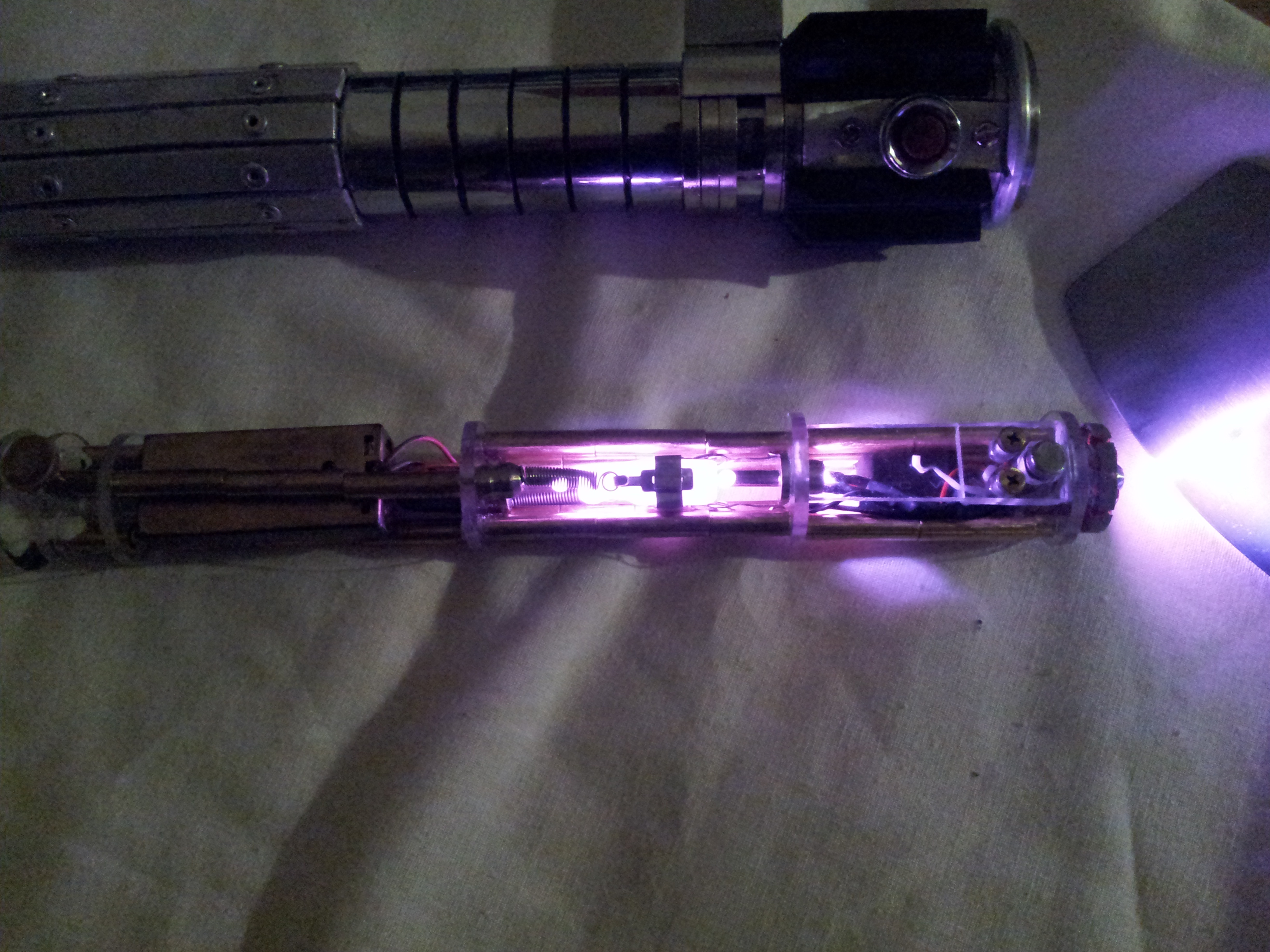

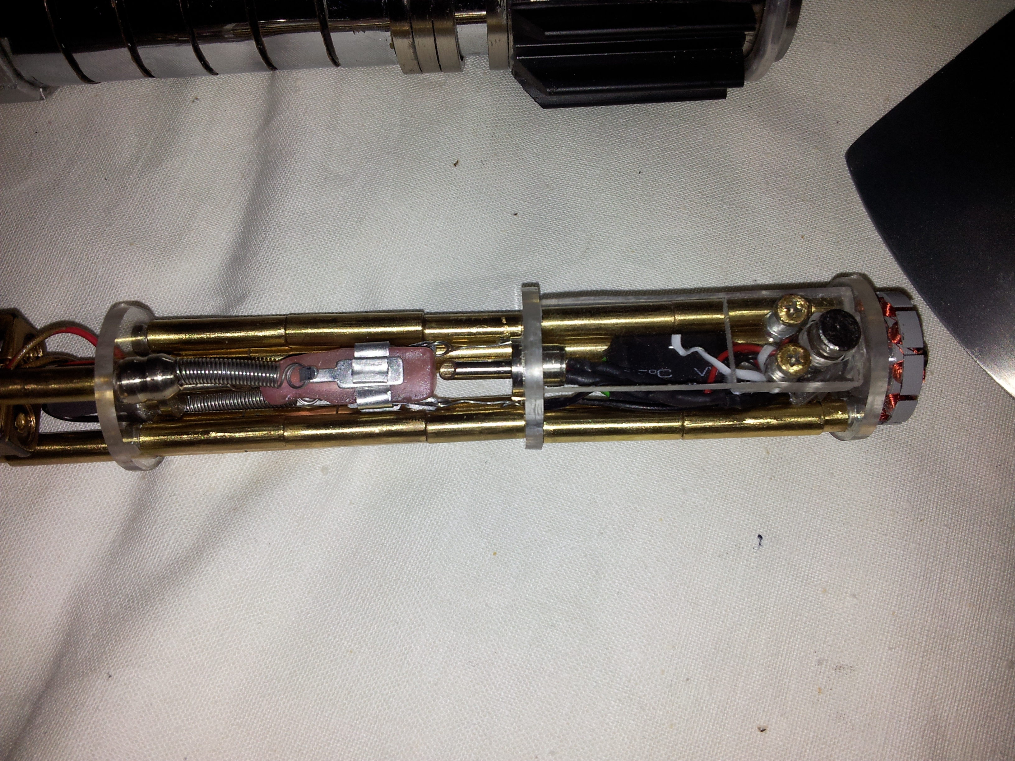

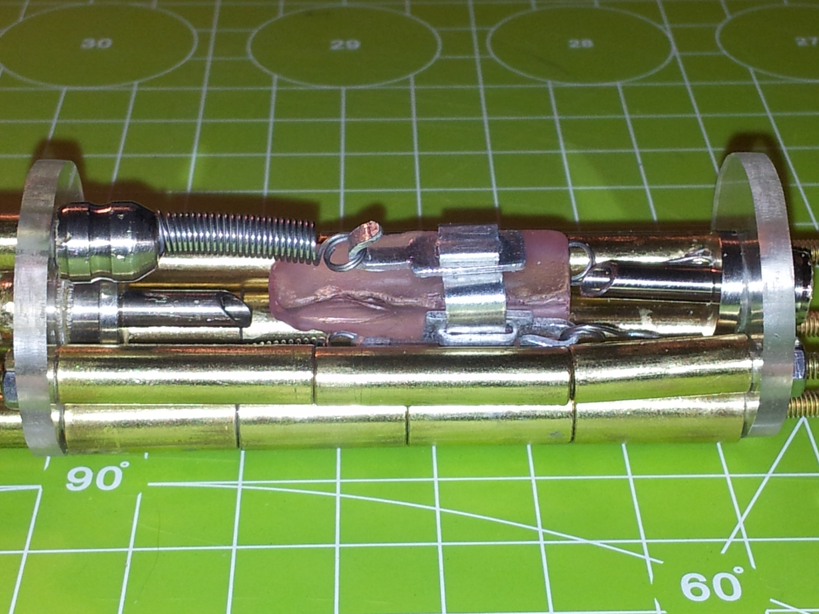

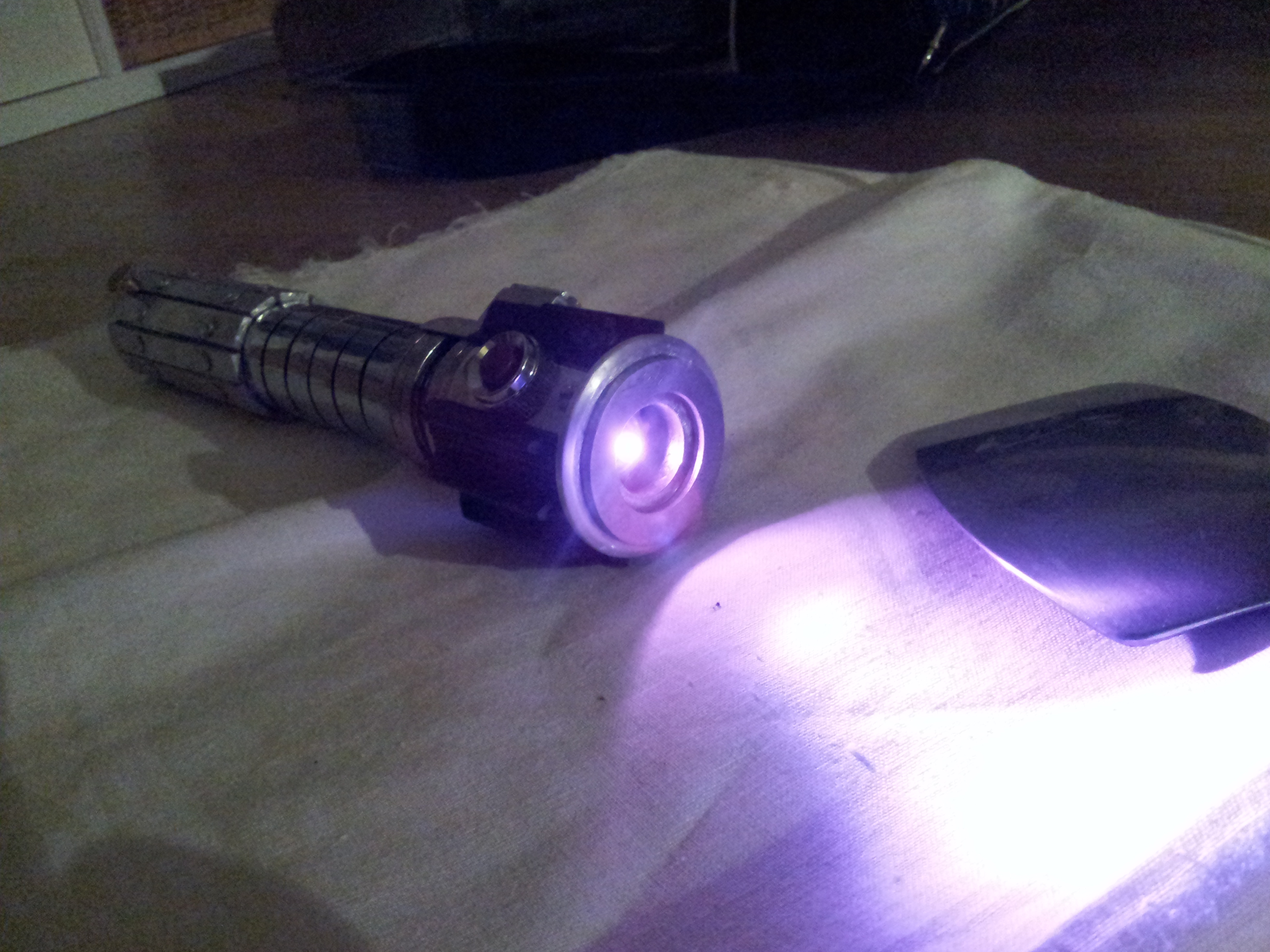

I finished the crystal chamber last evening.
It is completely independent from the hilt and could be switched ON inside and outside the hilt.
Would like to hear your oppinion ;)
Here we go:
Inside the hilt

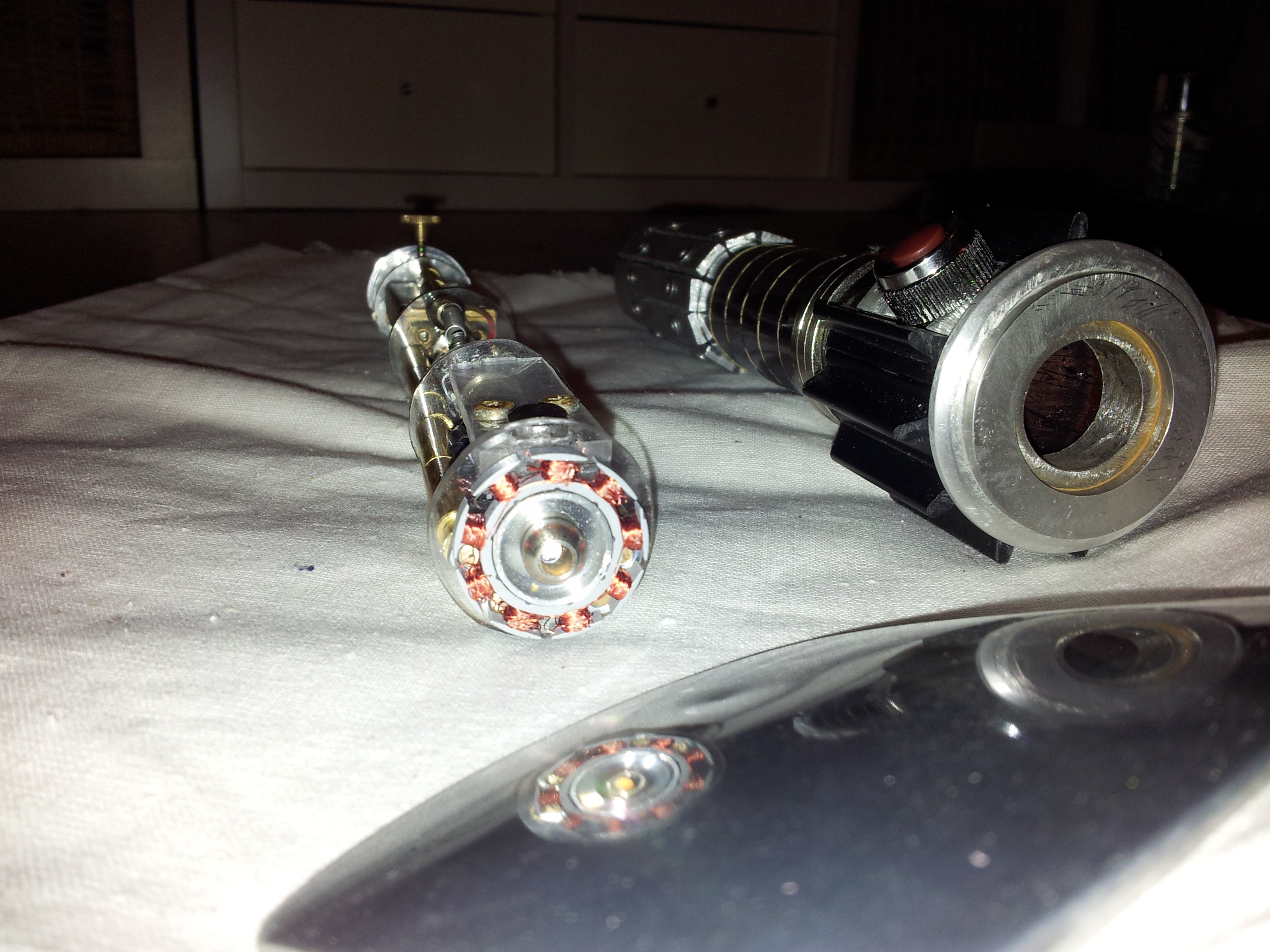

Outside
That's it.
Last thing to do: An appropriate stand.

still that's quite an accomplishment ... crystal working inside as well as outside the hilt

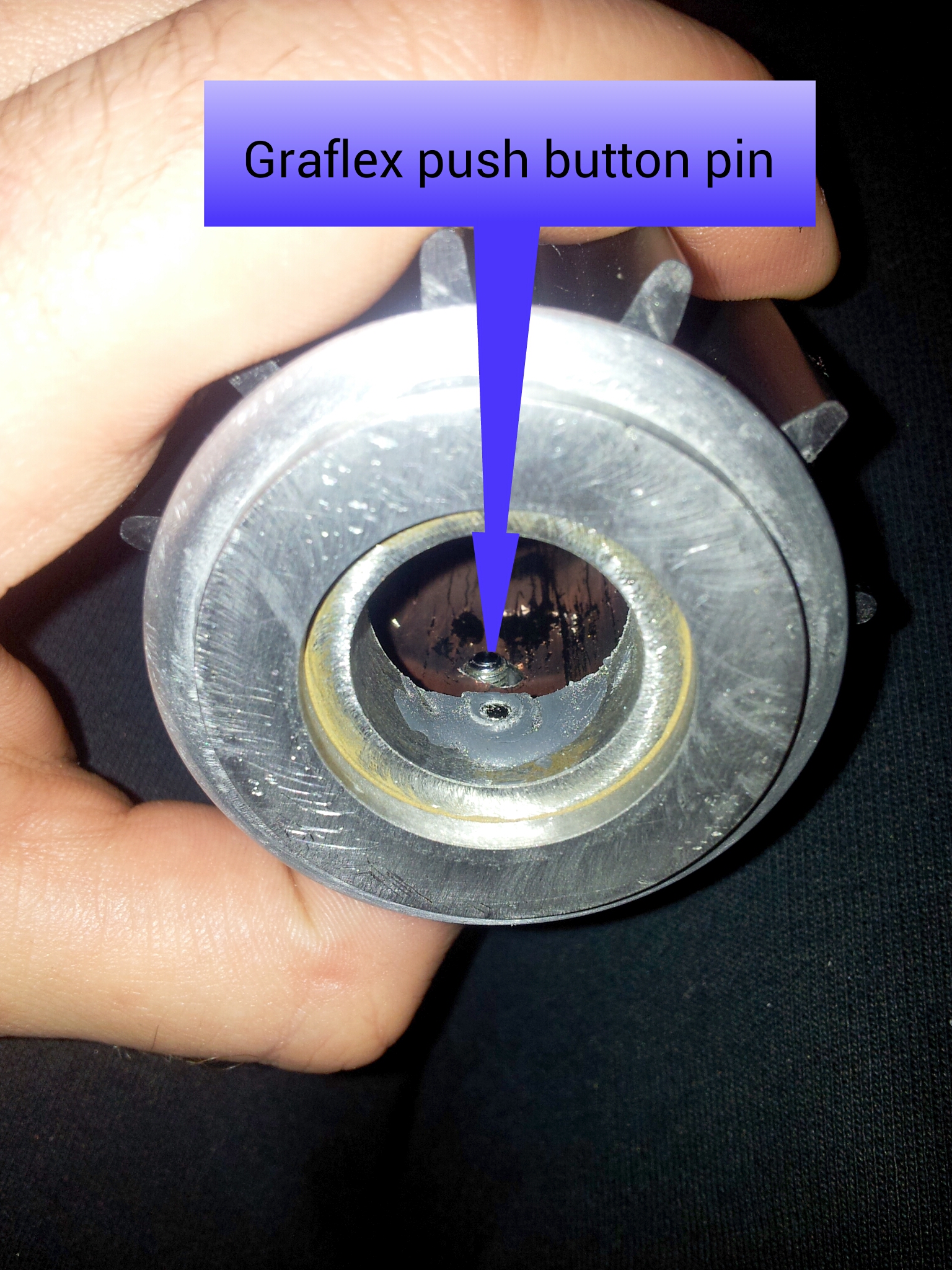

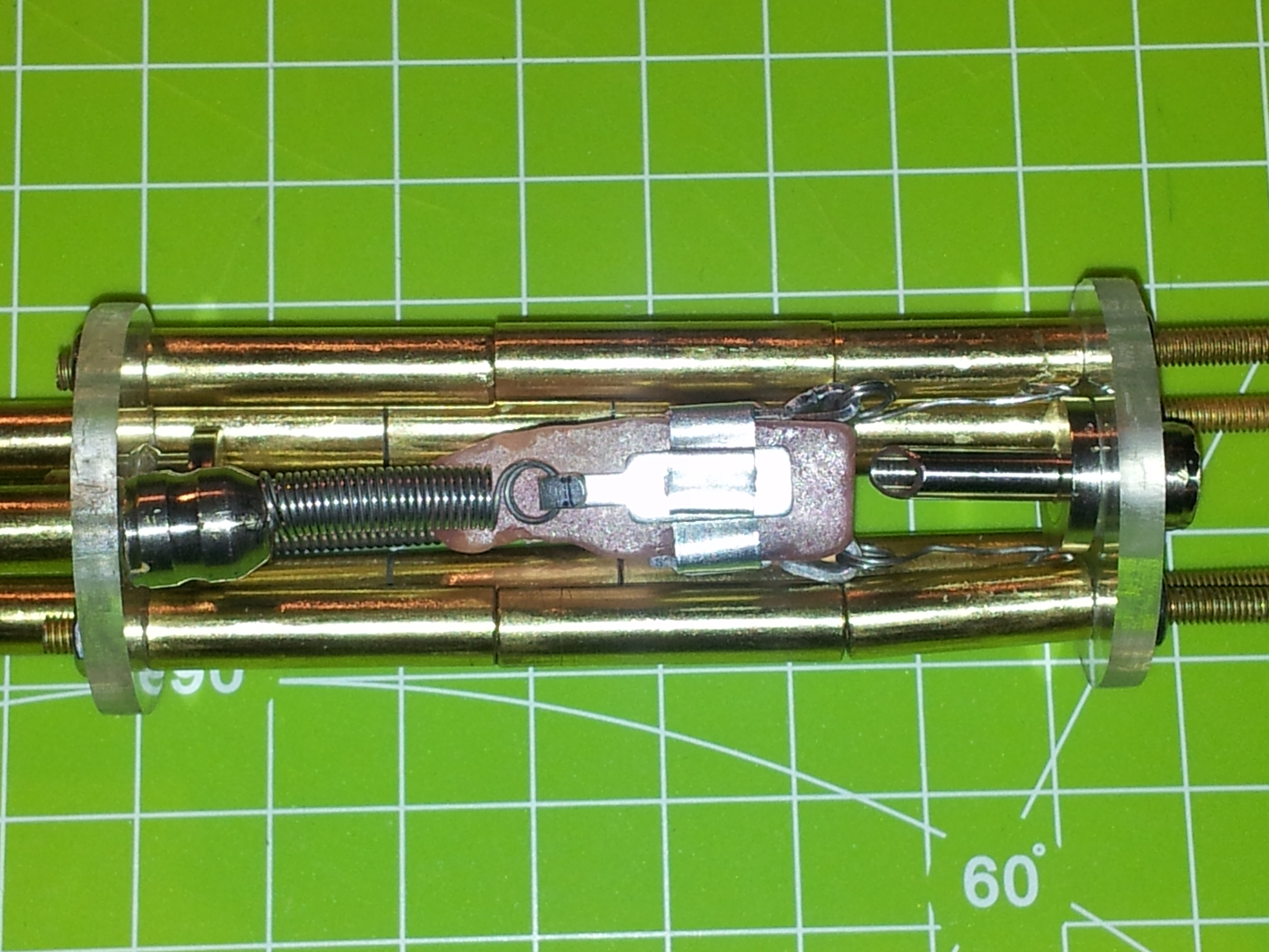

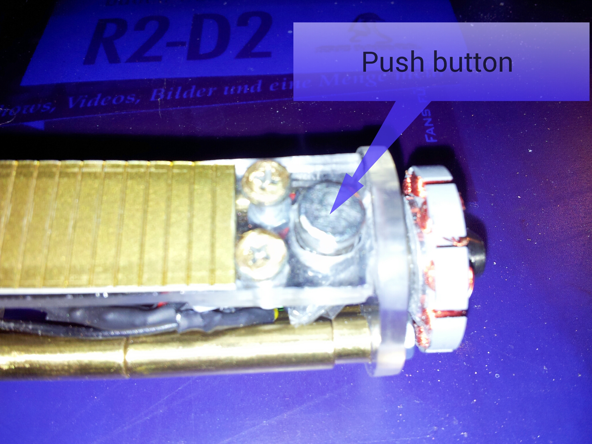

It's quite easy. The working pushbutton is installed in the crystal chamber.
To switch it when inside the hilt I attached a pin to the Graflex button which goes through a hole in the hilt. When I push the red Graflex button the pin pushes the pushbutton from the crystalchamber.
I'll take a picture tonight.
Just hard to see but I'm can't get a better picture.
I think you'll get a idea how it works.
