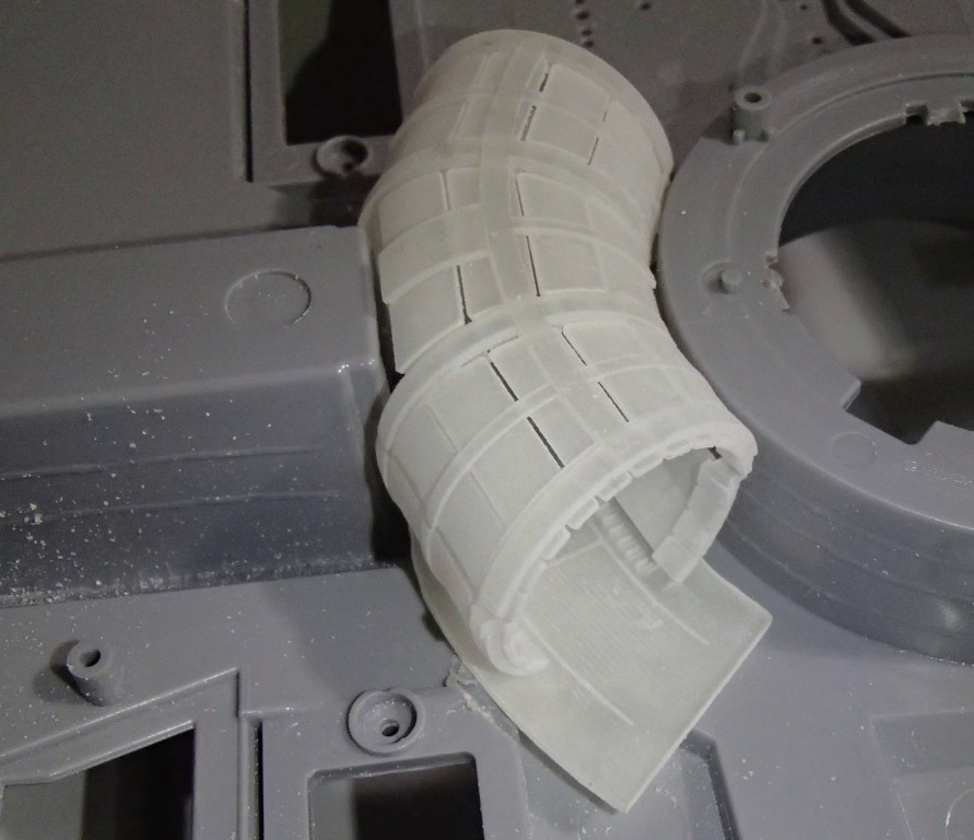

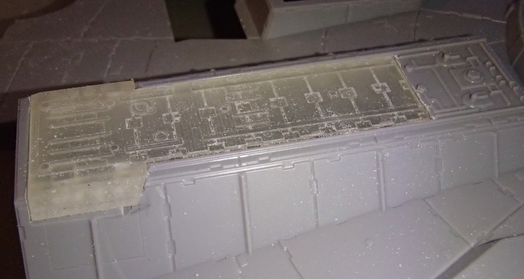

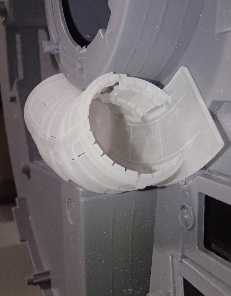

I got the corridor modified and placed into the model. It is looking pretty darn good. I have also modified the model to accept the aftermarket boarding ramp. Now that these are both in the model, I need to finish up the light box for the engines, that will hold the 39 LEDs and figure out where to place the servo that will control the boarding ramp, and then start working on the ground defense laser that you see in Empire and then, figure out how to get a smoke effect into the model.

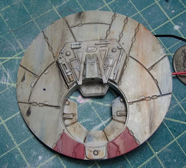

Got some of the oil work down, well, three layers of it. It needs a few more days of drying, before I go back in and do some of the dark grey sections. I plan on doing them in oil at first. If I don't like it, will fall back to acrylic. The picture looks darker than in person, and not as well blended, so I wonder why that is. I have no picture taking skills. One concern is over doing the amount of weathering and streaking, but this sure is fun to do with oils. I still need to find a softer brush though for blending, any ideas would be welcome.

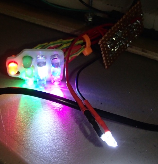

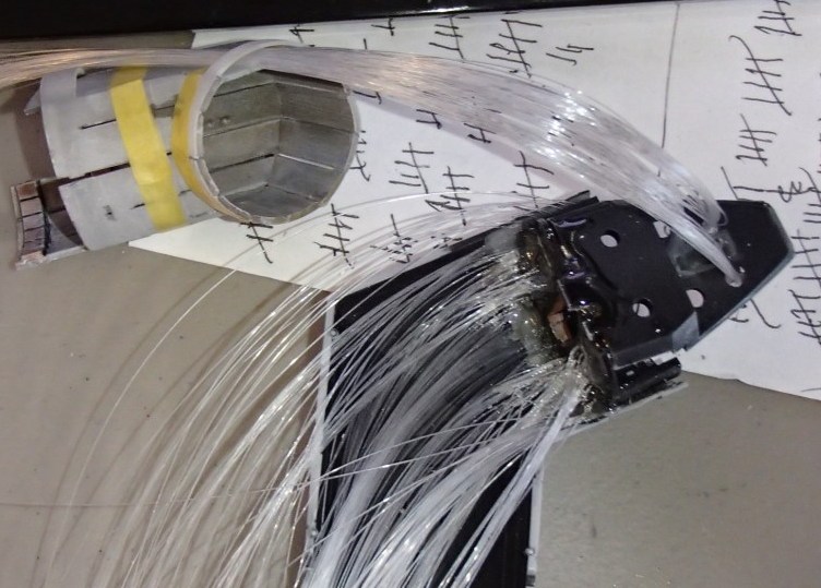

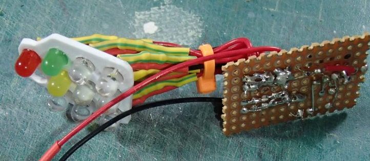

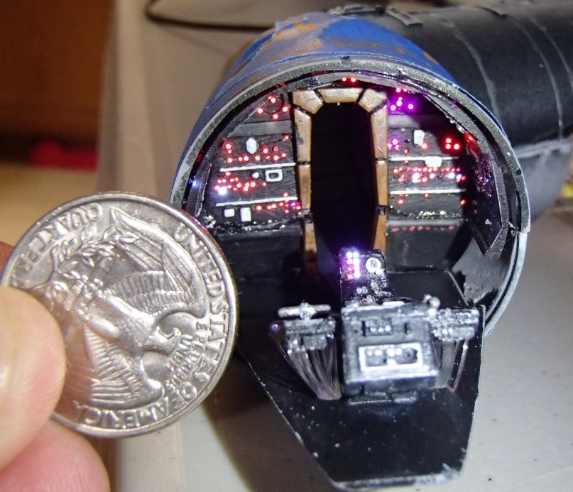

Well, I finally got the fiber installed, the cockpit tube put together, and the LED driver board hooked up. Took way too many hours to get this step done, however, I am pretty happy that the 354 FO in there are lit. They are a little bright, but, the LEDs that drive all of the FO, are turned on by a transistor, so I can hook this up to a PWM and basically dial in the voltage to the LEDs, I will dim them down some. For now though, I am basking in their lit glory. I do have the board turned the wrong way, not sure how that happened, so I will have some issues when I start working on the boarding ramp, I will have to figure out how to get this turned back around.
It was very difficult to get everything to close up, and route the fiber. I am not sure how to make it better in the future. The FO are all twisted around to get them to fit into the various LED heat shrink used in tying the FO into the LED.
I would have liked to have spread the blinkies out more, but it was a crap shoot pulling fiber for the different LEDs, you don't know where exactly they are coming from, since everything was closed up.
Pics 1 - 3 show the fiber and hull parts getting closed up.
Pics 4 - 5 show the LED board on and off. I used 5mm LEDs, should have gone with 3mm LEDs for all but thered.
Pic 6 shows the LEDs on and a quarter for scale.
Check out the video of the cockpit lit.
https://www.youtube.com/watch?v=OepnOBzNeoE&feature=youtu.be

Are you using leds that flash themselves, or do you use an ic board for that? No electronics man myself and the only thing holding me back in finishing my Slave I project is getting the leds to flash..

knievel - I am using LEDs that flash on their own. I bought them from Fiber Optic Products, Inc although many people carry them. I am not sure if you can change the rate at which they blink, but I have not played with changing the voltage going to them, so who knows.
