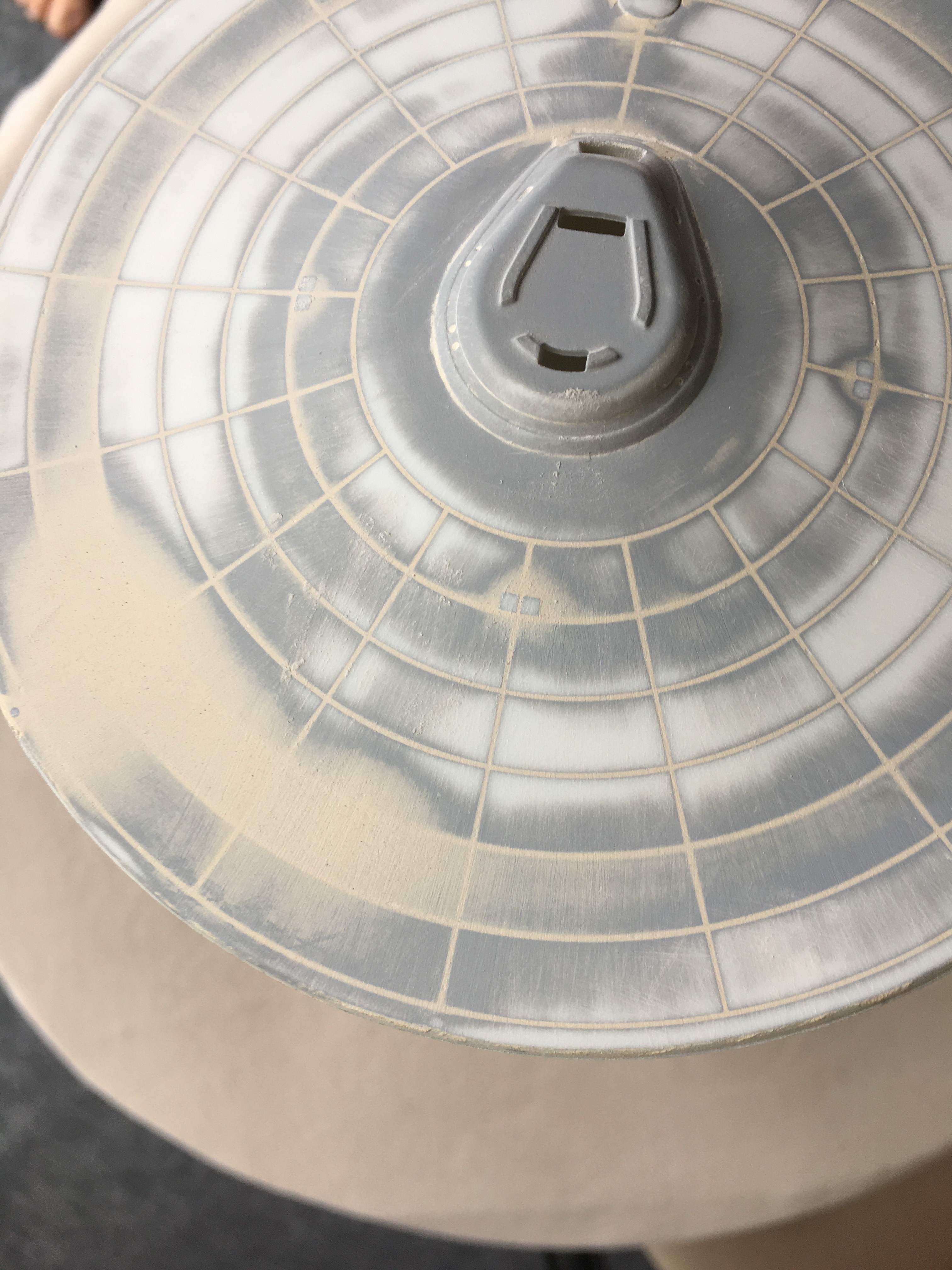

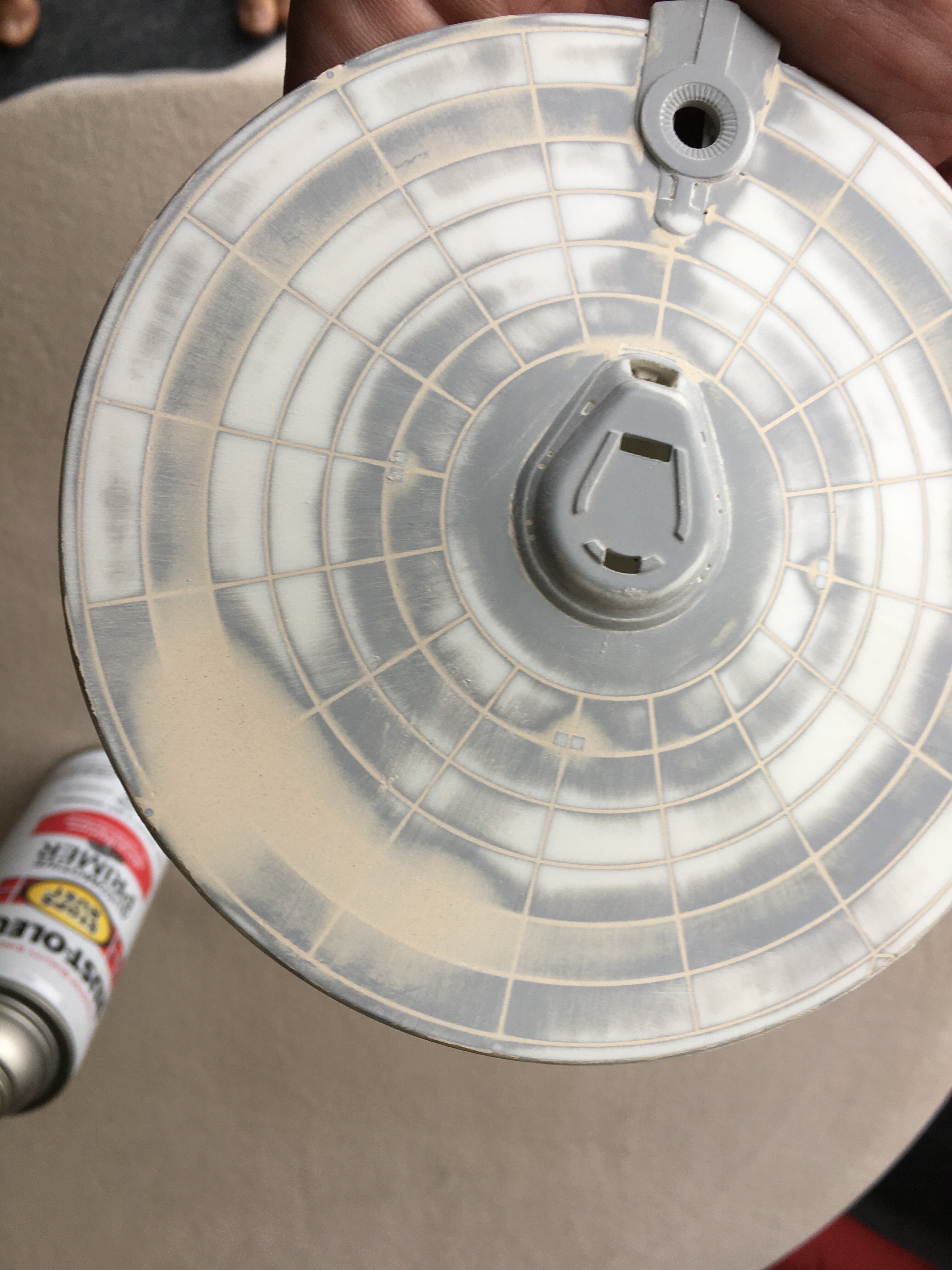

On the wood filler, it feathers amazingly well too (sheesh - sounds like I work for DAP or Elmers!)...
Apoxie Sculpt - if I remember right - can be a bitch to sand, and I ran into the "drying up" issue as well.
Here ya go - a look at sanding / feathering... (yes - am aware I obliterated my phaser banks!)
And this is a relatively heavy grit too - 220 I think:
