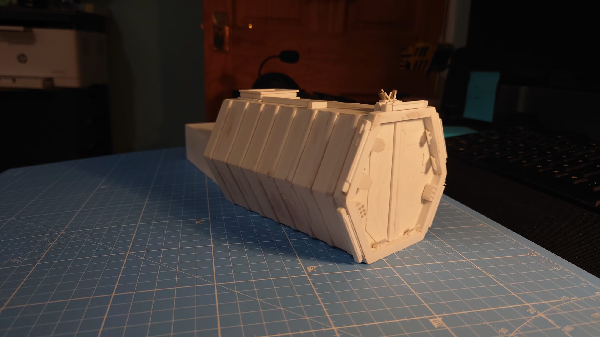

But the main thing that's prompted the filler questions is trying to save a model of the 'Belter breaching pod' from the expanse:
I've messed up and put some dodgey filler on it, then further messed up by sanding it too soon and am left with the above image on parts of it.
I reckon I can save it yet and then just have some "free weathering" it's meant to be a used smashed up shipping container after all!
any advice from anyone would be appreciated, should probably have led with the images in the first place to be honest.

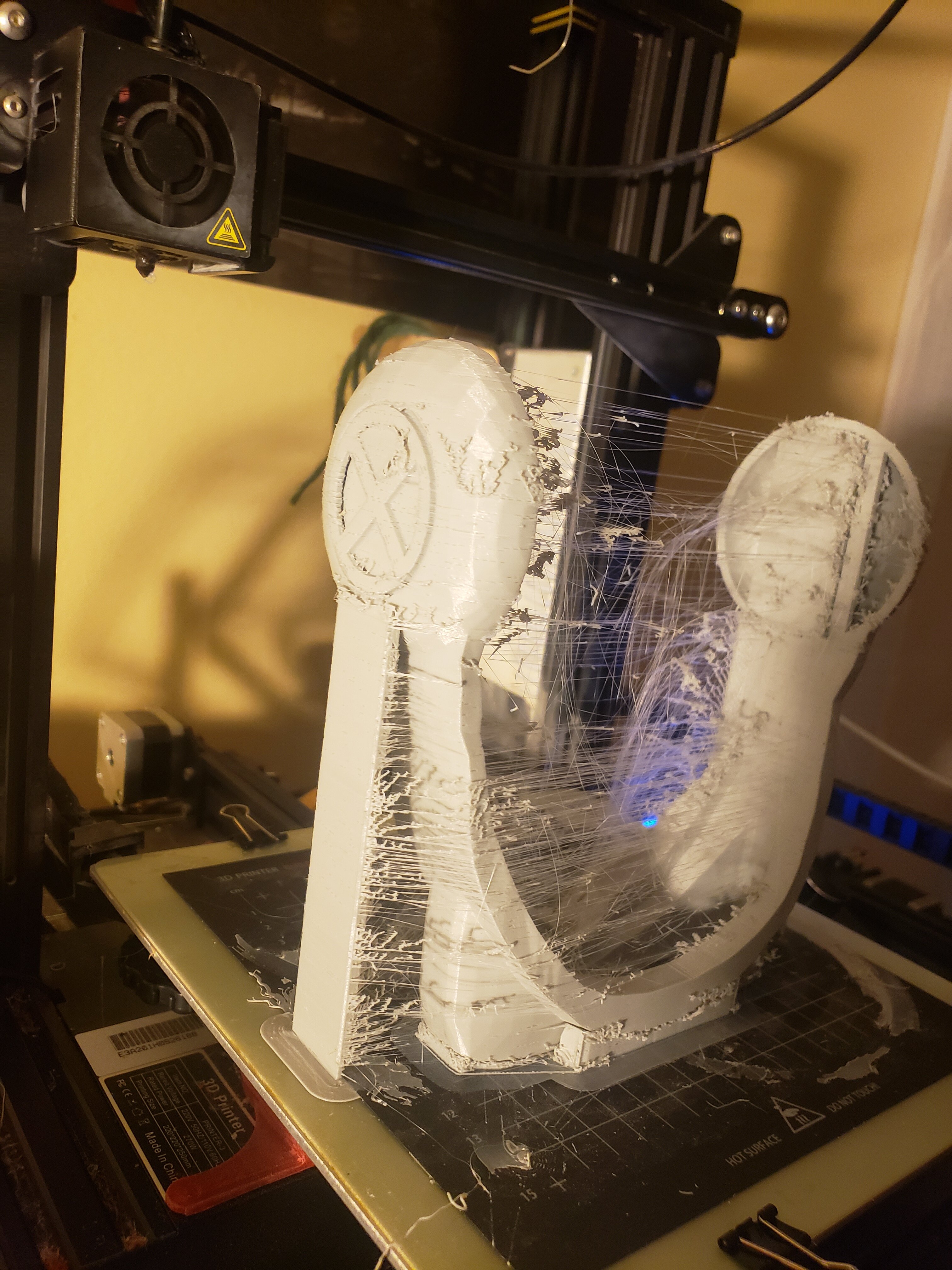

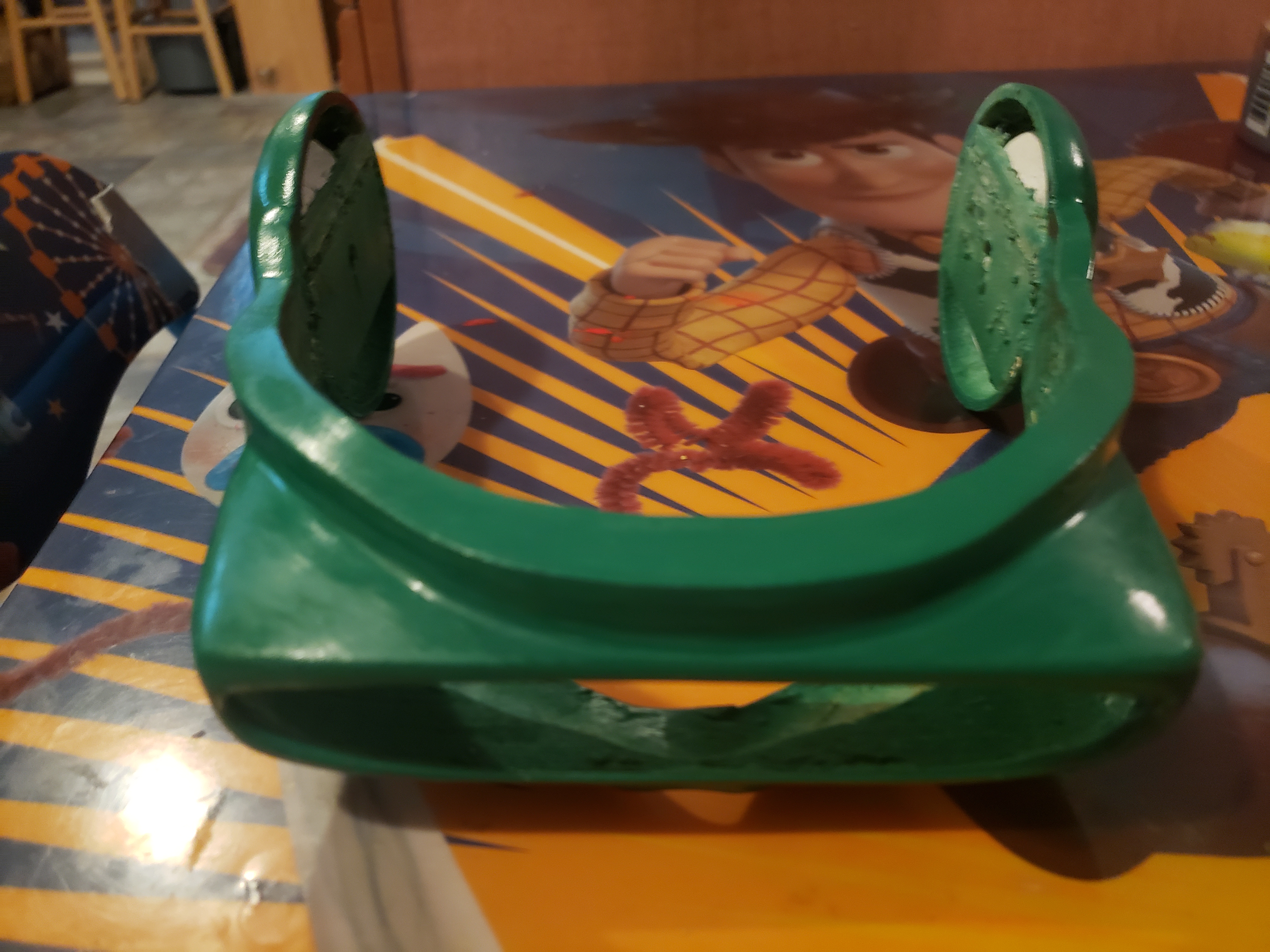

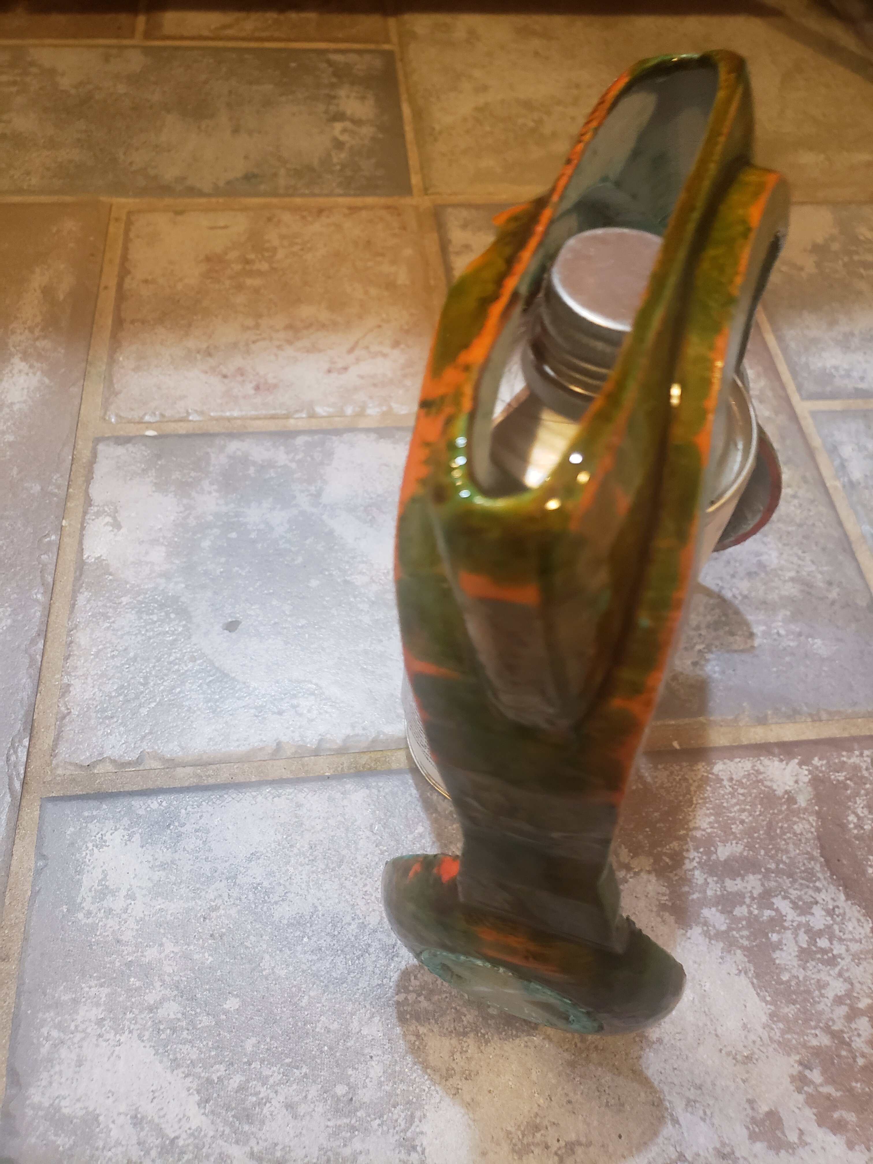

I am actually a fan of XTC 3D for that kind of stuff, paint multiple thin layers and it will fill in.
When it starts to look good, paint it in a totally different color and your eyes will pick up additional blemishes
Interesting, I have some of that. Do you find in binds to stuff like styrene alright?
Not necessarily; no...
Consider it purely as a filler, not a binder, per se.
It is not robust enough to withstand or support stress, but as a simply filler (imaging nacelle seams on a TOS Enterprise), its beautiful...
