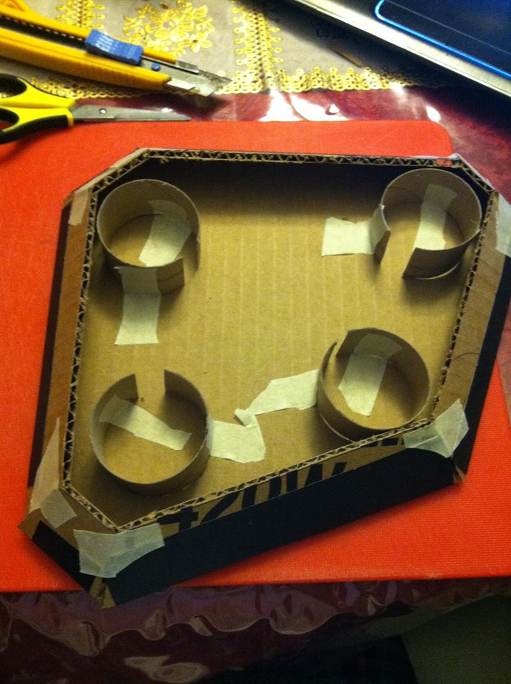

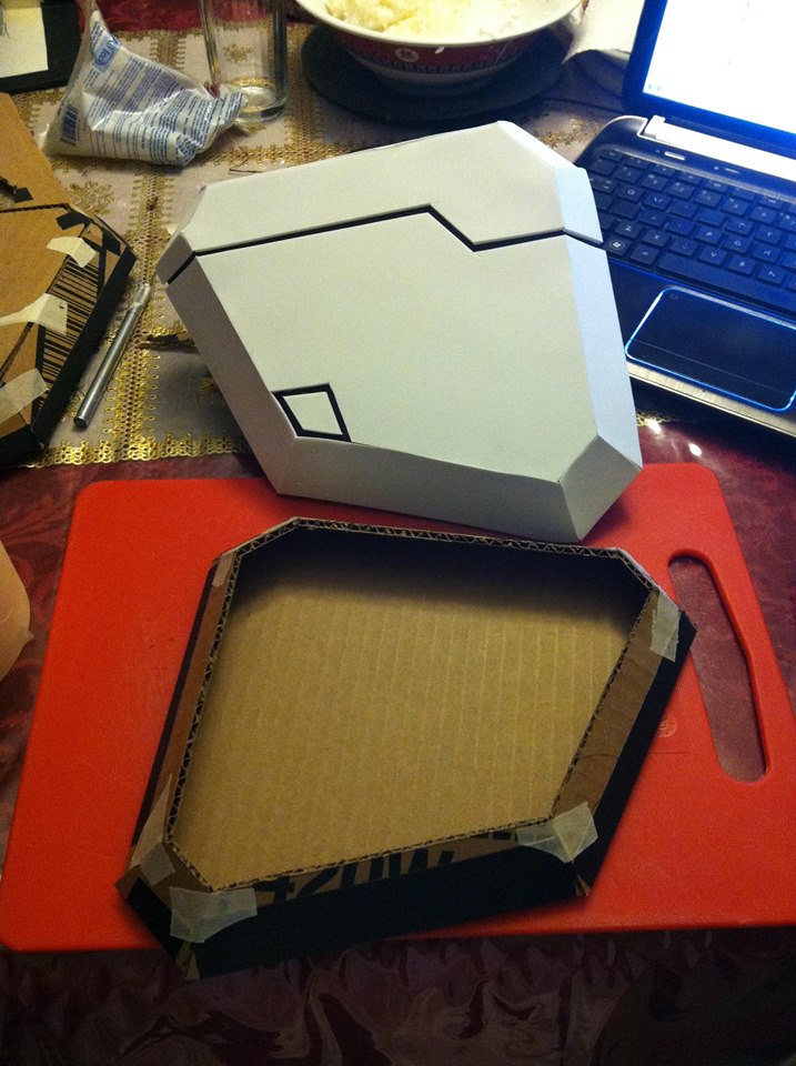

Got the frame of the plates all done. Very sloppy, but here are some pictures to give you a better idea idea of how I made them. I used paper towel rolls as supports.

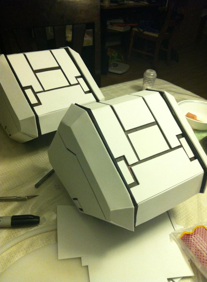

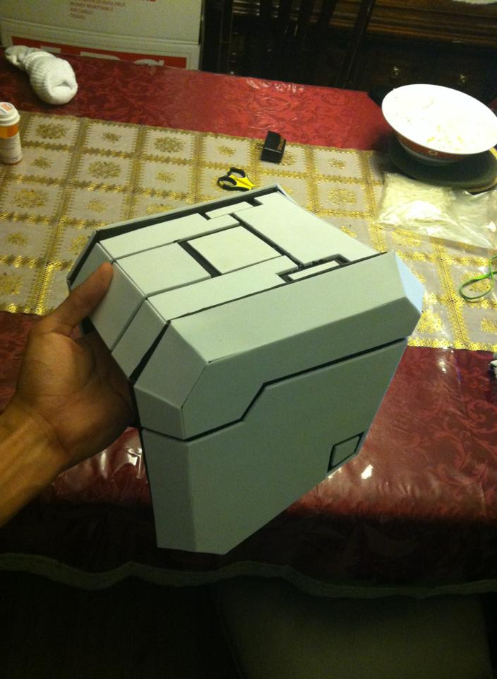

I planned to finish one more shoulder plate tonight, but ended up finishing a whole shoulder. LOL. It's so satisfying seeing it slowly come together!

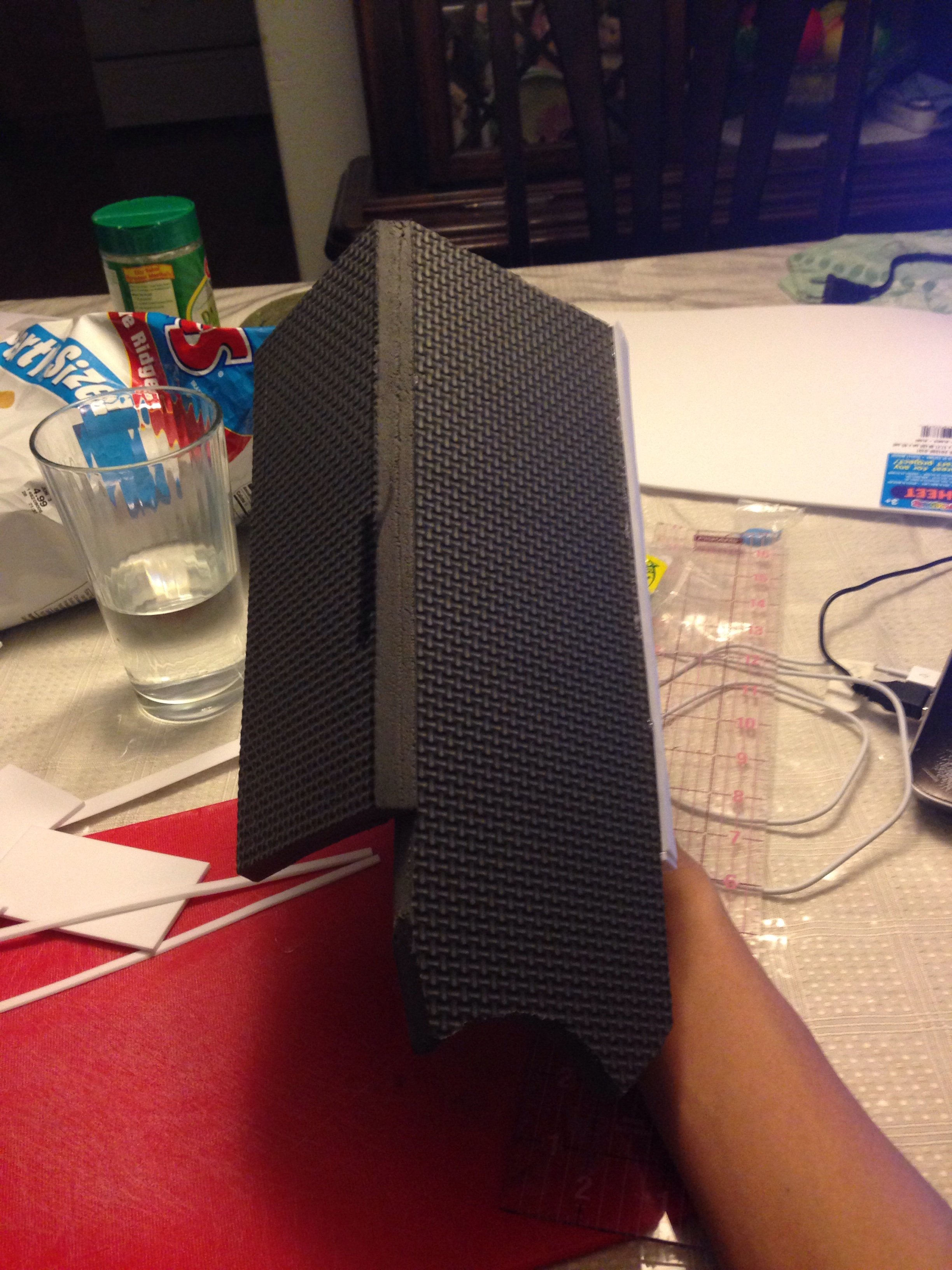

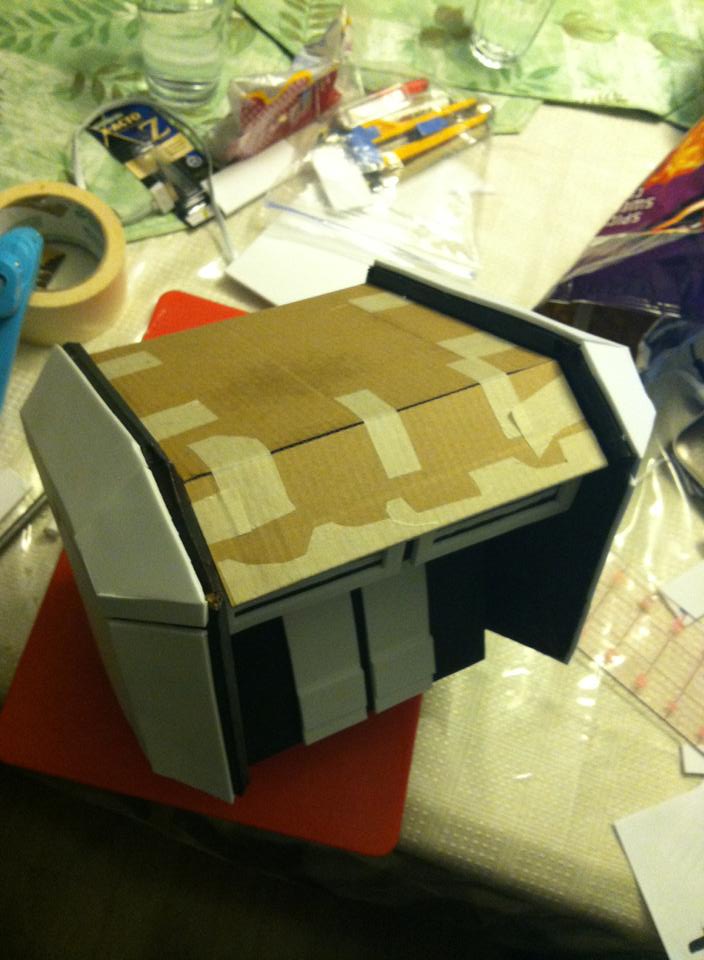

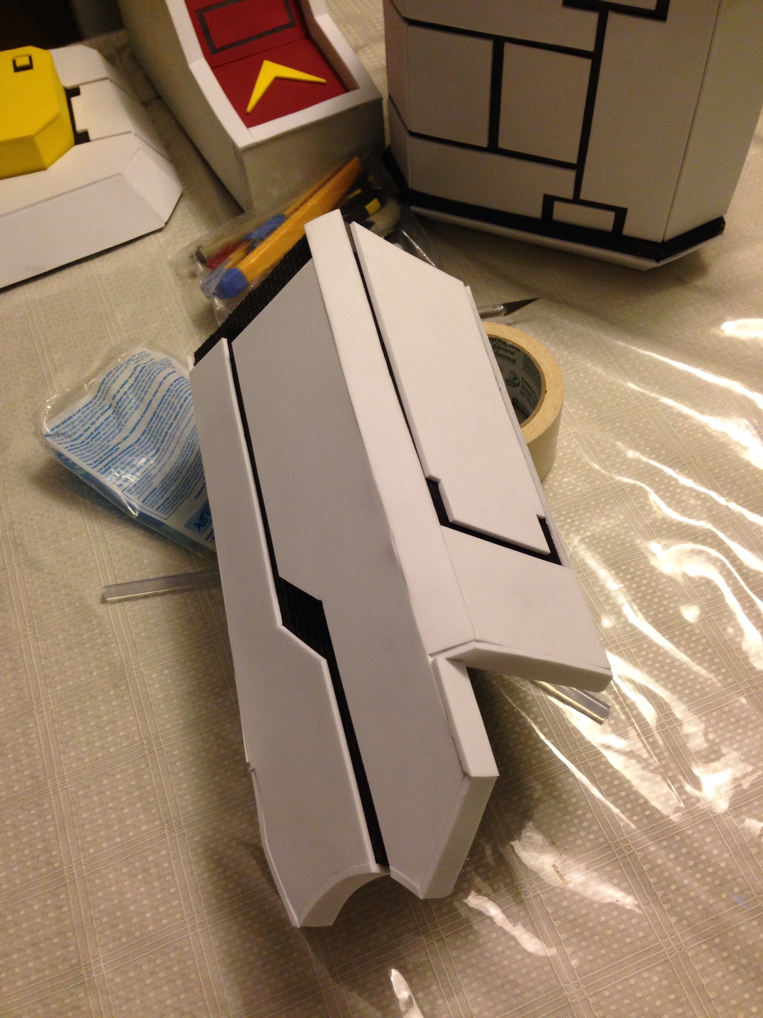

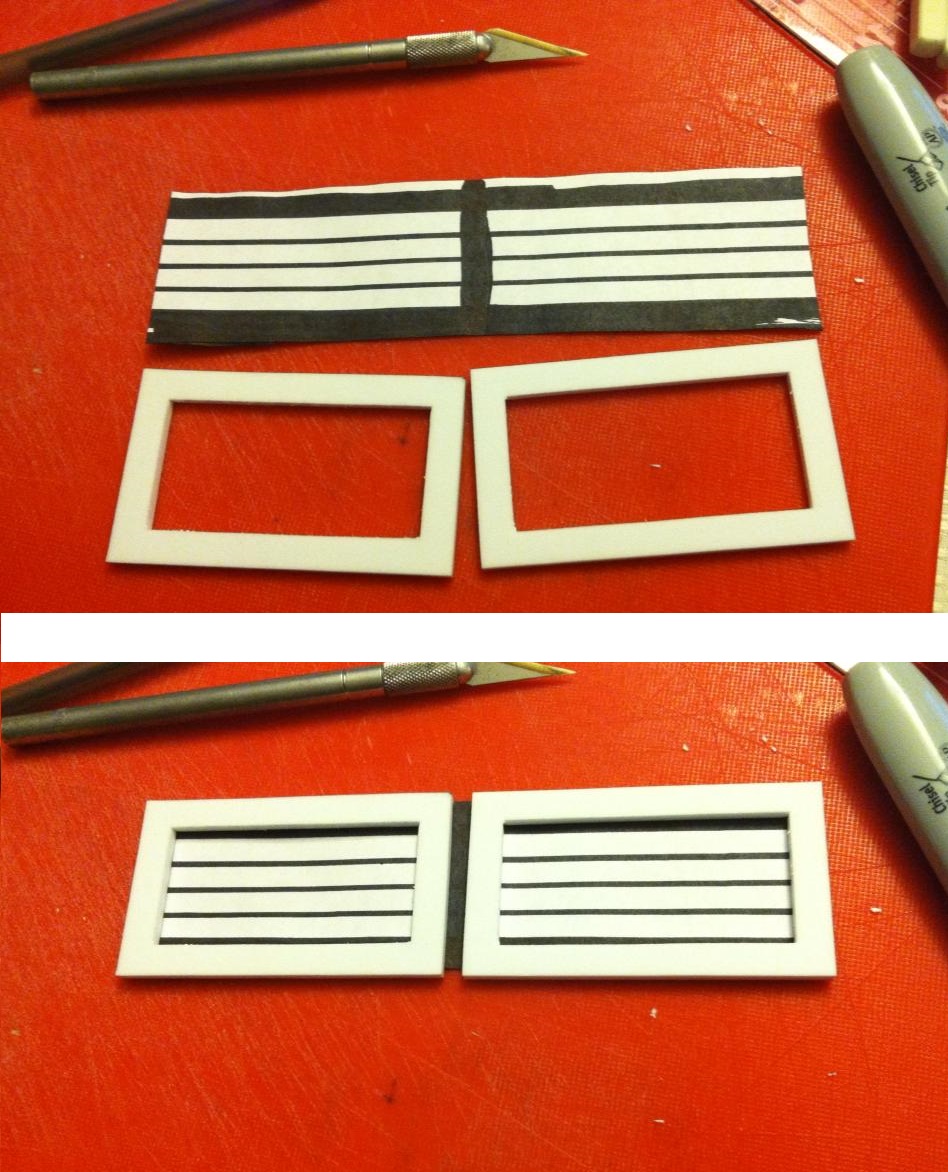

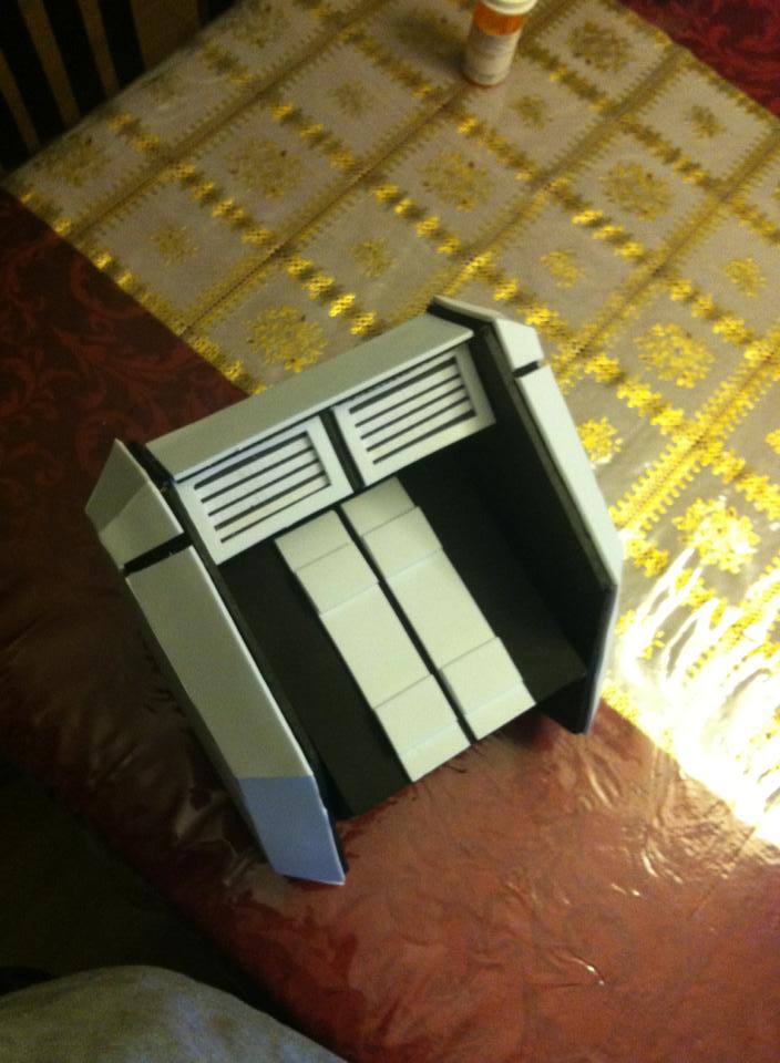

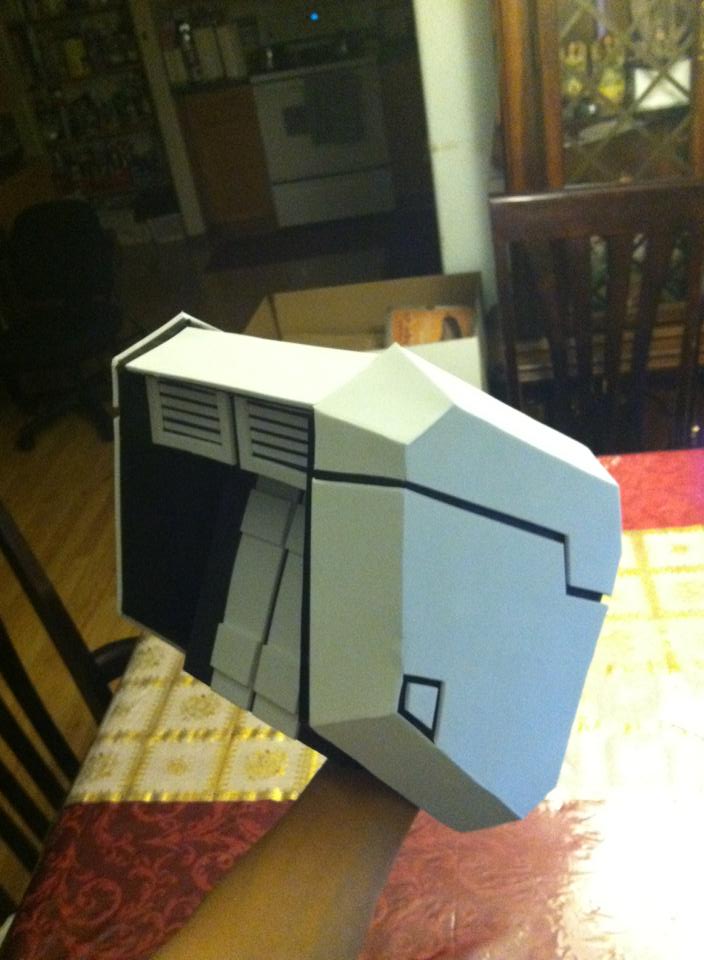

Took me a while, but I finally managed to finish both of the shoulder pieces. I took some pictures in the process to show how I've been going about making most of the costume. The little vents are basically just lines drawn on a piece of paper with rectangular pieces of craft foam layered over them. Foam pieces were measured, cut, and hot glued on to the cardboard base. Unfortunately hot glue doesn't adhere very well to masking tape, so I sometimes have to go back and remove bits of it. Thats why it looked all torn up in the second picture

Thats awesome build.. can't hardly tell that you used a cardboard with that build. :D.
Keep up the work. :D

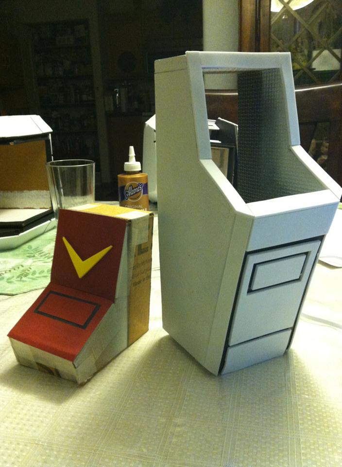

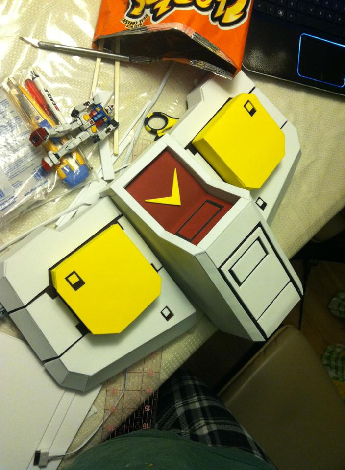

I finished the crotch piece :) Finally got to work with plastidip+spraypaint. I gave it 2 layers of plastidip and later 2 more layers of white Rustoleum spraypaint. So far, the paint is sticking incredibly well to the plastidipped surface which is awesome, but I ended up getting a kind of grainy texture... and some tiny cracks. I'm thinking it may have been because I sprayed on too thick. Which I'm hoping is the case because the whole torso is going to be spraypainted @__@
Here's what the texture looks like up close. You can tell the difference between the painted surface and the foam on the left.
I really didn't like that texture, so I ended up covering the front face with foam. And I'm glad I did cause it looks awesome :D Edges still aren't perfect, but they get lost in all of the details I think.
1558554_661148877285039_6020040853406582845_n.jpg1512287_661148857285041_4201866139534246641_n.jpg
Instead of spraypainting craft foam for the red, I ended up using a painted piece of card stock. I got excited to see it finished so I just cut out a flat V shape from yellow foam and stuck it on there haha. I might replace it with a 3d one later on. You can see the textured side of the EVA foam mat on the inside of the white piece, but it's not really noticeable when put together.

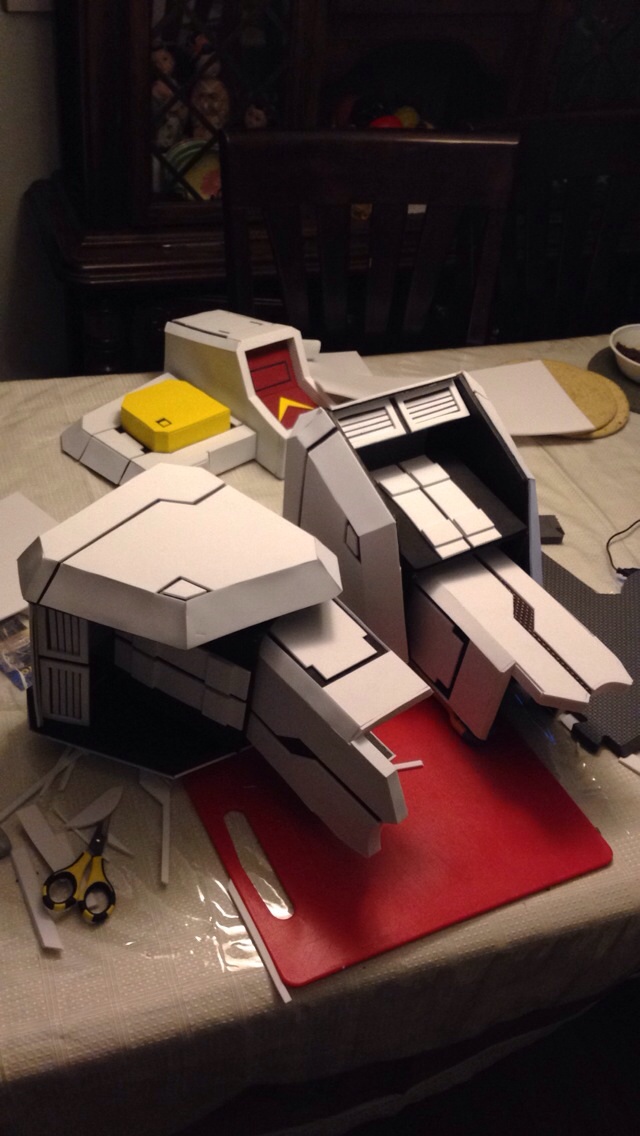

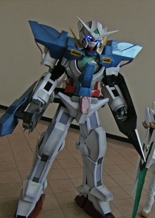

I've been working on this every night lately, but about 1/3 to half of the time was spent looking at what I have, test fitting, trying to figure out how to make the future pieces, or experimenting with paints and different materials. I initially planned for the upper and lower arms to work like sleeves you simply slip on, but it just didn't look right due to the gundam's super broad shoulders... I ended up going with the 3-sided biceps method like in clive's exia below
Other than that, I also made some changes to the torso piece and started adding on the red. I discovered something weird in the process, but I'll save it for next time :)
